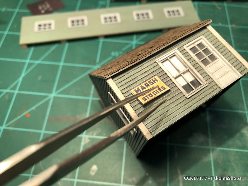

For now I will show how I managed to apply the provided signs to the buildings. There are many ways to do this. Honestly, try whatever works for you and stick with it. Here is what I did.

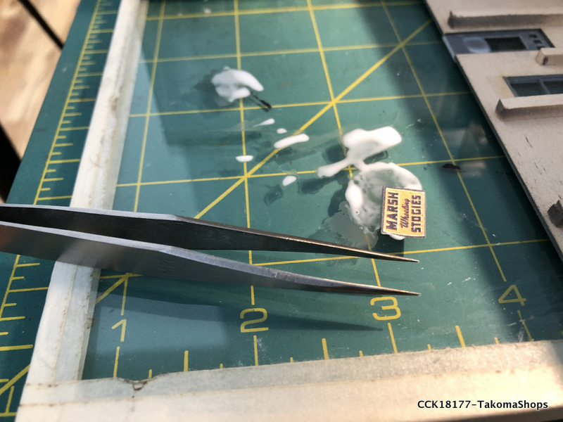

I cut out the individual signs from the provided sign sheet.
I "dunked" the sign into a pool of full strength white glue. The goal is to coat the back of the sign with a thin layer of white glue.
I lifted the sign out of the pool of glue and lined it up with a clapboard on the building wall.

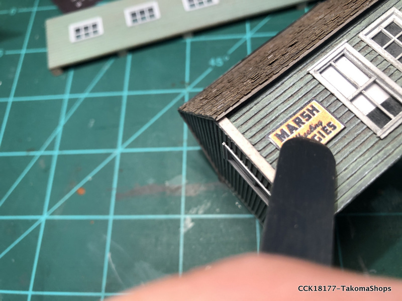

With the blunt end of my tweezers I burnished the sign onto the clapboard wall. Some white glue will squeeze out. Try to remove it carefully.

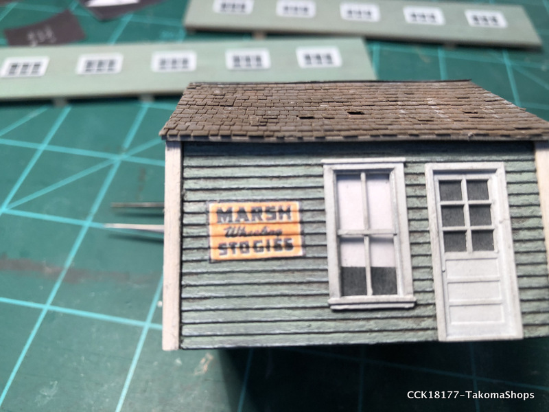

This is what I ended up with.

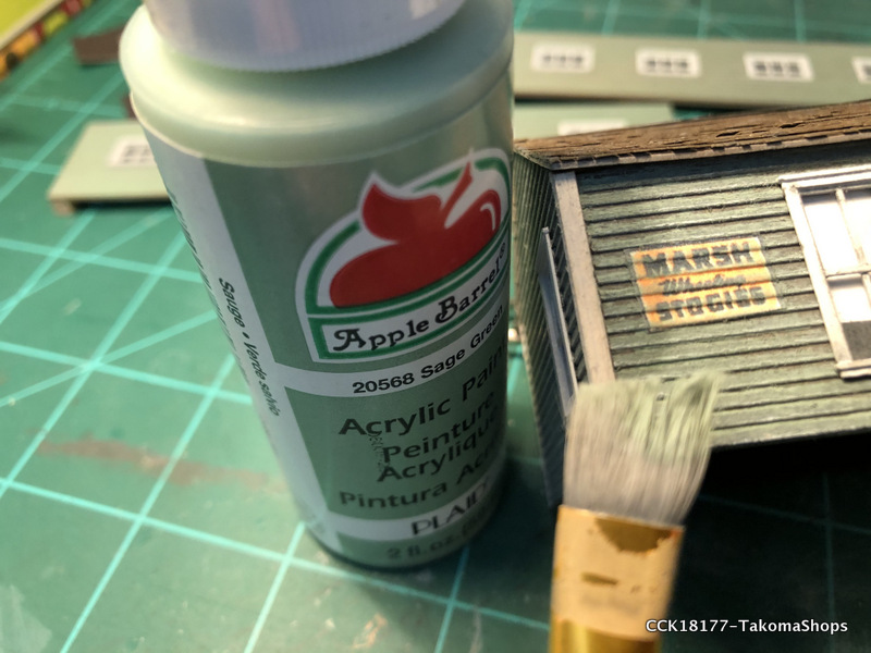

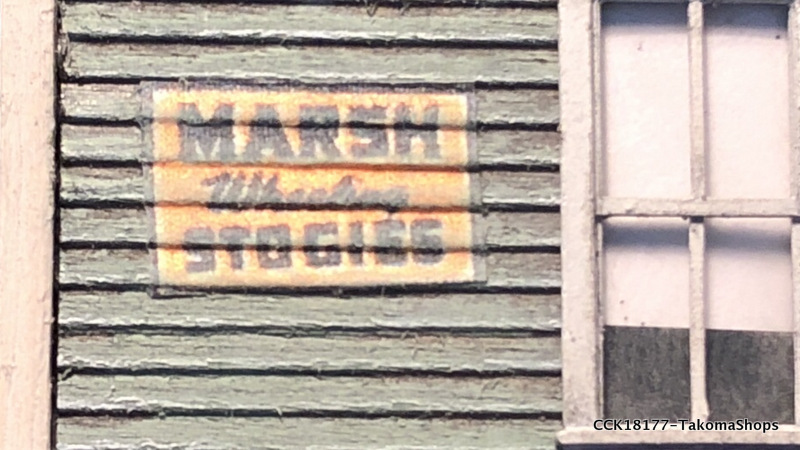

I dry brushed some of the color I used on the wall onto the sign. I did only enough to blend the sign in with the wall.
And this is what I ended with up when done.

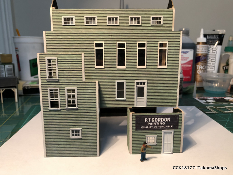

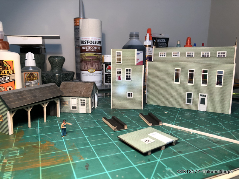

Now I have to finish gluing up the walls of the main building.
It's kinda tricky this main building. The wood walls are not the full height og the building. There are other walls that get stuccoed and then glued to the wood walls. I'll show that once I am caught.

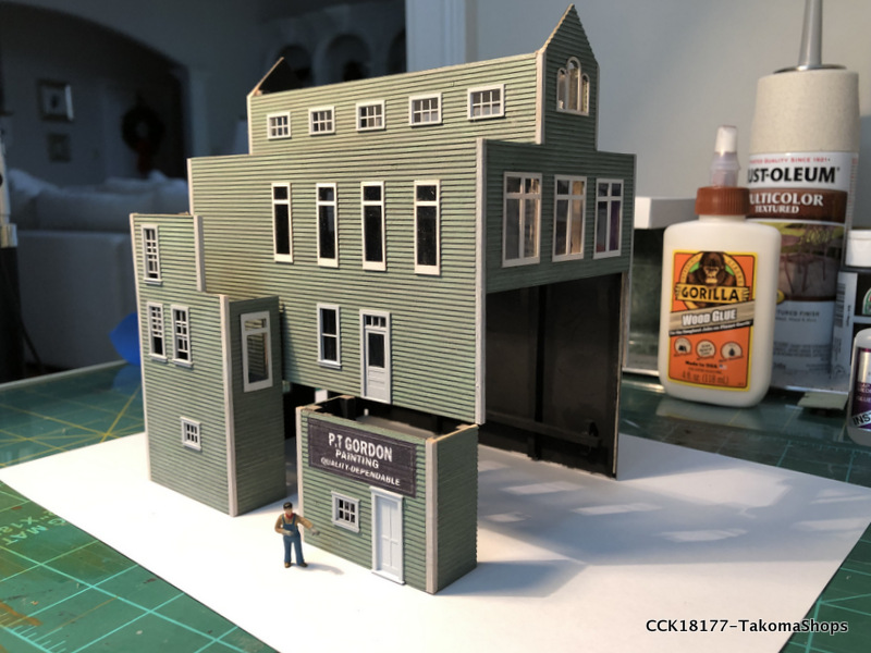

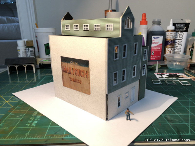

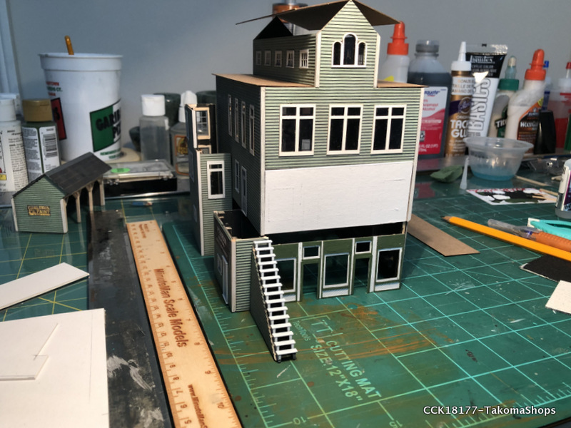

I'm putting all the walls together and my wife says, "It's starting to look like a building."....
I need to work on the stucco walls for the main building. I'm waiting for the spray paint to dry.
Somehow I've jumped around all over the place on this kit. I have not been following the instructions in order. There is guidance on how to do the stucco walls. I am lousy at stucco so I will stick to the instructions for that part.
Later.
Jaime

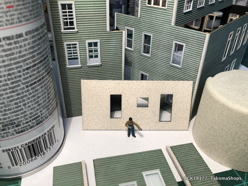

The instructions for this kit say to use Rustoleum Multicolor Textured spray paint "Caribbean Sand". I bought mine at Walmart. That is what I am using. Here is a sample of what it looks like 90 minutes after it's sprayed on a taskboard wall included in the kit.
On the right is the cap of the spray can. In the middle is the wall I spray painted. On the left is the label on the can. This is a photo fo the can.

I've gone to the spray for stucco exclusively. It's quick, easy, neat, and sands nicely.  From my experience you might consider the following:
   1) Shake extremely well and shake frequently during application. The "grit" texture separates quickly from the carrier/solvent, resulting in runs.
   2) To further avoid runs, consider keeping the wall flat during spraying. If already assembled, place the building on its side and do one wall at a time.

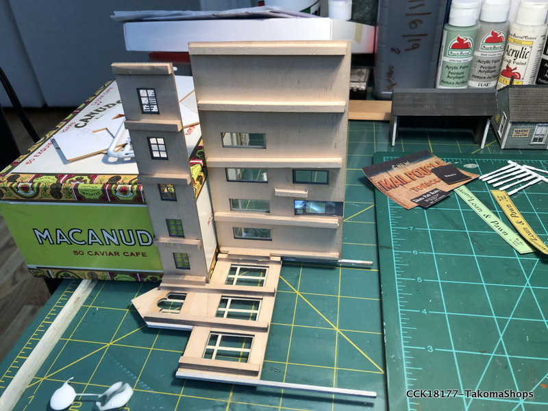

I am mocking up the walls for the main building.
More as it develops.
