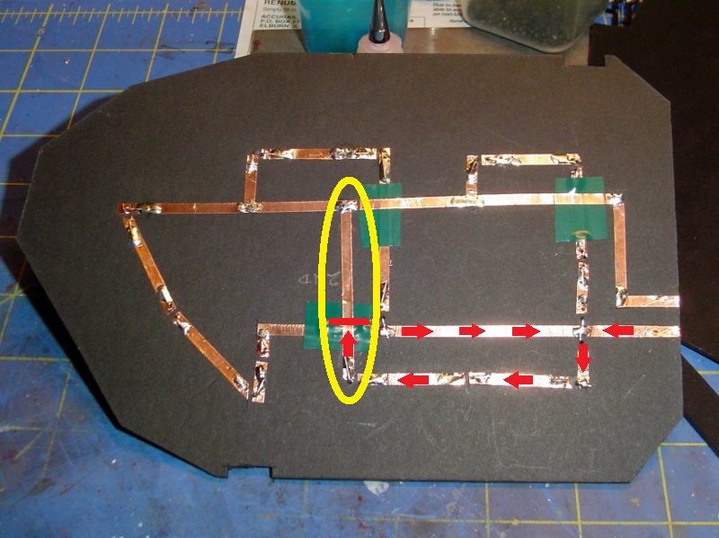

Okay Dave,  :D here you go.

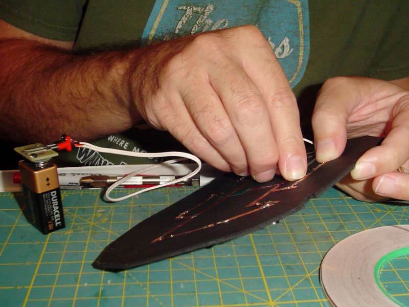

My 'debugging' process is as follows:
1. I take the handy, dandy little LED tester that I bought from Slim and attach a length of wire to it.  I then touch test each LED in the series, one at a time, by touching the wire attached to the positive side of the tester to the copper tape on the positive side of the LED and, of course, the wire attached to the negative side of the tester to the copper tape on the negative side of the LED.  If the LED lights up that tells me two things.  First, I didn't cook the LED when I soldered it in place and, second, that my connections are sound.
2. Next I want to test to make sure the connections to the Current Limiter are sound.  At this point I already know the first LED works so I remove the wire from the LED tester and take the tester off of my 9 volt battery.  Using some clamps I connect the wire directly the battery posts.  It then touch the wire attached to the positive side of battery to the copper tape on the positive side of the Current Limiter and the wire attached to the negative side of the battery to the copper tape on the negative side of the first LED in the series.  If the LED lights up that confirms that my connections to the Current Limiter are sound, the Current Limiter is okay and didn't reverse it when I soldered it in place.
3. Test the entire series in a fashion similar to step number 2 but this requires more than a 9 volt battery when you do like I did and have three LED's in series with the Current Limiter.  If the series works then the problem is something like what I did.   ::)
My apologies, I forgot to take a "before" photo.  Here's a photo of the circuit after I corrected the issue.  The yellow circle indicates the repair I made.  The red line indicates where had originally connected the negative lead of the last LED - right back to the positive line in.  D'uh.  The plan was in my head when I was wiring everything and I knew where it should go but I failed to execute and connected it to the nearest line.

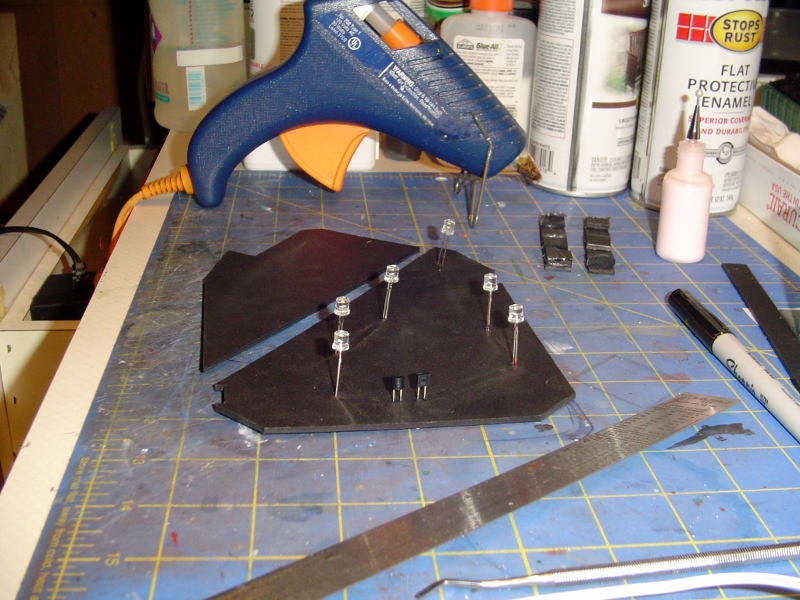

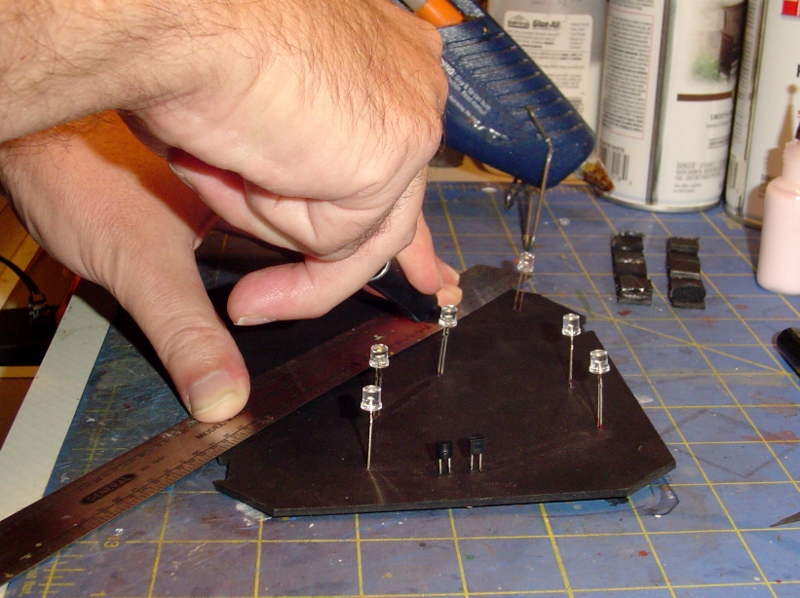

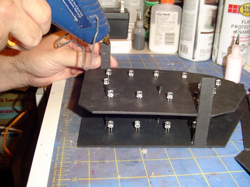

Using a hot glue gun I connected the three "ceilings" together.

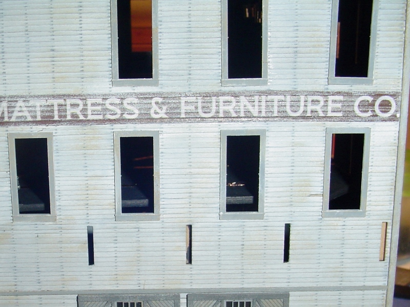

When I put the assembly in place I noticed that the lowest ceiling was clearly visible in the second floor windows.  My measurements were off a wee bit.  This was partly because the bottom of the second floor windows are almost at floor level in the overhang portion of the structure.  There's not a lot of room for error.
I broke down the assembly and, as luck would have it, noticed that where I cut the notches for the supports was perfect for allowing me to trim off the piece of bottom "ceiling" that was going to extend out over the overhang. I did that, which will allow me to drop this ceiling down a little lower and clear the bottom of the windows.
More in a moment... :D

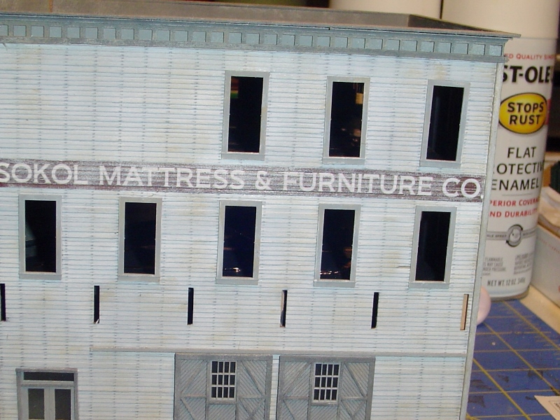

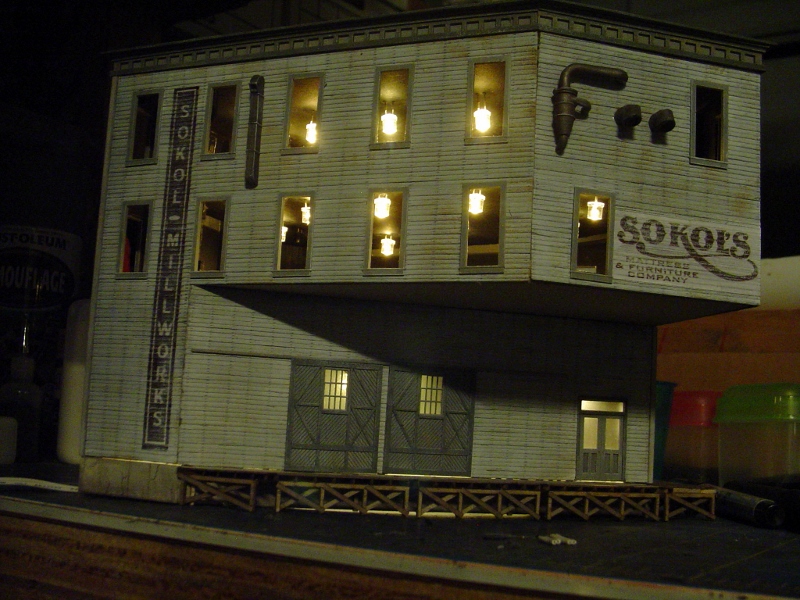

The ceiling is no longer visible in the window.   :D
And here we are with the inside lit up.  The window, which aren't in place, have been sprayed with DullCoat to dirty them up a bit.
I haven't started adding the exterior lights yet.  Those will be a bit more challenging.  I plan on adding three gooseneck lights over the large Sokol's sign and several under the canopies to light up the loading docks.  Those will have to go thru the walls and I haven't quite worked out how I'm going to add them yet.
P.S. - I haven't fixed the 'light leaks' yet.  That's on my radar too.   8)
