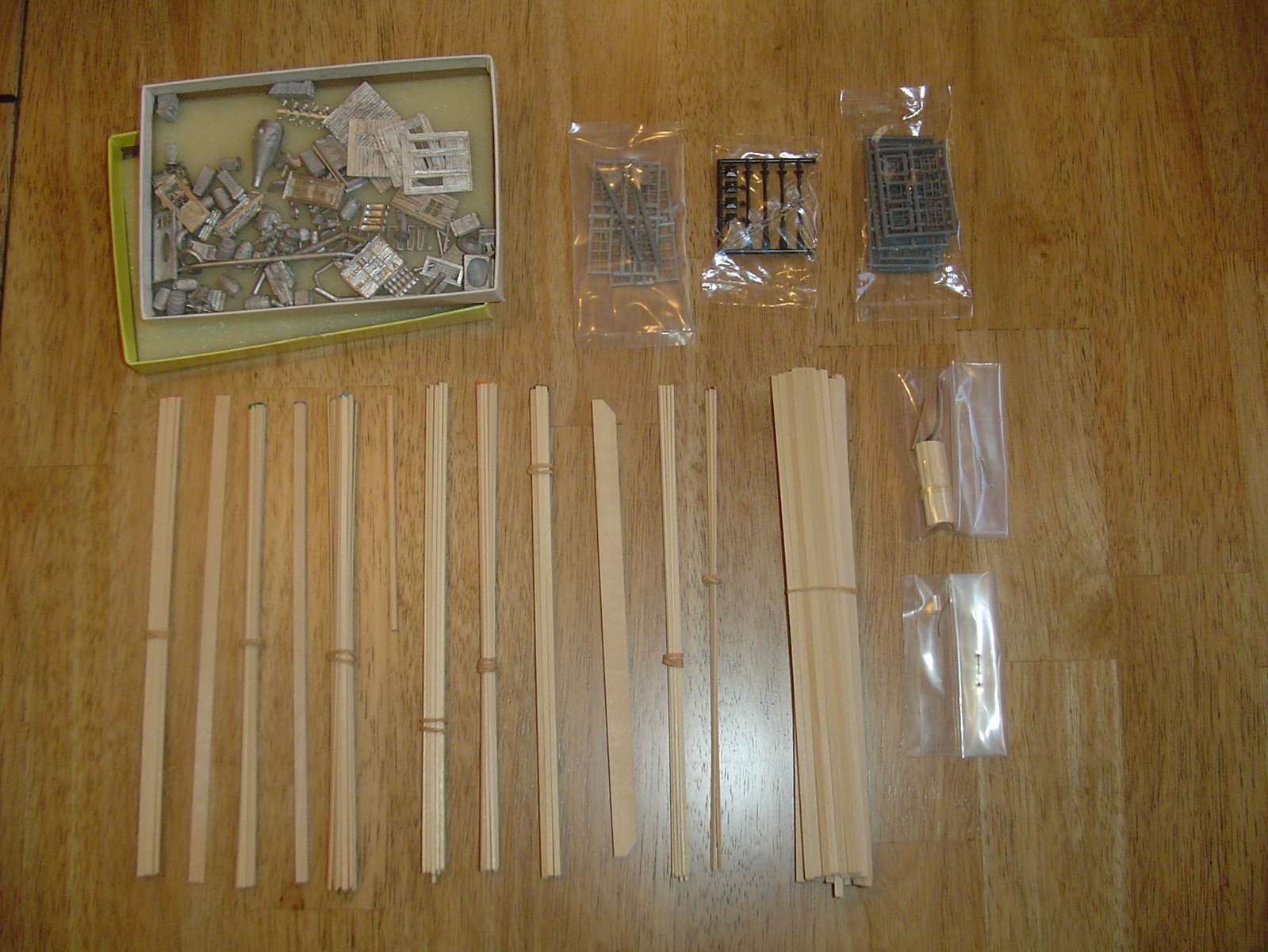

Let's start with the box and it's contents.
Include in the box is a large sheet of color photo's that will really come in handy during the build.
Then there are those wonderful detail castings along with lots of strip wood.
Walls corrugated aluminum sheets and other assorted goodies.

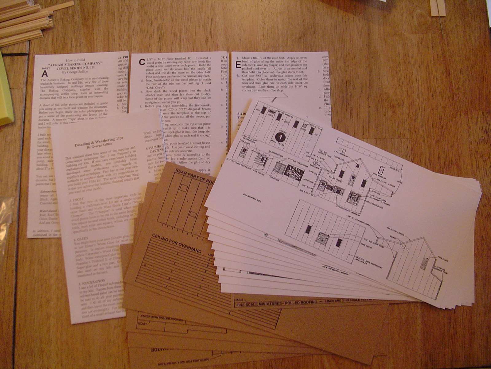

Lots of templates and roof cards.   :o

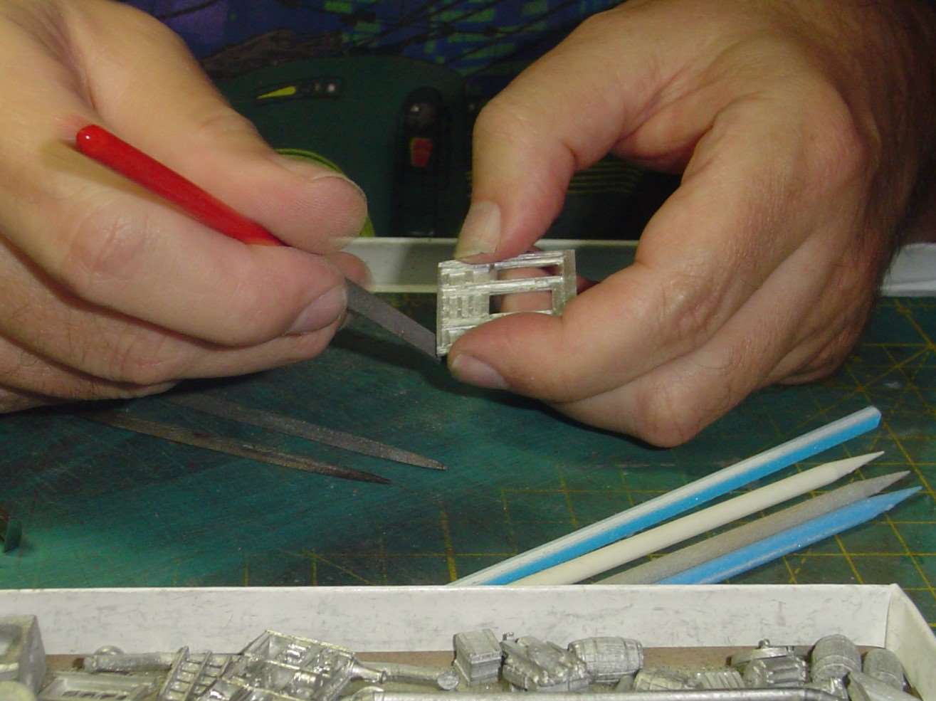

First thing I tend to do in a build is clean up and prep the castings for paintings.  For the plastic castings this involve removing them from their sprues using a sprue cutter.

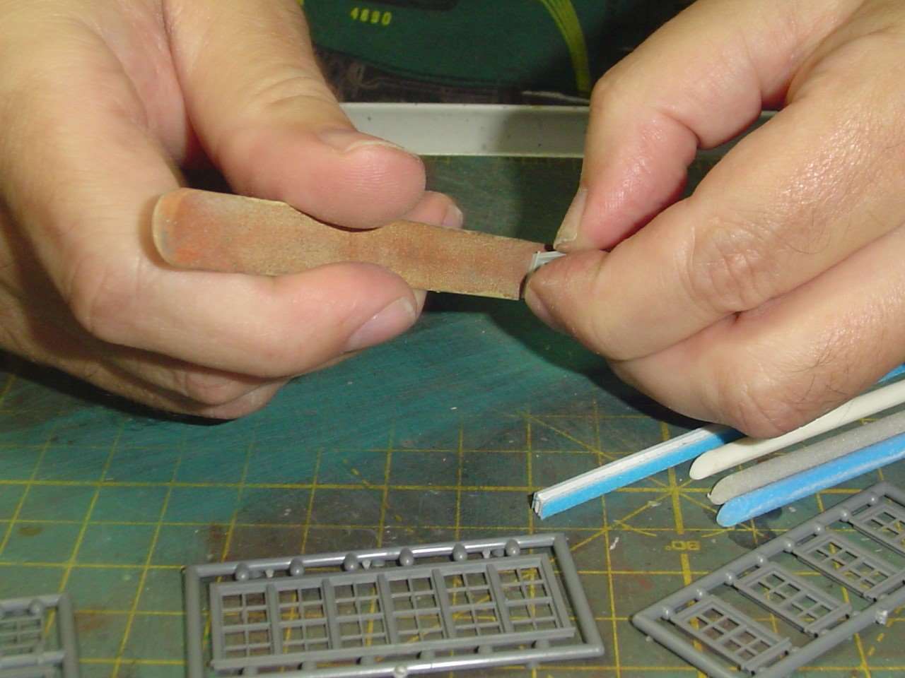

I clean up the edges (although the sprue cutter does a pretty good job) using an emery board.  Just a couple of swipes is all that's needed.

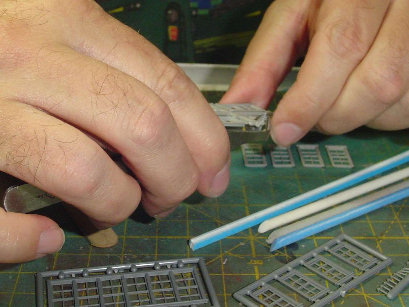

The metal castings require very little clean up.  I use files, emery boards, sanding sticks, etc. to clean up anything that needs to be cleaned up but there really isn't much to do here.

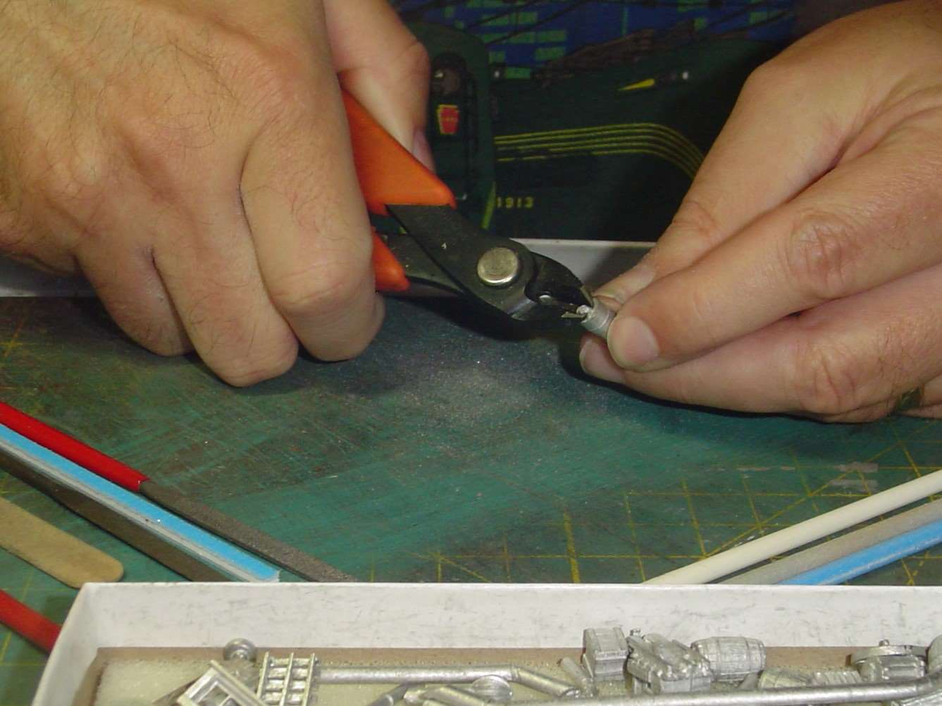

In the off chance I find a bigger chunk that would take a while to file away I use an old pair of rail nippers to knock of the biggest part of it before filing it down flat.

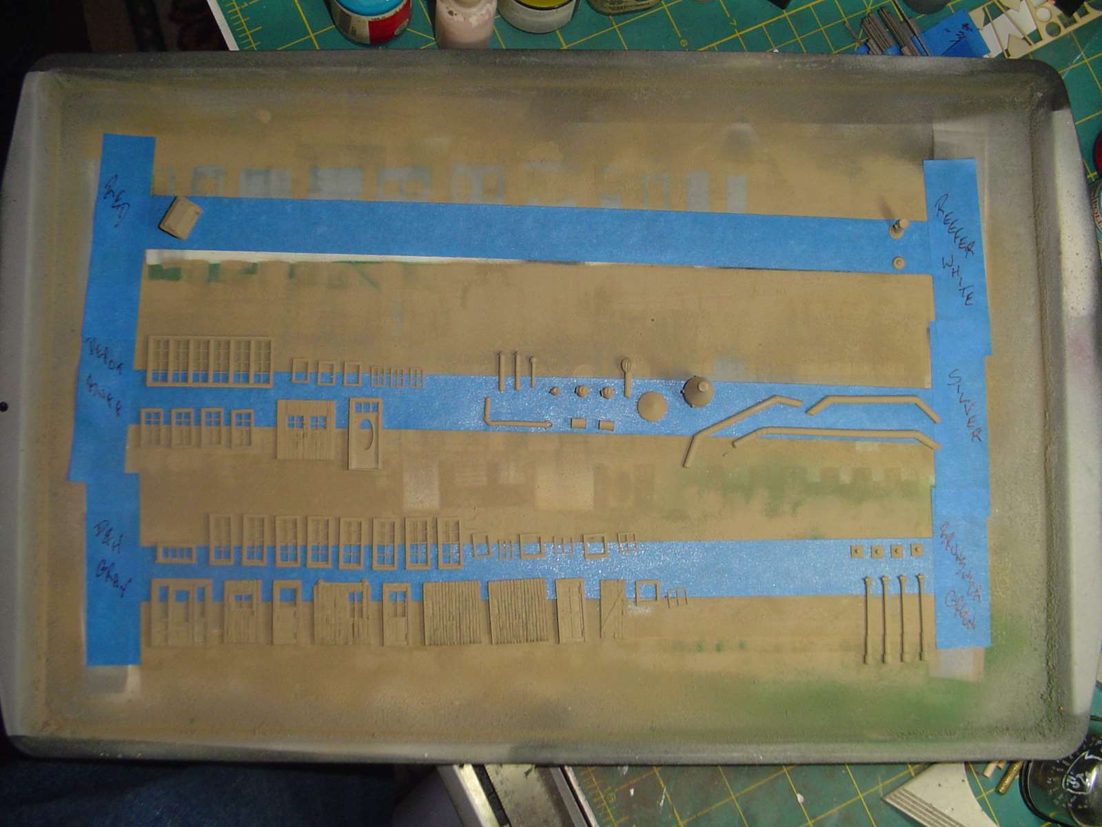

Skipping ahead little bit.  I put everything I want to airbrush on a metal tray using some strips of painters tape taped upside down (sticky side up).  I've already done that and primed everything.  At this point I picked out the parts that I want to paint specific colors with the airbrush and grouped them together along with a not as to what color I want to use.  When I paint them this way I'll use paper towels to cover up the parts that I don't want painted the current color I have loaded in the airbrush.
That's pretty much where I'm at at the moment.  This will be a marathon rather than a sprint but I'll update it as I make progress.
