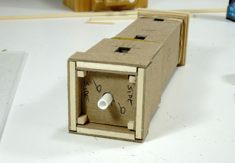

Even though I'm using the RSM block sheets here, I first made the carcass of four sides with .050" chipboard. I didn't want to rely solely on the finished block sheets for strength. I also need to miter all edges, and insert a tube to carry the power wires to the light.  So they'll be laminated to these pieces.
Rough mock-up...
Additional strength with 1/8" square corners...
Building out the base thickness to match the prototype....
Dressed the top with 2 levels of borders....and prepped the window cut outs...nothing glued...rubber bands only.

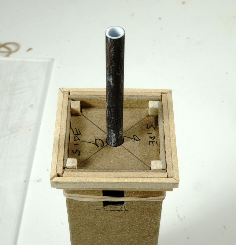

carl b
The very small windows for the tower are N scale version Tichy, with the original muntins cut away, and a single vertical bar I inserted in the middle.
I made 4 square bracing blanks from chipboard for the interior. They also hold a styrene tube in the center to carry the lantern light wires. I won't glue the four sides together till later.
The top of the tube was run long for measurement purposes, previously painted because it's a cut off from another project. Will now begin the lantern assembly....

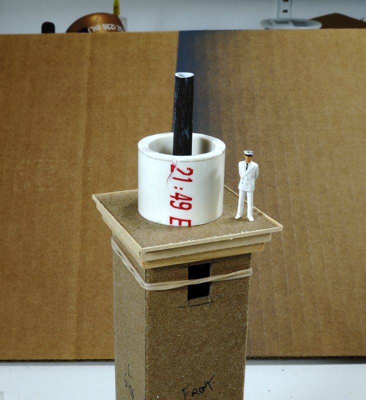

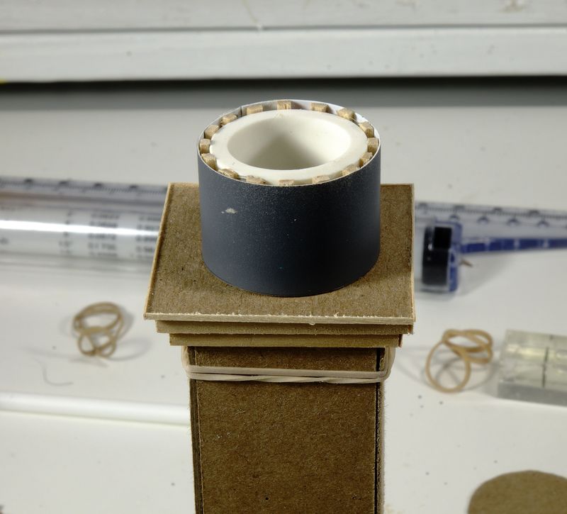

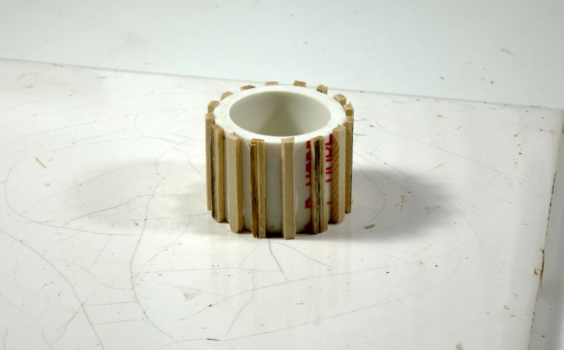

The lantern "clockworks room", housing the mechanism to rotate the light, is a slice of 3/4" pvc pipe. In HO scale, it's 6 ft high and 7.5 ft. in diameter.
The outside diameter (actually a bit over 1") wasn't quite big enough, so I added some blocking so I can "skin over" it with some thin sheet styrene.
Now with primer gray.

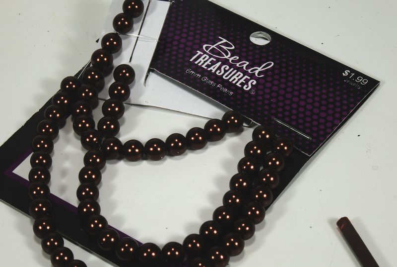

A trip to the craft store for these wood balls (labeled "dowel caps"), which I will have to cut in half to become the top of the dome.....They were out of stock on the "half split balls". GRRR.  No, I couldn't buy just one.

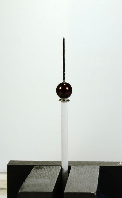

And this cheapo necklace, which has a string of plastic 5mm balls, for the evaporator ball....
Putting it together, a styrene tube (which will be cut super short), a jewelry ring, a 5mm necklace ball, and a needle. Bathed in CA glue. It needs a paint job...
