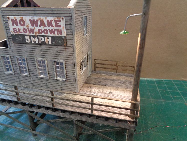

Now that the walls are together and square, it is time to consider the signage for the structure. The large "No Wake" sign appears to be porcelain and not one painted on the wall. A sign this big needs to be supported/fashioned to the wall in some way.
I started by weathering the sign on the sheet and then cutting it out. I wanted to add a stiff backing so I used 3M transfer tape and glued the sign to a piece of heavy cardstock.
I chose to use N&B casting for securing the sign to the wall. I painted four a rust color and let dry. I said four just in case one of the little suckers gets loose and on the floor somewhere. :-[
I also used the transfer tape to secure the sign on the exterior wall. I used a #78 drill bit and drilled a small hole in each corner of the sign. I then glued the N&B casting in the sign holes.
There are also two red "GAS" signs. They were a little light so I used a carmine red leaded pencil to darken the red. You can see the difference in the next photo.

It's truly amazing, how much the small details like nuts attached to a sign, make such a huge difference to the overall look of a build.

Another great looking build Tom.
-Steven
Steven,
Thanks for stopping by. Yes, small details can really change the entire look of a structure.

i did finish the main dock railings and added a light pole with an LED for night fishing.
The light bracket still needs paint.

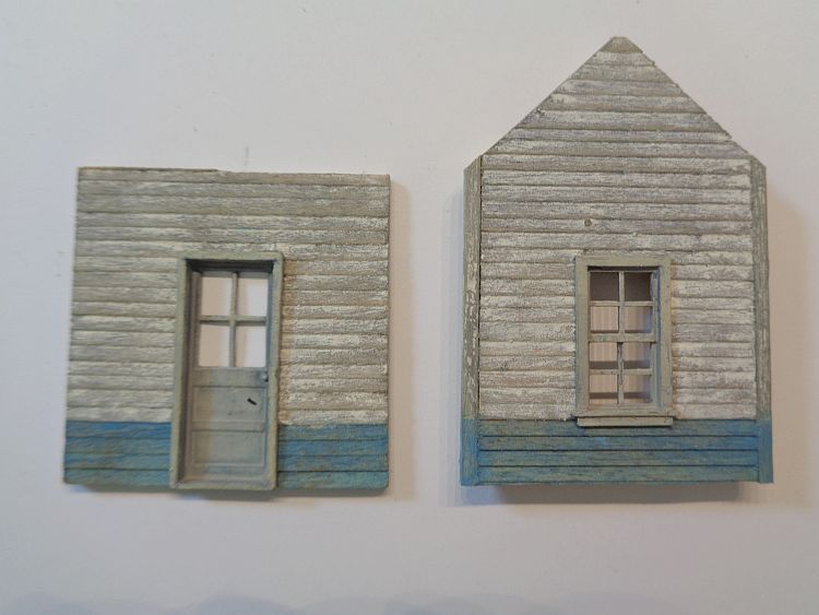

I also scratch built a small office for the smaller dock. This dock will have the gas pump on it. Much work still needs to be done on this dock.
On the small office walls, I used thinned Floquil Reefer White. I thinned it to the point of pretty much being a white stain. 80% thinner to 20% paint.
I used this on the walls along with some thinner on the brush. I then dabbed the walls, exterior side down, on a paper towel. I wanted the white off the outer edges and not from the inner edges.
When paint fades and peals from a sun exposed area, the outside edges get the main break down of the paint. Right or wrong, this was my thought process for the walls. I think they came out just right as planned.
Here is a close up of the walls and faded paint. To me this looks more natural vs. the blotchy look..
