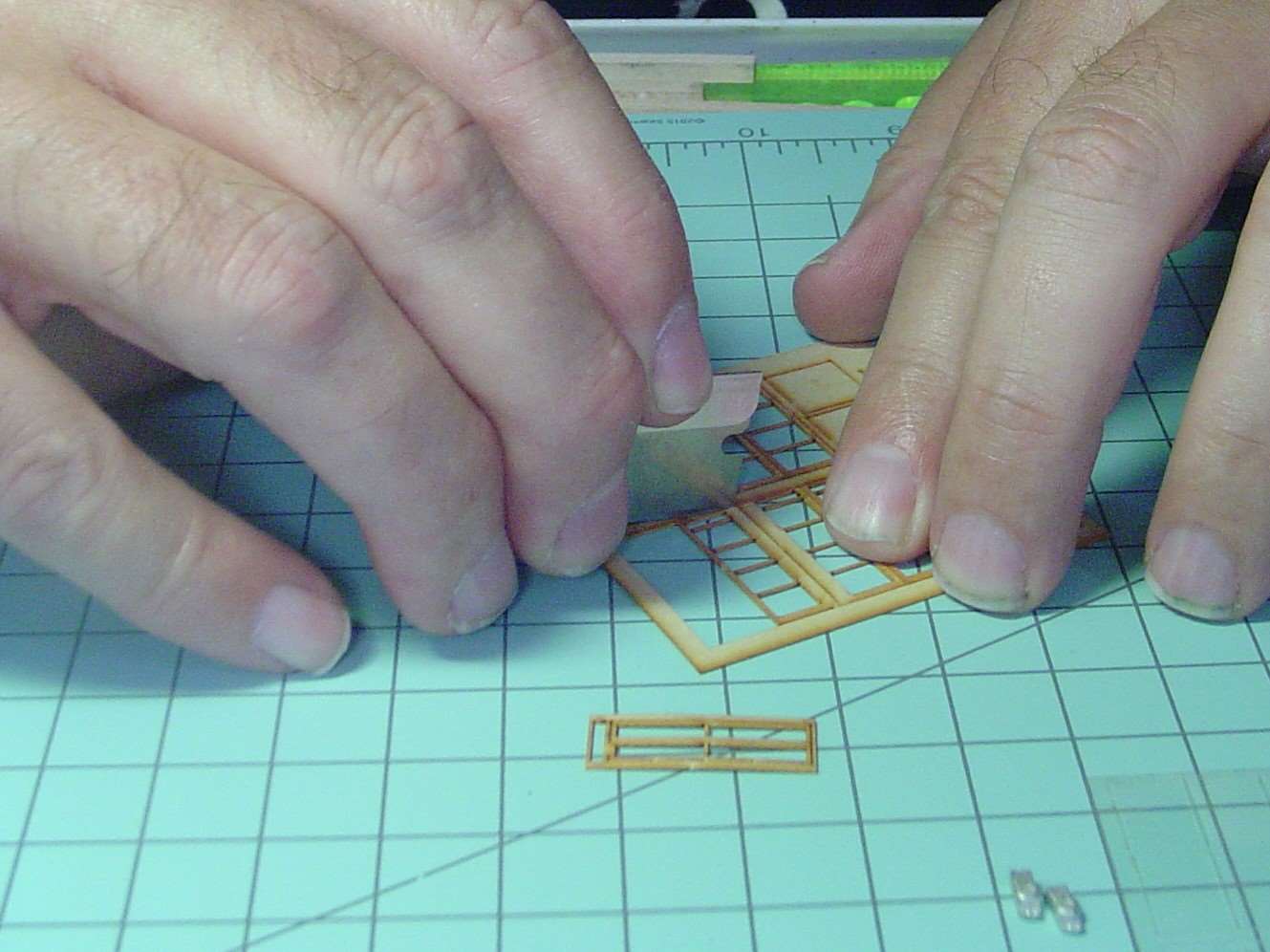

I started the build by carefully removing the parts from the carrier sheet using a single edged razor blade.

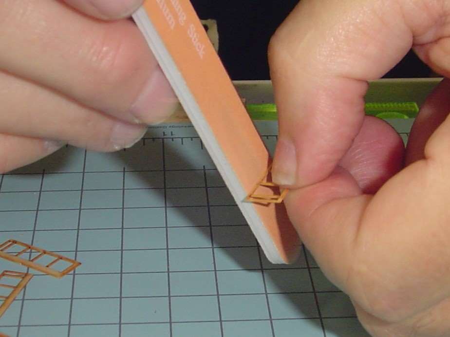

I used a medium sanding stick (I purchased a set of these at Hobby Lobby) to smooth the edges where the cuts were made.
A flat metal file was used to smooth the bottom of the telephone castings.

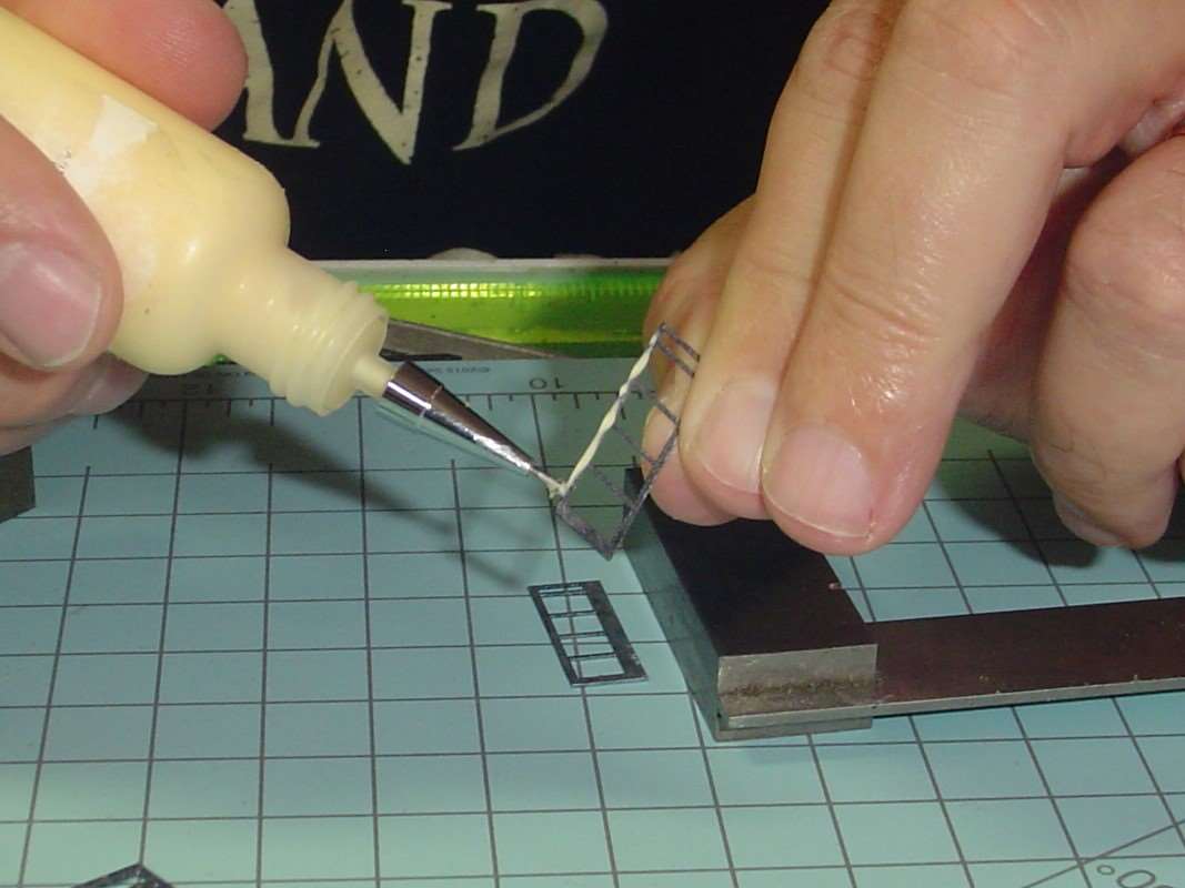

I then started gluing the sides together being careful to orient them so the correct side was facing out.  My Pink Flamingo glue is getting to old so I switched to Titebond.  I couldn't find Pink Flamingo glue on the Northeastern Scale Lumber website but they typically don't ship it in the winter months because it's susceptible to the cold.  That looks like a lot of glue but I'll take care of that.
The next step it remove the excess glues by drawing my finger along the front and back.  I keep a paper towel handy to wipe the glue off of my finger before handling anything else.

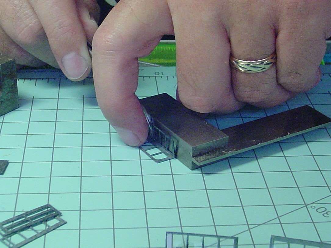

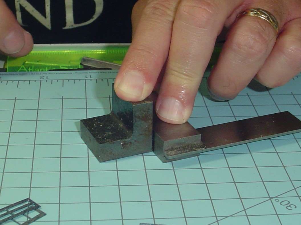

Then I put the part in place with its mate and used a square to make sure the edges were lined up.
Another small square keeps everything square until the glue sets.

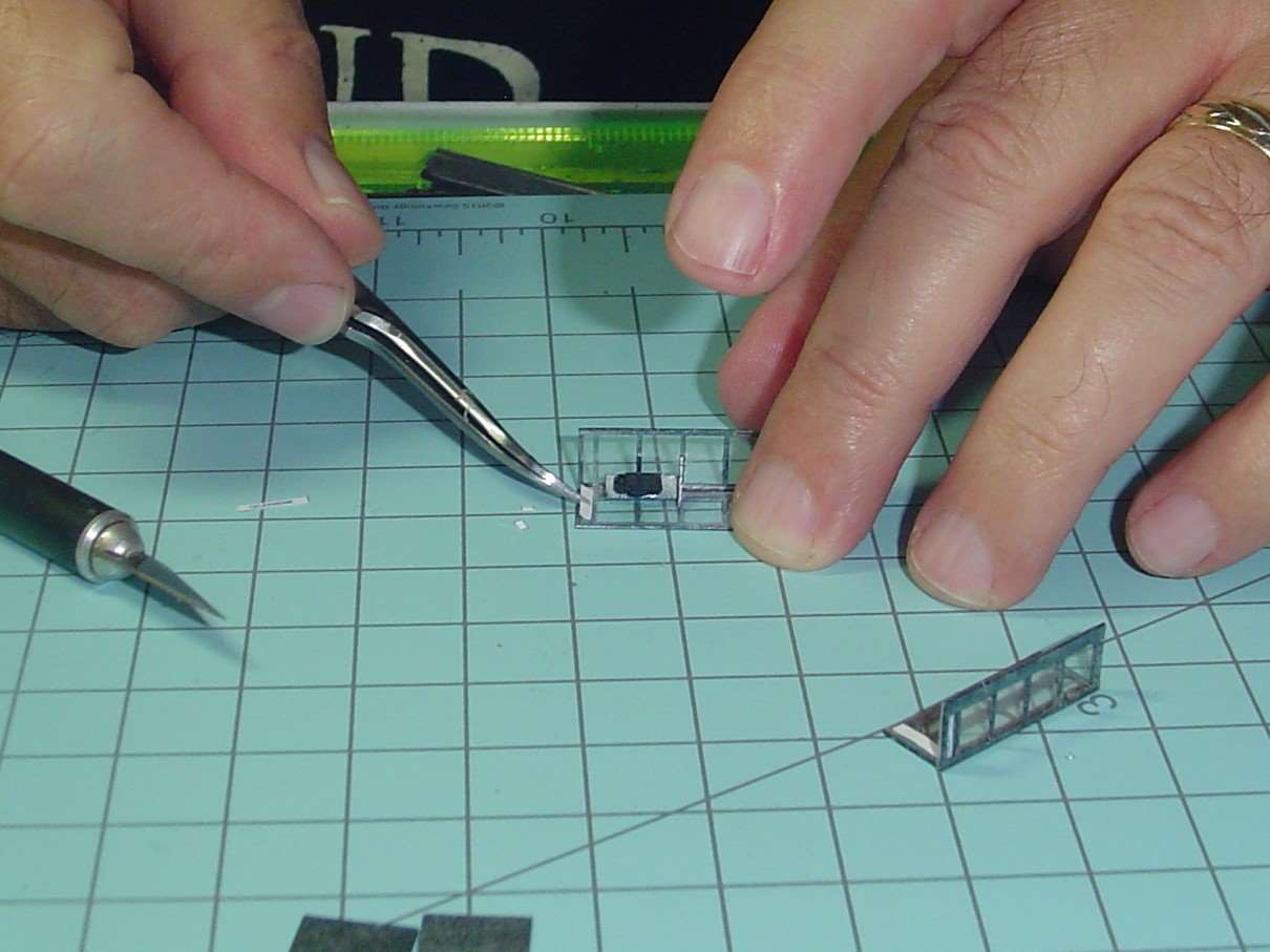

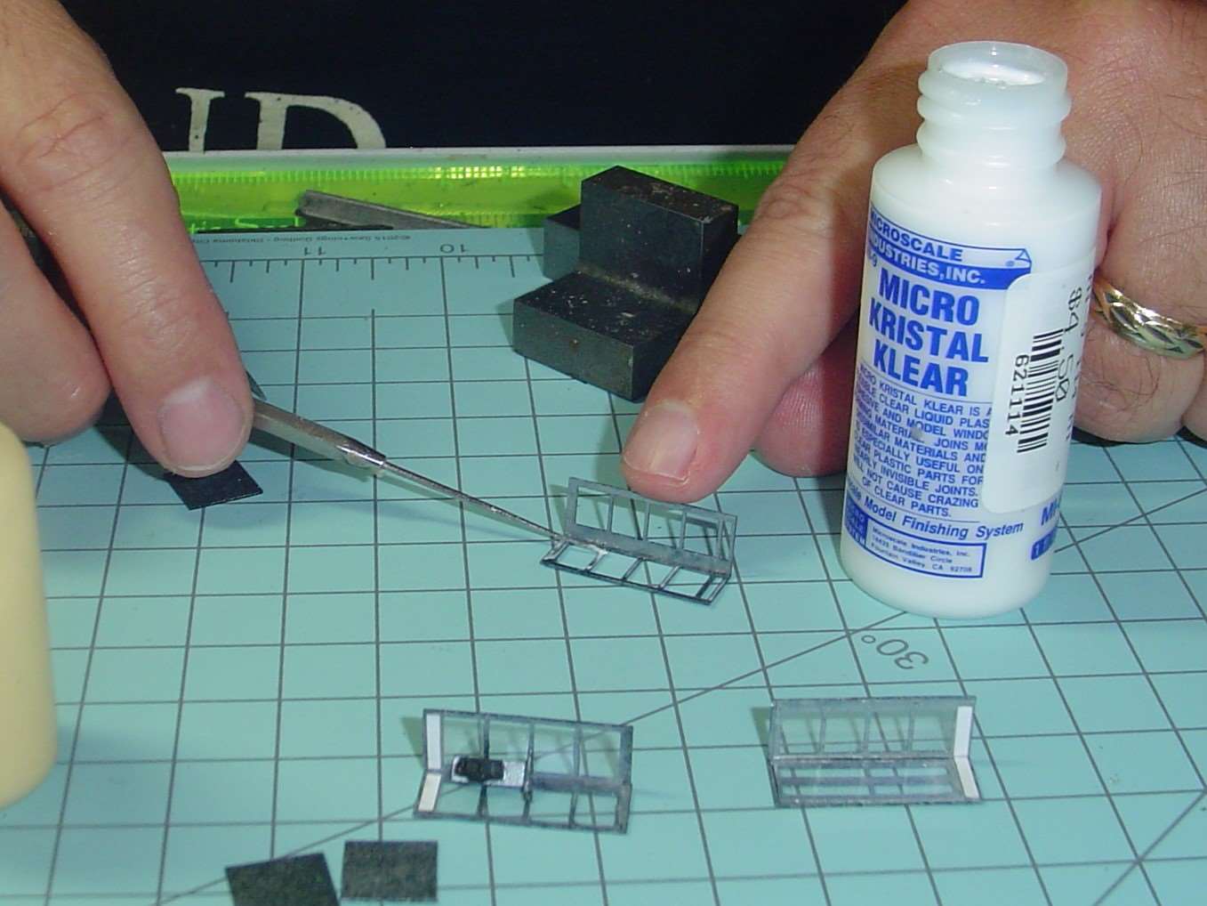

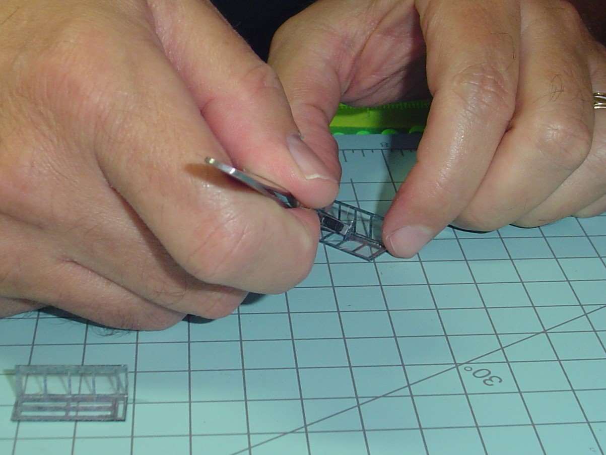

You make two halves of the phone booth that way and when glue had set you can then glue the glass in place.  I used a very sparing amount of MicroScale Industries Micro Kristal Klear for glue.  If I screw up and use too much or get a smudge on the glass (acetate) where I don't it I remove the glass (acetate) and scrub it with q tip dipped in isopropyl rubbing alcohol to clean it off and start over again.
More in a moment... ;)

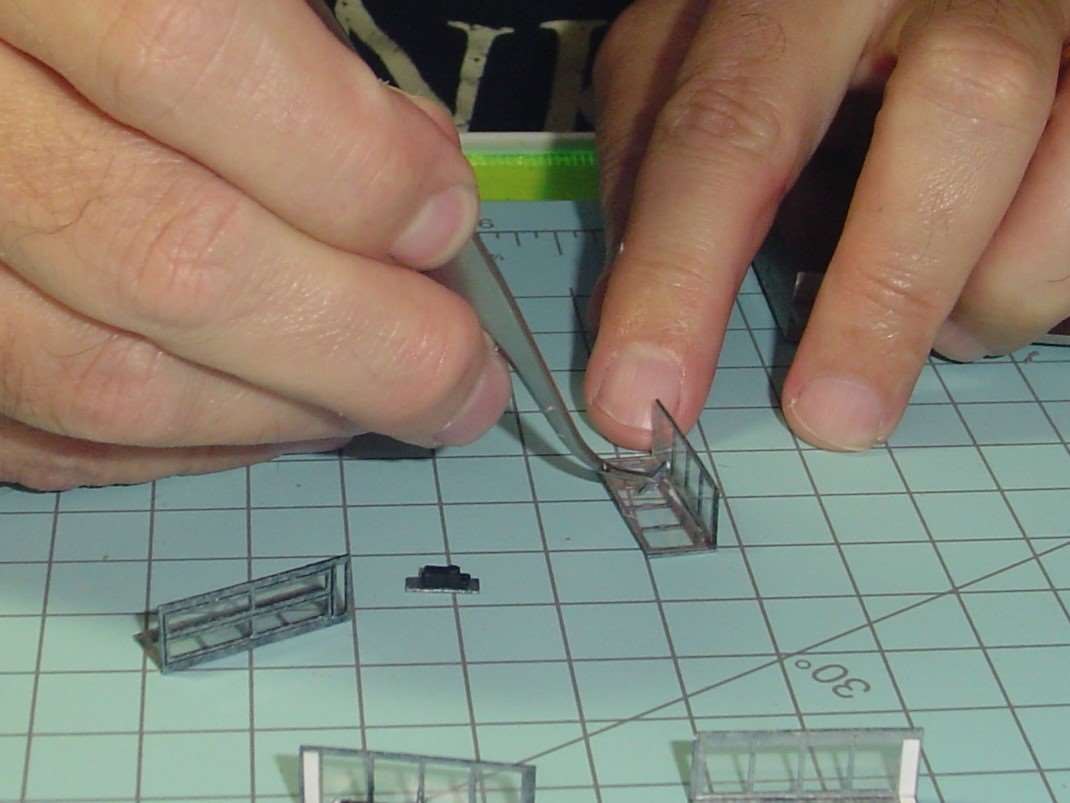

Next the glass gets carefully positioned in place.

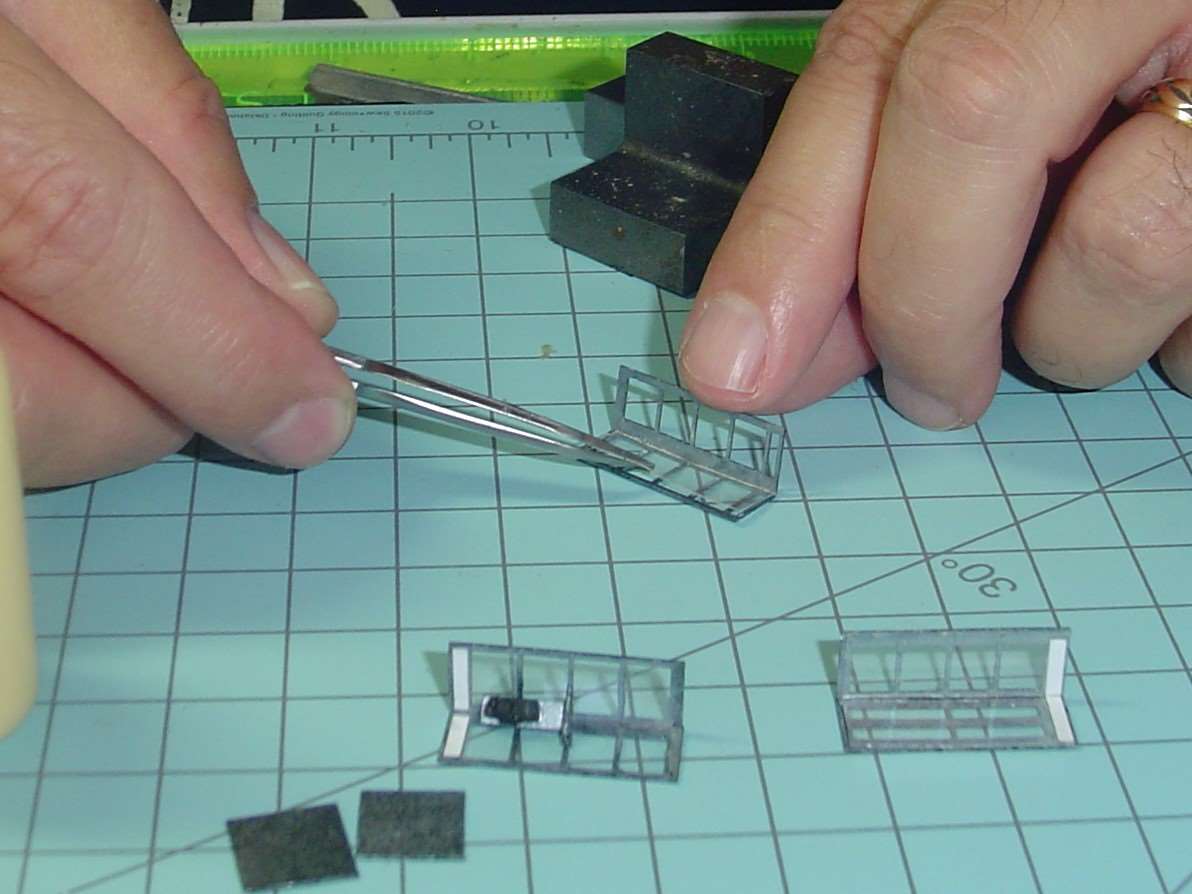

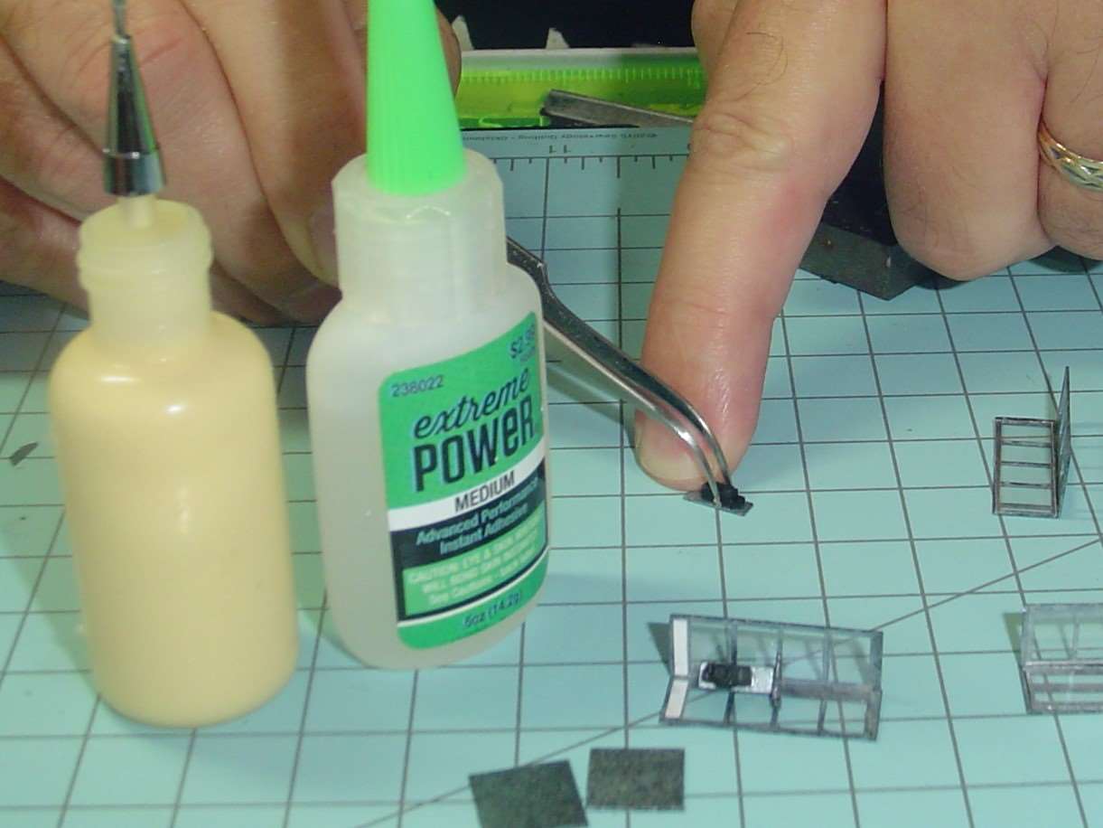

I glued the telephone casting to the backboard with a little bit of medium ACC.
Then the shelf gets carefully glued into place.  This step was a little nerve wracking and required the Optivisor.  I used the Kristal Klear for this.
Then the backboard/phone get glued into place on top of the shelf.

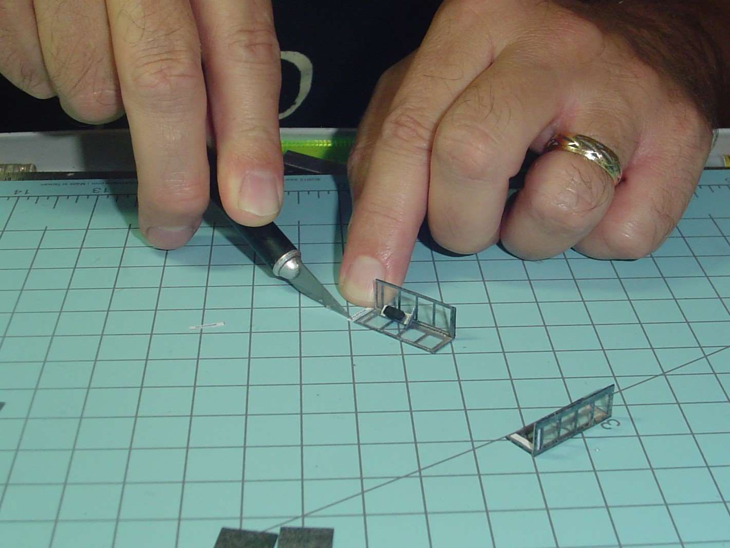

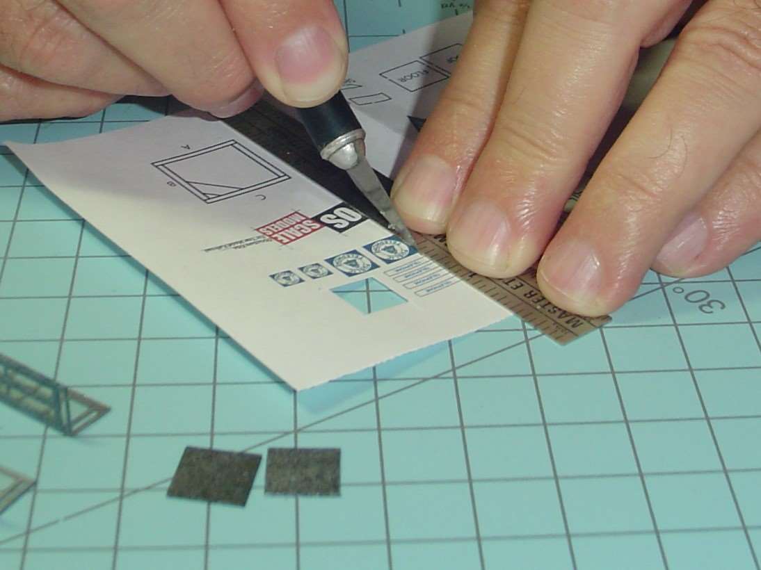

The little TELEPHONE signs are cut out using a steel ruler and a sharp #11 X-Acto.
The TELEPHONE signs have to be trimmed to fit over the opening so that the word is centered.  A little bit of each edge will do it.

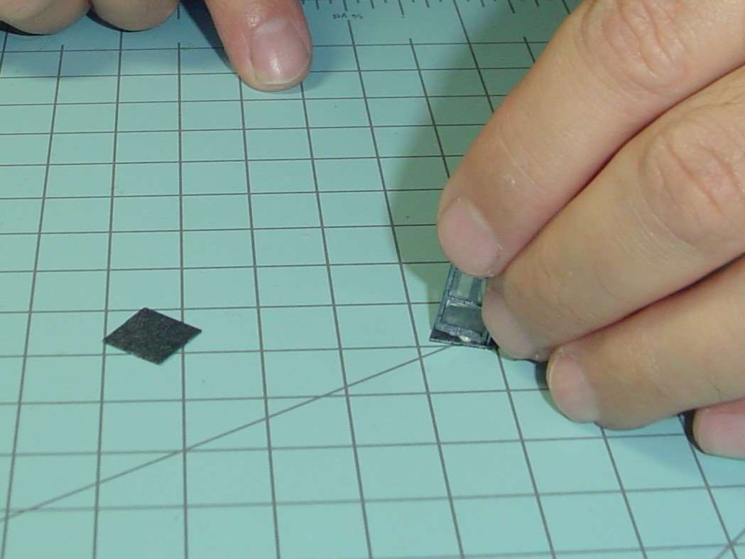

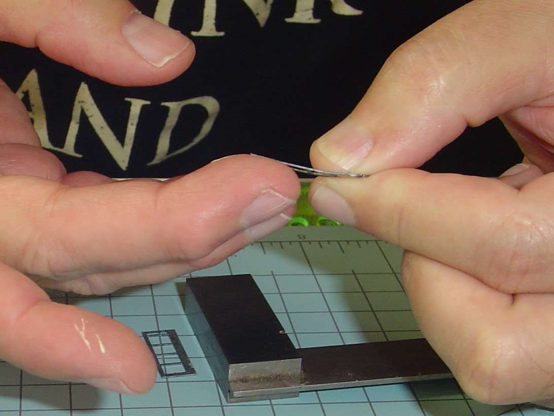

I used the tiniest bit of Kristal Klear at the end of each TELEPHONE sign to glue it into place.
The two halves were then glued together and then the floor and roof were glue in place.
