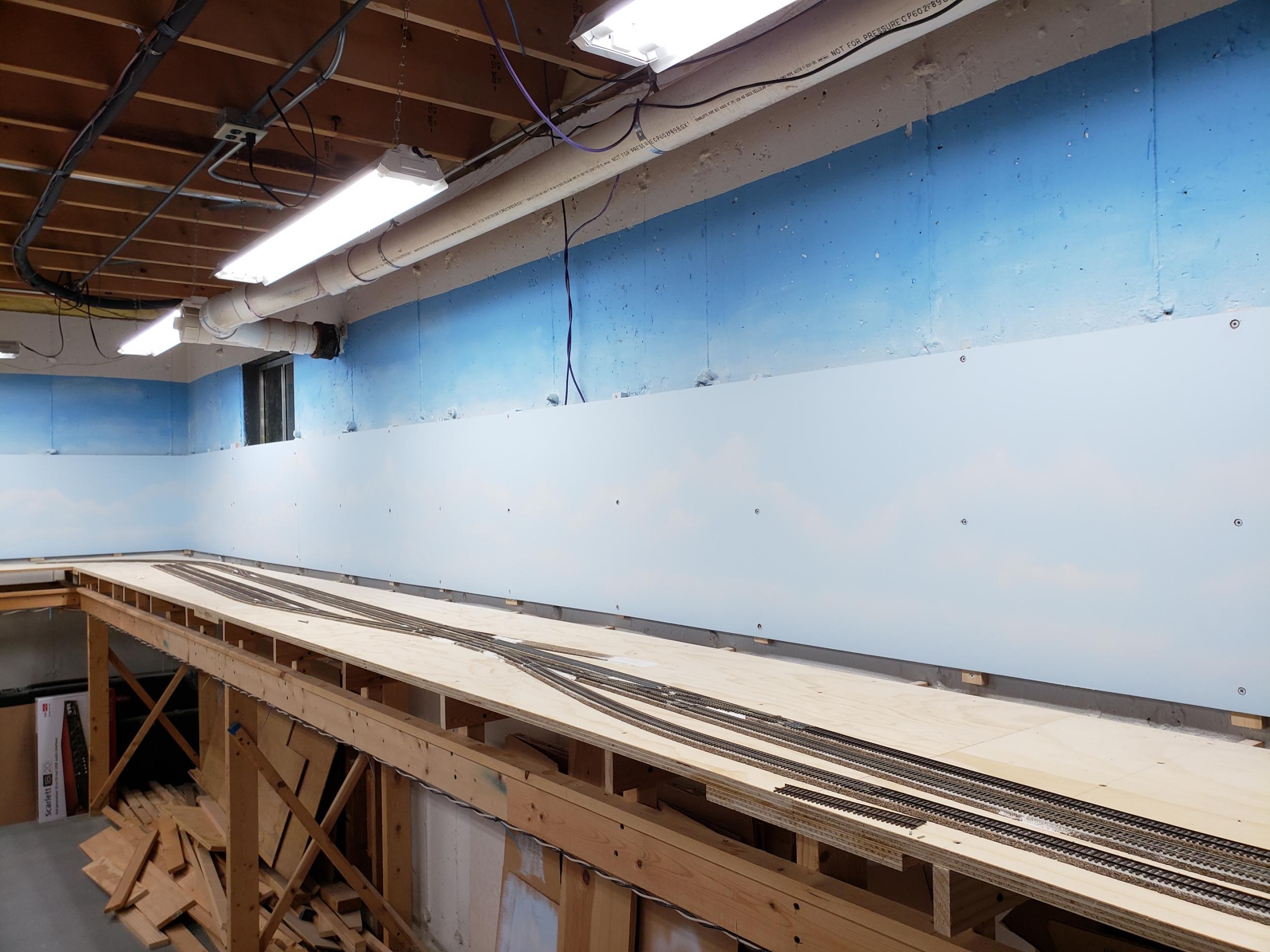

I know this is a thread about Monee, but as long as the whole backdrop thing came up (came down, actually....) I thought I would post a few pics of the backdrop progress as it is happening. It is also a good excuse for me to take pictures and memorialize the process. I guess it will also give you a tour of my basement. Here's the north end of Indian Oaks - next town south of Manteno:

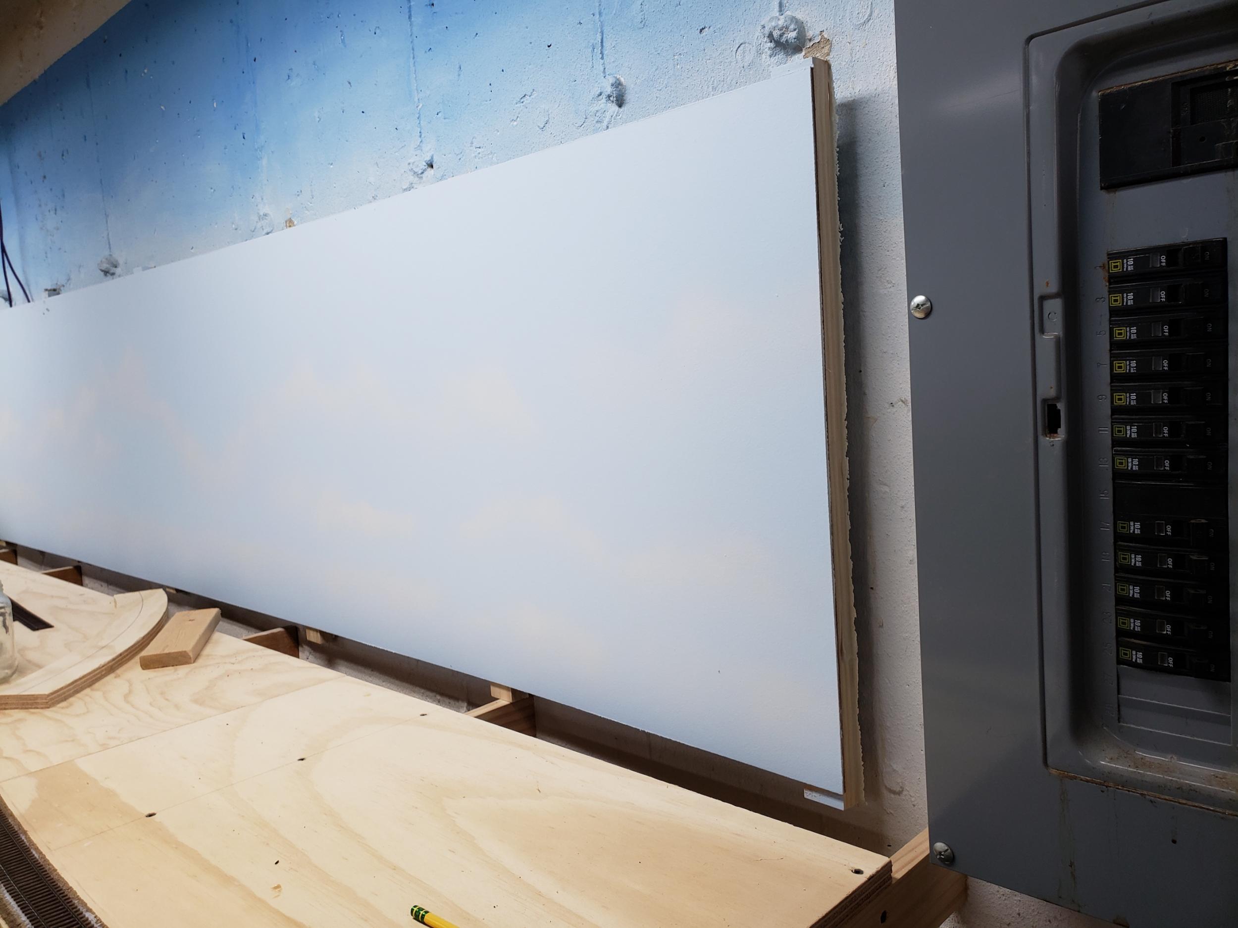

Immediately to the left is the circuit breaker box that you saw on the right above. As you can see - glued and screwed. Here's a longer shot of Manteno:
You'll notice that the double track main is close to the aisle here. You can also see a left-hand turnout on the east-most track. That will lead to a substantial switching district here. The plan is to plunk down a few zillion of my kits here. This is the "lancing" part of my protolancing.
Working with a contractor is nice. Aside from the fact that he actually knows what he is doing, it gives me an excuse to be in the basement (helping hands now and again) so I get other stuff done - right now, I'm trying to get caught up on the big wiring job that remains for much of the railroad. You can see my DCC 12 gauge twisted pair bus just below the nearest L-girder.
