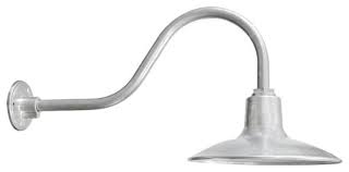

martin.ojaste
Ok, through the air it shall be.
I guess it has to be two strands tied to glass insulators on both ends. Then would they have pipe/conduit at the building side to feed it into the building on the first floor?
Also, where should the magnetic wire come out of the lamp shaped tubing? I assume a hole in the bottom edge with a loop to the insulator is the most realistic. I thought of running the tube through the pole and tiring it to the insulators at that point; while easy to do, it's not realistic.
I figure black epoxy will do as the lamp support mounting bracket unless there is a better way.
