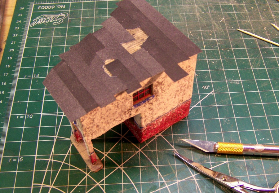

Below is the building with roof paper installed but not yet trimmed.  I allowed two distinct bare areas on the roof where the tar paper blew away.

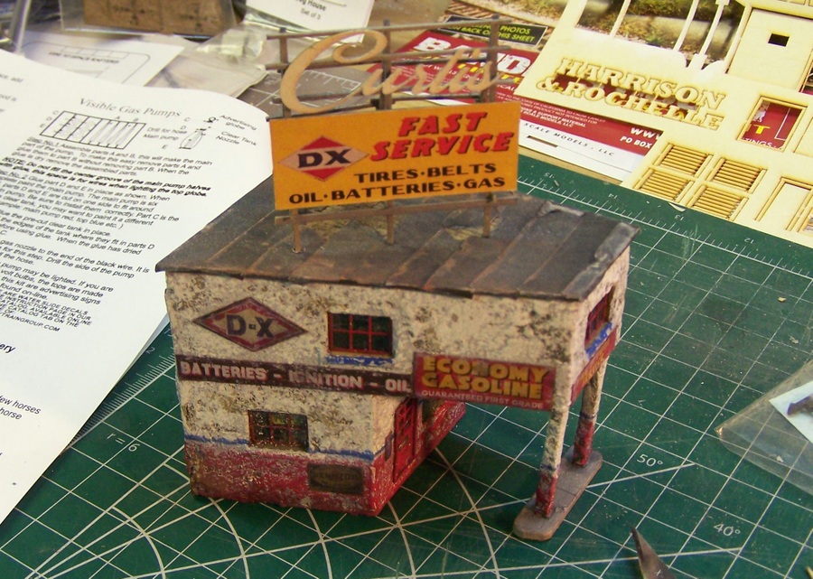

Only had time for a bit of modeling, so I added the rooftop sign.  It will need some weathering and streaking.
We're advertising tires, belts, oil, batteries, with no access to the interior for a vehicle. So apparently all of the work is done outside in the alleys alongside the building. This really DOES resemble a few of those tiny corner garages I remember.  Yes, indeed, this is going to be a hoot to model all of that going on!

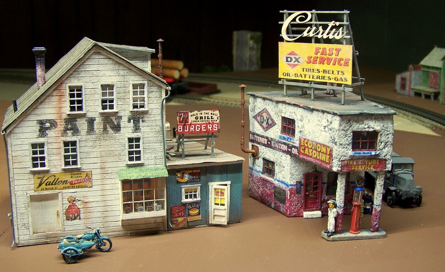

Can't really add other details until I start building the base for the entire complex of structures, so here is the gas station pretty much done, next to Vallon Paint and the burger joint.  I added a Bollinger Edgerly "Skanky Yankee" Gas Station Attendant, currently holding up the front porch column while he waits for a customer or lunchtime, whichever arrives first.  Now I need a name for him.

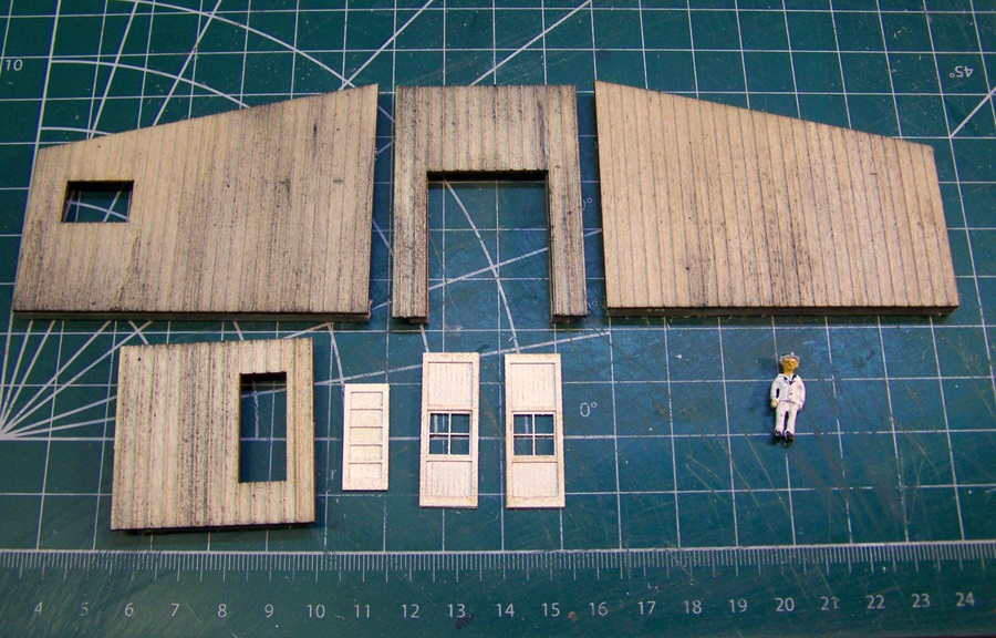

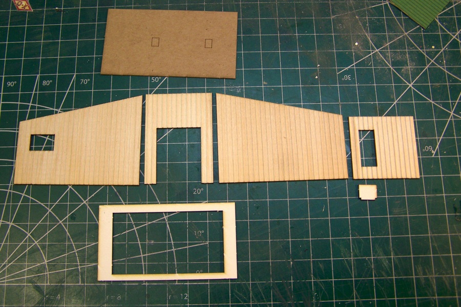

But now I can move on to the Livery building. Doug Foscale describes this as another simple, four wall structure, which it appears to be from the wall pieces.  The walls are not on the larger wood sheets, but rather may be found in the small plastic bag of miscellaneous wood walls.  I also located the roof, the foundation, and a very small porch base.  Everything is laid out in the picture below prior to bracing.
I have them braced and drying. Will post more tomorrow.

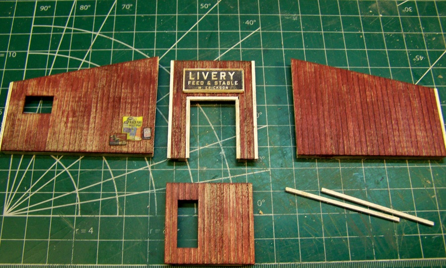

Here are the Livery walls with some distressing using a file card, then a welder's brush, then a wash of A&I.  The doors are sponge painted with white acrylic paint.
For wall color, I chose an acrylic "Deep Wine."  It is a very dark red, but I dry-brushed it on and it stayed relatively light with a washed out look.
Above is one of those weird and rare mistakes in the instructions. I added corner trim per the diagrams, but only after it had mostly dried did I realize that the high (front) end of each long wall did not need it, since corner trim is also applied to each side of the front.  I was able to remove it without a great deal of trouble, fortunately, and sanded the edge smooth.
