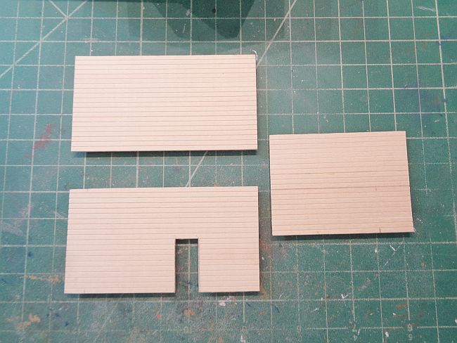

For the walls in the garage area I chose Northeastern Scribed Siding. Mainly due to I had them in my stash.
I didn't notice this but NE now places a thin piece of cardboard between the siding sheets.

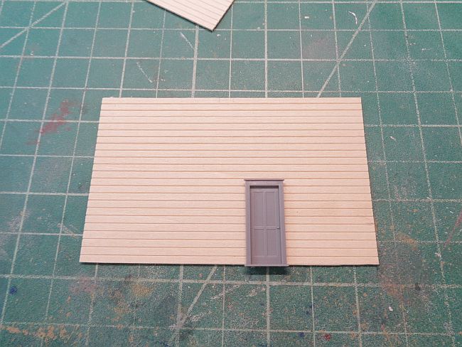

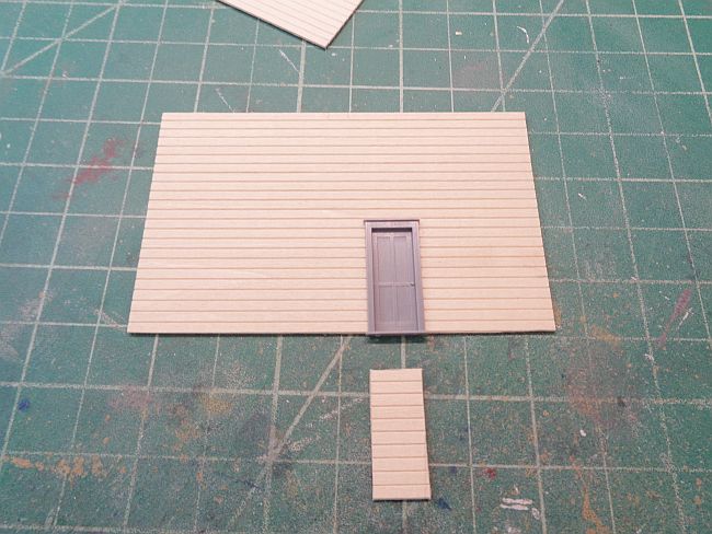

I measured the wall on the right and cut it per my measurements. I found a Tichy door and placed it where I wanted to cut the opening.
Continued -

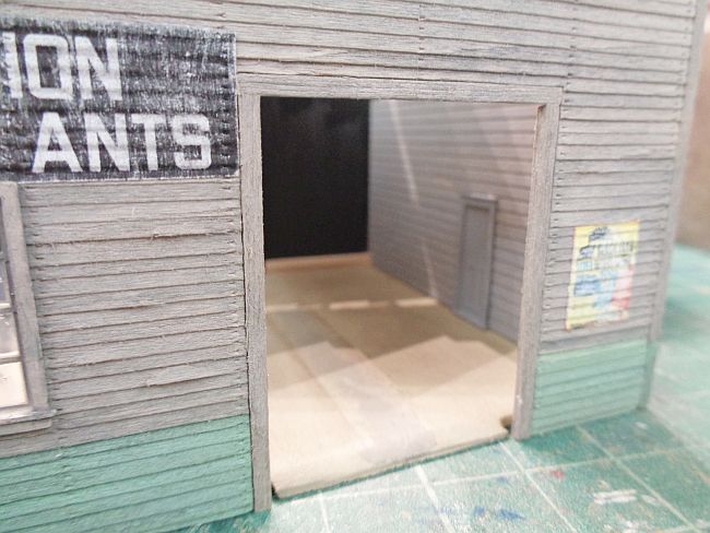

The opening was cut and the door fit.

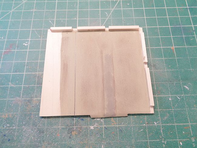

I then measured the floor area where the left interior wall will be located and drew a pencil line on the floor.
Continued -

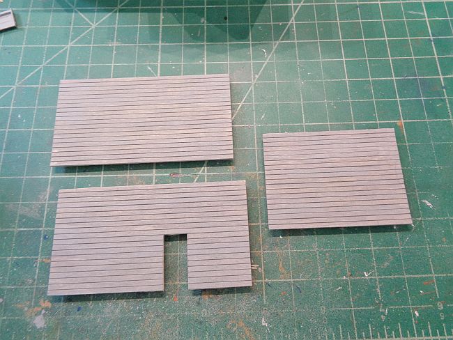

The left and rear wall pieces were cut.
I stained the walls with a light application of Hunterline Light Gray A&I.

I forgot to show and mention, I added a little weathering to the floor. More will be added later in the build process.

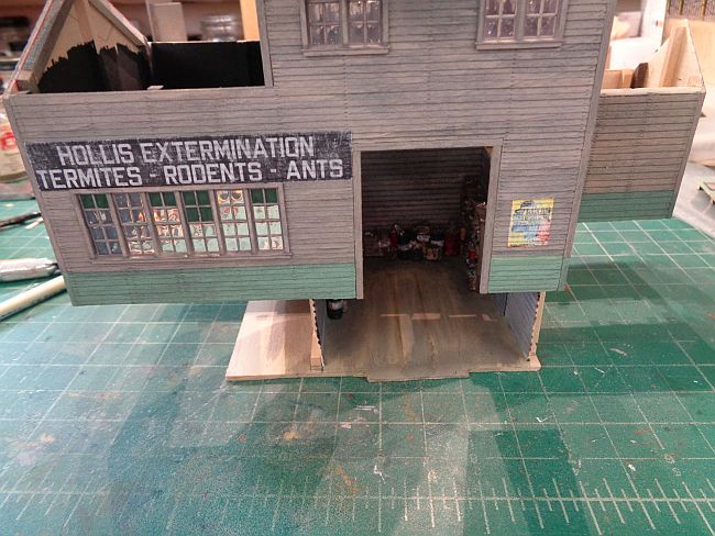

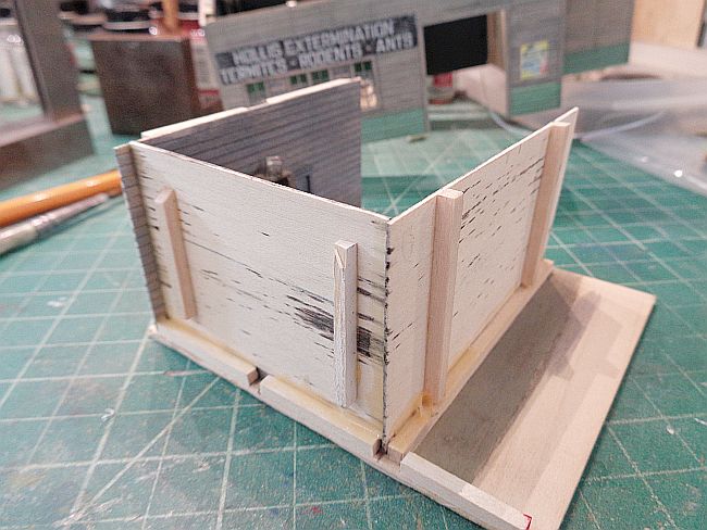

I'm guessing by now ya'll are thinking I glued the walls to the interior of the structure.
Well, I did and I didn't. what I did was glue the three walls to the floor.
I wanted to add some interior details so the structure needed to be removable from the floor.

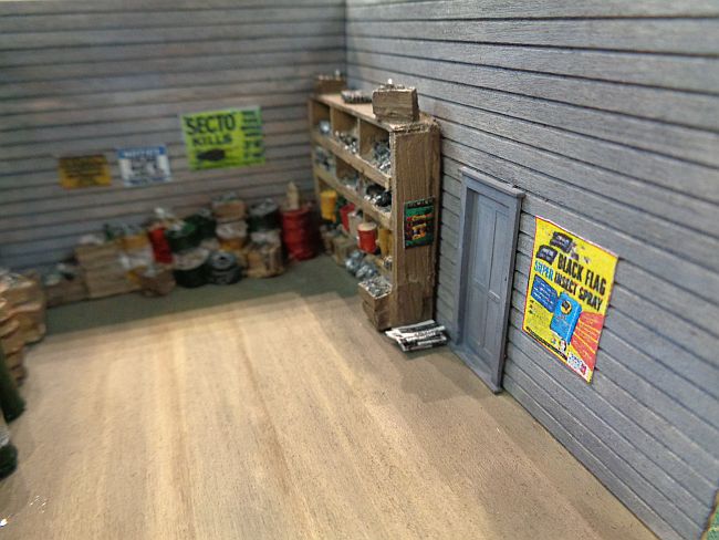

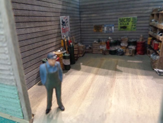

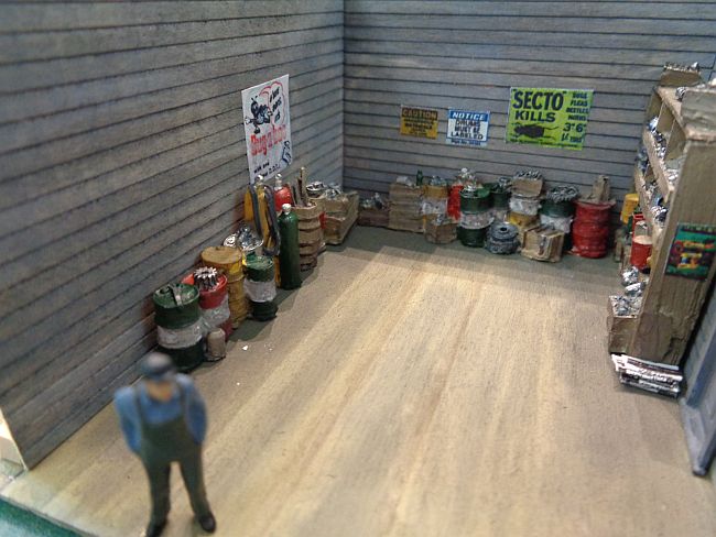

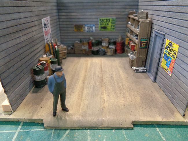

I used three Rusty Rail castings for the interior detail. No photos of the painting process of the casting.
www.rustyrail.com
I added a few wall signs and some newspapers. The figure in the front is from a Preiser roundhouse figure set. I also added more weathering to the floor area.

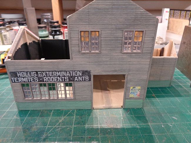

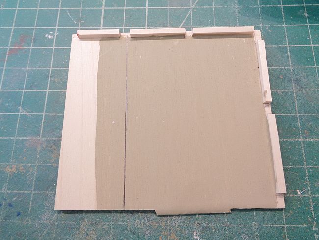

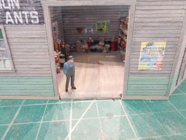

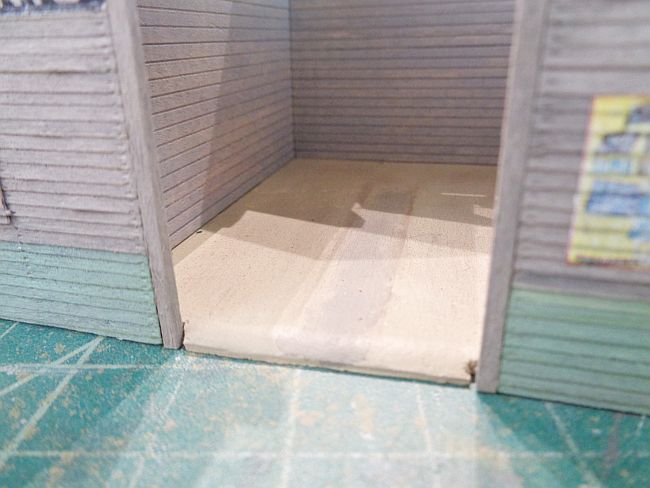

Here's the best part, the garage walls, as mentioned, were constructed so the structure fits over the "garage box".
I forgot to mention, I added a base to the bottom of the walls so the structure will sit just above the scenery when applied. The base is scale 4X4s and painted full strength Floquil Aged Concrete.
I still need to touch up the concrete color on the corners as you can plainly see.
