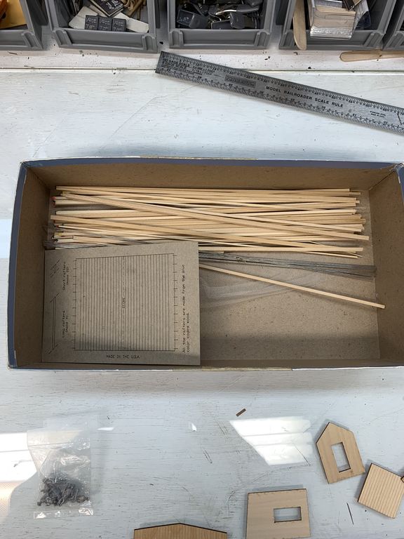

Instructions are 2 huge front and back newspaper style sheets like older FSM kits. Going over everything it looks like during this time Master Creations was trying to make kits very similar to FSM. The only other large Master Creations kit I built was Minerva Casket and it was very different from this. Minerva Casket was a big box of laser cut parts and confusion.
Lots of lead and stripwood.

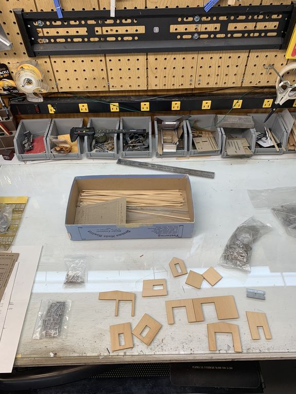

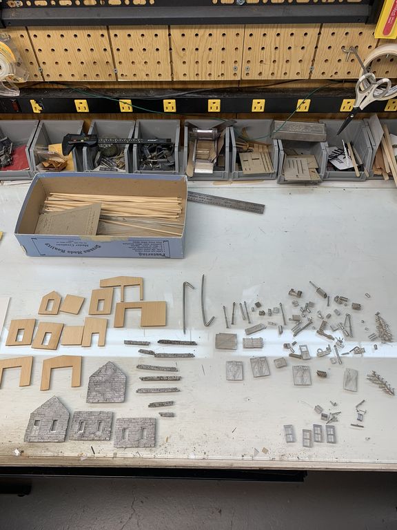

I built the small stone office a little while ago as a separate kit. I always liked the building but this one will need to be heavily modified to install on the layout. I might cut the top off the peaked walls and use it as a lower floor for a building.

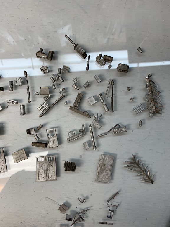

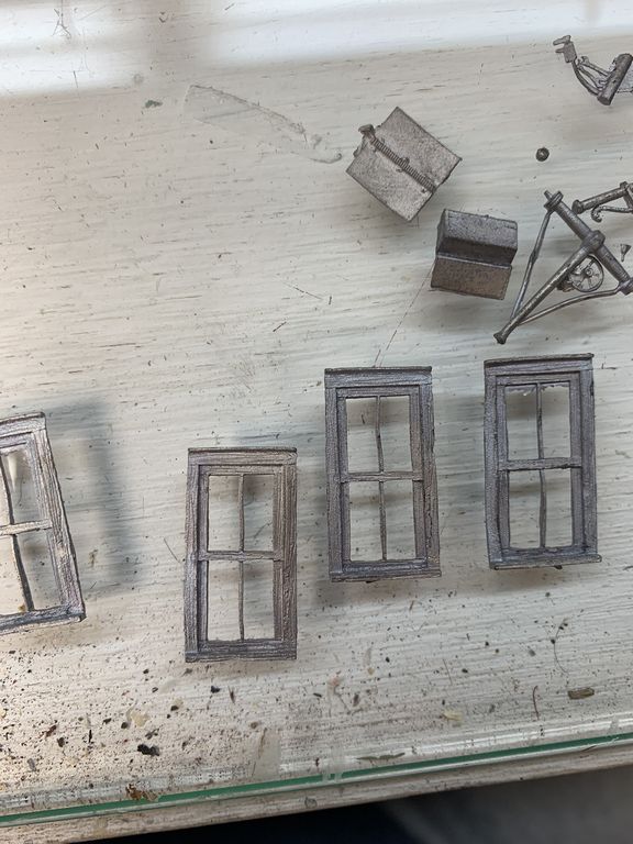

All the castings are good quality. Not a ridiculous amount of flash either. The windows have a nice wood grain texture.

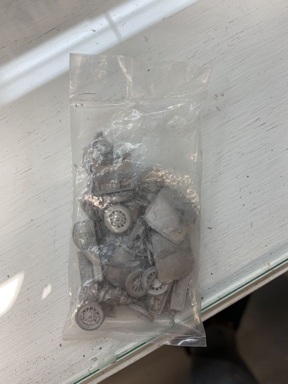

The kit came with enough parts to assemble a few trucks.
Looks like this brass sheet goes with the lead vehicle parts castings. Looks like maybe 3 trucks total. I'll probably wait to tackle these.

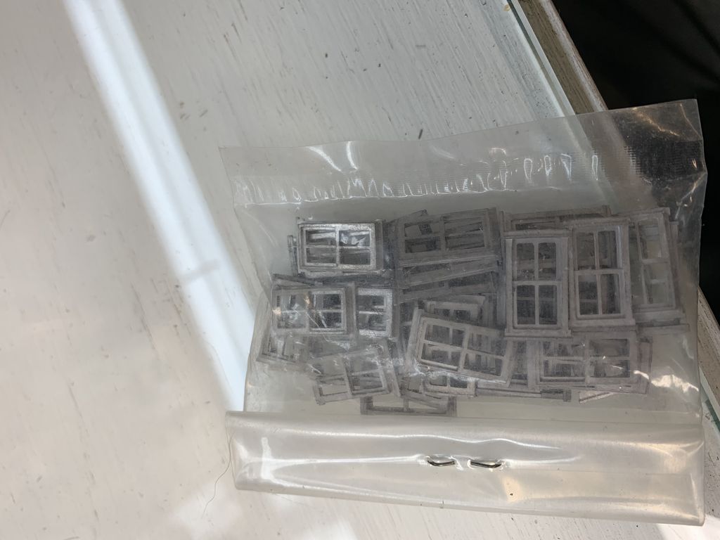

The kit came with a bag of about 15-20 windows but I'm not sure what they go to. Might be the resin brick building. I'm going to set these aside for now.
I cleaned all the flash from the castings.

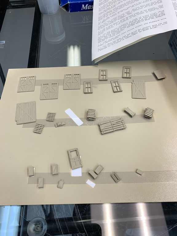

I separated all the castings into either wood or metal. These are the castings that represent wood. I stuck these to a sheet of paper with double sided tape and I'll prime them Khaki.

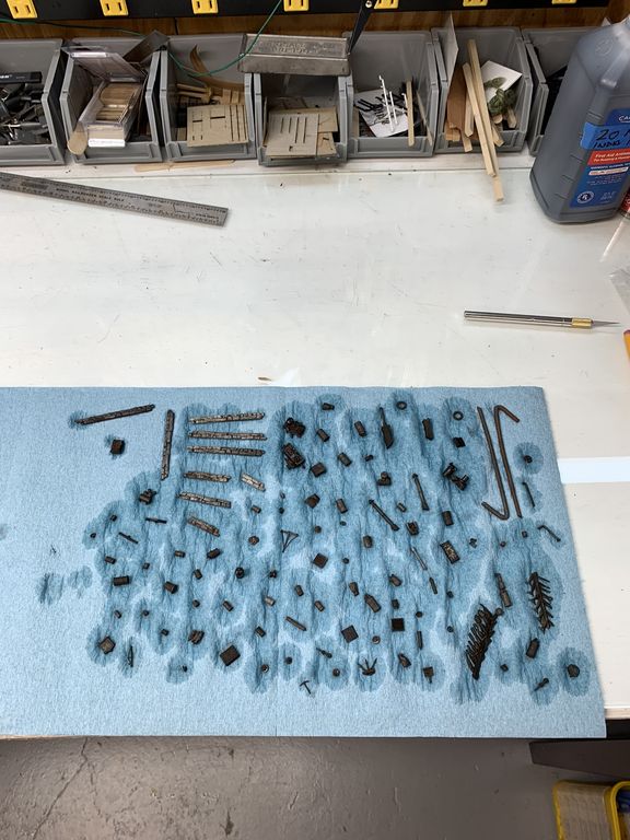

The rest of the castings got blackened with Jax Pewter Black.
In a little while I'm going to flip the castings I primed over and spray the other side so I can start painting them tomorrow.

BTW, I just checked my kit and the large bag of wood framed windows isn't in my kit. I don't think they go with Blanding and Gallard.

Interesting about the windows. I wonder if someone bought another kit from this guys collection and it's missing all the windows but has all the walls I need.

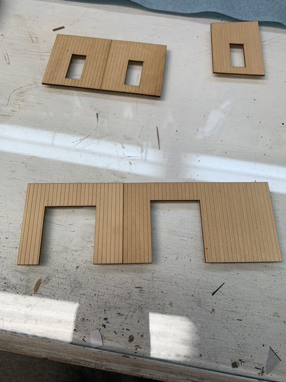

I started prepping the walls for the main shed building. They had me glue a few pieces together side by side.

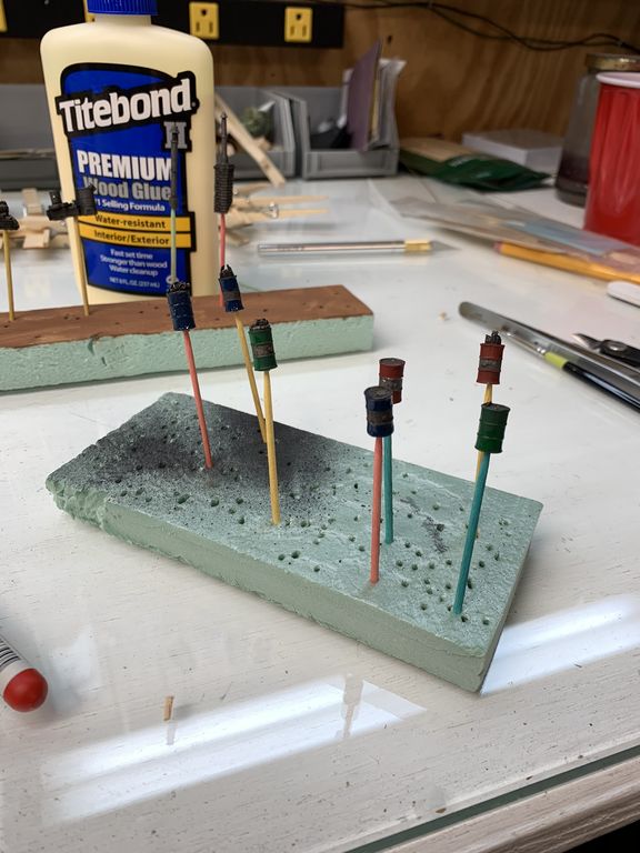

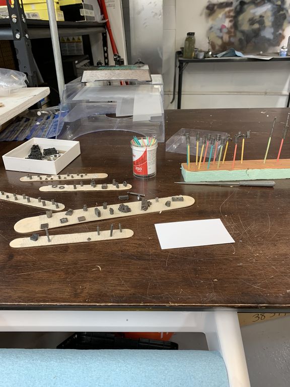

I set up all the castings for painting. Anything I can drill a hole in for a toothpick I do. I think that's the best way to paint a castings. It's a must for larger barrels. It's much easier to get straight lines by turning the casting while holding the brush stationary. I didn't spike much more than this because I ran into a problem with the castings breaking.
The castings in this kit are very brittle. Might be from age maybe something with the alloy but this one broke when I tried to drill it. I broke 3 of them total.
All the khaki parts are primed and ready to go.

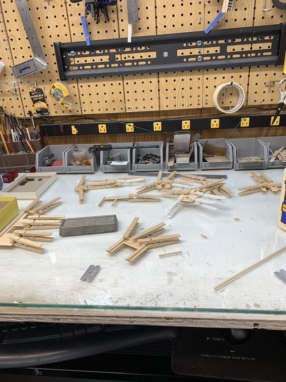

All the walls are braced and drying. This is one of my least favorite parts of building but it's the most necessary. Especially on old wood siding like this.
I started painting the castings. I always use Reaper paints for my castings. I try to get some sort of assembly line order with the painting. I usually do as many as I can until my hands stop holding steady then I move on to something else.

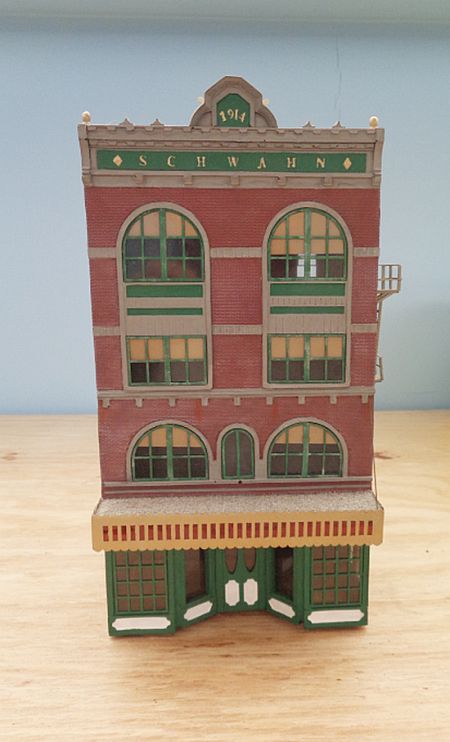

On Fanny Schwann only the front wall is resin and fairly thick. I built this one some 15 years after the kit came out with no noticeable warp. The rest of the kit is wood siding.
