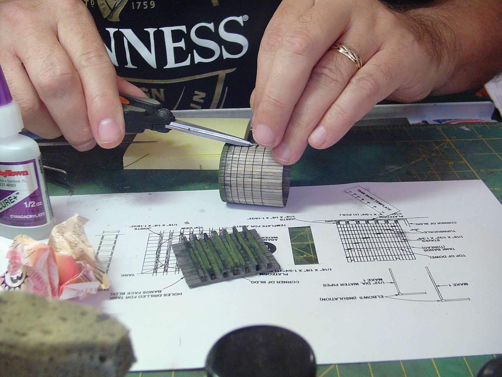

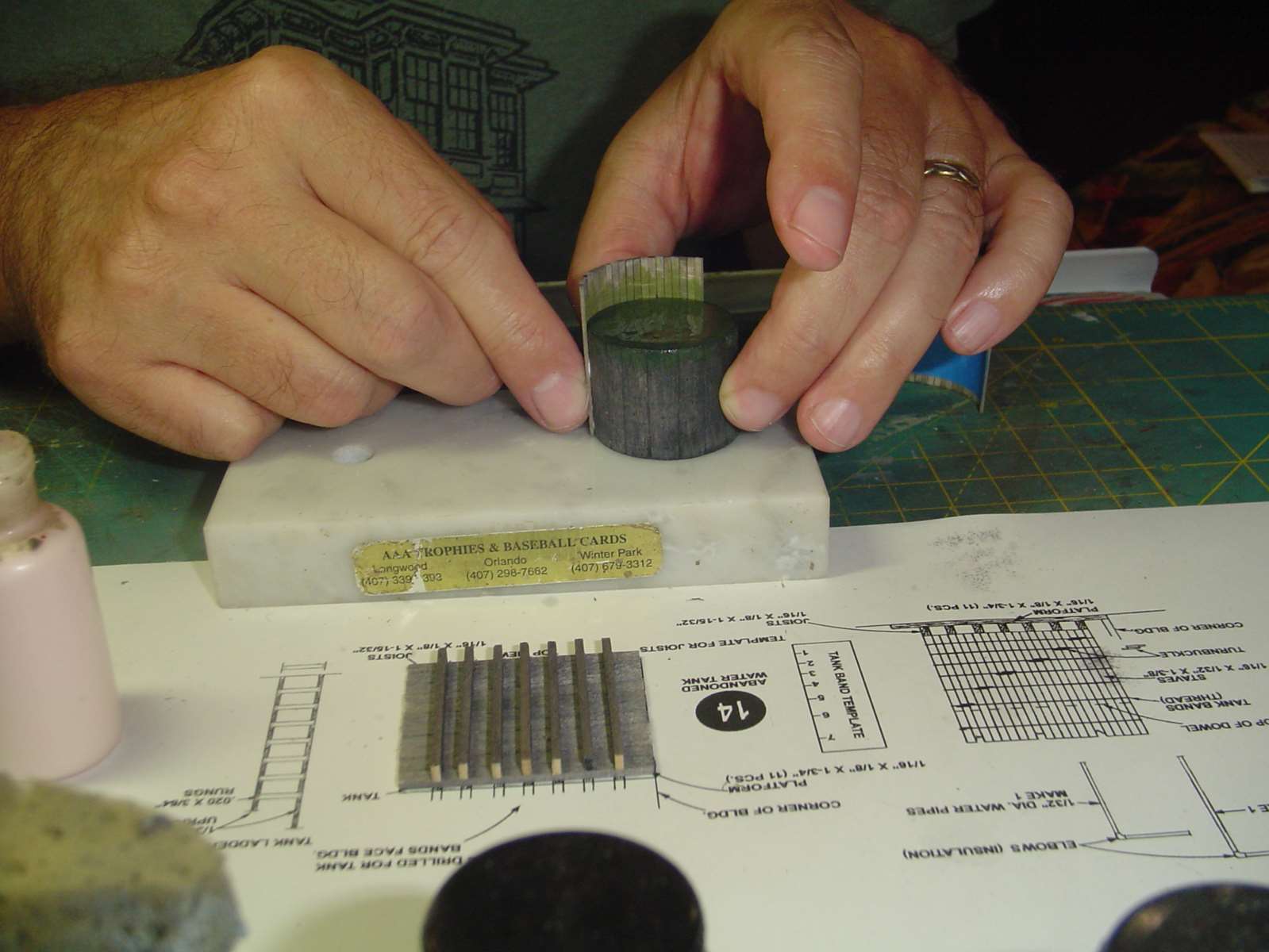

I took all the boards for the water tank, stained them with driftwood and then put them on a piece of painters tape side by side and even at the bottom.  I drew a line where the top of the 'water' is going to be inside the tank and then added some moss extending from the line upwards towards the top of the tank using AK Interactive Moss Deposits.
I noticed that if I wrapped the boards (still on the tape) around the tank I was coming up with a little bit of gap.  So I made a mental note to not glue them together as tight as I normally might hoping the extra space would resolve any gap issue I might have.
Then I started gluing them onto the water.  This certainly would be a leaky tank if that was real water in there.  :o
This was actually fun to assemble.  It's been a while since I put together a water tank that was a sheet of scribed wood wrapped around a dowel.
I added some moss to the bottom of the tank on the outside after it was assembled and then marked off where the bands would go.  I actually ended up with an extra board and had to cut one down a bit to close the final gap.  I could have glued them together a little bit tighter than I did.
Using the marks as a guide I drilled holes in one side of the tank to glue the end of the thread that will be used to band the tank.

The tank bands are thread.  One end gets glued in the hole that I drilled, the thread gets wrapped around the tank and then glued to where down over the piece that goes in the hole.  I trimmed them with scissors.  This side will be against the building so it'll be pretty well hidden.

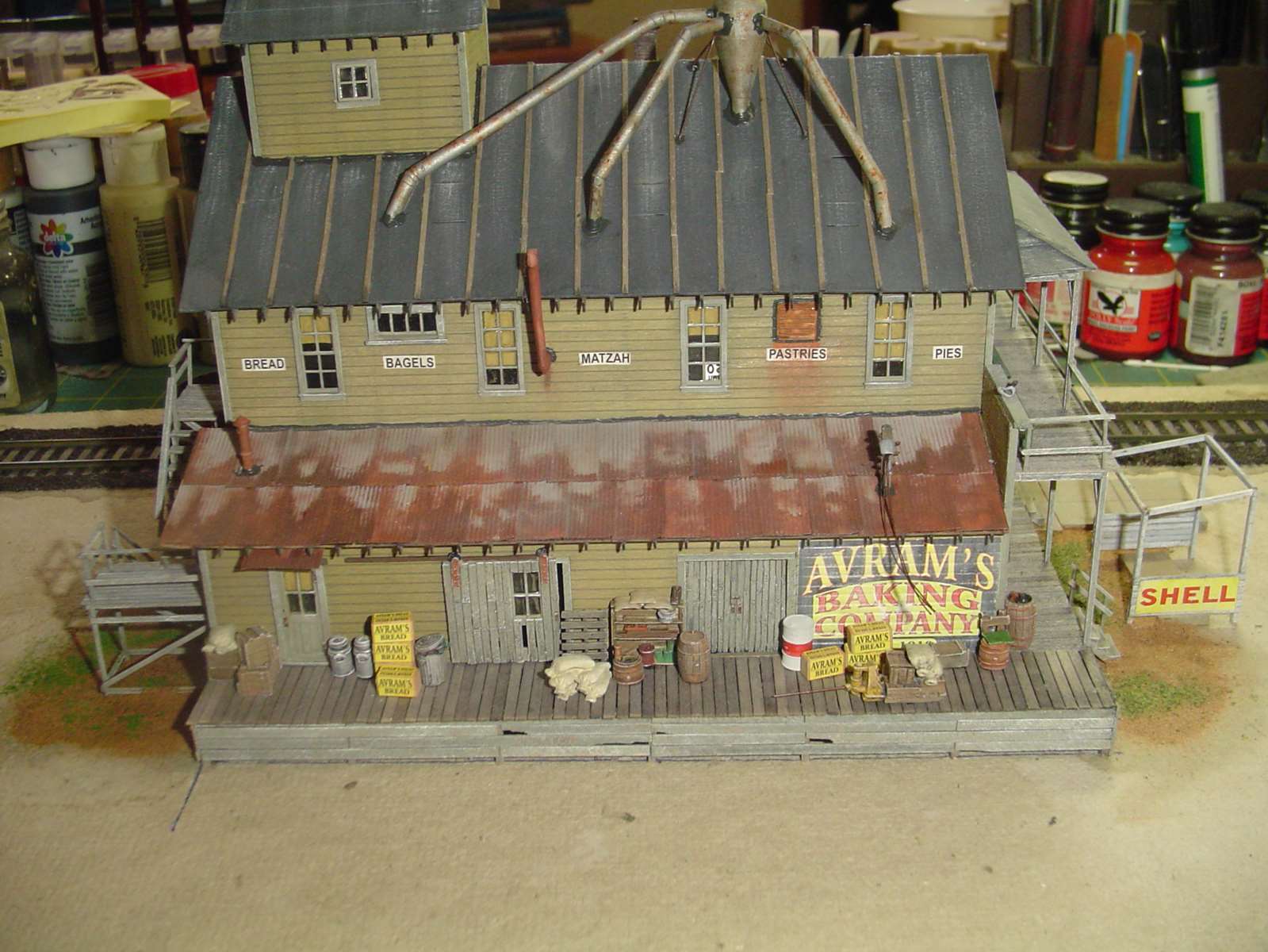

Took a break and started adding details to the main structure.
The details add a lot to the overall appearance.

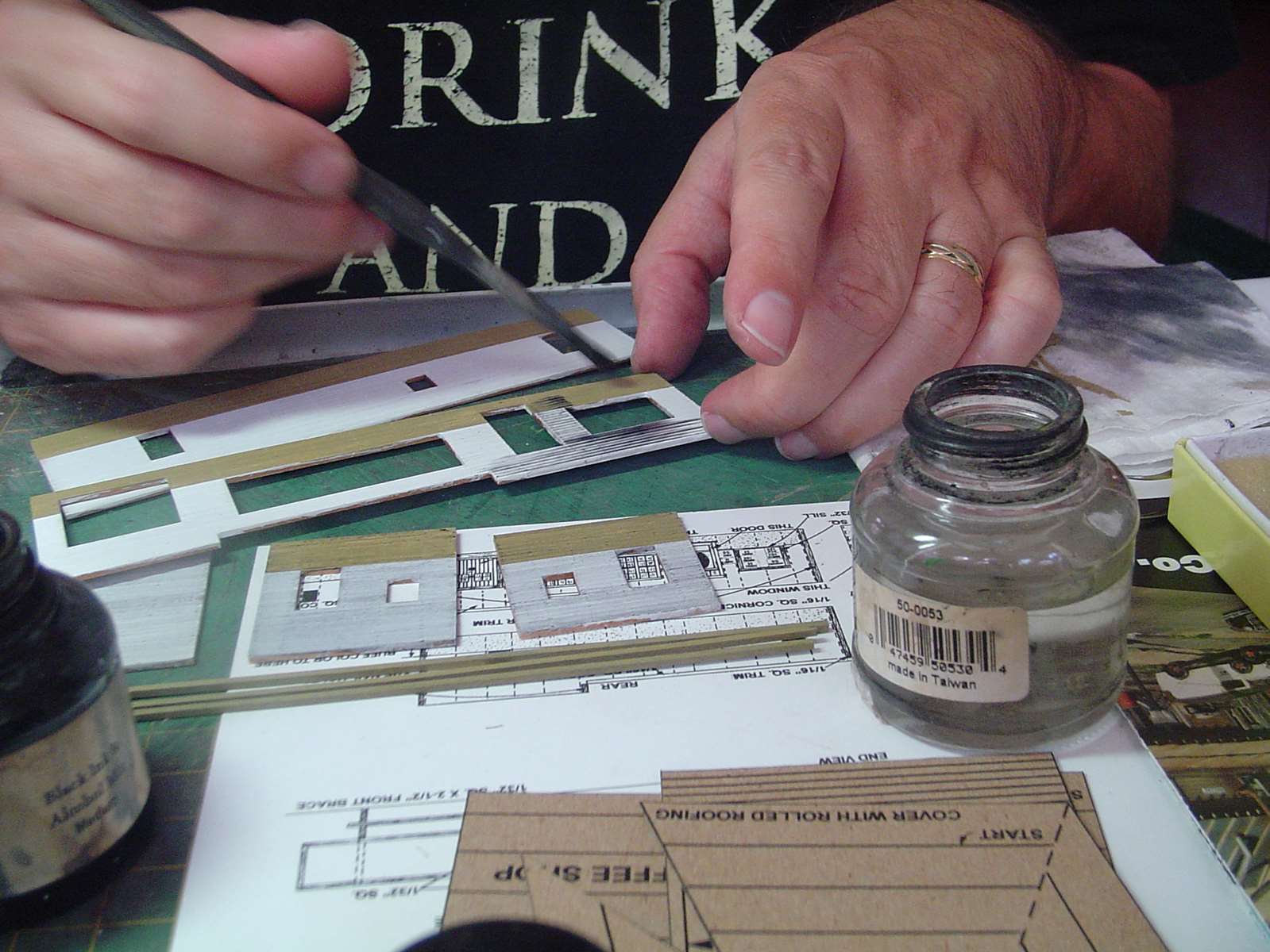

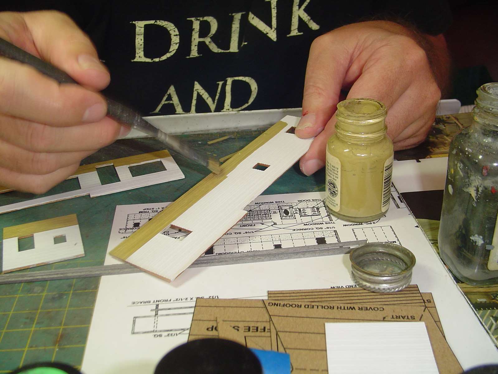

Time to get started on the coffee shop.  I followed the instructions on this and didn't stain the wall before painting them like I usually do.  Partly because I was following the instructions and partly because I forgot to stain them.   ::)  I painted them white first (Polly Scale Reefer White).
Then I painted the lower portion with Floquil Depot Buff.  These are the same colors George used except he used the Floquil Reefer White and the Polly Scale Depot Buff.   :P
I added the nail holes with a ponce wheel as per the templates.
Next up I applied a wash of A&I.  A little darker than I would normally use on a structure I'm trying to make look not too old/weathered but the next step was to go back with a Q-Tip dipped in plain old rubbing alcohol and scrub some of the darkness off.  That worked okay.  It leaves a little of the darker stuff down in the crevices.

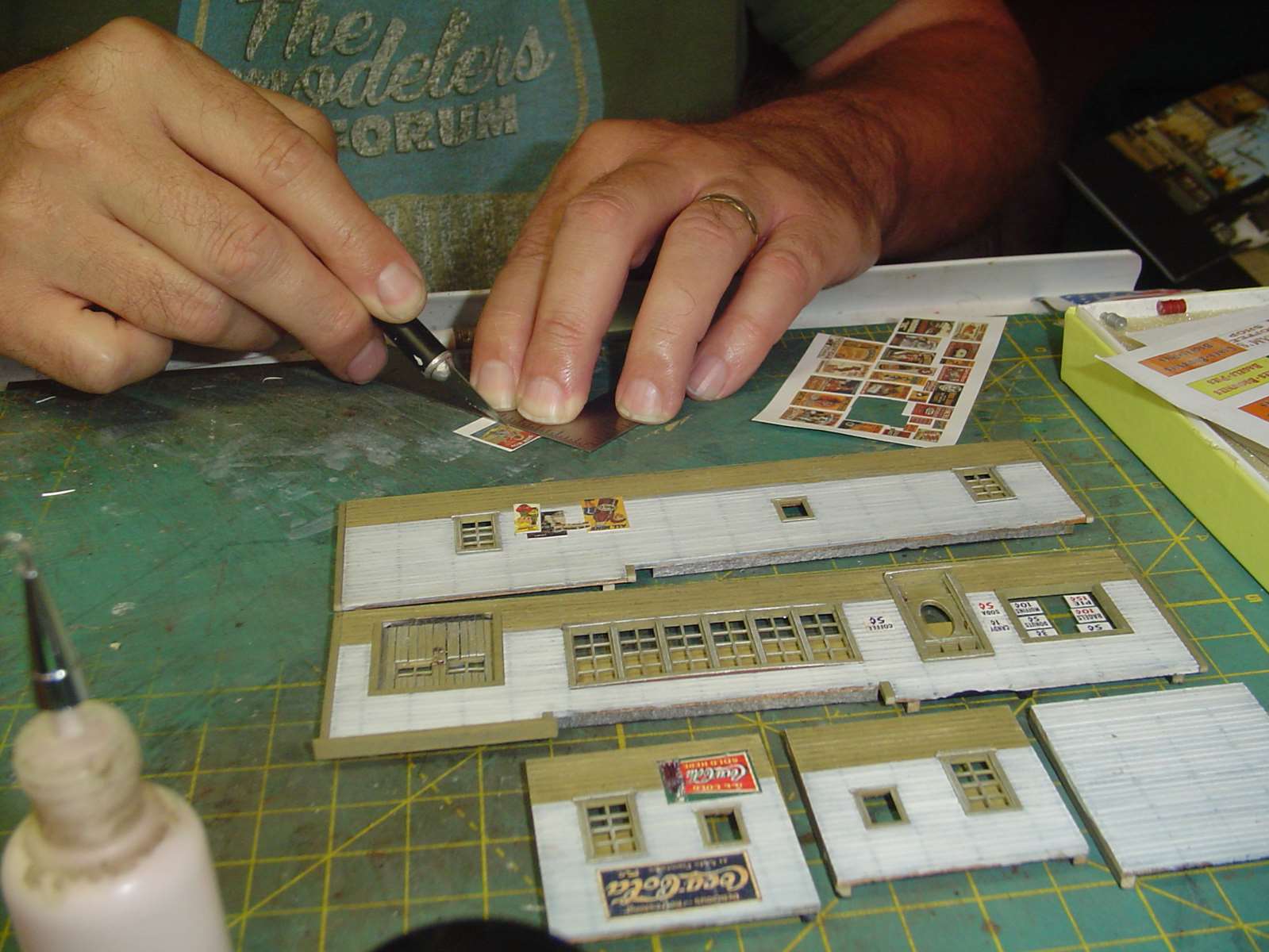

The windows and doors where glued in place next.
Then all the cool signs and posters were added to the walls.   ;D
More in a moment... :D
I just used plain old Elmer's White Glue to glue the posters to the walls.  Bent a few corners down here and there and lightly weathered one or two by scrubbing a bit with some fine steel wool.
I liked the way, the pilot model, the back wall had posters over top of posters so I did the same thing.

Nice work so far, Bob.  The moss effect on the tank is really neat.
Wow.  Both the main building and the restaurant really look great.  Glad to see it so close to the finish line.
