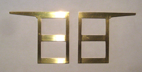

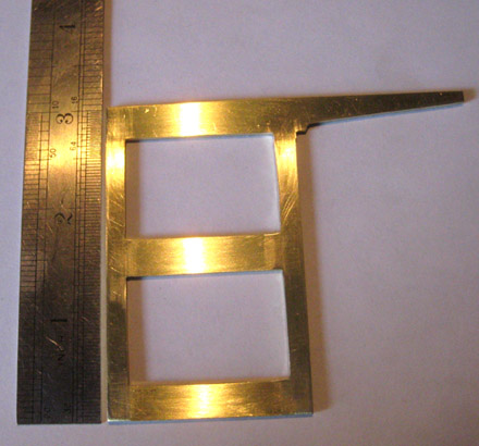

So here is the first of the cab sides in brass.  Hard to believe that the lay out and fitting was about ten hours. The second one won't be so long.
It's also amazing how much distortion - fish eye occurs when taking something close up.  Nothing looks square!!
Still needs polished out and the windows fitted.
see ya

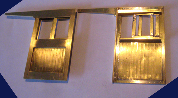

Got both cab sides done.  The second took half the time of the first.  I cheated......  I traced the first onto the second so the layout time was only a few minutes compared to an hour or more.
Now on to the cab front, which has to be made in two sections; the upper with windows and the lowers as they need to be removable from the larger cab for assembly purposes.
see ya
So I got the scribed lower panels put in which also became the lower window rail.  The windows slide in tracks but I have not located the rail divider yet. The glass will go in last.
