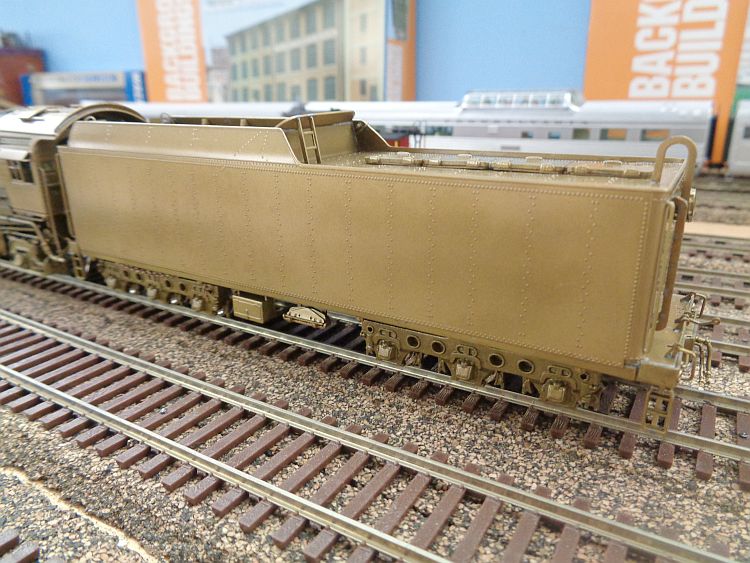

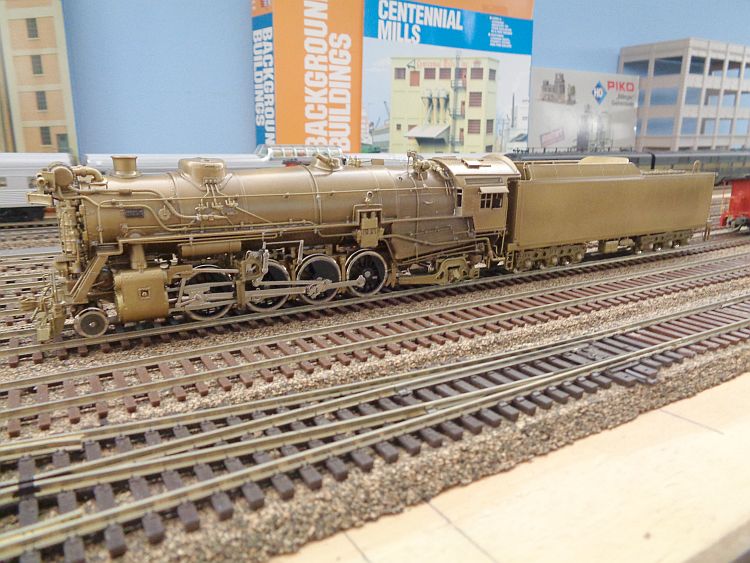

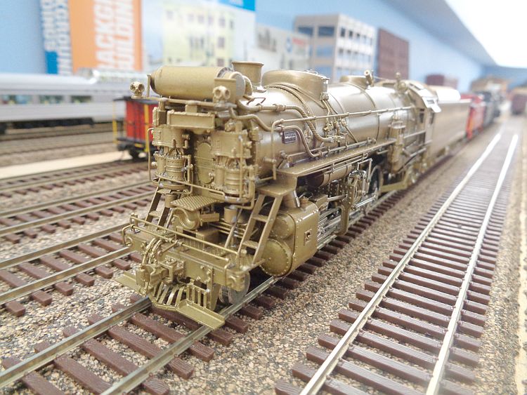

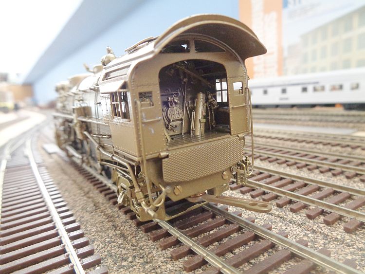

This is the next brass loco in the paint shop. This is a brass PFM C&O K3 2-8-2. In fact, I'm behind in the thread as this one is already painted but needs details and decals added.

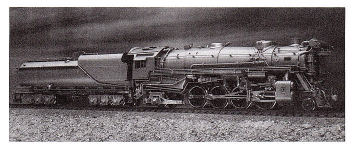

This model came in two versions. Both a rectangular tender and a Vanderbuilt tender model was offered in 1978 at a retail cost of $495.00. The Vanderbuilt version cost $550.00.  Also, they both had the Elesco K-40 feedwater heater on top of the smoke box. 730 of both versions were made and imported.
Here is a photo of the Vanderbuilt tender version. The locos were identical with the exception of the tenders. At various times, these have sold on the secondary market for upwards of $1200.00 to $1800.00. Prices are low so now you can probably get one, if available, for around $650.00.

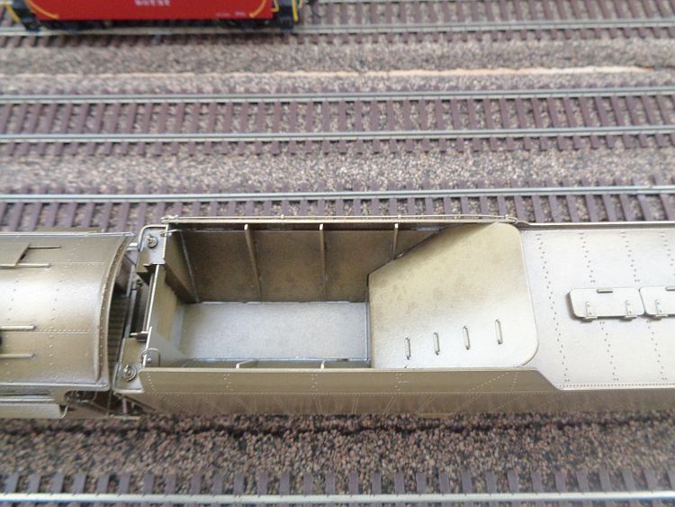

On this model, the cab comes off and the backhead with all the extra details also comes off.
There are some interesting disassembly issues which I'll cover later. Just for FYI.

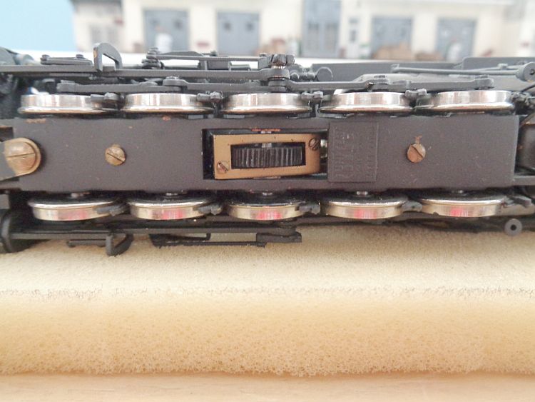

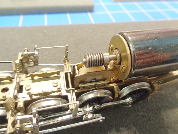

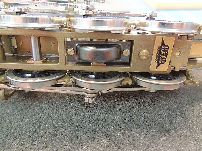

This isn't part of the update I've promised but I wanted to show ya'll yet another different drive mechanism on a brass loco.
Most brass have what we refer to as an enclosed gearbox. Meaning the bottom gear housing has a cap on it and the main gear doesn't show.
Below is the enclosed gearbox on the C&O K3.
Below is a photo of an open gearbox.
Continued -
This loco has an idler gear as part of the main drive. The motor shaft has a worm gear on the end. This worm gear meshes with the idler gear in the gearbox tower. The worm gear turns the idler gear and this in turn turns the gear on the driver.
This set up is very dependable and is very quiet as well.

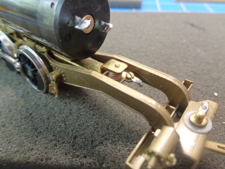

Here is something I've never seen on a brass loco - ever. The motor mount has a spring on the rear as shown. I'm guessing this helps with the smoothness of the motor, motor mount and the idler gear all working together with the least amount of "bounce".
I do have the loco painted but not yet back together. I'll show some photos tomorrow of the painted model and mention some issues I didn't count one.

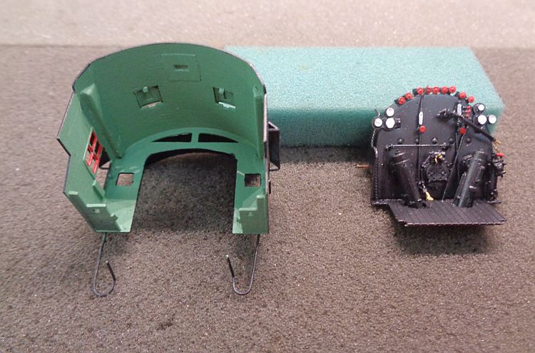

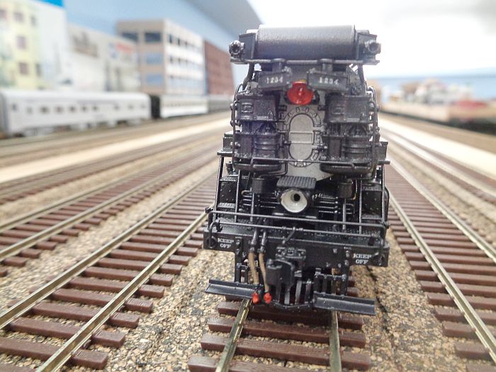

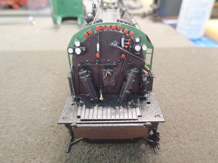

I painted the backhead details and cab interior.
Continued -

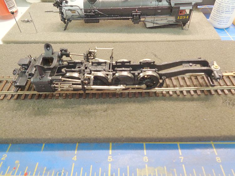

Main frame and all side rods back in place.

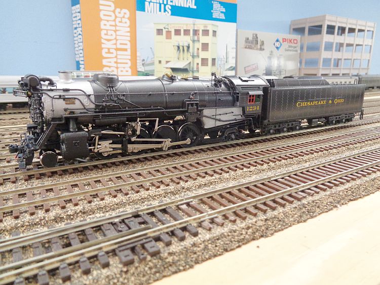

I set the boiler on the frame and the tender on the tender deck and trucks. Nothing is screwed together at this point.
The loco boiler, cab and tender all have a gloss coat on. I'll spray the satin finish on later when the weather permits.
Continued -
The boiler appears crooked in the next photo. The boiler is only sitting on the main frame and not secure. The photo angle also adds to the illusion.

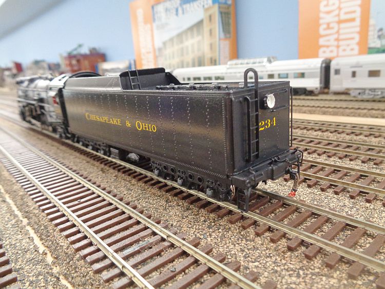

I had to use a set of old C&O decals. The C&O also used a Delux Gold on some of the K3's. The set for this K3 had the Delux decals. However, the decal refused to meld to the tender rivets. Even using the decal set, they wouldn't set and showed an air bubble under the decal.
So, heck, I used what worked.
