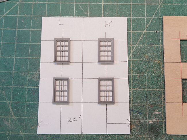

This section of wall is a scale 22 feet wide.
I'll find the center line at 11 scale feet and mark it.
More in a few. I think I'm going to need some Diet Pepsi. 8)
I want the four windows centered on the left and right of the centerline.
I'll then mark the left and right center lines. These will be 5.5 scale feet from the edges and center line. Draw these lines.
I'll place the four windows back on the wood, er paper, to make another test location.  At this point, I'm satisfied with the locations.
So far my paper matches the original wall section.

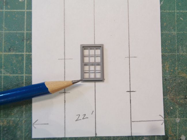

Once you determine the height you want your windows, place the plastic window on the paper. I make sure I center the window over the vertical line I previously drew.
I then mark the bottom and top of the window. Use the rear frame of the window to make the marks, not the front.
Once the bottom two windows are marked, I measure up (whatever distance determined) and then mark the location of the upper two windows.
Continued -
I then place the window on the paper and mark the edges using a sharp pencil.
Again, remember to mark the window with the edge of the rear window frame.
Continued -
You can see the four windows are marked and centered on the left and right vertical lines.

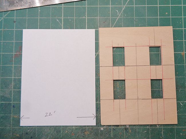

Using the short horizontal lines from marking the window locations, I then used a metal ruler and drew the upper and lower horizontal lines. Windows were placed on the paper for another test look.
They look centered and where I want them.
I then mark the outer edges of the four windows. These are the four short vertical lines on paper as shown below.
Again, using the metal ruler, draw the vertical lines for the four windows.
Now I have the pencil lines centered for all four windows. These are centered vertically and not horizontally. You can see the lower windows are further up the wall than the windows from the top. However, if you wanted to center all the windows, use the same method for centering them vertically.
Continued -
There are many lines on the paper and can be confusing when you start to cut out the openings.
I use a red leaded pencil to mark the cut lines for the windows.
Using the red lines, I cut the openings as shown below.
I hope this helps clear up any confusion in my previous narrative.

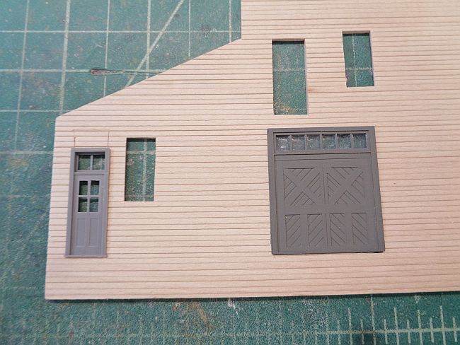

After cutting the openings, I realized the height of the freight door is for a freight car.
I had to change this as it won't be a trackside structure.
I'll lower the freight door height by 1ft. 10.
Continued -
The tall door will also have to be lowered.
The freight door will be enlarged to the size of the large Tichy bay door.
When cutting door and window openings, I usually keep the "Plug" from that opening until the walls are glued together. In the photo above, notice the large door opening cut out portion is in place.
The large freight door and tall door have now been installed. The top of the tall door wall section needs to be filled in.
I removed the top portion of the original plug and glued it above the door. You can still see the cut lines. These will not be seen when the door overhang is installed.
Continued -
