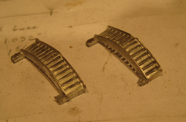

I had this notion that I could use pre-made cast pilots from Labelle for their trolleys. I have a ton of their castings and this was going to be a push over.
Wrong ! ! !
The melting point of the white metal is too close to my coolest melting point solder....180 degrees Fahrenheit.
So I fried the legs off of two castings just to prove to myself that it wouldn't work.  Here is the evidence!
So on to making my own pilots
Next!
