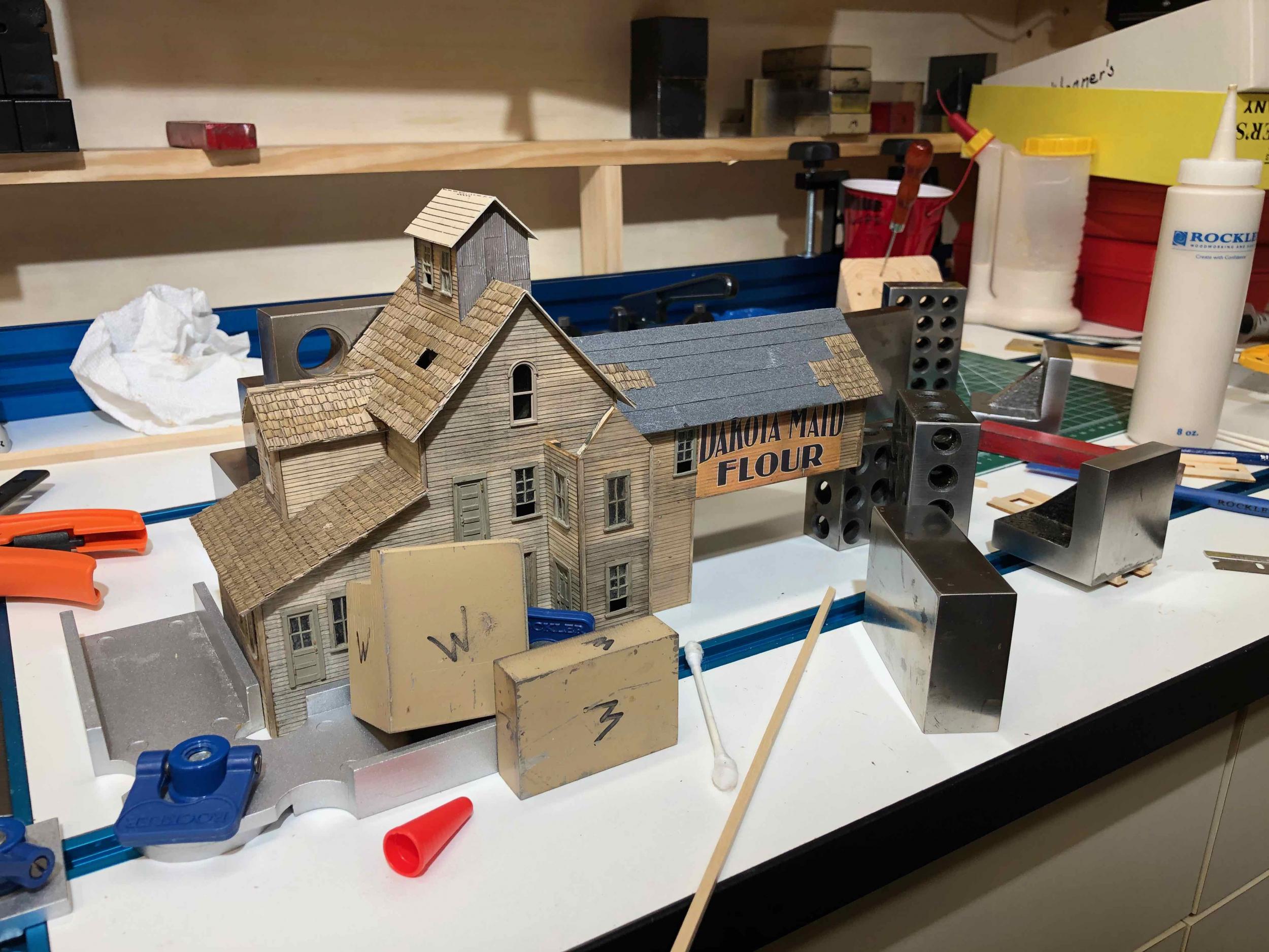

Thank you, I will be using the weather chalks once the structures are in place - but I agree that these new shingles from Wild West Models really look good right out to the package.

Update: I spent most of the day adding shingles to the many structures that make up the Fox Run build and getting all of the clapboard structures glued together and ready for the staining process on the Swakhammer build. I will take some more progress pictures when I get these steps completed.

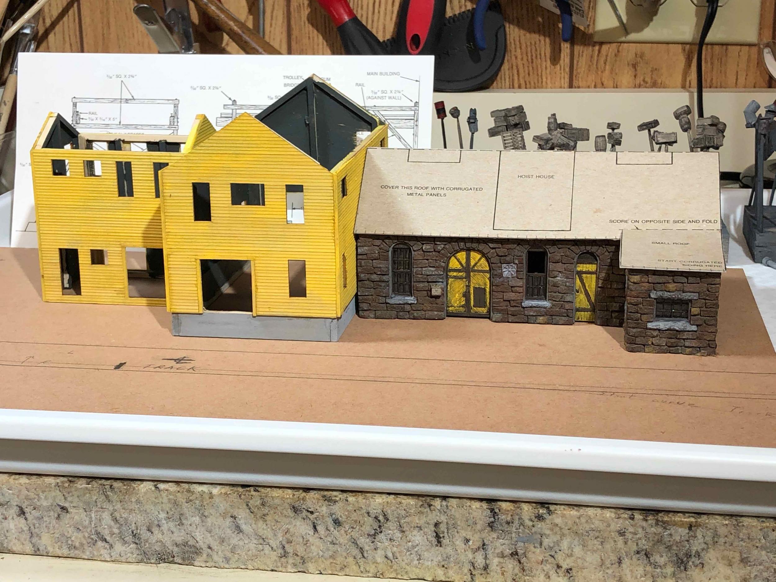

Update: I colored the clapboard walls of the main build for Swakhammer's today.  I wanted that chalky paint look. My time frame is 1949 so I wanted the building to look like it was time for a new coat of paint - neglected during the war - look. I used a three step process. 1) stained the wall with Hunters Creamy Yellow stain. 2) A&I to get the coal dust look and pop the railheads. Finally, 3) added yellow chalk for more color - slightly more orange to the yellow to get to the color that matched my doors on the stone part of the building. Here are a few pictures from the end of the day followed by some process pictures.

I need to get rid of some of the chalk that built up next to the moldings.

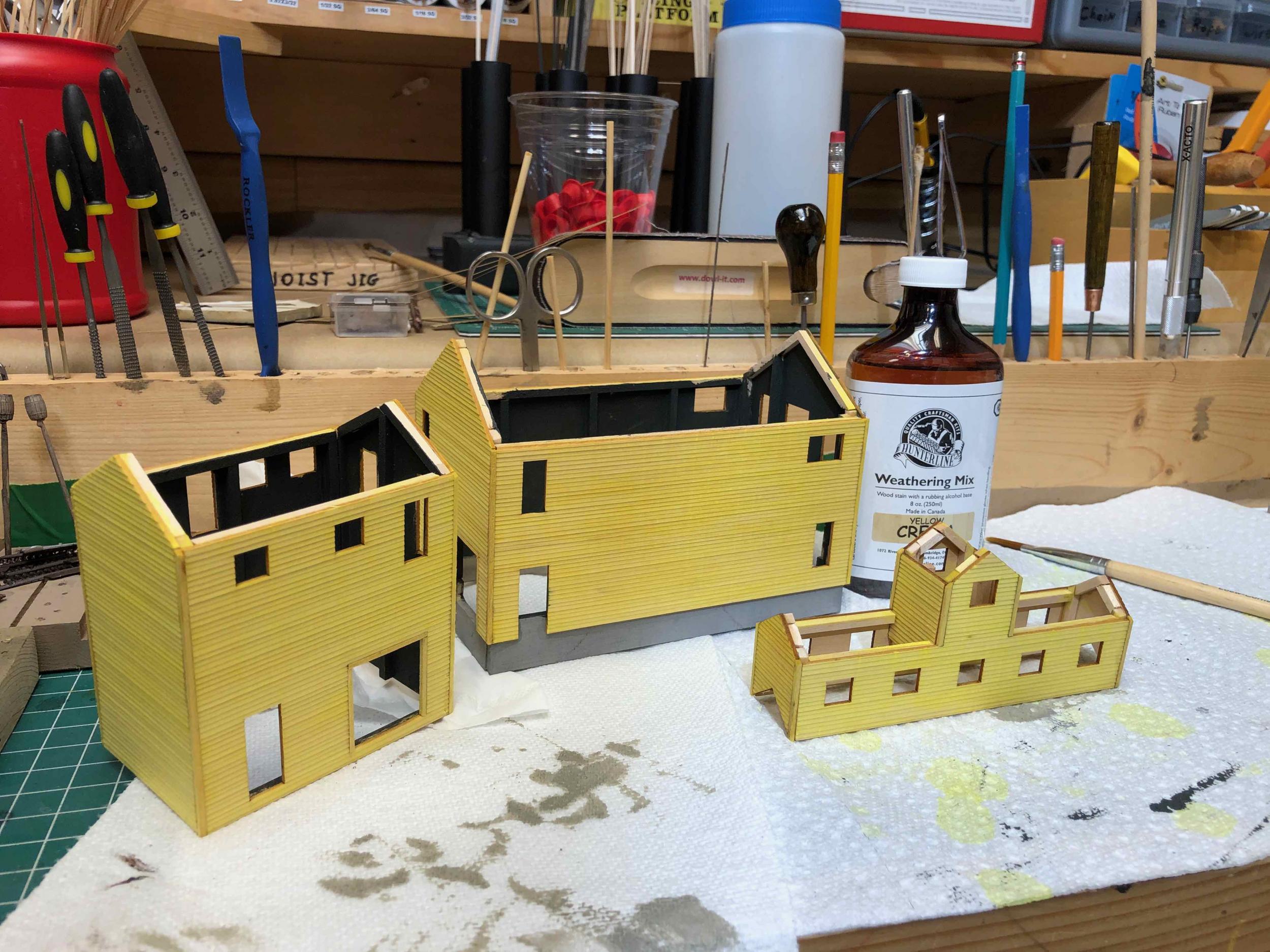

Step one: Hunterline Creamy Yellow stain.

Step 2: A&I wash.

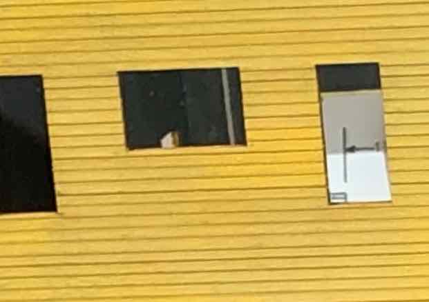

Step 3: was the Rembrandts 202.5 yellow chalk.
I painted this on as a wash by adding Alcohol.
Here is a zoomed in picture of the clapboard wall.  The nail heads are visible but much more subtle. They are more visible to my eye and the paint color is more chalky.  The magic of an iPhone picture.

Here is a picture of the Fox Run build at the end of the day, today.  Followed by a couple of progress pictures as the main building subassemblies came together.
