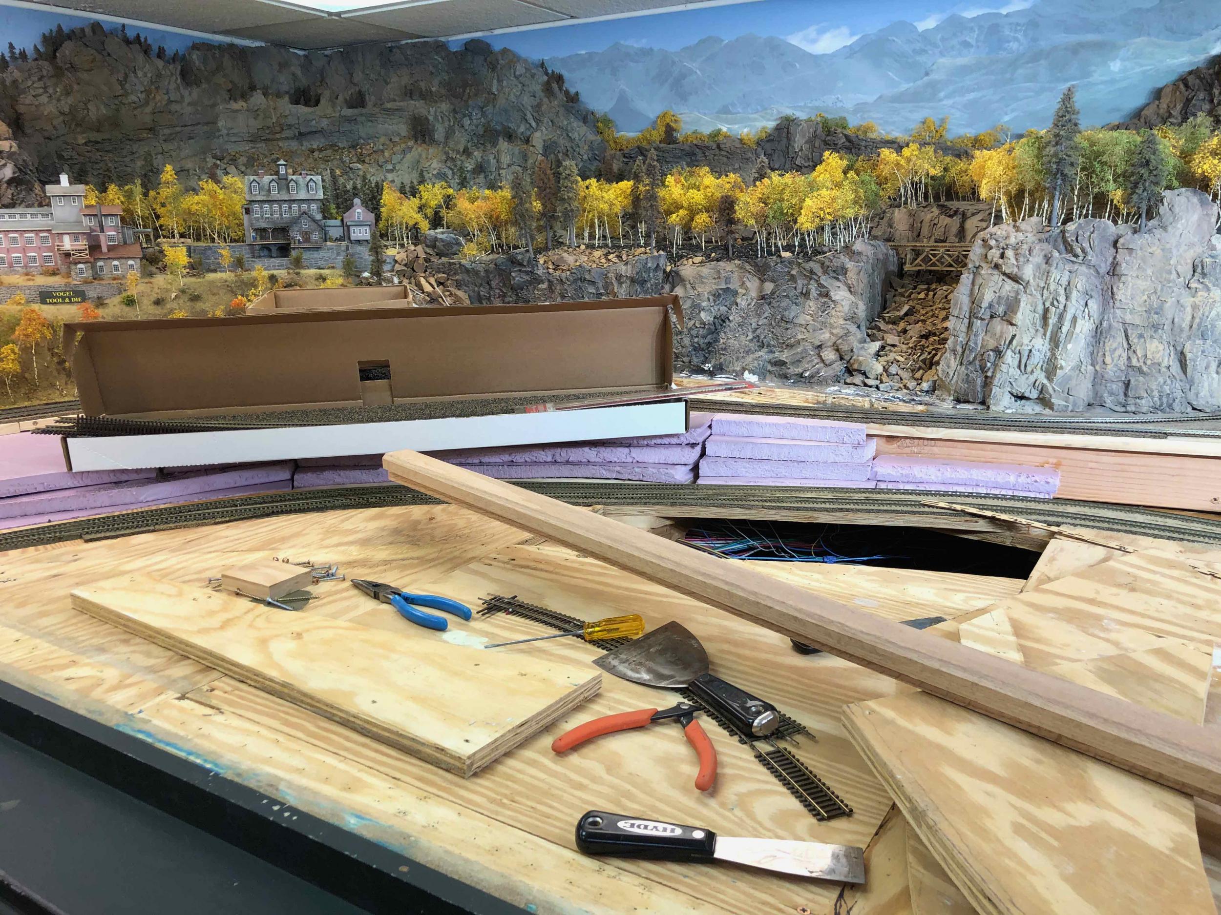

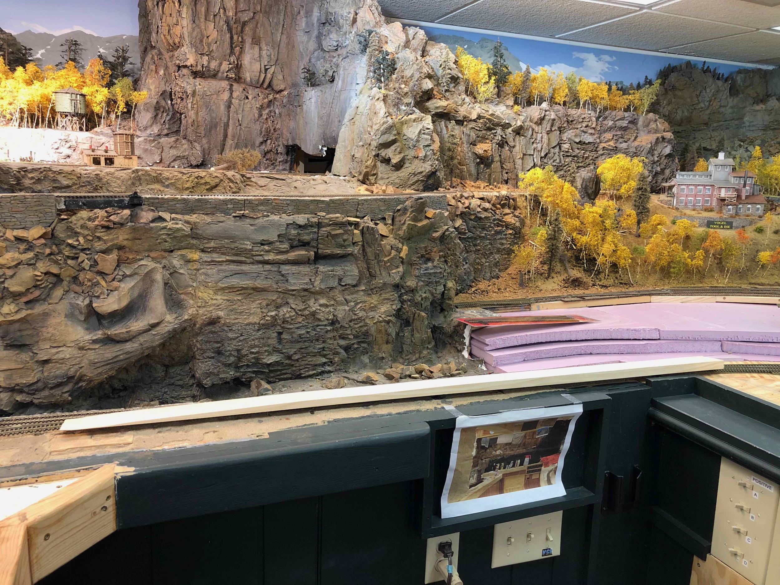

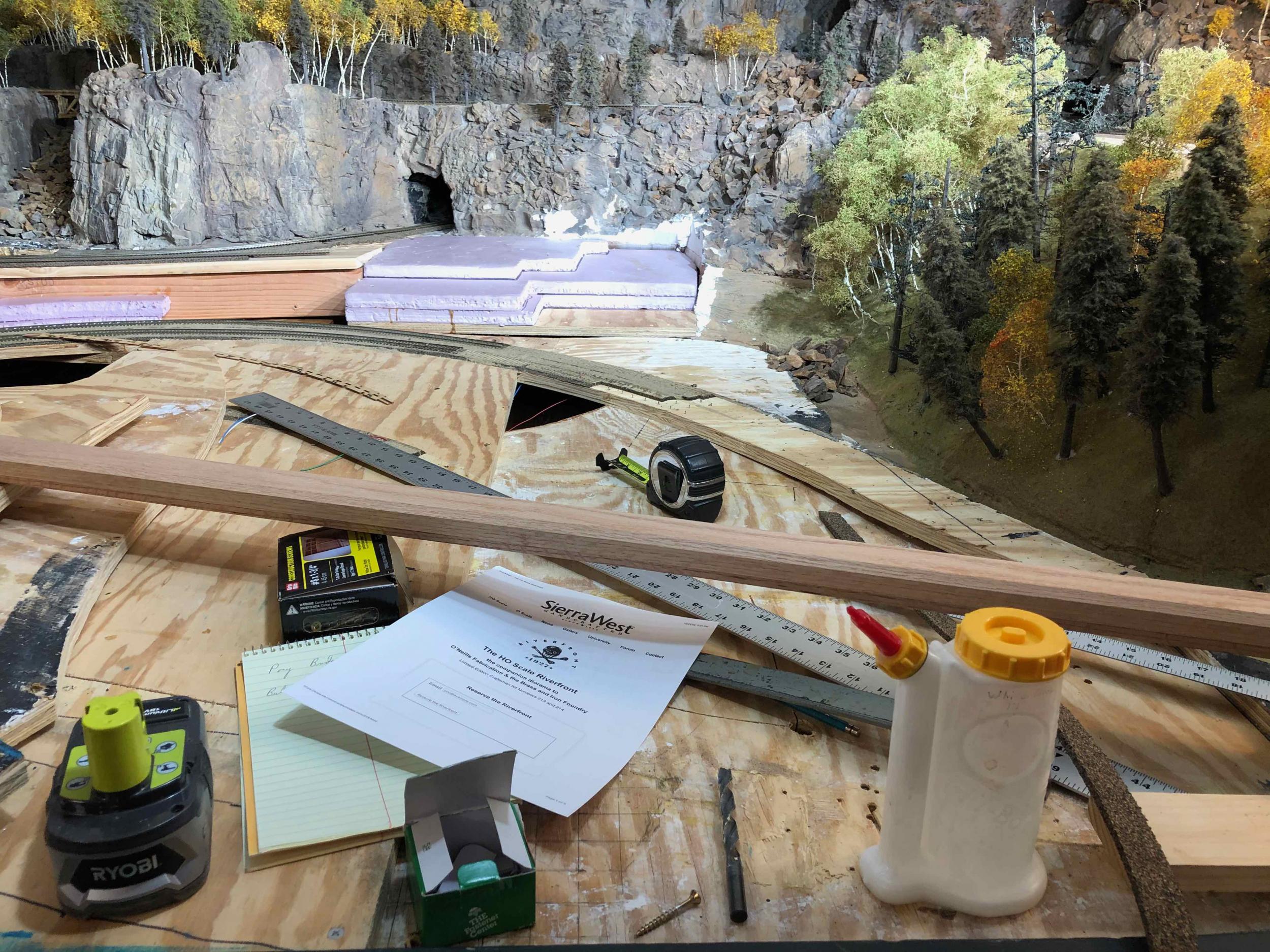

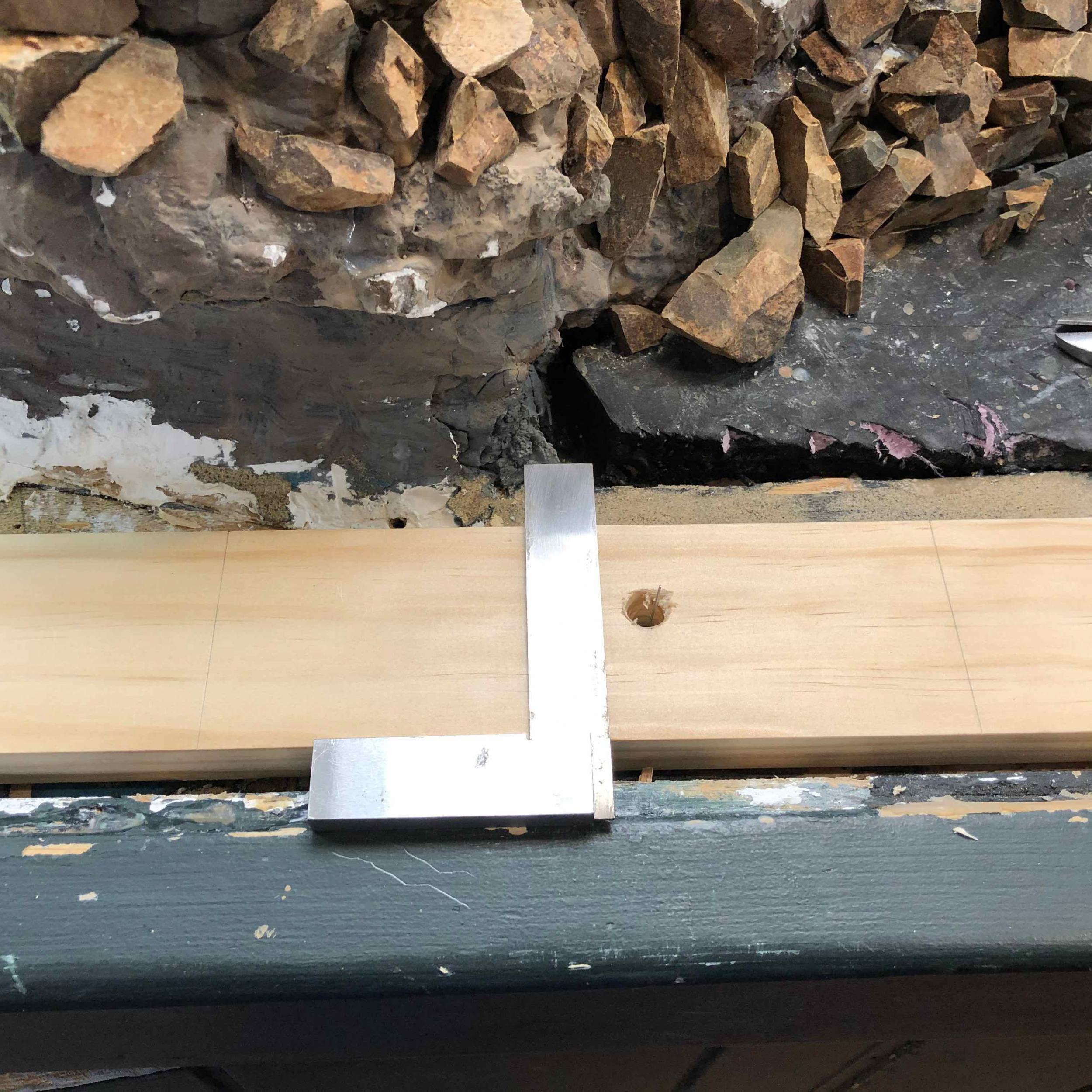

Happy New Year! I started to post a few pictures of the new track work that is going in the town of Sellios before my holiday/take care of mom break.  I'm basically raising the mainline 3/4 of a inch to give me more options with elevation changes in this area.  To make tortoise switch machines easier to install I'm cutting a hole through all the layers of benchwork in this area and attaching the tortoise machine to the top 3/4 inch thick board.  The sections are put in with screws so I could remove the section and replace the switch machine if needed, later on. Here are a few pictures that show what I'm doing.
First the turnout location is established and a section of the benchwork is cut out.

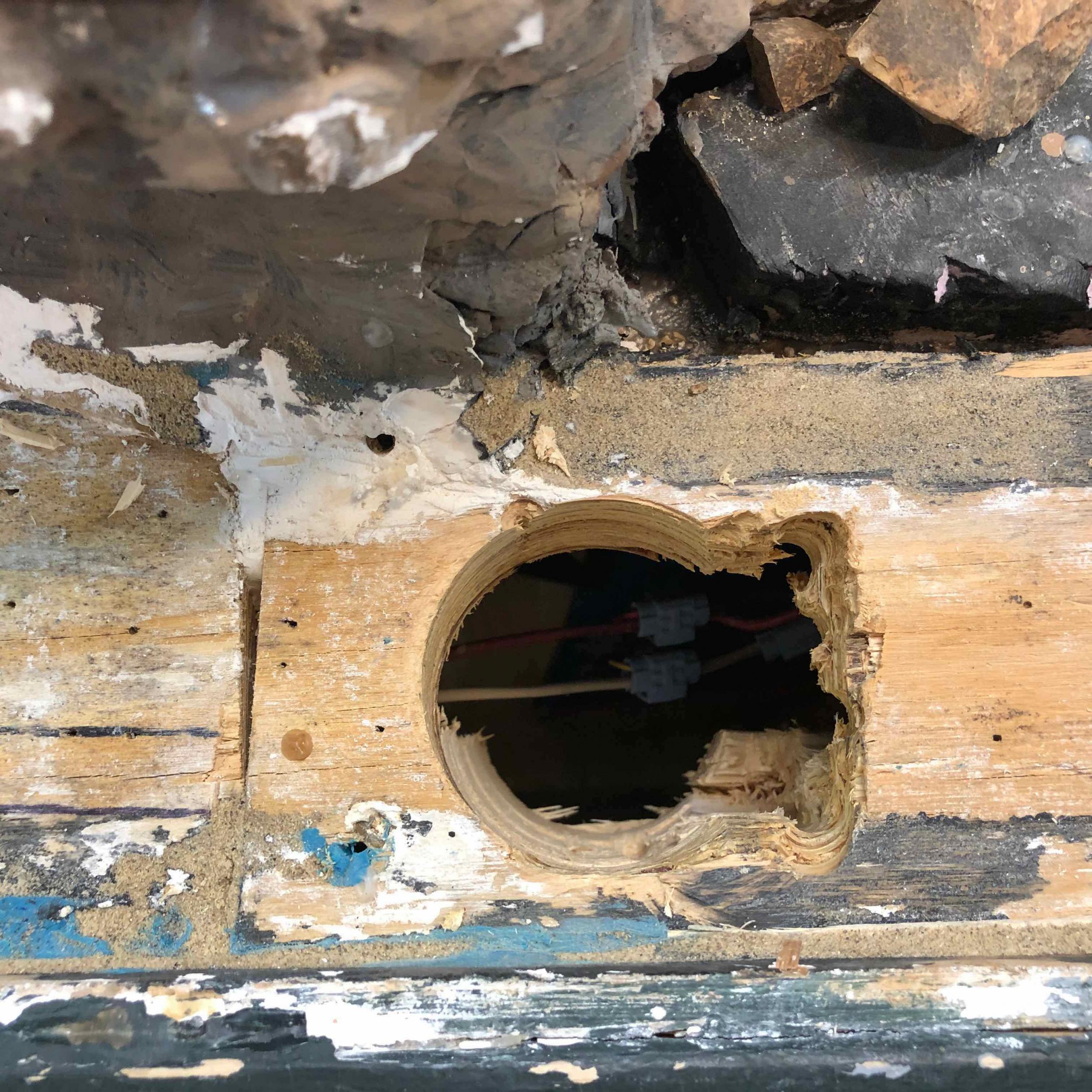

I cut a clearance hole underneath the 3/4 inch mainline benchwork.

I'm cutting through a lot of layers of history. The benchwork from my first layout extends through this area.

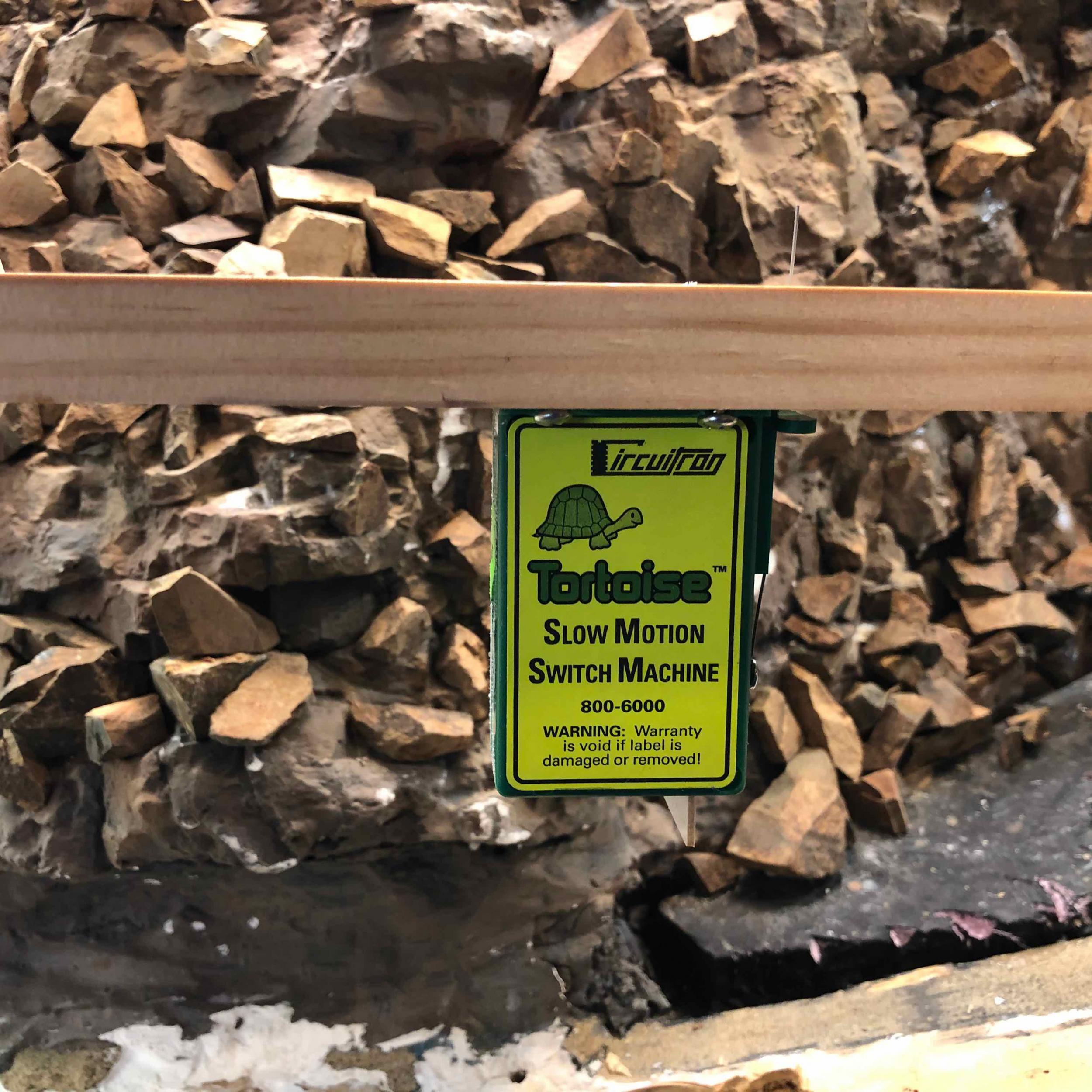

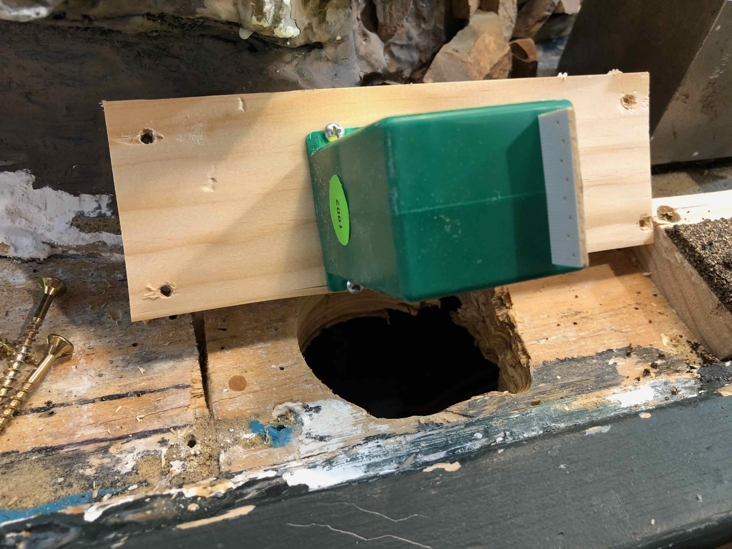

The tortoise machine is then attached. Wires added. and then screwed in place.

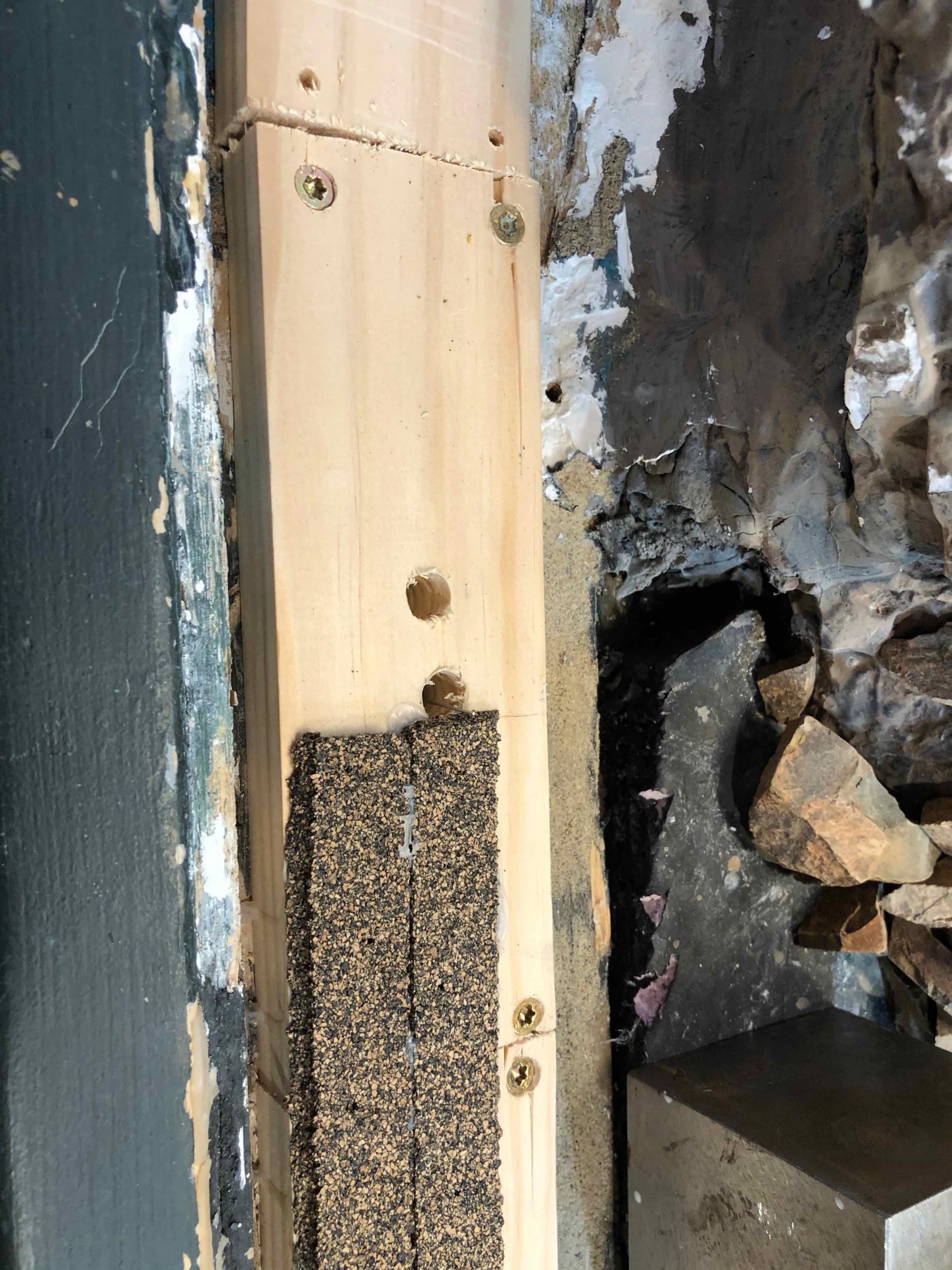

A cut is made through the cork roadbed at the joint line.  Once everything is in place I make sure everything is smooth using the belt grinder.

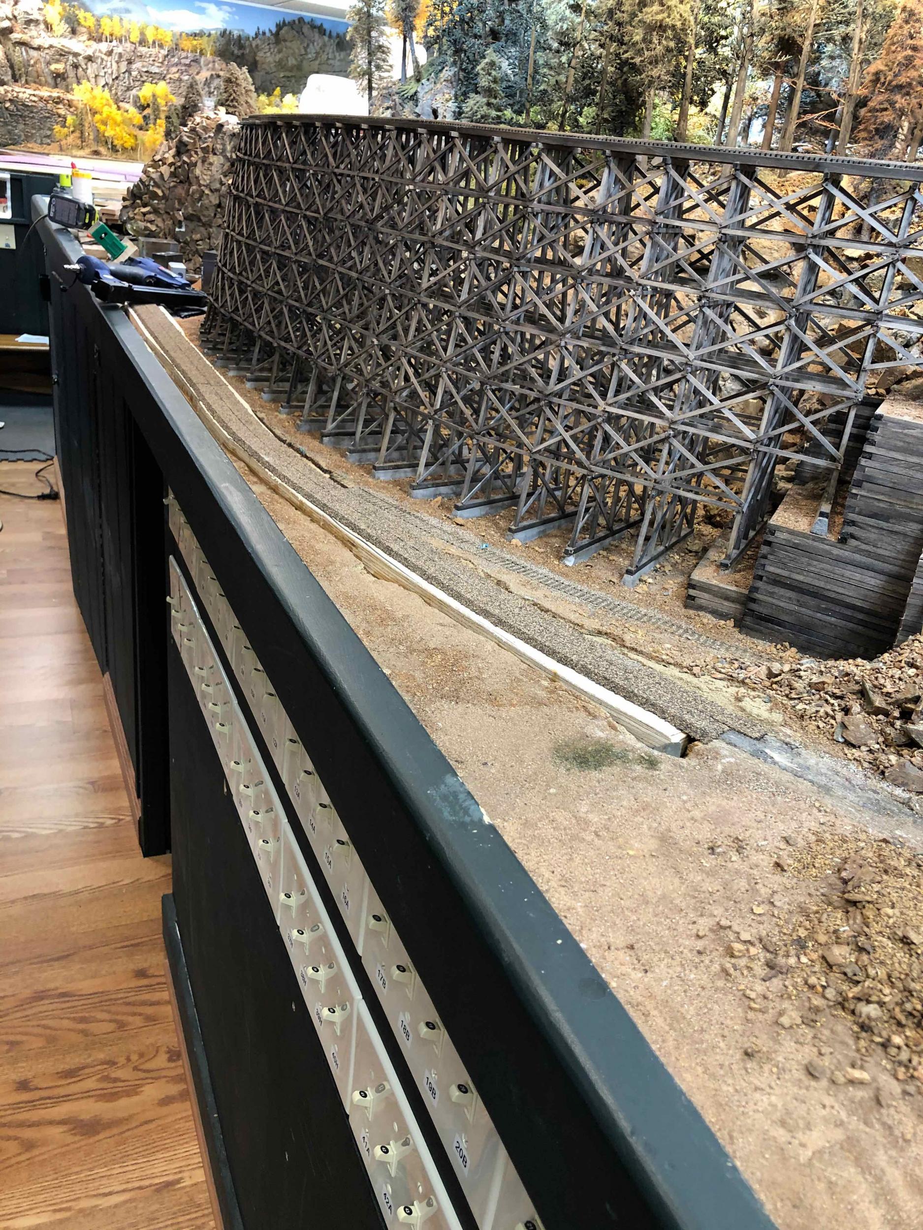

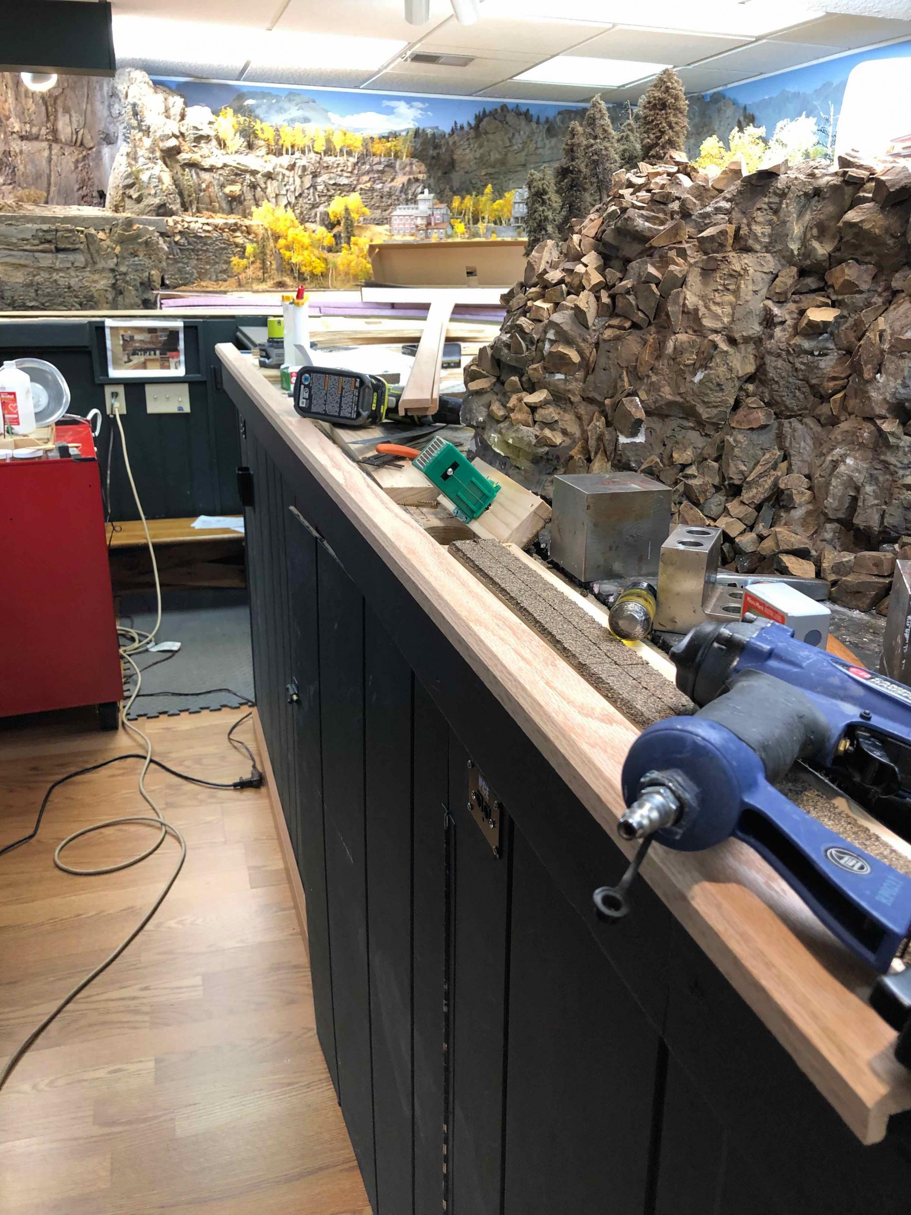

Here are a few overview progress photographs of the area I'm changing.

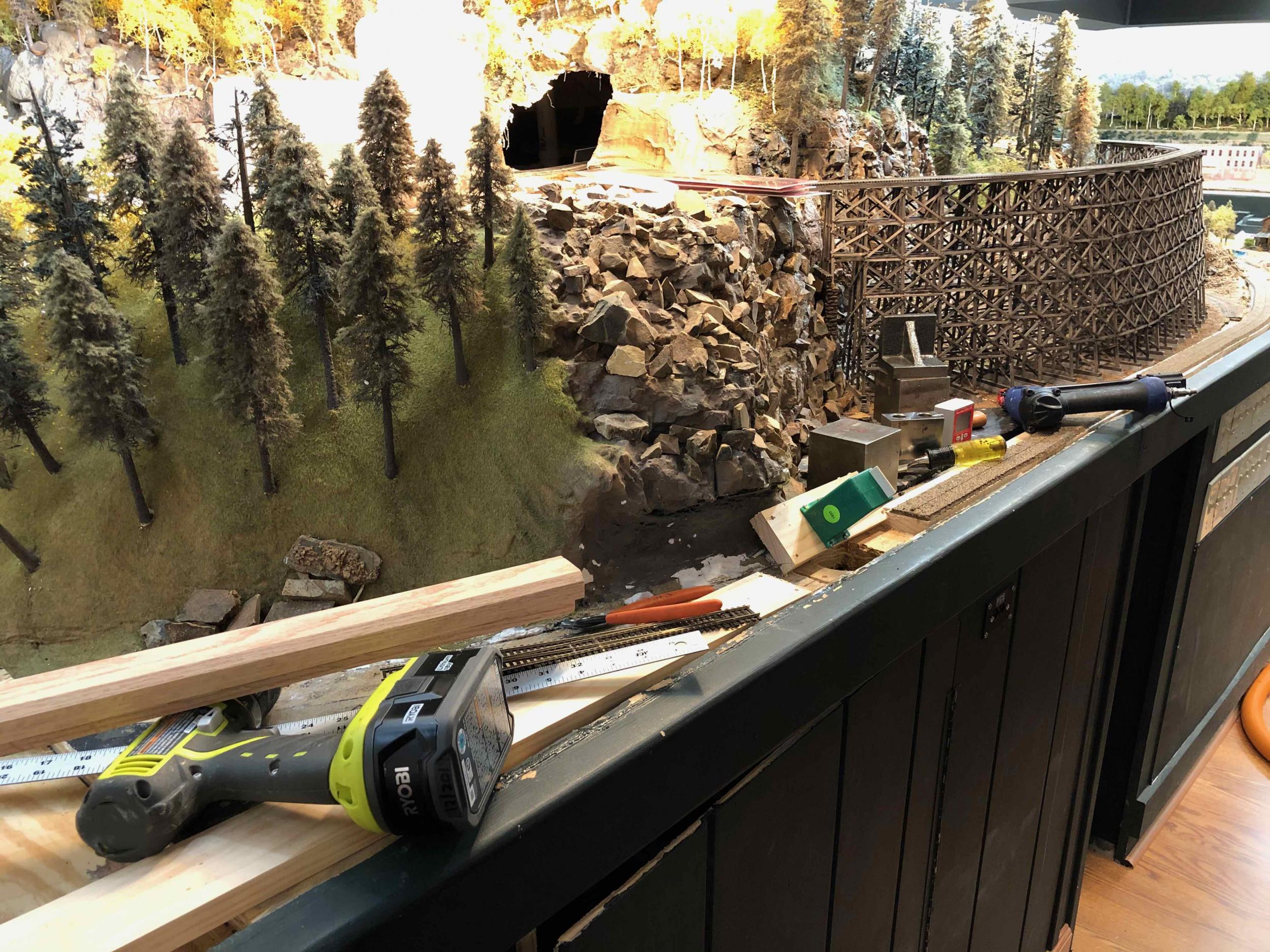

The ramp back down on the other side of town.
