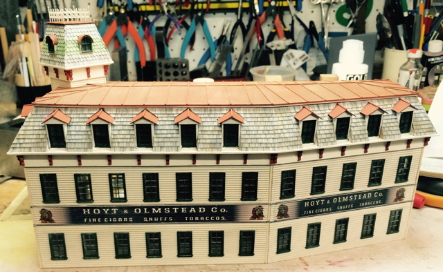

« on: August 31, 2015, 10:57:29 AM »

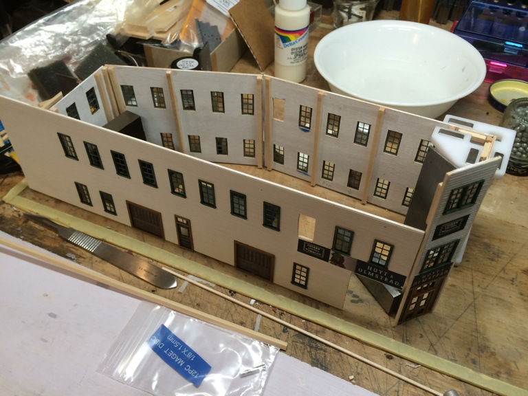

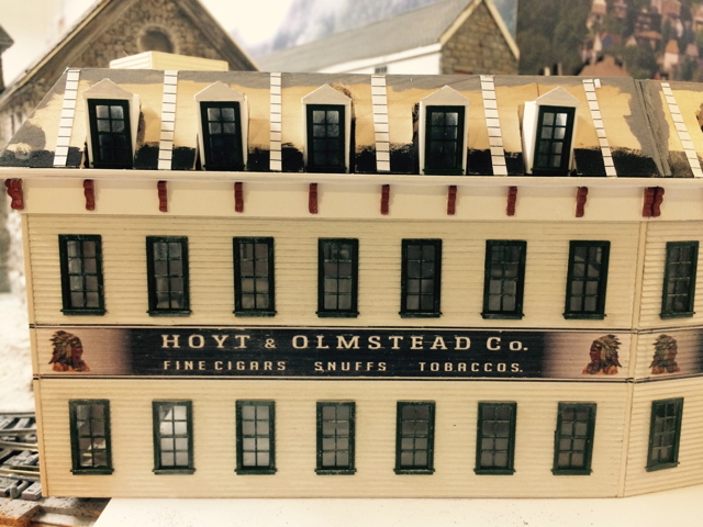

Here's a quick summary of a multi-year project.  I was visiting Craig Bisgeier's Housatonic RR in 2009 (!!), and we were discussing structures, getting information from Sanborn maps, etc.  I asked, "that's a nice spot, what goes here?"
Craig said, "It's a cigar factory, wooden building according to the Sanborn Map."  We discussed it, including the lack of good Victorian mansard roof structures, and I offered to build that.  I did some quick measurements of the site, both the ground plan and that change of elevation leading up to the brick building.  We exchanged some sketches, and eventually (a year or two :-) ) later, I sent Craig a mock-up, which he printed out, assembled and tried in the location.
The basic "look and feel" was good, but the structure was a bit small compared to the brick building behind it, so I adjusted that.  We also captured the topography a bit more accurately, to make sure the foundation would fit on the site.

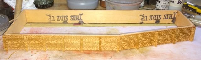

The foundation uses Monster Modelworks cut stone.  One thing I've seen on large stone walls on the prototype, but infrequently on models, are buttresses to take some of the lateral pressure from the walls.  Jimmy Simmons cut some of his stone corner pieces with a 3rd side of relief, which I then shaped into buttresses.  From that, I assembled the foundation.
I primed it the mortar color and then applied Pan Pastels to color it.
The walls were done with Mt Albert clapboard and Tichy windows, pre-painted before assembly.  Craig and I worked up some sign prototypes.  Craig did the finished artwork in Adobe Illustrator (which allows me to print at highest resolution) and I printed them onto color laser decal paper.  Here's a mock-up of the the signs, work-in-progress.
I did an angled tower entryway, which looked great on paper, but turned out to be a bit of a pain to actually construct.  The entrance door is an old cast metal part, and the large picture windows are scratchbuilt.  The project languished for quite a while while I pondered how to do the mansard.

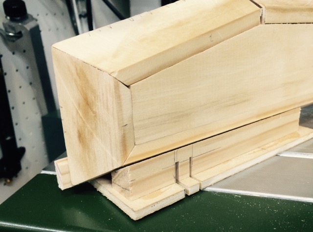

Eventually I decided to cut the mansard subroof pieces from 2"x2" stock on my regular table saw.  I assembled everything using thick wood and a lot of bracing, because I knew the roof would get a lot of handling. The roof fits snugly over the siding, thanks to the brackets and (thin styrene) trim at the top of the walls.
I rigged up a jig to cut the slots for the dormers on my modelers (Proxxon/Micro Mark) table saw.
The dormers required a bunch of similar sized parts for sides, gable end and roofs.  The sides I cut from styrene strip (so I could use styrene cement to glue the windows to them).  The modeler carbide saw blade kerf is .060 wide, a piece of serendipity.   The dormers were assembled and glued into place.

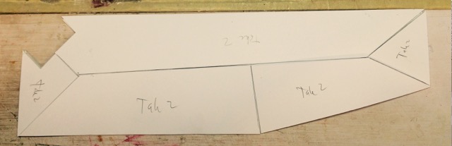

Because of all the angles, I did a lot of cardboard templates.  The hip roof at the top of the mansard was particularly complex and needed to be exactly right.  It took me 3 sets of templates to make it so.
I used styrene for details and where I needed to do small part assembly or thin cross-sections.  I used large pieces of wood for the base and the subroof, and of course scribed siding for the walls.  The shingles are Northeastern Scale Lumber paper slates, which I special-order unassembled.
I delivered the foundation to Craig earlier this year, so he could "dig it into" the location on the layout.  The remaining structure will be delivered at Mid Atlantic RPM in September.
If you have any questions on specific items, let me know.

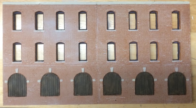

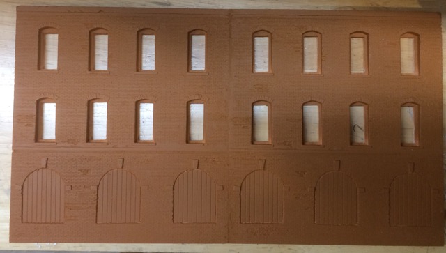

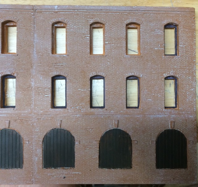

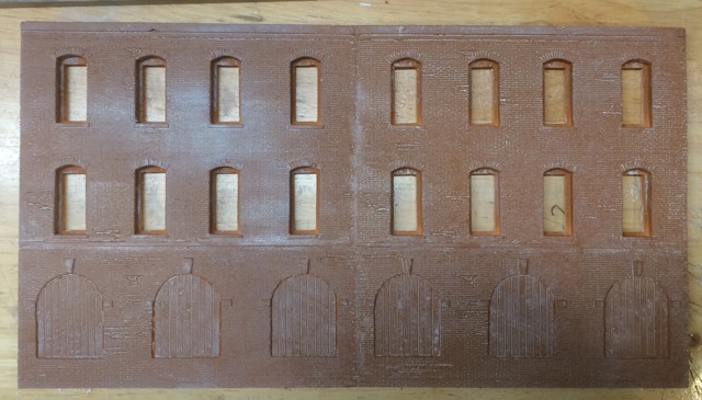

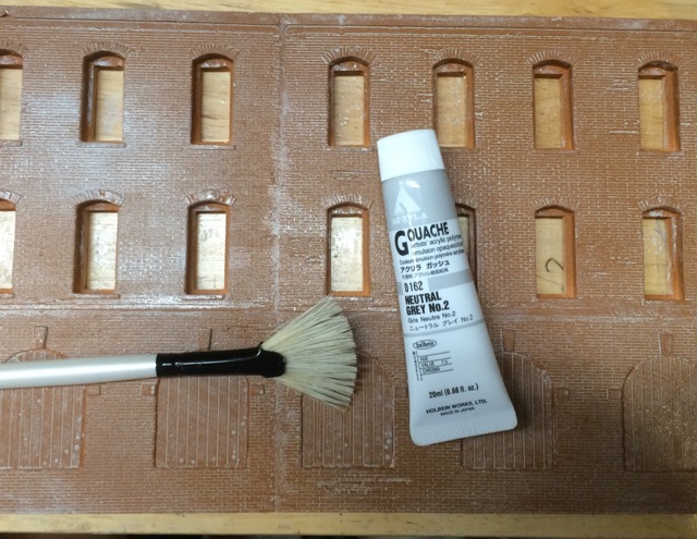

Here's how I did a Downtown Deco plaster-cast brick wall.  (This will be a flat that sits behind my roundhouse, one of these years...)
First I prime the casting.  This gives me a uniform sealed starting point.  The color here is Liquitex water-based spray paint "raw sienna."
After that sat for a couple of days to be well sealed, I applied a wash of thinned artist gouache.  (Gouache is 'opaque water color', water color paint with very fine marble added to it to make it opaque.)  The wash was the consistency of milk.   The color I'm using is Neutral Gray #2, a light gray that isn't quite as stark as white, so it looks a bit weathered), thinned with "wet water" (water with Liquitex Flo-Aid added.)  As the paint dries, the effect goes down.  If you want more prominent mortar, use a thicker solution (more paint.)
And the full wall with the mortar:
Then I painted the wood doors with artist burnt umber, to which I added some white.  I also painted the insides of the window openings a dark color (in this case, "Midnight" dark blue, because I will eventually do the window castings in dark blue.  I painted the full well, to get a dark shadow effect.)
I used a Vallejo "brown wash" (new product) to color in the cracks by the doors, getting rid of any white or red where there should be shadows.  The wash flows nicely into the cracks!  I also painted the stonework a beige color with craft paint ("sandstone")  I had to give this 3 coats to get even coverage.  For this work, I used a 1/8" angle shader brush, which makes it easy to control.  When I got a bit of the sandstone paint where it didn't belong, I 'erased' it using a damp rubber tipped "colour shaper."
Before adding windows and glazing, I need to 'fix' the work with a matte finish (since gouache will wash off if any moisture hits this.)  But first I want to think about adding some variation to the brick color.  Right now, particularly since this is a background building, it might be good enough.  But I will want to add downspouts (in part to hide the seam in the middle of the wall) and to give a bit of texture to the flat.
Yesterday I made the huge mistake of trying to spray prime the (Tichy) window castings.  It was too humid, and the result was "popcorn".  Fortunately, I was able to scrub off the gunk, and will re-prime today (using the airbrush inside, rather than the rattle can outside.)  Then I have to find where I put the clear laser-cut glazing for these windows :-(
