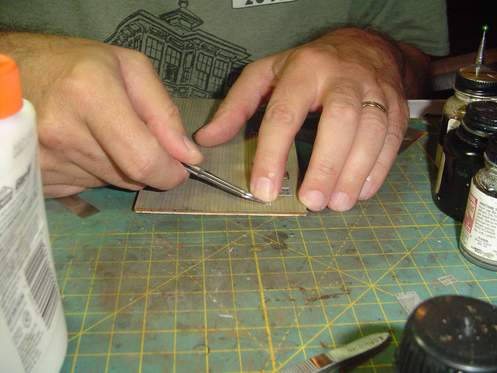

Next I cut out the signs that would be used on the main structure.  This is the first time I've come across signs in a kit where they were two sets.  One unweathered and one old and faded.  I chose the old and faded one.  I used a steel ruler and a sharp #11 blade in an X-Acto handle to cut out the sign.
I sanded the back of the sign with an emery board to thin it as much as possible without going all the way through it.  Take care doing this as the sign can crumple or rip.
Following along with the instructions I applied full strength Elmers White glue to the back of the sign.  Normally I'd thin it with a little water but this time I opted to do what the instructions say.
I smeared the glue around the back of the sign using a finger tip making sure the entire sign was covered with a thin layer of glue.  Gotta get dirty when model building.  There's no other way!   ;D

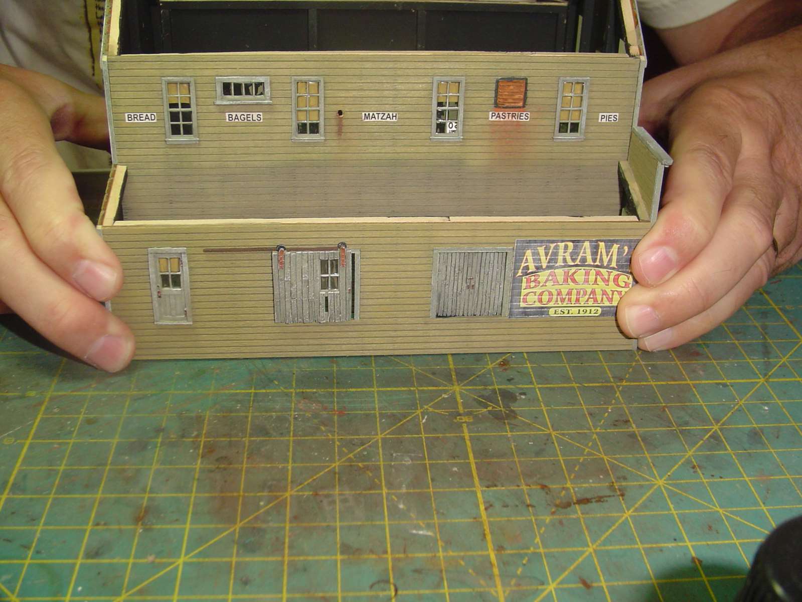

Again, I followed the instructions regarding the placement of the signs.  Bear in mind that there's a loading dock that will be attached to the wall so the sign shouldn't be too low on the wall else the bottom edge would be covered by the loading dock.  That'd be a problem.
More in a few.... ;)

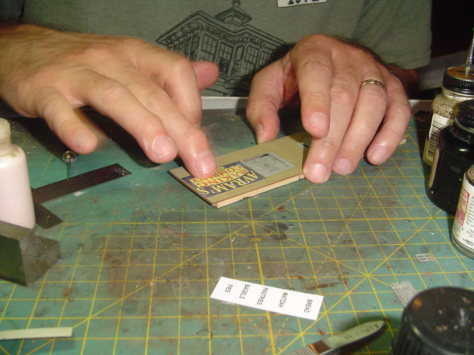

I used a fingernail and carefully (emphasis on carefully) worked the sign down into the joints between the boards to help make it appear painted one.
After brushing some light gray chalk powder over the smaller signs I cut them out following the guidelines and applied them to the walls per the instructions.
These were relatively easy to keep in line using one of the joints as a guide.
Some rust color powders were applied beneath the vent and a hole drilled for a smoke stack that will be installed later on.
Woo-hoo!  It's time to start joining walls together.  One side wall to the front and the other side wall to the rear.  Nice an square.
After the two assemblies are glued together the other walls can be glued in place.

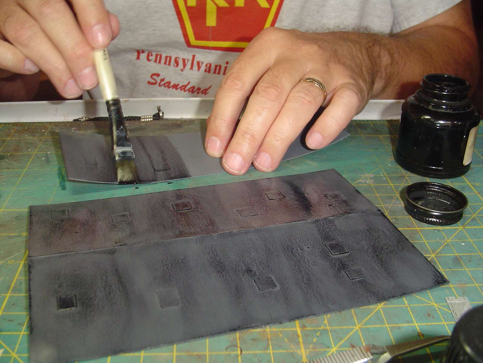

I cut the underside roof out of the cardboard stock and trimmed it to fit.  Nobody's going to be able to see this (except the little people loading and unloading freight) so it doesn't require painting or weathering.
Now it's time to work on the roof cards.  First, prior to painting, some small patches are glued in place as indicated on the cards.
These are cut from the rolled roofing material included in the kit that will be used elsewhere.
Next the roof gets painted using a combination of Reefer Gray and Grimy Black.  I just dipped my brush in both and started painting.  The paint mixed as I brushed it on.
After paint dried I hit with my A&I mix.  The card stock warped a bit but it straightened out later when bracing was applied the roofs were glued in place.
