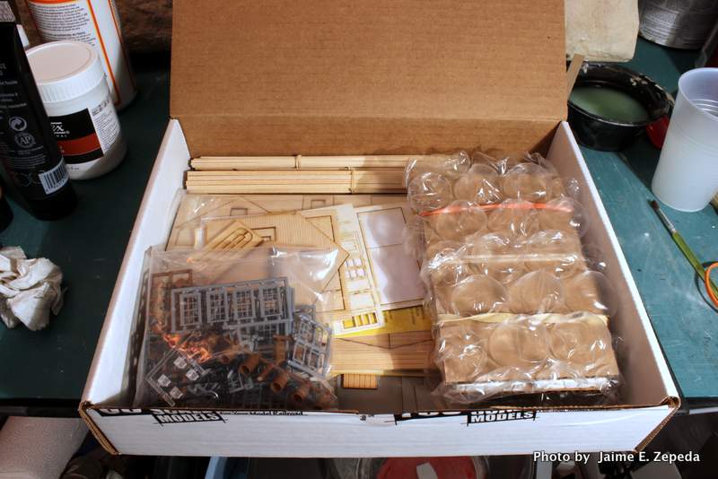

And here is all the kit's goodness ready for all the fun.

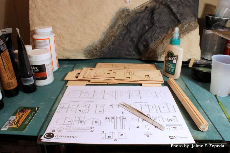

First step is to brace the wood walls with 1/8" bracing according to template C.
I'm building Oyster Hill...

Hi everyone. When Jaime says he's ready to build.... IT"S GO TIME! During this build I would like to throw in a few tips that I like to do while building craftsman kits. They are more for the newbie than for the experienced builder. First off, I carefully cut the walls from the wooden sprues. When this happens you find that there are small nubbies that need to be sanded off. You can see these in the picture with the pencil. I go through and sand all of these off with an emery board. I then number the backs of the walls and wooden pieces. This is for easy reference to the template. When you build these larger kits, there tends to be a lot of walls and things can get a bit confusing really quick. The next step is that I go through and check to see that I have all of the walls that are on the template. Once I have the wall I draw a line under the number. In this kit, all pieces are accounted for and a call to Doug is not needed..... so far. I then go ahead and brace the walls..... This takes a while so be patient....
chooch41
Another kewl tip..... When you are done cutting all of the pieces off of the wooden sprue, you end up with a small pile of wasted wood. I keep these and use them as test pieces for paint. I'll paint a bit on them, label the back with what color and brand of paint it is and then in the future when deciding what color to paint something, I can check these and see what colors I might like to use..... Thats it for me for this evening. I have a busy day at the bench tomorrow... Here In Ottawa Canada, it is roughly -29C. I will stay in doors and work on my kit all weekend.

It should be noted that the bracing template shows the *back* of the walls. Some walls are mirror images of their mate and well, you could end up bracing the wrong side of the wall...
Brad makes a good point about sanding the burrs of the laser cut walls. And, be careful when removing the walls from their carriers. I've already broken one wall. Luckily it broke right where the bracing goes so it's not noticeable and with the bracing it's now stable.
I got to get moving. There are some 43 walls in template C.
