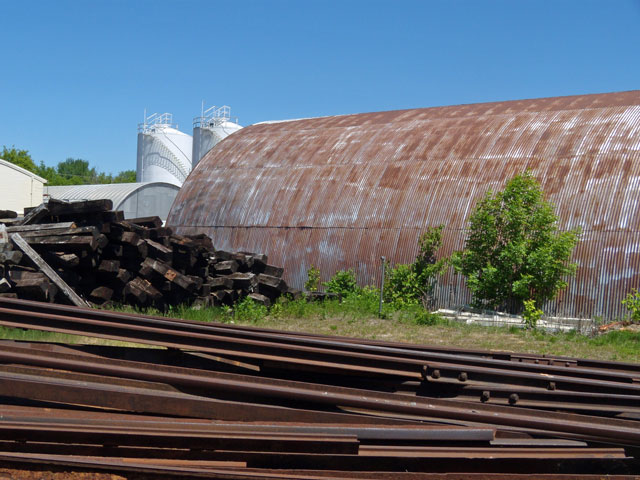

I've been away for over a week, but I'm doing some thinking, planning, and a little work. First, Brett and Bill Michaels did their corrugated metal panels by spraying with a gray primer, baking them for three minutes at 350℉, and then applying Rembrandt chalks, mostly varying shades of the rust colors. While they both look great, they are different looks from what I am trying to achieve.
I've a file of rust photos, and Dustin recently posted one that I've tried modeling a few times without any real success. Here is his, and another I took of a quonset building.
Notice how the rust is streaky and splotchy, but doesn't really blend gradually from one shade to the other. So this look is what I'm trying to accomplish. I actually cut extra panels from some additional corrugated I had on hand (I also got to use my nifty little panel cutter some more! One side of the upper roof I finished the way Brett and Bill did theirs. I think Brett gave credit to Roger Malinowski for this as well, and I read Roger's treatment of this method as I also have his O scale version of this mine. Mine turned out OK, but my gray primer was a little too blue, and the rusting effects too uniform. So then I got out the Evil Etchant, and next time I'll show you how that turned out. I wind up putting both treatments on opposite sides of the same roof, tacking them in place so I can choose which I like best.
