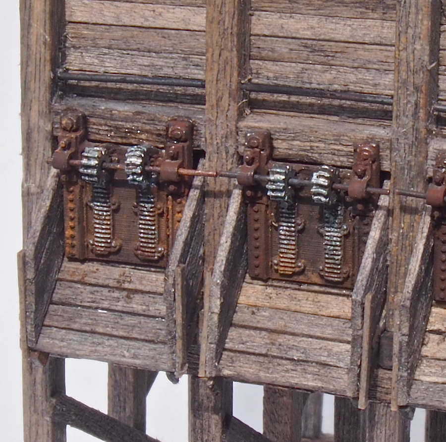

I'm plodding away and I'm finishing up the ore bin. One tool I use whenever I can is 3M 465 transfer adhesive. Perfect for adhering the boards to the paper side wall templates. Again, I make a copy of the original template in case I screw it up. Using the tape instead of glue is quicker, neater, and of course makes warping not a factor.
A few months ago Brett put me on to Jax Pewter Black as a replacement for the A-West Blacken-it I had used for many years. I think the Jax adheres even better to the white metal castings, and I also find that it does a great job on brass wire. Shown are most of the castings after a minute soak in the Jax, then rinsed, but before buffing with Q-tips, felt wheel (from Dremel- hand held on the little pieces), etc. Some will also get chalk and/or acrylic paint. Brett's castings get better and better, which I thought impossible. This is one great kit- I'm anxious to use some of the other jigs and templates included.
mike.engler59@gmail.com
Mike Engler

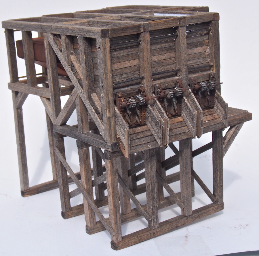

The last three pics are of the bin with all but a few details to be added. Some clean-up is needed, and I need to figure out some more or different on the gates. Animated (working) gates are probably not going to make an appearance. At least I'm thinking about it- kind of like I always think I'm going to add lighting to my structures and dioramas. Like my logging models, this was from an era that pre-dated electricity.

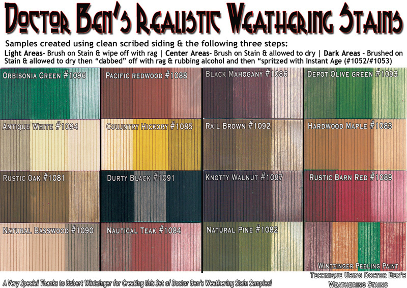

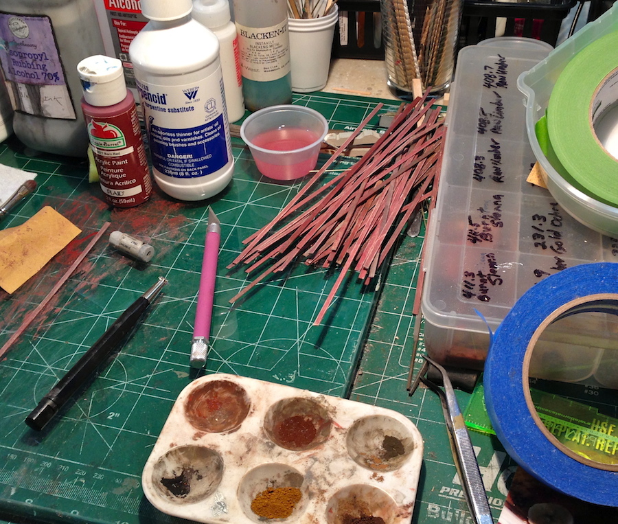

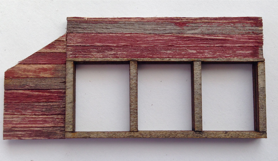

Thanks Dustin, UP Fan, Marty, and Bob. I've started the tipple house and I'll try to make a few points not already covered. I find out that modeling "faded" barn red or boxcar red paint is even more difficult than "peeling" red paint. After researching Google images, a Dr. Ben chart, and some trial and error on the kitchen counter, any natural fading of most red shades becomes pink. Here are some examples:

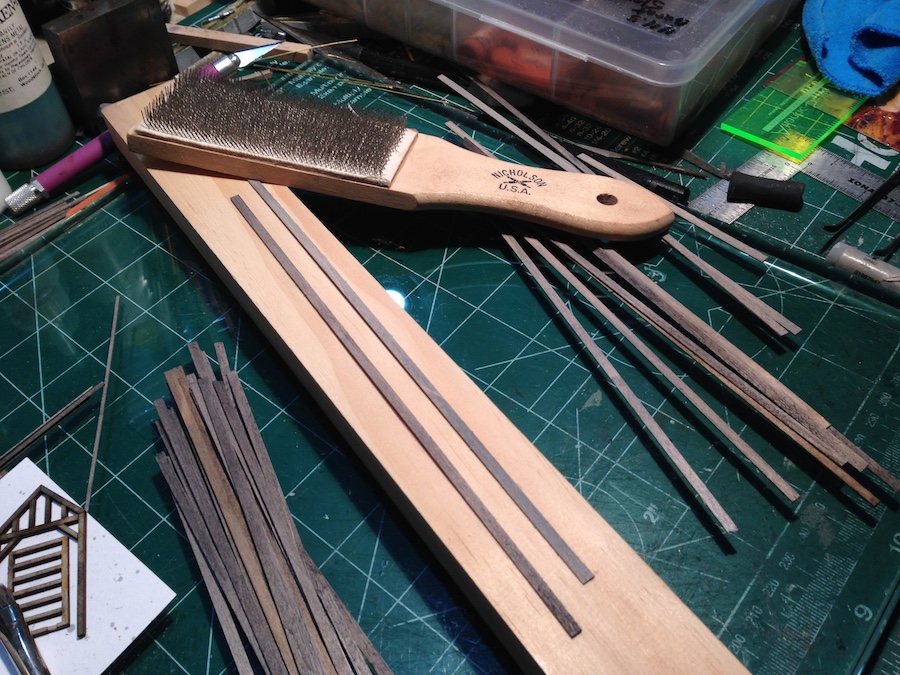

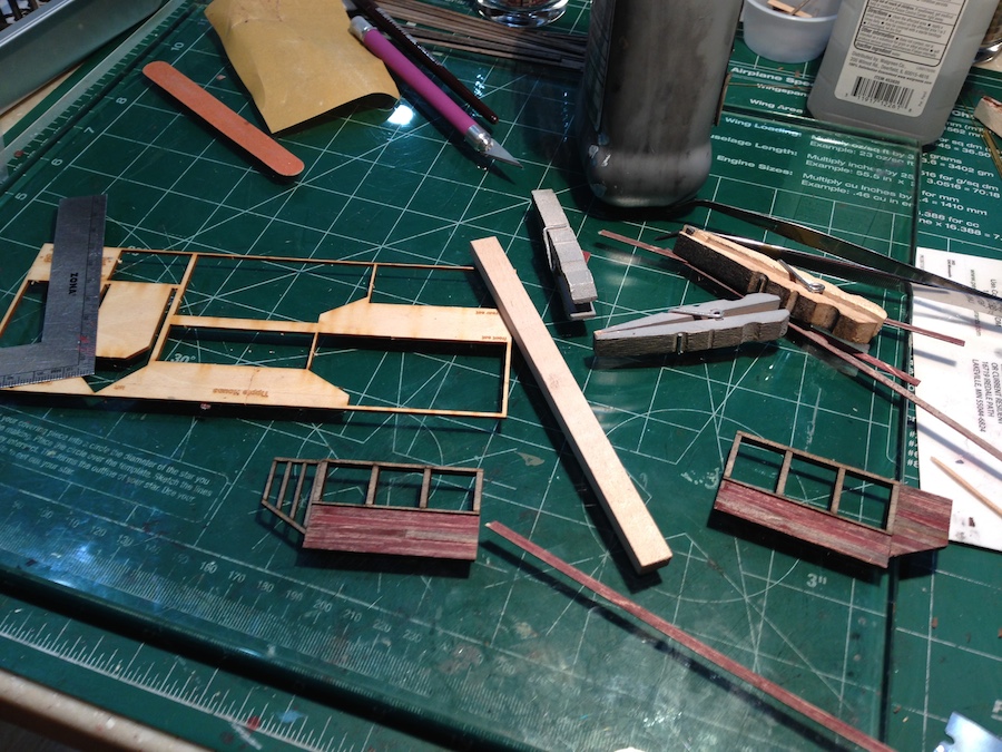

After I painted all the siding boards Apple Barrel "Barn Red" 20577, I sanded lightly as Brett suggested one hour later. I only did half, and results aren't as good the longer past one hour you wait. Since my base color was the grey A/I stain, just the right amount of sanding left some of the A/I intact. Too much sanding and I had to reapply more A/I, or add some alcohol and gray chalk with a fine brush to the bare wood areas. I also used a scratch brush from Micro-Mark that works like a mechanical pencil, especially for board ends.
I've gone back and forth, and have had several discussions with Dustin on nail holes (nail heads). I've probably participated in two dozen threads over the years debating the subject. I believe from 100+ feet away you wouldn't see average size nail heads on most wooden buildings. I've put thousands of nail holes on models over the years, but no more on HO models. The biggest reason is: It's easier not to.
When sanding one or more painted boards I found it easier to NOT round the corners by placing them on a 1" X 2"- somehow it was easier to sand them flat and not the edges.
So after all that I have built one little wall (actually more than that but this post is already way too long). The result isn't great, but is something I can work with. These big close-up
photos are for my benefit, not yours. They not only humble the builder, they tell you where all the warts, fuzzies, blemishes, glue spots, and shiny spots are. Your cell phone camera is one of your most invaluable tools.
