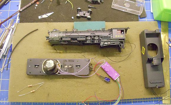

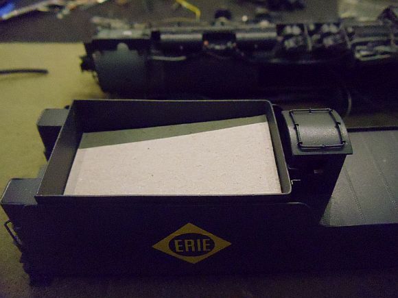

Here's as quick update on Frank's loco.
I started the sound installation this morning prior to going to the airport to drop off a friend.
I'm installing a Heavy Locomotive  Tsunami decoder. This loco would qualify for a medium one as well but I like the whistles on the heavy loco decoder. This decoder came out of my ACL R1 4-8-4.

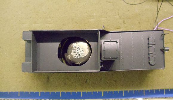

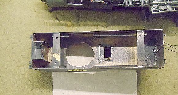

I positioned the 8 ohm speaker on the tender deck and glued it in place.
I made a test fit while the glue was still wet to make sure it was in fact the correct position.

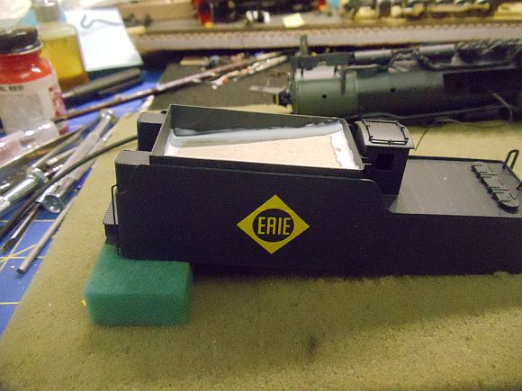

Since there is a slight opening in the coal bunker I needed to block it off so the coal load will not fill the opening.

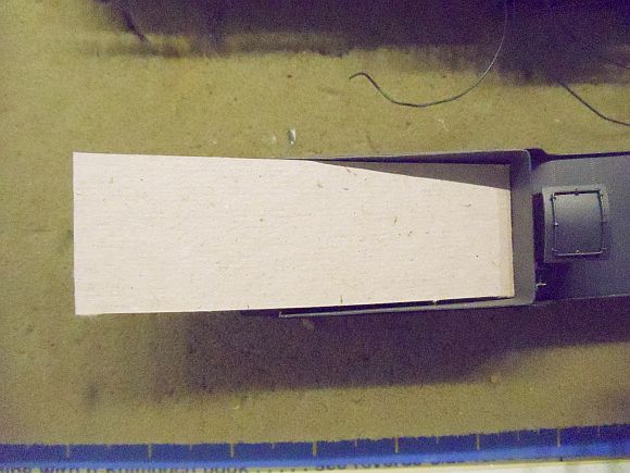

I started by cutting a piece of cardboard to fit the opening.
I cut the insert a little long so it would not fit length wise in the tender. You can see it slopes from back to front.

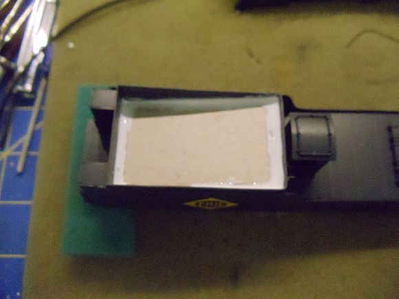

I then added some glue to the edges of the cardboard.
I then placed the tender on an angle so the glue would dry flat and not all run to the front of the tender.
Continued tomorrow.

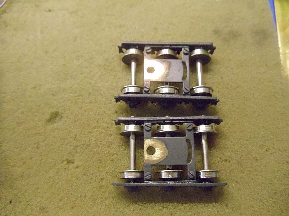

I forgot to add this little part to today's thread. For the best electrical contact I can get between the tender trucks and the tender bolsters, I polish both areas. In the photo below you can see the top tender truck has been polished and the one on the bottom hasn't.
