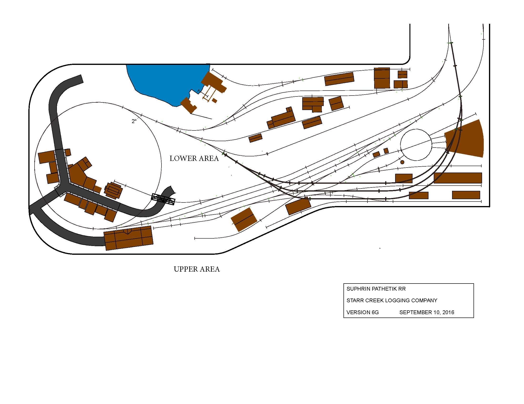

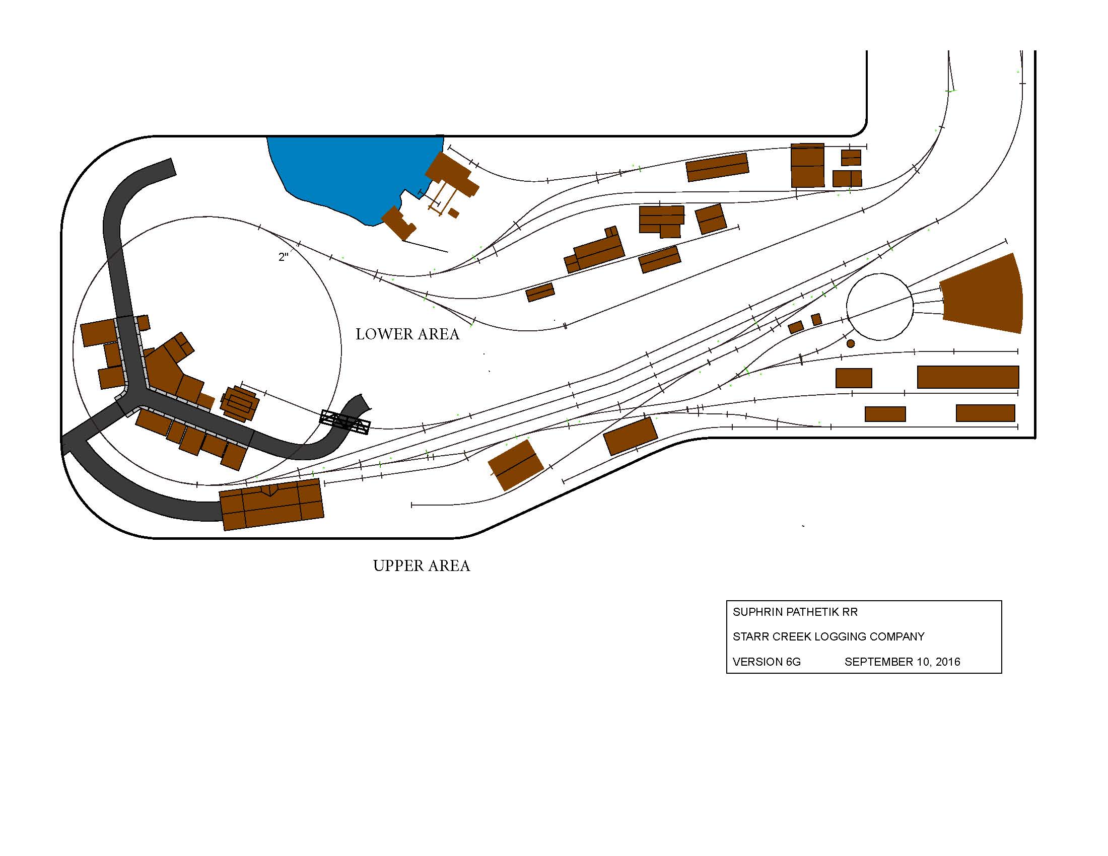

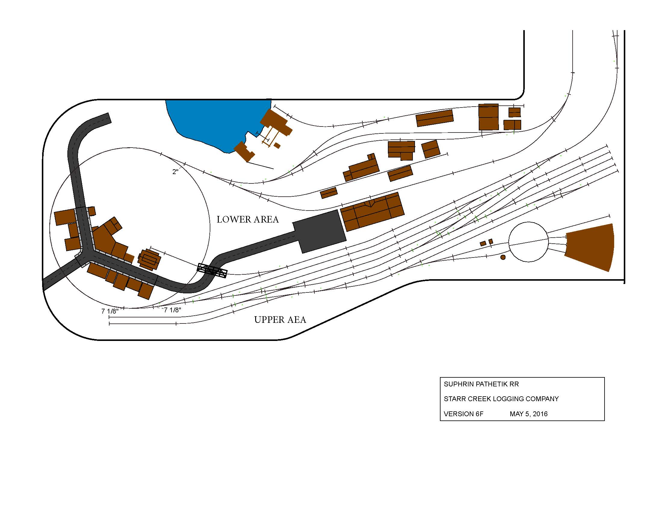

I have revised my track plan as mentioned before.
This is the original track plan for the main yard.
This is the revised plan for the same area.  It will allow more switching opportunities and provide a more interesting track plan.  This will be the interchange for the Suphrin Pathetik RR and the Southern Pacific.  Since this is a short line railroad, I do not need all the yard in the first drawing.
This is the revised plan with the staging area in the heavy lines.  The staging area is hidden under the upper area and will be easily accessible.  I am showing the staging tracks separately to cause less confusion with what I am trying to do in the old yard area.  The trains will interchange on the upper area and the Southern Pacific will go down the helix and held into the staging area until time to remerge.
So even if you thought you had the best thought out plan and had drawings for it, Once you get started with construction you change your thoughts and make the appropriate changes and drawings.

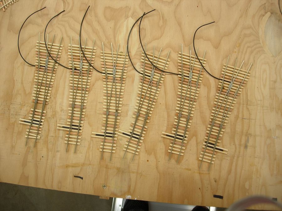

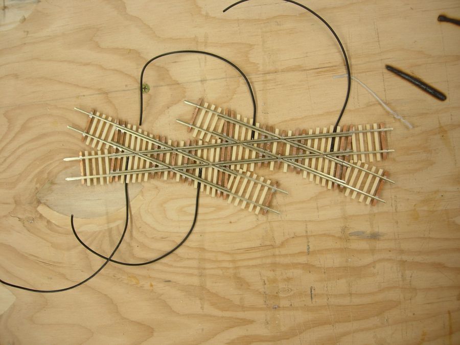

Ok, I finally received the remainder of the turnouts for my railroad.  This batch was custom made by Oak Hill Track and Supply.
Double Crossing
3 Way Turnout
No. 4 turnouts

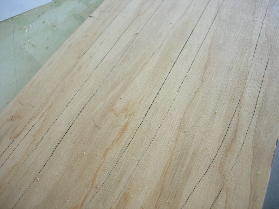

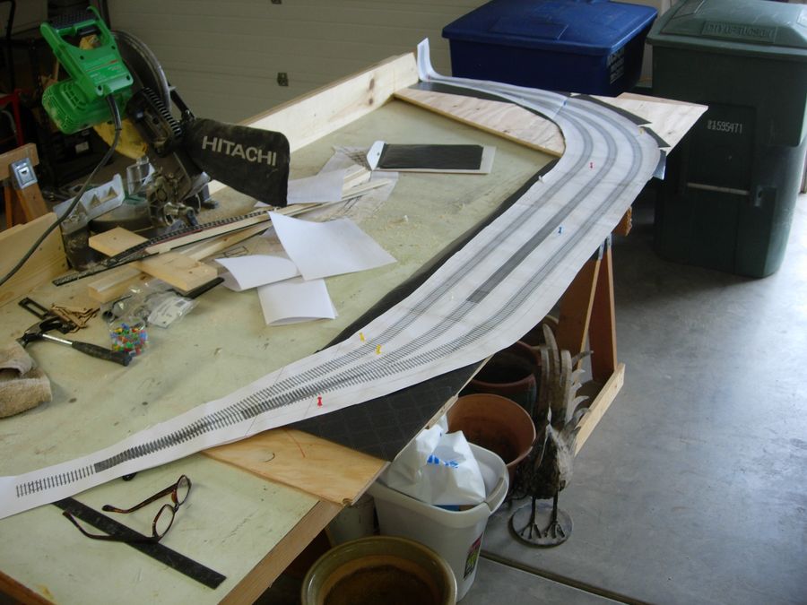

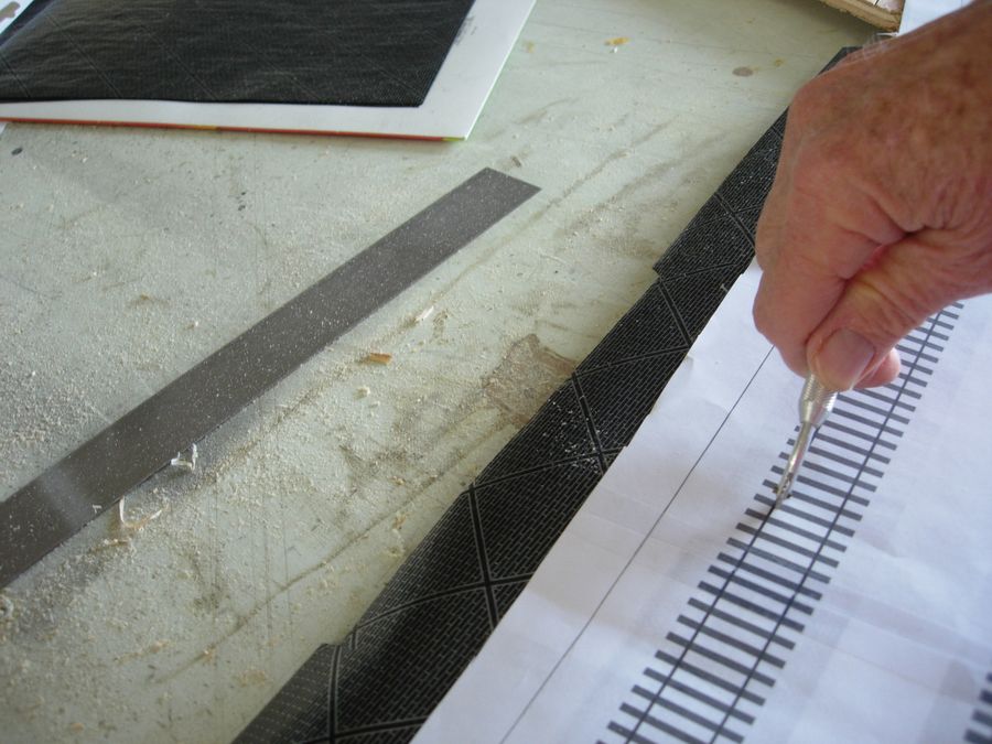

Now I can get back to track work.  I am prefabricating the staging area that I am adding to the layout.  This is because it will be under the upper yard and industrial area.  So I had a full size print of the staging track made to use as a template for the sub road bed.  I took the following steps.
1) Placing Template
2) Carbon Paper
3) Using pin wheel to transfer template to plywood sub roadbed
4) Results of use of pin wheel
