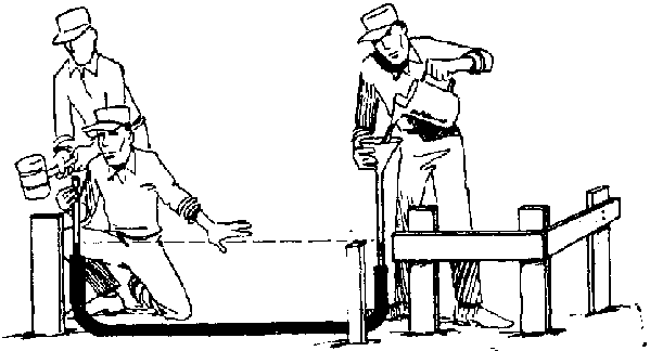

« Reply #56 on: March 11, 2016, 12:33:23 AM »
That's a fact ....
I'm stuck with old school stuff like a level.
Oh... And stuff like put down a strip of flex trak and roll a Central Valley truck across it and see if it leeks going.  I need to wind my watch into the twentieth century.
See ya
Is this what you use Bob??
Thanks,
Donato
Biding my time till I can start my layout and build nice stuff like all you folks .... (said with envy). :-)
  • Boise Nampa & Owyhee RR
  • Modeler's Hero 500+ Posts
  • Posts: 2584
  • Karma: +3/-0
    • View Profile
Re: SP RR
« Reply #57 on: March 11, 2016, 08:39:25 PM »
Actually that is a pretty accurate method.
In my earlier life when I was doing engine swaps, we would put a glass of water on the engine intake manifold and level the three engine mounts.  This was necessary because float chambers in carburetters were unforgiving about this stuff.
See ya

I've used the water level method several times. Mostly on setting footers when I built the train room. Of course a clear hose is necessary but really comes in handy when the ground ins't level. It is also very helpful when you want a level over 8 feet long.
