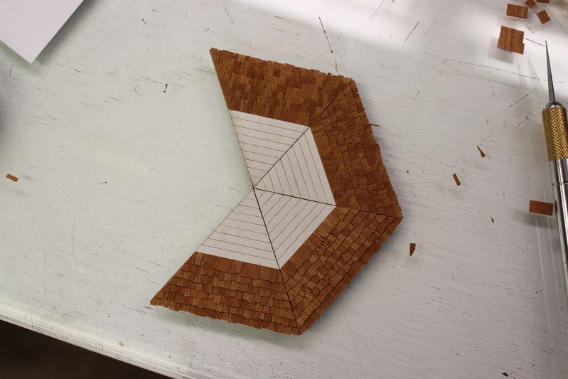

I got most of the tower shingled this weekend, I took a break to add the other staircase and awnings.
For this roof I got a little smarter and cut all my shingles into this bottle cap. When I was doing the welding shop roof I just made a big pile of them on my workbench. I tend to breath heavy when I'm concentrating and I ended up blowing them all over the place.
Before I got started I made a copy of the roof card, I used it as a guide to cut the edge pieces. In the past I've used scissors to trim strip shingles but that wouldn't work for the individual shingles.
Moving along with the shingles.
The hardest part so far was the very top, I kept disturbing the shingles I had already done when adding new shingles.

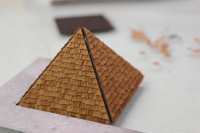

I got the edges glued up before I did the ridges. The roof card comes with a square cardstock piece that goes under the roof to keep the corners square, another great SW design. Simple but very effective. I've fought to keep these types of roofs true in other kits I've built.
I glued a scale 4x4 in the ridge gap to give myself a better surface to glue to ridge cap shingles on.
