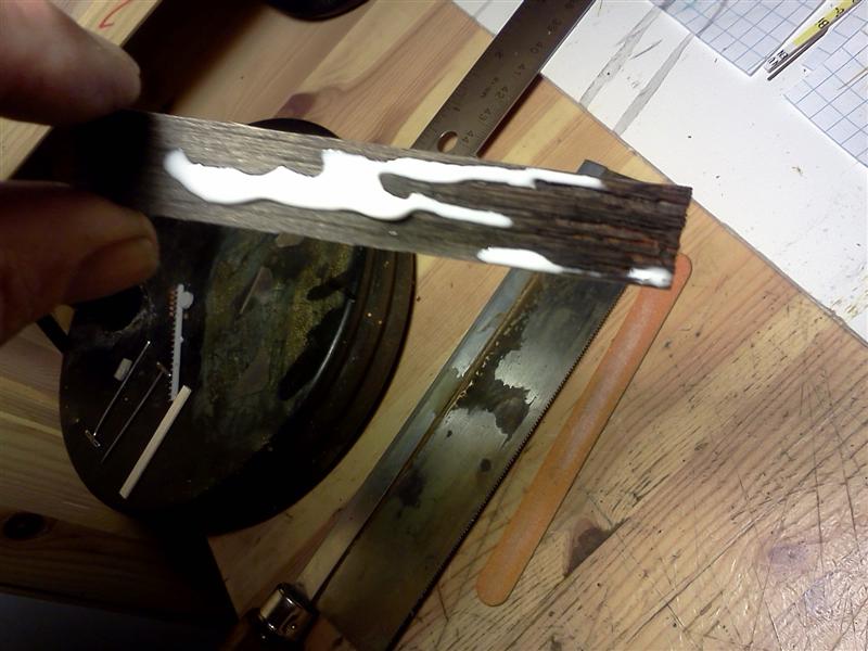

One day, I was using a small piece of stripwood, to spread a bead of white glue more evenly over a broad surface.  I set the stick to one side, went to reach for my paint and oops...tipped the bottle and spilled a little.  Well, that paint went right onto the glue end of the stick.  Not much, but enough.   I did not give it much thought till I picked up the stick.  What should appear to my wondering eyes, the paint was cracked!!!!  WOW!!  EPIPHANY!!!!!
From there, I went ahead and did some practice strips and got the same result, every time.  Before the glue dries, I would paint over it.
The glue dries under the paint and as it does so, the paint cracks!   Many experiments later, I found how to vary the effect.

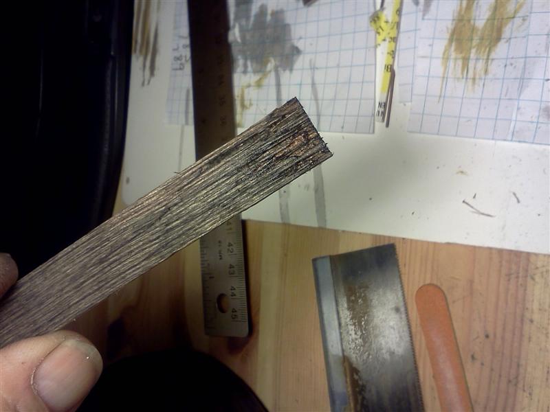

Step 1.  Put the grain into the strip of wood.  I use a razor saw.
Step 2.   For me, it was gouging the bottom parts of the boards.  Aging it and giving it a very rotting and needing replaced look.
              Depends on you of course.  You can leave this step out if you prefer.

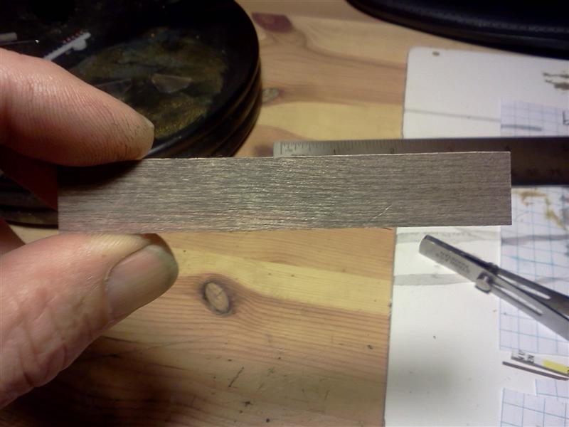

Step 3.  I will stain it with a very dark A/I mixture.

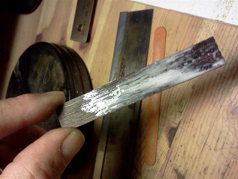

Step 4.  Now I will lay out a bead of white glue.
Step 5.  Then using my finger or a brush, spread the glue to a thin layer.  Try not to get the glue all the way to the top of the board, under the eaves, paint does not crack or peel as much.
At the bottom, I don't let it get into the cuts and gouges that much either.  The wood is missing, so goes the paint.

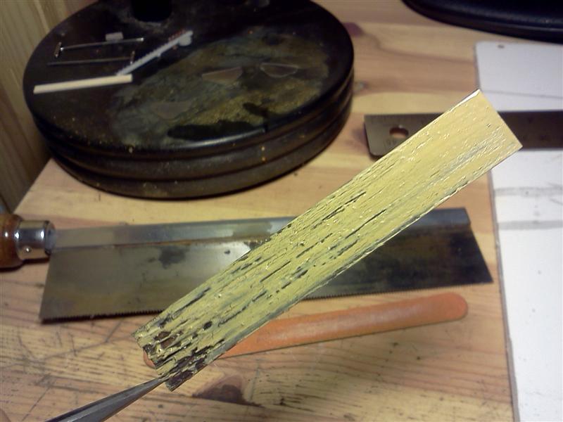

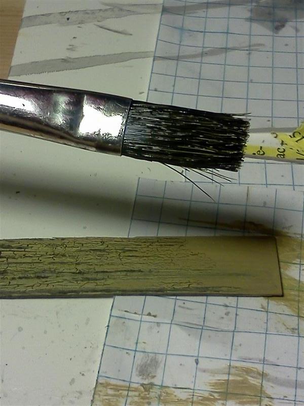

Step 6.  Do not let the glue dry.  Take a fairly coarse brush, dip in your favorite color of choice and in "one swipe only" apply your paint.
             Do not go back over the paint!!  Set aside to dry completely.  Let the process do it's thing!

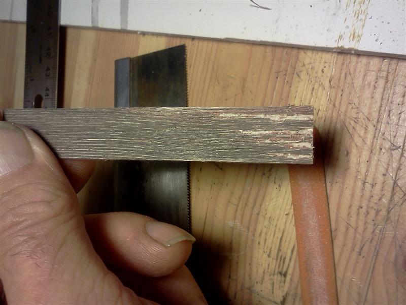

Step 7.  Once completely dry, admire your hard work and realize, this structure will be needing maintenance.
Step 8.  Not finished yet.  Now you will using more of your A/I mix, just brush down the piece a couple of times.
             This really brings out the cracking detail.
