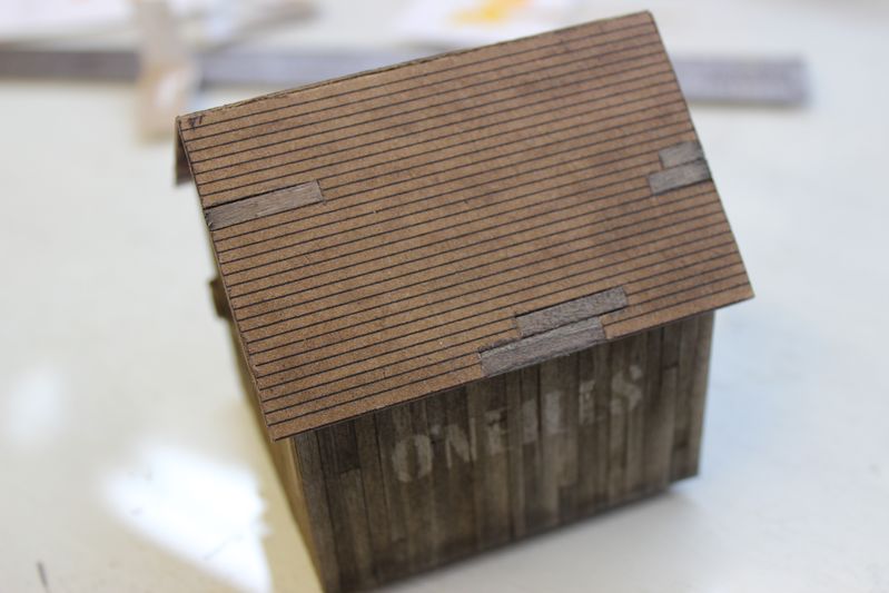

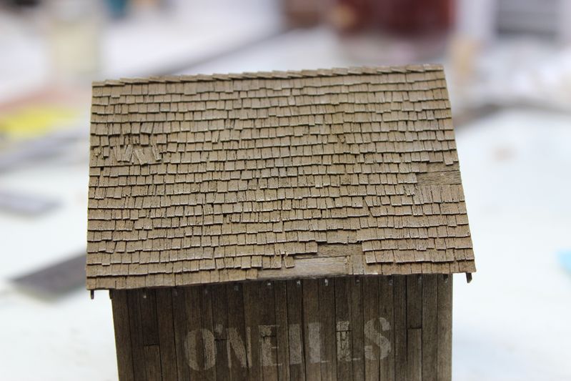

I made some progress on the roof this week.

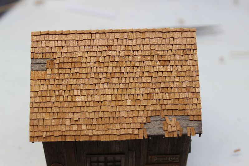

I cut a few sections out of the roof card to give me a few areas to simulate blown off shingles. I used 2x10s to simulate the sub-roof.
I used the same method as my FSM water tank and O'Neills Fabrication for the shingles. Slow and steady, even a worn out roof should have pretty straight shingle rows.

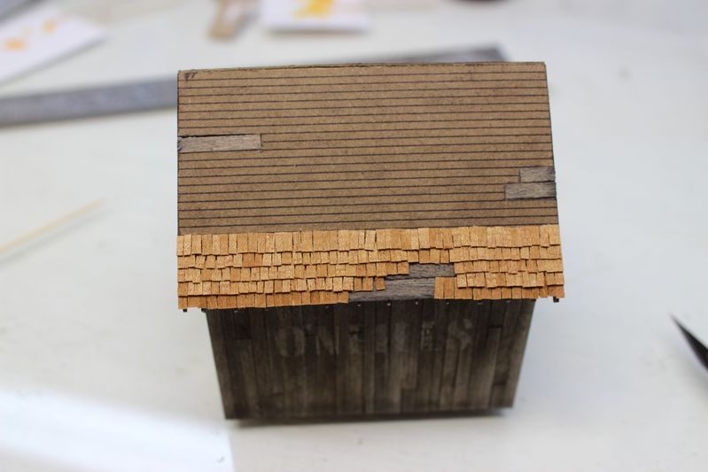

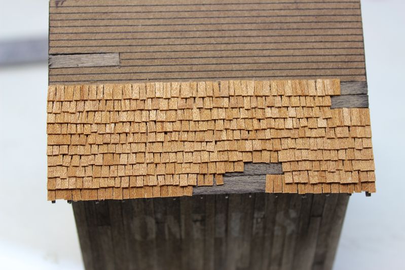

I glued one row on and then jumped the other side. I used as much carpenters glue as I could get away with. I don't want the wire brushing and alcohol to pull the shingles up.
Moving along..
The most challenging part about the cedar shakes is always the ridge cap. I prefer the look of the shingled cap over boards even though both would be prototypical.

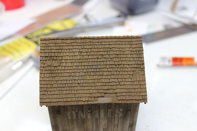

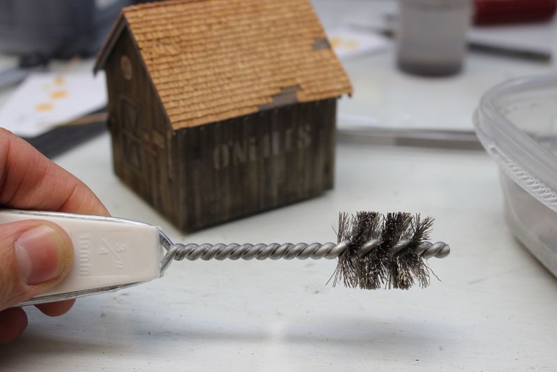

This is the wire brush I used to put some texture into the shingles. I got pretty aggressive with it and none of them came free. I also used a X-acto #11 blade to slice some grain into some of the the shingles especially at the missing areas.

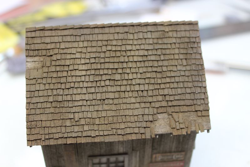

I applied my first wash of alcohol and chalks. I used a few different colors. The main purpose behind this wash was the get some color in between the shingles and on the edges. I soaked the roof in alcohol to make sure the color got everywhere. I let the glue on the shingles dry a full 24 hours before I did any weathering.
I added a coating of some dry chalks. Color is getting where I would like it but it's not quite there yet.

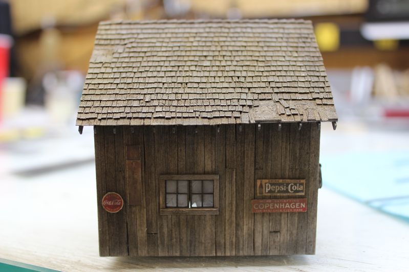

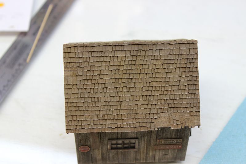

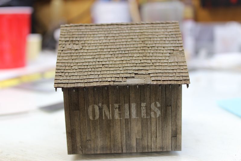

Here is a view from the other side.

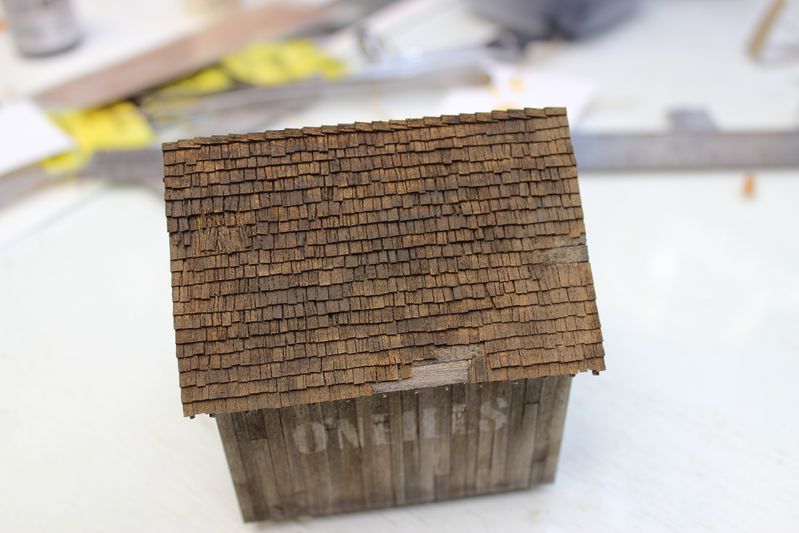

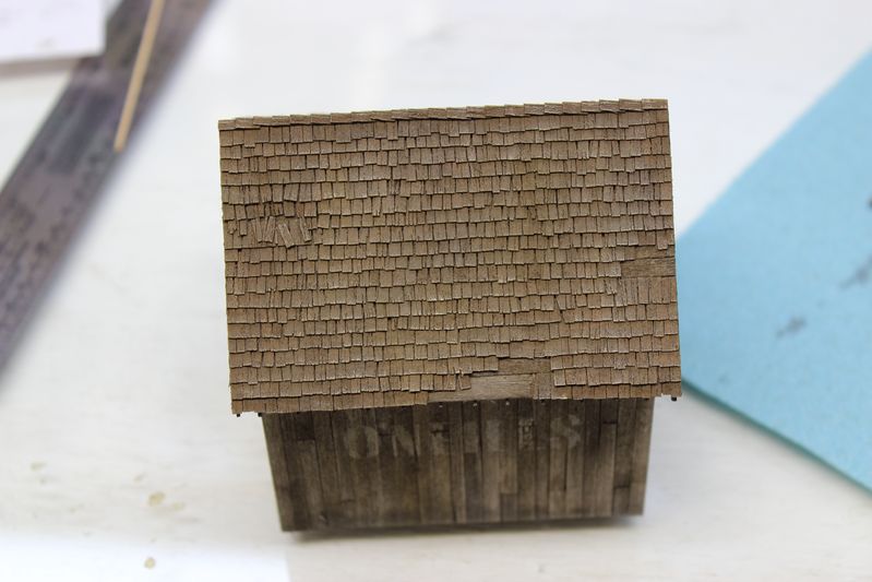

I added some drybrushing of white and gray craft paint.
Here is a lower shot showing the roof texture.

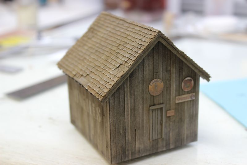

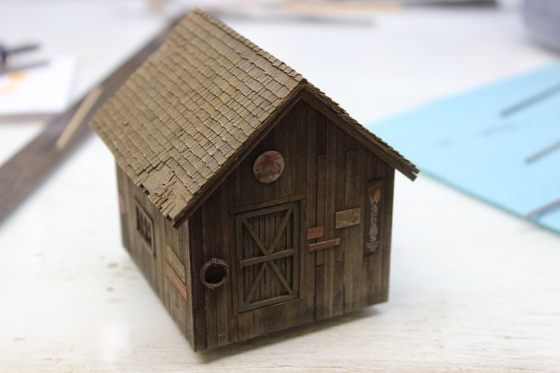

I was concerned about my placement of the lettering but it ended up in a pretty good spot.
Does anyone know of a source for laser cut lettering? Maybe a way to order custom precut stencils?
