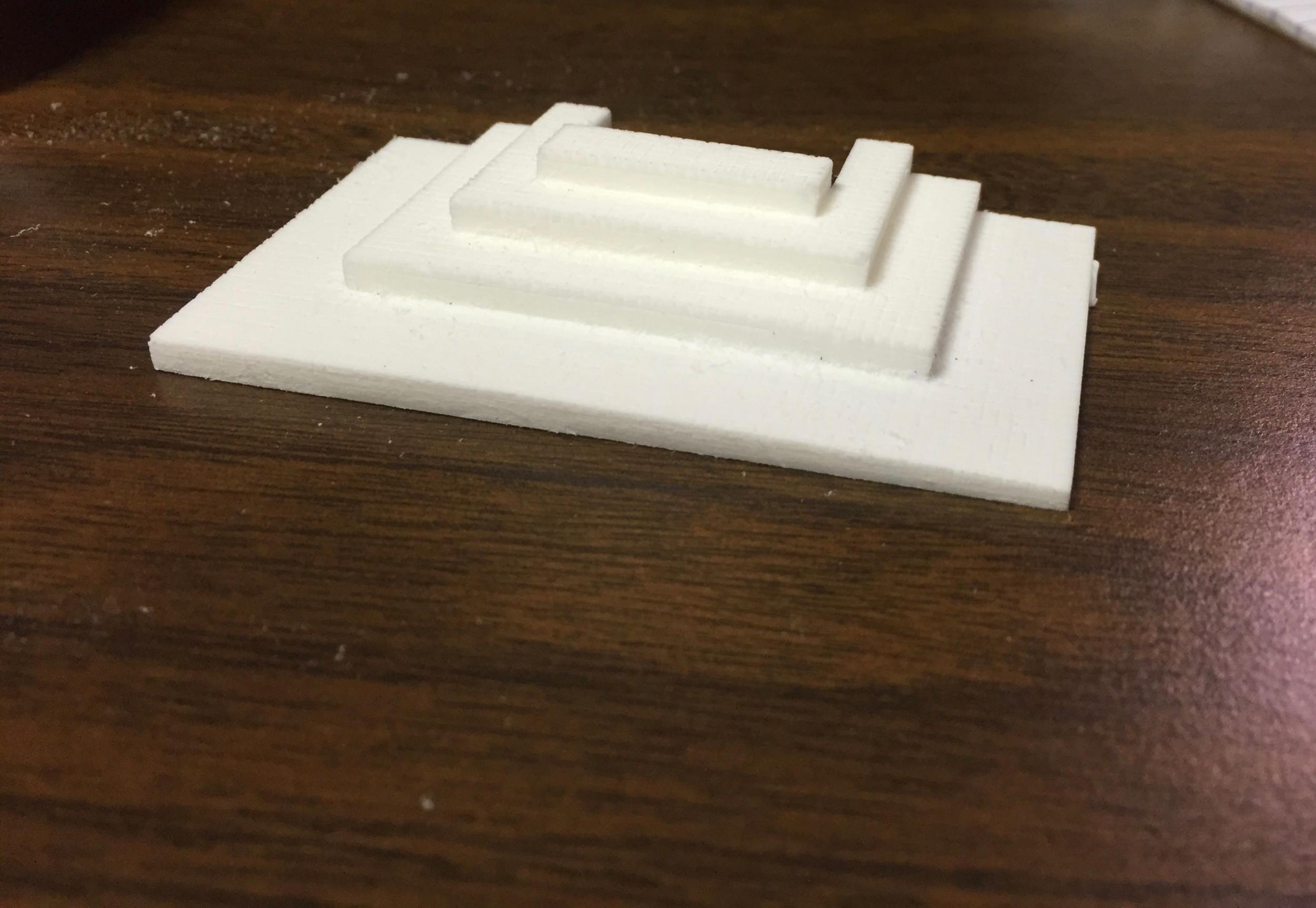

Here is a couple pictures of the casting - trying to show the brick pattern - I know it's hard to see in all that white.

I pulled the resin casting from the mold and we have a piece to work on.  I started the process of shortening the steps by pour the mold a little light so now all I have to do is spend a few minutes on the bench evening out the first step. Tomorrow I will see how well this resign cuts and we will see if plan A is going to work. I'm real happy with the way the brick pattern on the top surface of the steps reproduced. I know it's hard to see in the picture with all that white. Yes there is sanding dust on the casting from me getting started with the process and then remembering to take a picture. ;)
