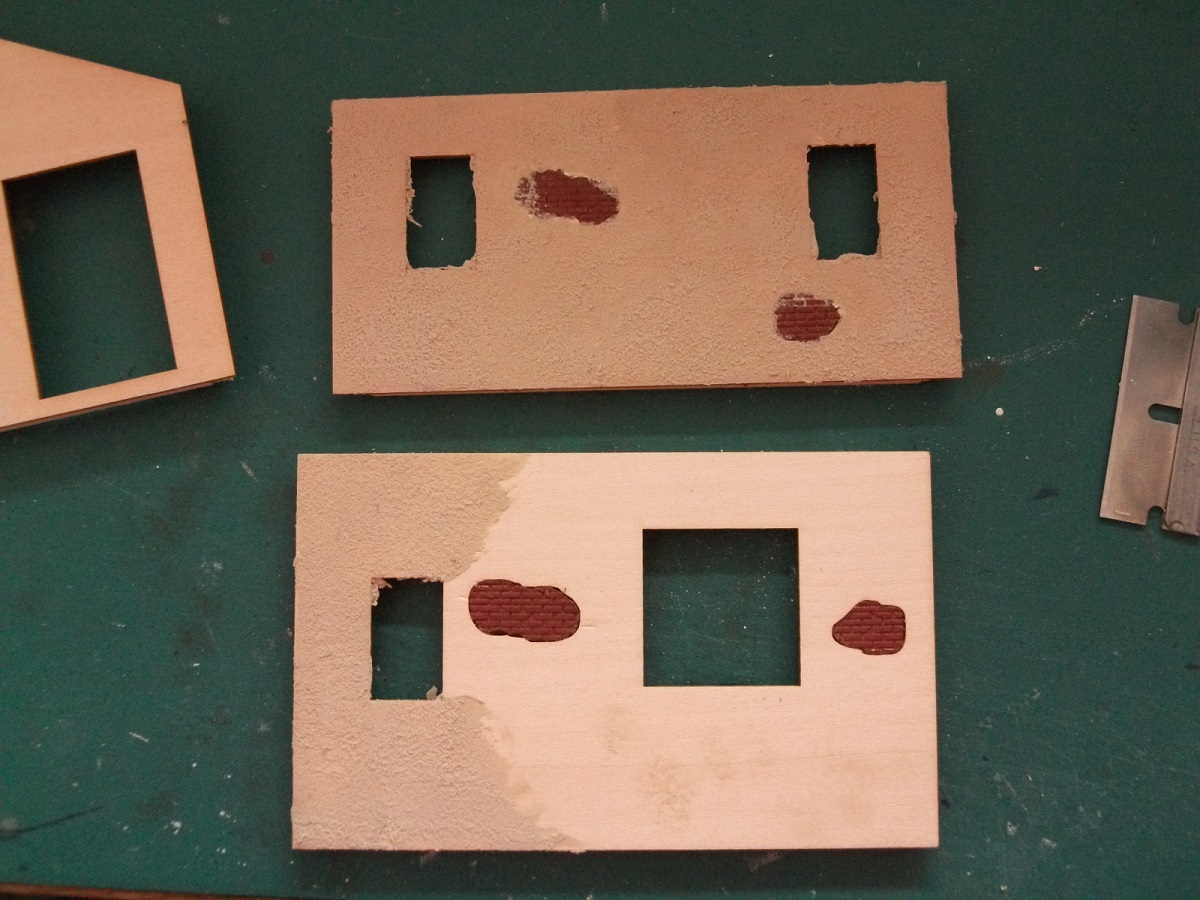

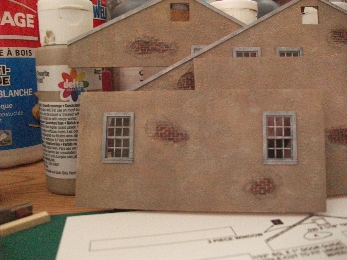

Times is coming to stucco the wall. the kit provide a package of water putty and Georges explain very clearly how to achieve this task, and call for doing some test and practice before stucco the wall. Unfortunately, I've don't like the technique, and can't achieve a good result. So  I've let down this technique and work with Liquitex light mortar structure. I found that the principal advantage of this technic is that the wood don'T absorb the humidity of the stock and it don't dry as quickly as the water putty and can be work in very thin layer with a  small spatula. Note that the liquitex light mortar structure can be colored with acrilyc paint (mudstone colour in my case). Once the stock is applied on a small surface of the wall I dip a very soft brush on this surface to texture it.
Once dry, I've repaint the wall with a thin coat of acrylic paint (ceramcoat : mudstone) When the paint is dry, I've  put some drop of AI solution here and there and around the brick work., and apply a drybrush the wall with Unbleached titanium white colour. Note that the drybrush was do apply with irregular strength. The I've paint the windows in grey (folkart grey sky colour) and once cure, apply a coat of AI solution, and finally drybrush them with Vintage white. The wood used for the door trim and facia board are paint in the same way.
Here's the final result of a wall

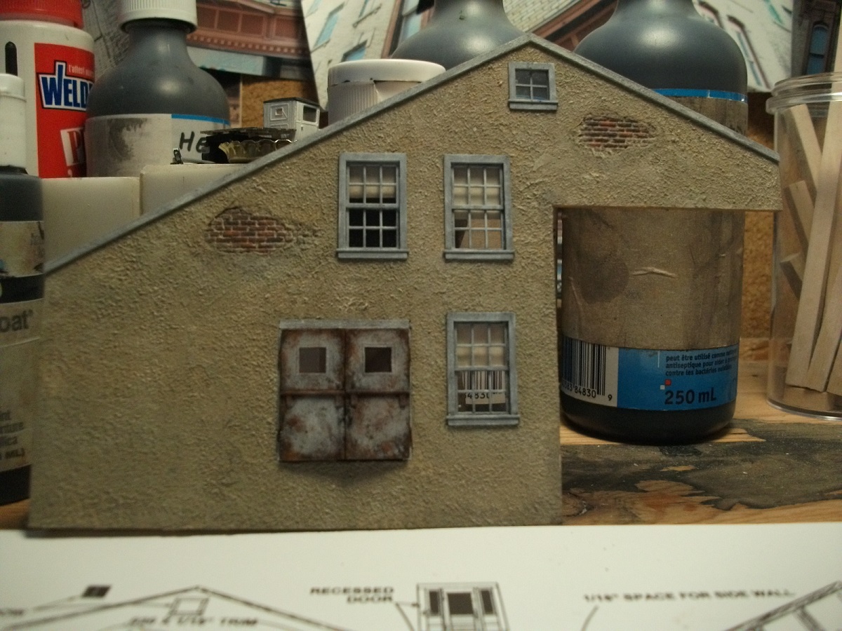

First I've paint the metal door casting, and glue it in place. At first sight it look be a little be too rusted regarding the other part of the wall. But I think taht this effect will be attenuated once the corrugated metal canopie will be glue in place later.

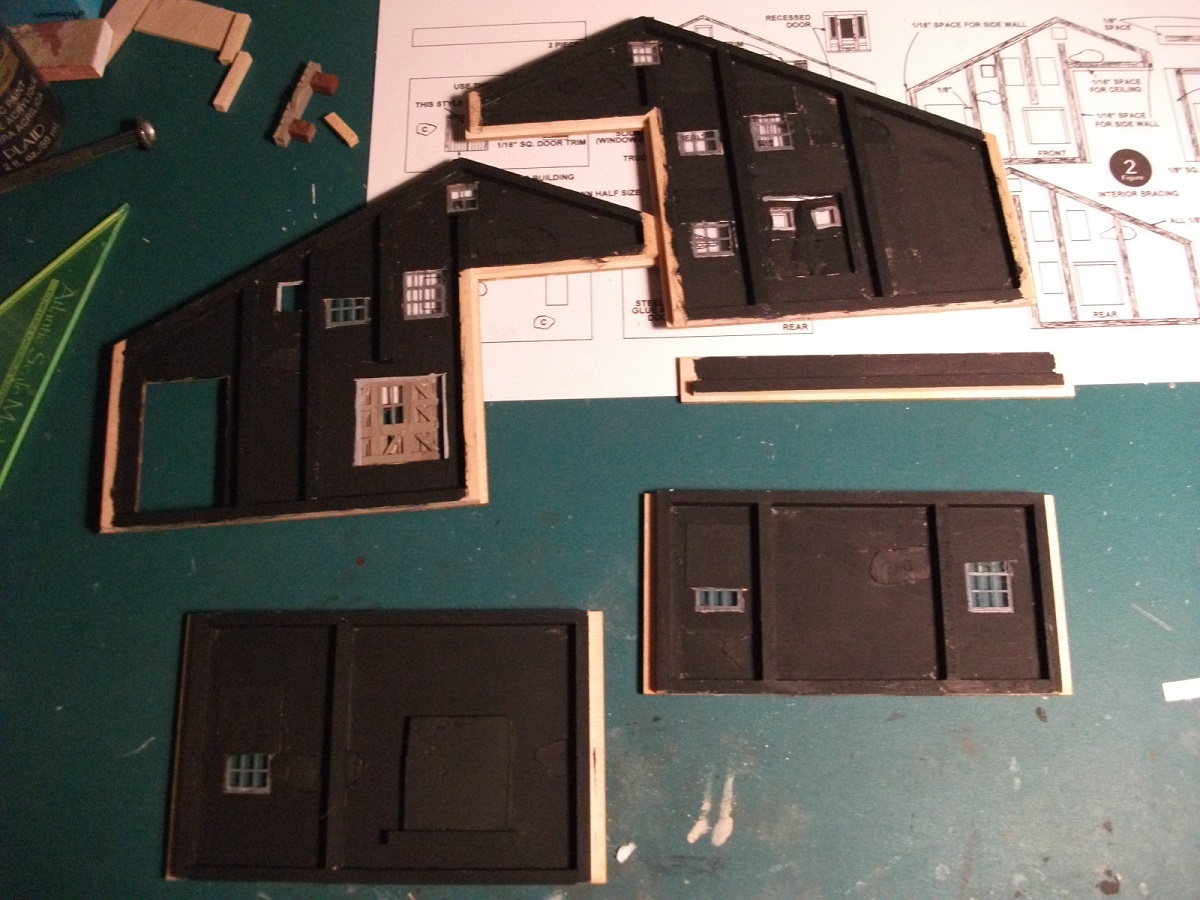

I choose to lightened all the building of this kit, so I've paint the backside of the wall in black.

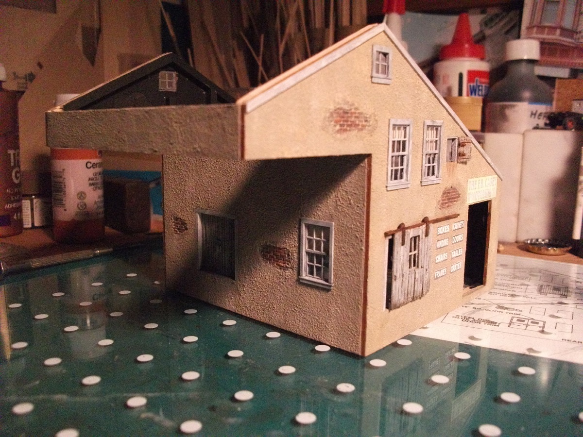

Once the paint is dry I've assembled the wall together,  gluying two wall together at  time, finishing be the small wall between the peak.

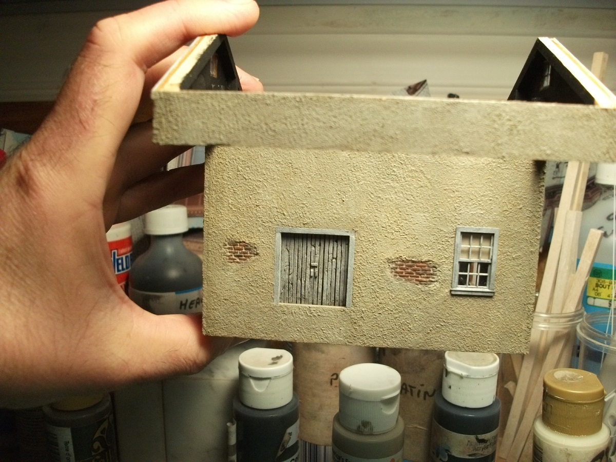

And cover the edge of the wall with stucco, using the same method than previously, but in despite of all my efforts, there is always a slight mark at the join of the two walls

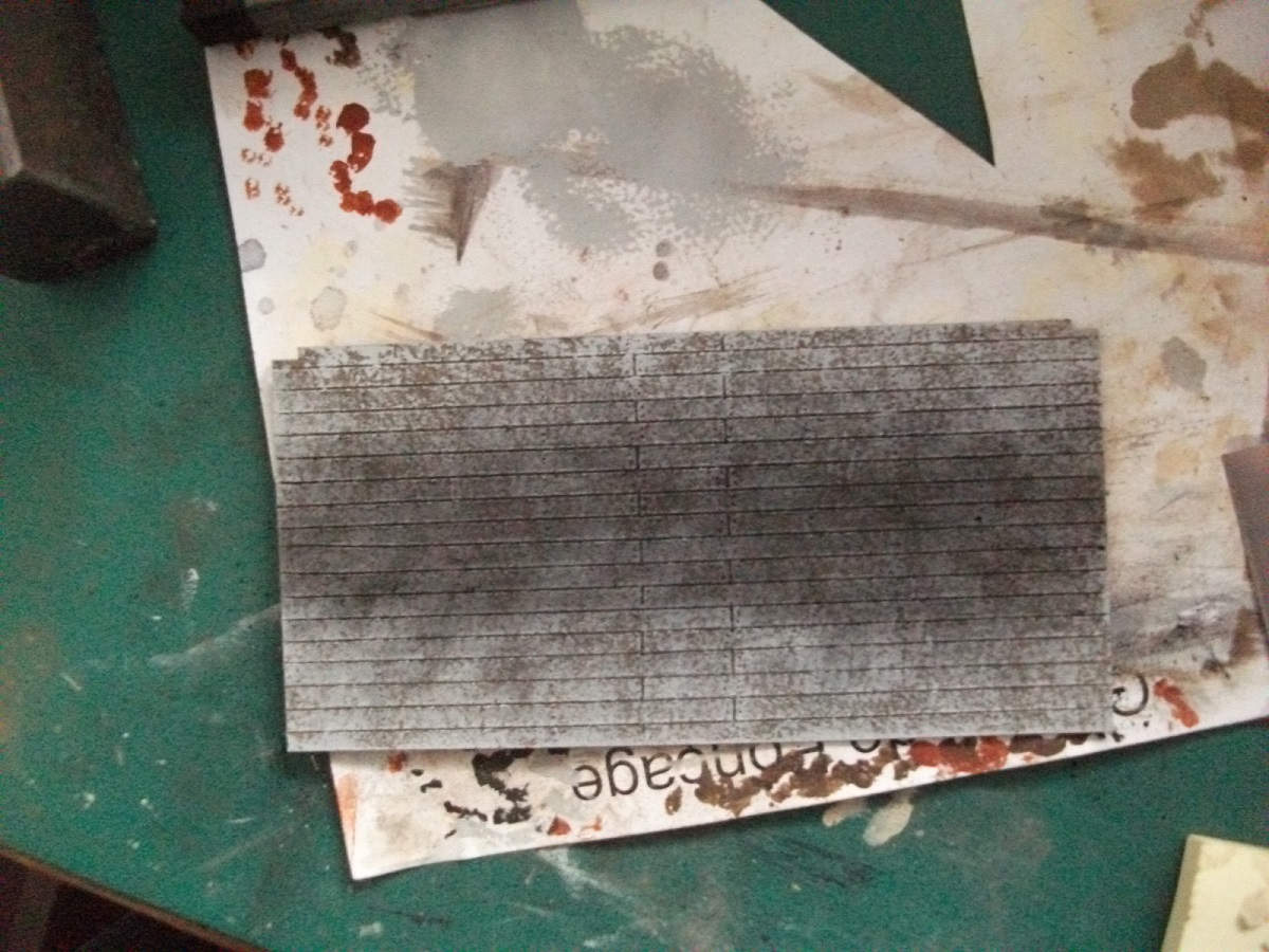

It's only one thing that I don't like in FSM kit or other brand : The fact that we neglect the parts that are supposedly not visible. And this ceiling is a good example of this fact. I Know that I waste my time to make some effort on a piece that virtually nobody will see it... But, imagine a camera on a loco or a wagon... what will you see  under this ceiling.. a piece of cardboard that will break all the realism of your work.  We can have an example of this on the excellent video that are realized on the FSM. There's a moment who the train enter on a cover station. Georges have make a lot of effort on the wall, there's a lot of details on the platform with a lot of little person, mini scene etc... but all this effort are ruined when we see the ceiling ... a simple white cardboard....  I know that with a layout of this size, it is impossible to tackle this kind of detail, and that is probably the first time that this ceiling was visible. But at this precise moment and place, realism was broken. This does not detract from the perfection of the whole work.
So I've decide to carve this piece of cardboard, paint and wheater it.

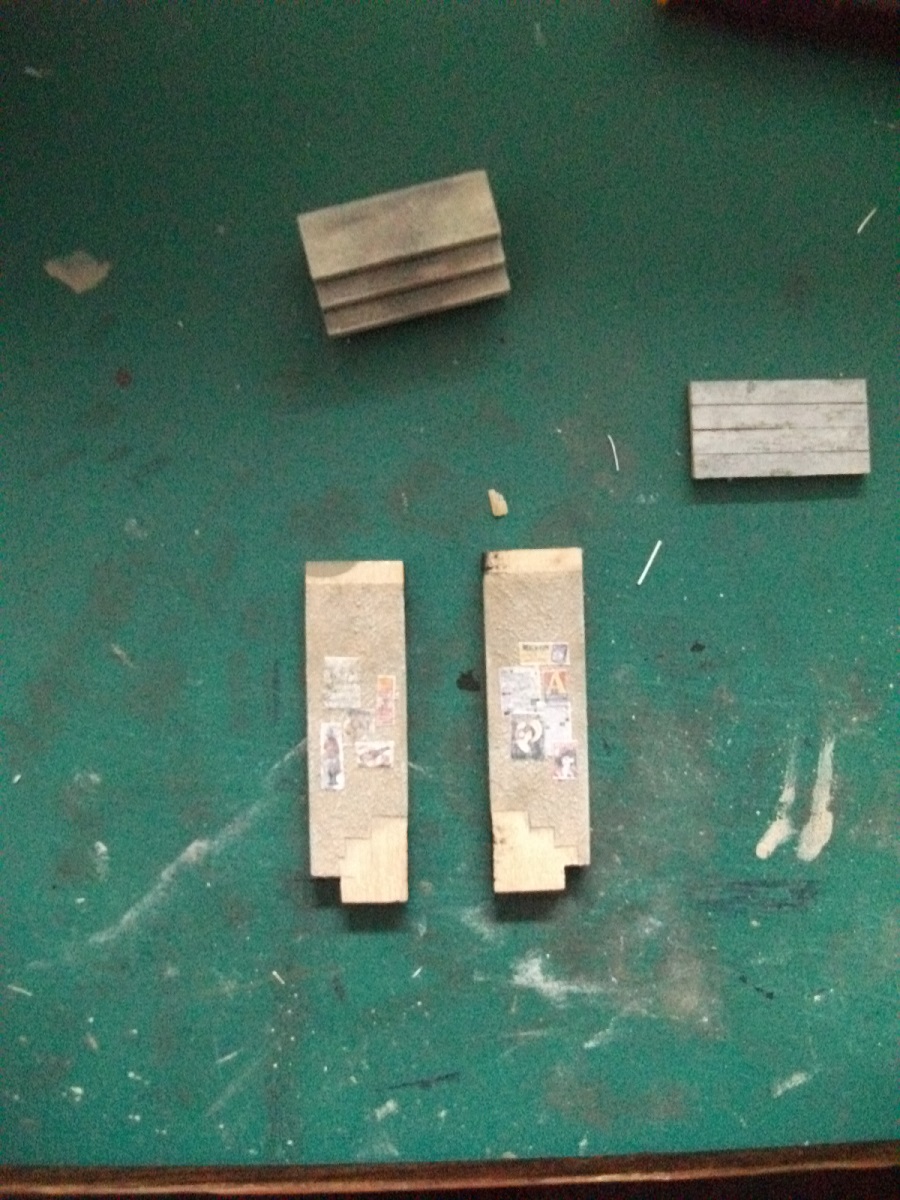

After what I've doing the recessed Door. It consist of concrete stair, with two wall covered with stucco.  In order to facilitate the final assembly I decided not to cover stucco the places where will be the stairs and the ceiling. The I glue some ad on the wall.
