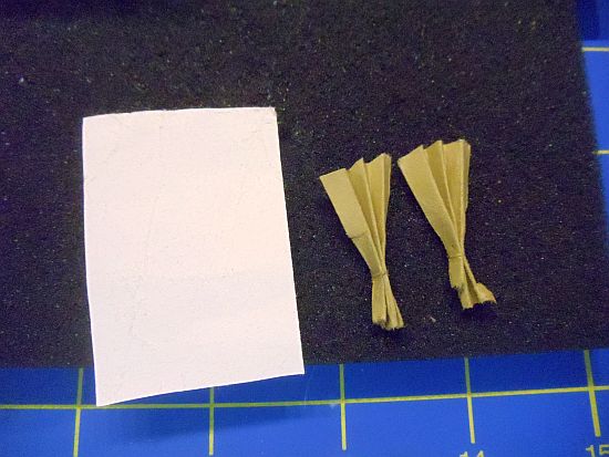

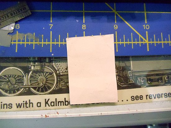

I wanted to have cab curtains and here is how I made them.
Many years ago, I found some cloth paper. It feels like cloth but it is actually paper. I've used this in other threads to make curtains. If you are a new viewer to my additional details this is quite simple. You can also use a good quality paper napkin from one of the better chain restaurants.
I have a small piece here, And, yes, it is pink.

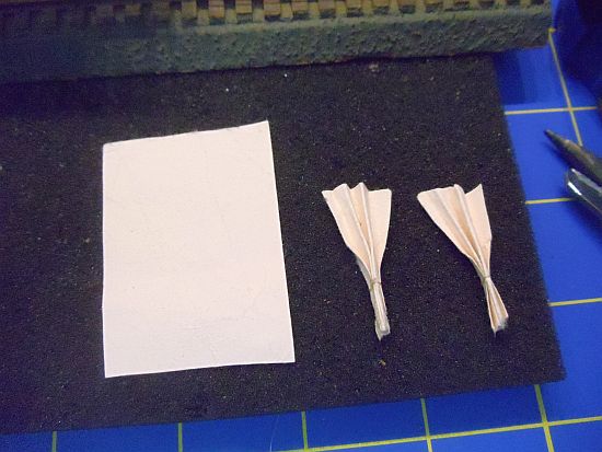

I measured the cab from the cab top to the bottom of the cab and cut two pieces off the small square.
I then folded them over on themselves. I tied a knot, using thread, a little from the bottom.
I then painted the two cab curtains with Floquil Earth.
When these dry, I'll weather them using some light and dark A&I wash/stain.

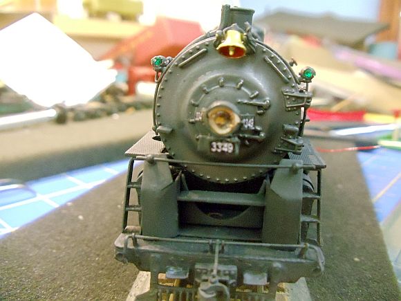

I had a conversation with Frank this morning concerning the headlight light. He wanted to know if I planned on placing some sort of cover on the light.
I hope Thom can back me up on this next statement.
"When working on another's brass, plastic or diesel, one should always anticipate any questions and be ready to answer assertively."
In years past, lighting a brass loco was done with a 1.5v mini lamp using a CIL (Constant Intensity Light) unit. One could also use a 12v GOW (grain of wheat) bulb and wire it directly to the motor leads. However, as the speed increased, the intensity of the bulb also increased. AH, the good old days.
Prior to DCC either one of these options was acceptable and actively practiced.
Anyway, I knew immediately where Frank was headed.
He wanted to know if I planned on using a MV lens in the headlight bracket without actually asking me. I then said, "Do you mean installing a MV lens?" He said, "Yes, you are way ahead of me."

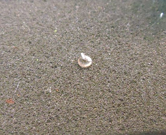

You can see the back side of the lens in the photo below.
It didn't take us brass repair/painting guys to figure out the foil on the back could be removed. By doing this, we also discovered the lack of foil on the back made the little 1.5v lamp look much brighter and more of a realistic looking headlight.
You can see the foil is partially removed in the next photo.

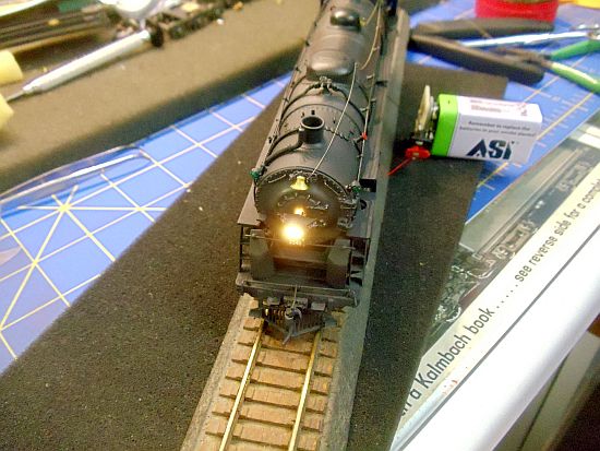

I'm installing a micro LED in the headlight of Frank's Eire loco. This LED will negate the need for a lens. Actually the lens will make the light look much worse.
Here you see the LED in the headlight.
#109

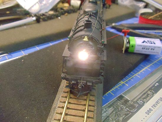

I'm using a 9 volt battery and a 1K resistor to show you the difference in using a lens  and not using a lens with the LED.
The first photo shows the lit LED with the MV lens in place. Its to bright and not realistic.
This next photo is the lit LED without the MV lens. Its not as bright and looks more realistic.
So, to answer Frank's question, " Yes, Frank, you get no MV lens on this loco!"
