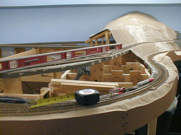

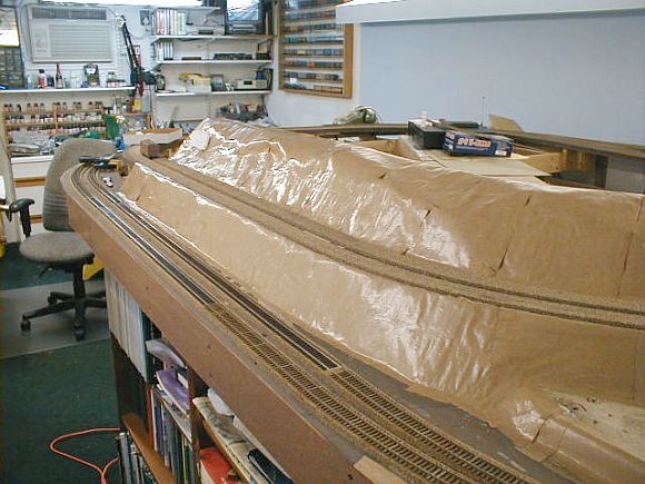

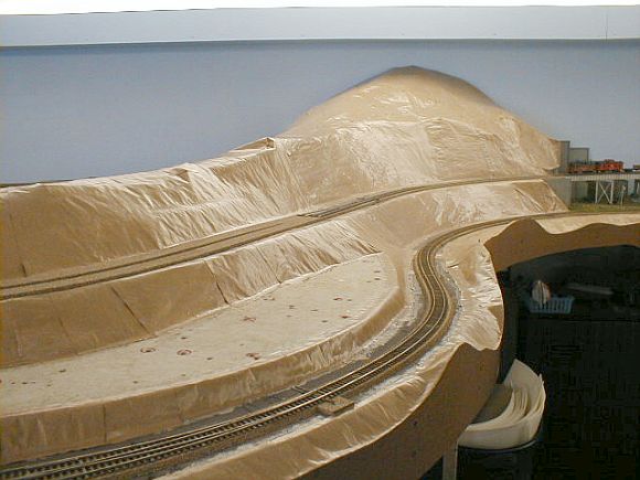

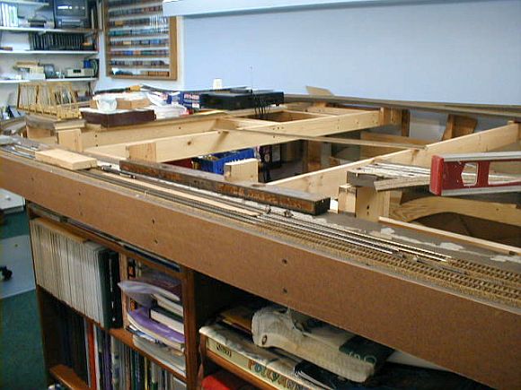

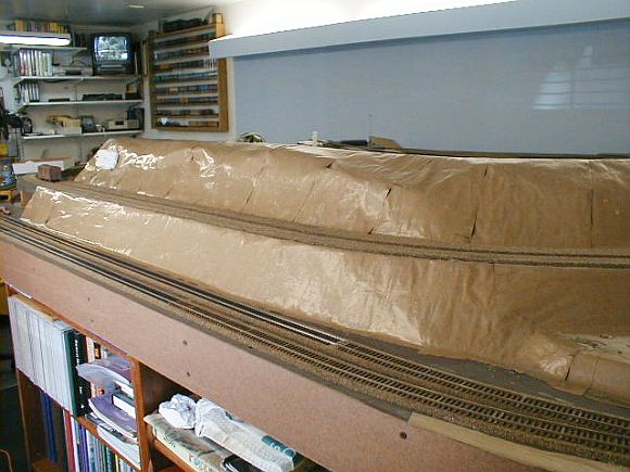

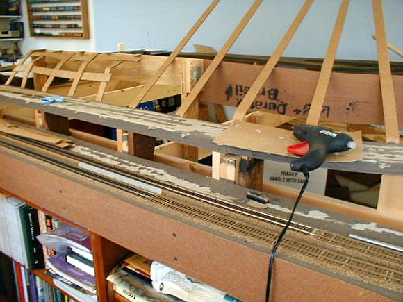

Once the basic scenery base was in place the actual scenery was started.
That will be a good post for next Thursday.
Looks like fun. I never thought to put down paper and glue it. I would save a lot of money on plaster cloth.
Quote from: PRR Modeler on June 01, 2017, 07:08:05 PM
Thanks for checking in. It was fun and as I mentioned Howard Zane showed me how to do it. Not only is this faster than plaster cloth, it isn't as messy either.

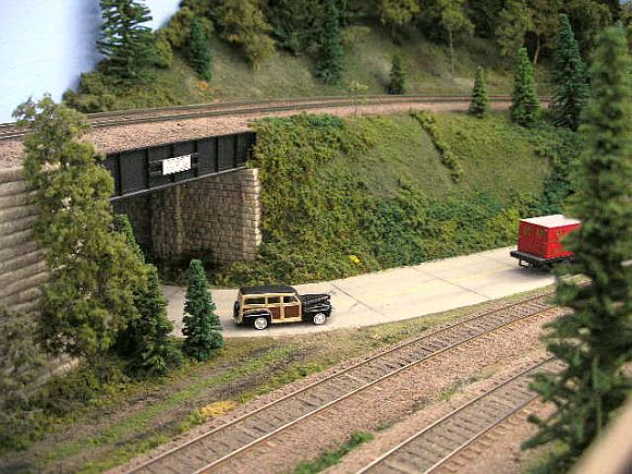

I didn't do a lot of scenery on the old, er, older layout.  I however, have enough to see the trains running at least through some scenery.
Here is where I started the scenery. I have more pictures of this area but can't locate them. When the thread has reached it's end, I'll find them.

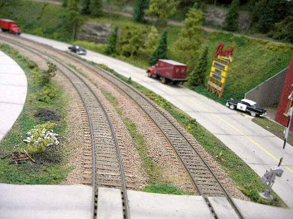

This view of the double track mainline was taken from the cab of an ACL E7. The engineer was O.H. (Bill - The Judge) Eaton.
If Greg were the engineer, the photo were be nothing but a blurrrrrrrrrrrrrrrrrrrrrrrrrrrrrrrrrrr!
The photo is directly north of the small green garage.
You can see the upper two track mainline in this view.

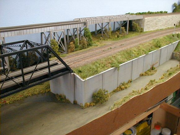

This area was directly south of the power plant. You can see the waste pipes in the retaining wall. These are 1/2" brass tubes.
The large retaining wall to the left was made of .40" Evergreen Styrene sheets and painted UP Gray. The expansion joint lines were weathered using a #2 pencil. The rest of the weathering was done with pastel chalks.
