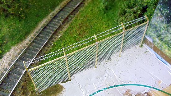

I've been thinking about the barbed wire question posed by Dave Emery. I came upon an idea and tried it this morning.

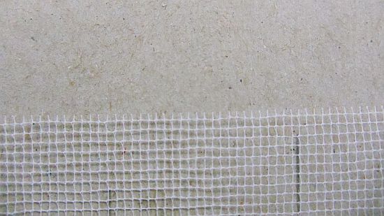

My chain link fence material is actually wedding tulle or veil. I know ya'll have seen my other fence around Delwin's Boat and Net Storage using this same material. The tulle is shown below.
I was looking at this material and especially the top portion. I thought this would make a great barbed wire look if cut properly.
I used a metal ruler and trimmed the top off as shown below.
Keep in mind this photo is a close up view so it looks out of scale for HO.
I cut the top portion off and trimmed one end by cutting the "barbs" off of the first few sections.

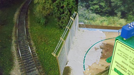

I then used tweezers and fed the tulle through the holes in the top of my fence posts.
I also glued the tulle fencing to the brass posts. I used CAA/super glue to secure the barbed wire on each end post.

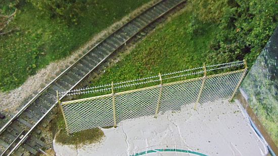

Here is how the first section of the fence and barbed wire looked.
I think it looks great for barbed wire in HO scale.

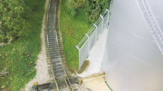

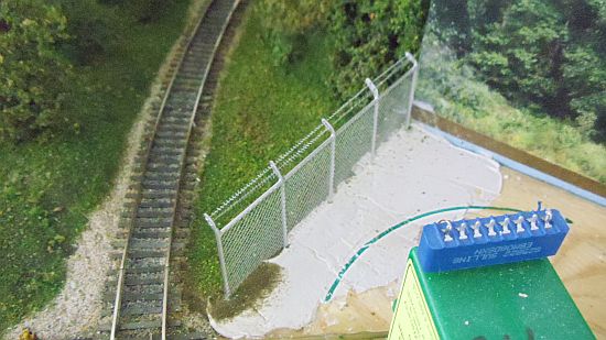

I spray painted the fence, posts and barbed wire with Tamiya Silver.
I'll have more on the fencing using the barbed wire tomorrow.
