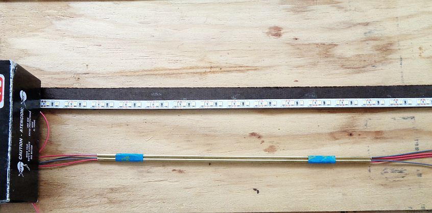

The thunder and lightning is nothing more than a Broadway Limited Imports item.
BLI currently has them for sale at $129.99.
http://www.broadway-limited.com/1598lightningandthunderaccessoryforany-scalelayout.aspx
They also have a reconditioned one for 87.09.
http://www.broadway-limited.com/hoscale.aspx
I got mine about two years ago for around $100.00.

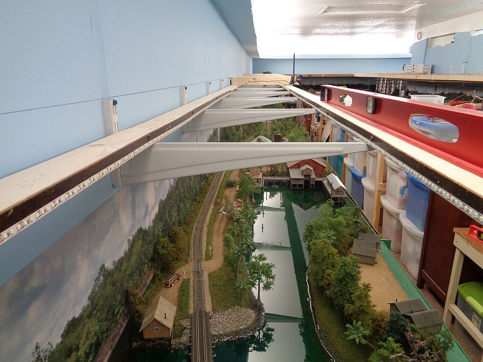

If you've already watched the BLI video on the thunder and lightning, you'll notice the LEDs in the kit are only about 18 inches long. My lagoon is right at 9 feet long.
I used the same Cool White LEDs I'm using for the second level lighting. I cut two lengths at 8 ft. and glued them to a 3/4" wide piece of Masonite/hardboard. I then screwed them to the inside edge of the two 2X3's I'm using for the third level benchwork.

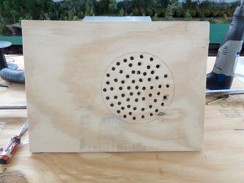

I cut a piece of plywood, marked the speaker diameter and drilled holes in the plywood.
The speaker was screwed to the back of the plywood. I also used a piece of white cardboard for a cushion between the speaker and plywood.

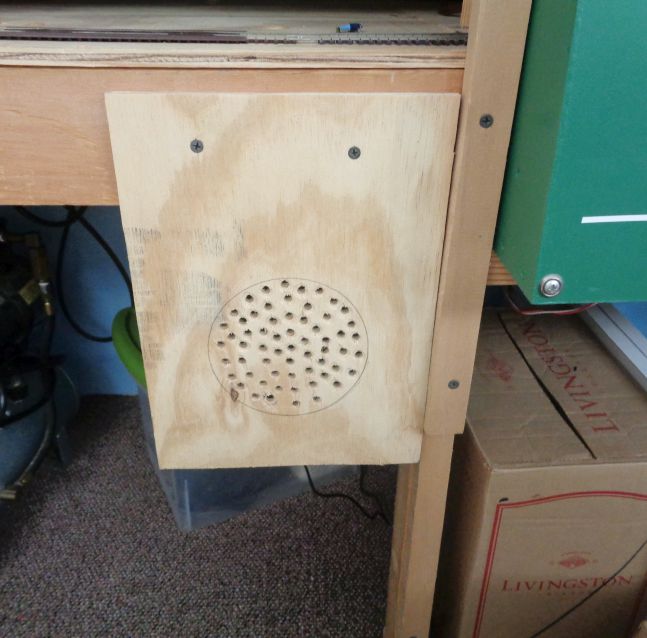

I mounted the speaker under the staging area with is also under the main channel of the lagoon.
Time for a Diet Pepsi, back in a fewl.

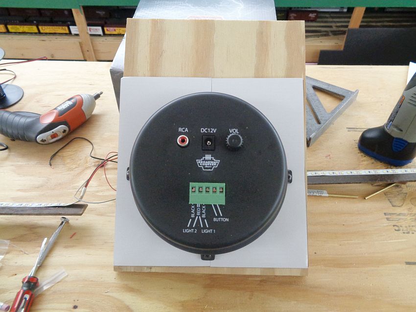

The speaker is 5.5 inches high and definitely wasn't going to fit under the third level, nor the second level.
The LED wires needed to be screwed to the rear of the speaker. The only solution I had to run the wires was to do so by cutting into the scenery to the left of the Smokehouse BBQ.
To make it easier to run/pull the wires behind and through the scenery, I ran the two sets of wires through two separate brass tubes.
