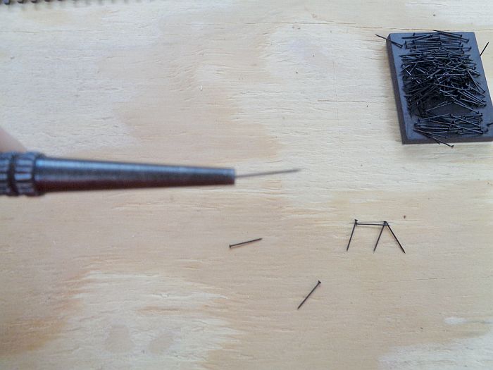

For securing the track I prefer to use PECO track nails. PECO calls the track fixing pins. They are in fact more of a pin than nail.

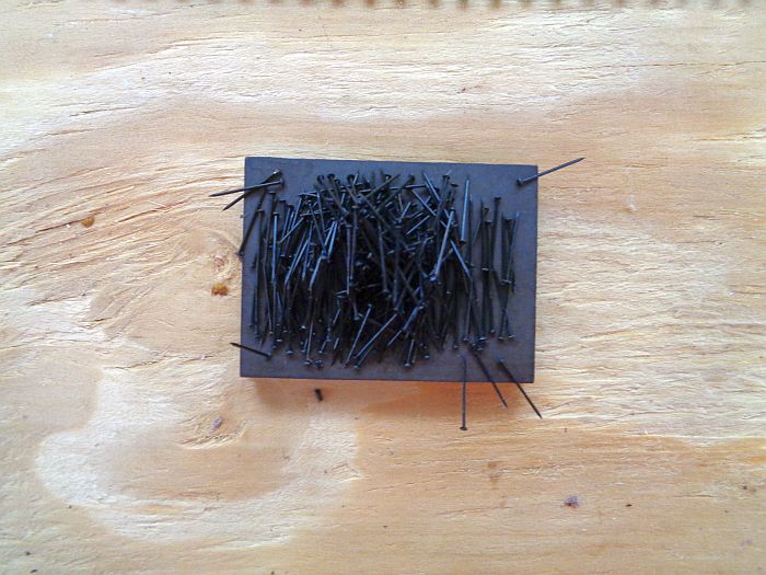

I dump the package on a Kadee Under Track Magnet.
I do this for two reasons -
1. It magnetizes the pins, usually takes 2-3 days.
2. It keeps them in one place.
When I use them, I remove a few and lay them on the layout. When finished, I move the magnet over the left overs and they are all back on the magnet.
I drill a hole, somewhere between a #76 to #80 drill bit. The pin is picked up and tapped into the track and sub roadbed. When I used 1/2" Homosote the pins held the track in place until ballasted.
However, I'm now just using 3/8" plywood. I drill through the track tie and into a little bit of the plywood.
I mentioned the pins getting magnetized. Here again, is what I do. I use a nail punch and pick up a pin as shown below.
The pin is magnetized and jumps on the end of the nail punch.
As you can see, it fits nicely on the end.

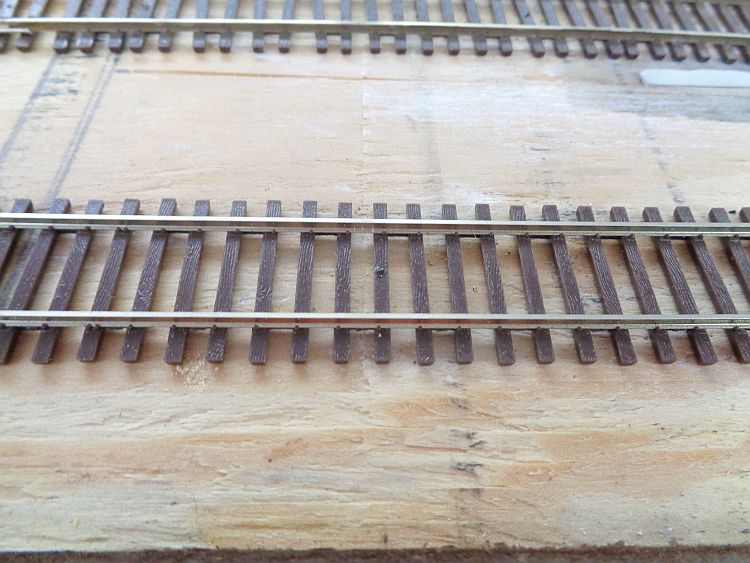

PECO track pins have a very low profile. In the next photo I have 18 track pins through the ties and into the plywood. They are hard to spot but they are there.
Here is a close up of the PECO track pin - center of track and photo.

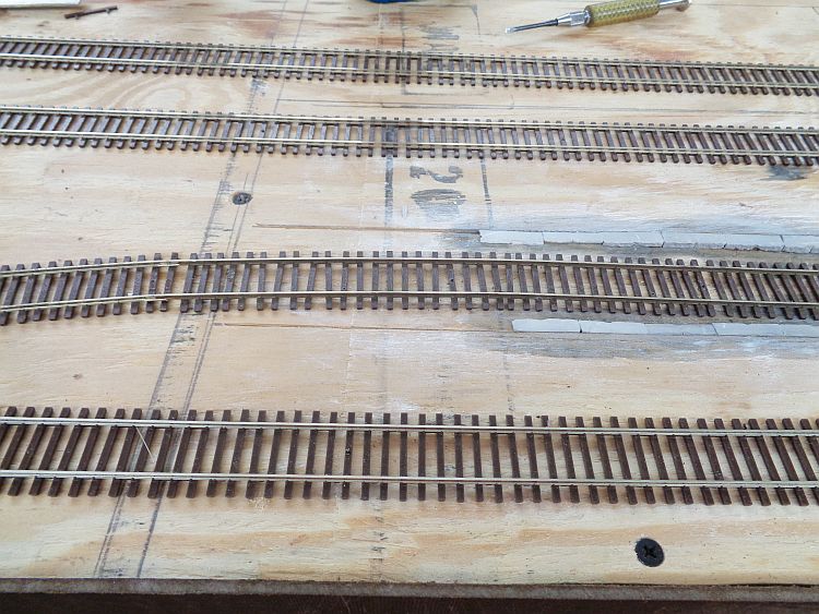

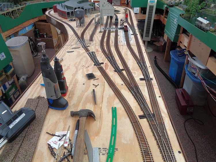

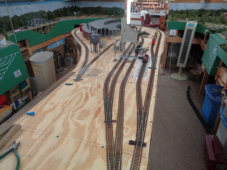

I spent most of the day laying the loco lead tracks for the steam servicing area.
Here the three tracks over the ash pit are now joined with the approach tracks.
