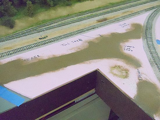

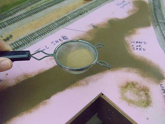

I liked how the orange grove dirt turned out so I thought I'd try the same method on the dirt area around Caldwell Junction.
On the orange grove I applied a layer of real Florida sand and then added the WS Earth on top of that. As it was drying, I sifted on a light layer of sand followed by another light layer of WS Earth.
On this road I applied a base layer of sand over white glue. I added matte medium and another light layer of sand. As it was drying I sifted some SE Fine Dirt.
I'll let you know tomorrow how it turned out, good or bad.

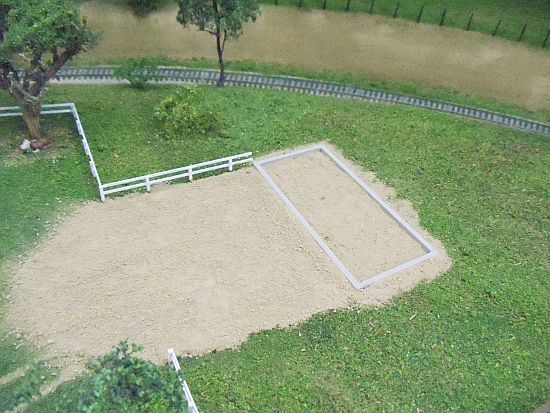

Farmer Perkins had Langford Construction Co. pour a foundation for the barn walls. Notice how neat the crew was in cleaning up all the construction debris.

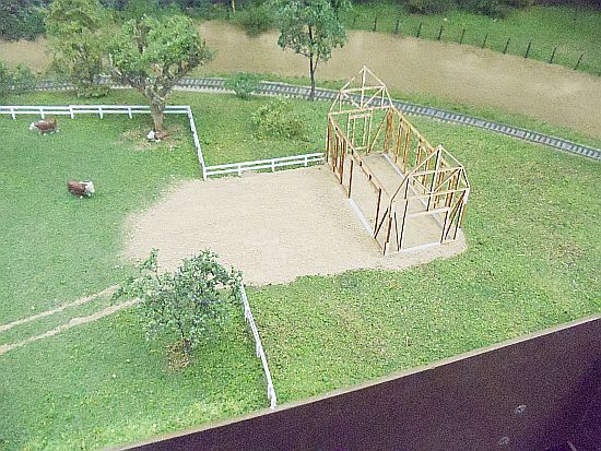

After the foundation was set and dry, the carpenters added the barn framing.
You can see how the framing is scarred and burnt from the laser. I'll paint it with either Floquil Earth of Foundation.
I'm not happy with the look of the BTS barn as it isn't southern enough for me. The roof just doesn't look correct to me. I probably is but I still don't like it. After the NMRA Open House. I'll replace the barn with one that is more fitting of the South.

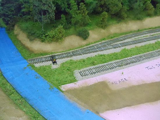

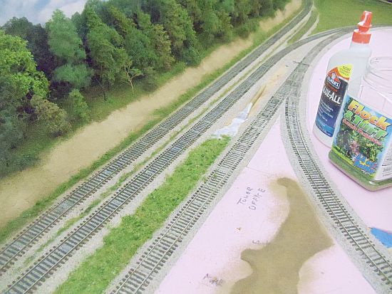

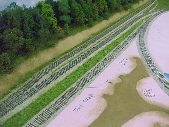

I added the grass and weeds between the tracks - mainline and siding. I also added the weeds and some growth to the sides of the road. I taped the road to keep glue and water off.

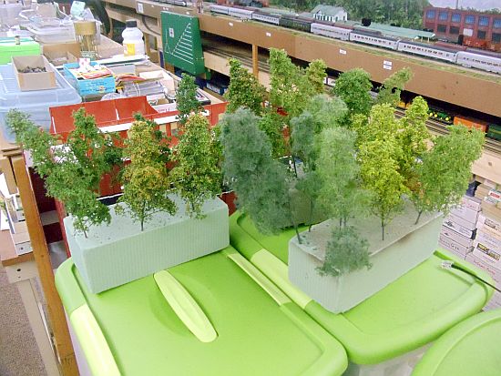

For several hours this fine day I tried to get the internet back up and running. During this time I also made another 75+ trees. I painted them early this morning with Ace Hardware Gray Primer. They were dry after 30 minutes.
Over the next 6 hours I added different types foliage and colors.
Here are about 30 of the 75.
