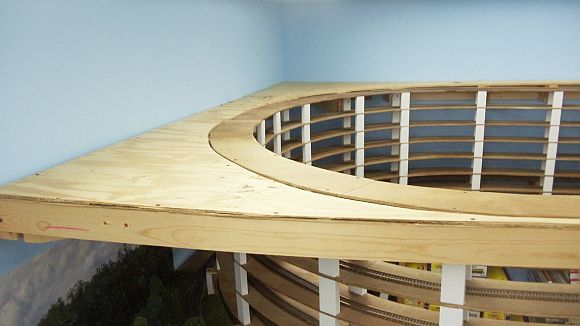

This morning I finished the top level bench work around the Ovalix.

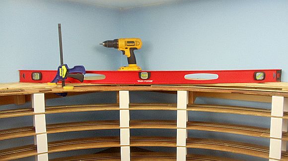

This is the West area.
Southwest and South area.

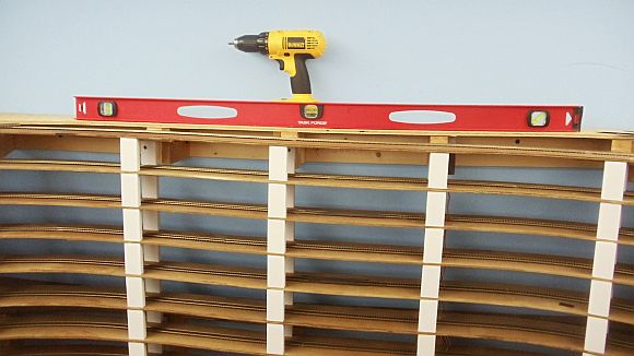

East and front of the Ovalix.

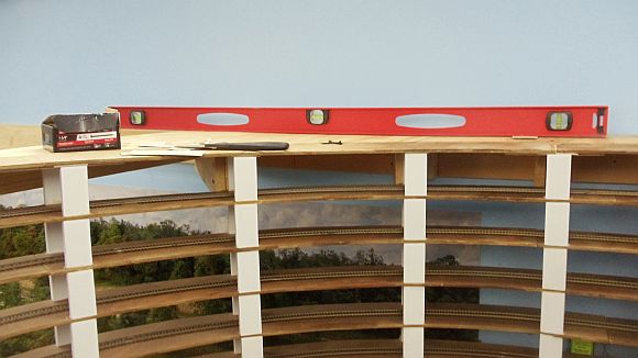

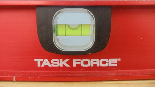

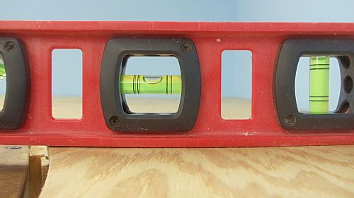

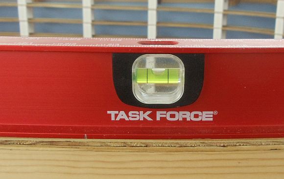

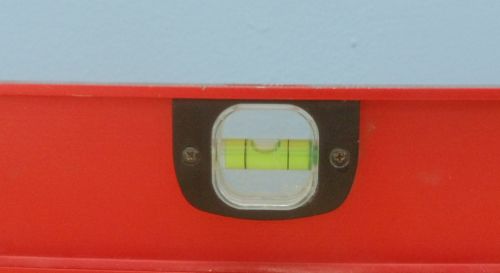

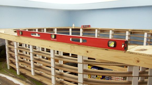

As you can see, I made sure the entire third level around the Ovalix was level. I don't want any surprises later when the trains are pulling in new revenue. 8)

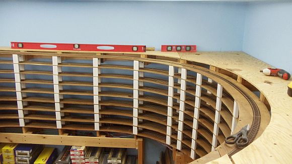

Ten loops with 26 feet of track per loop making the Ovalix track length 260 feet. And, a constant 1 degree incline from bottom to top.

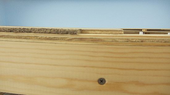

My original plan was to lay the track directly on the third level plywood. I decided to use cork roadbed on the third level. This meant I needed to adjust the last 14 feet of the Ovalix incline.
To do this I unscrewed the Ovalix bench work and slipped a 1/16" piece of cardboard on top of each support column. I added one 1/16" piece for every two columns. I then added two 1/16" pieces for the next two columns. Every two columns I increased the 1/16 cardboard until I had 1/4" at the very top of the Ovalix. This is the thickness of the cork roadbed.
The track now has a smooth transition from the Ovalix to the third level plywood.

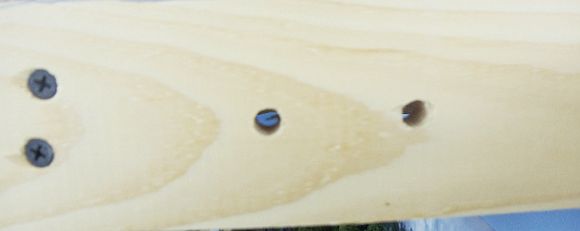

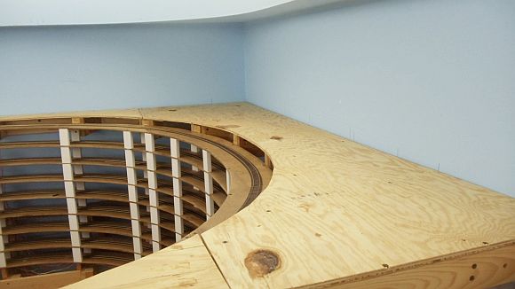

In the next photo, do you see the two holes in the 1X4 cross brace? Do you also see the feeder wires running through the holes?
No? Well, that's because yours truly forgot to run the feeder wires through the holes PRIOR to securing the third level plywood. :'( :'(
I'm not about to remove the plywood to run the wire. So, I guess I'll play the Ovalix monkey and hand feed the wire through cross braces a little at a time.
The feeder wires need to be pulled around the outside of the Ovalix.
