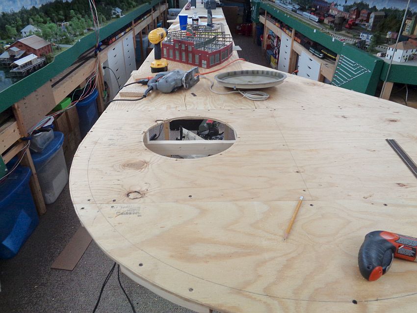

I've never been able to get such neat straight line cuts with my jigsaw!!  Is there a trick to this?
My lines really aren't that straight but straight enough so they look straight. All the experts say to clamp a guide board next to the outer edge of the jigsaw and use it as a straight edge for cutting. But I'm assuming you are referring to cutting a jigsaw line freehand.
Since I had 9 stalls and 18 lines to cut I didn't want to take the time to position and clamp all the lines 18X. The cut outs for the pits were 1/4" wide so I cut just outside the lines. I also drilled a 3/8" pilot hole for the jigsaw blade.
My trick for cutting straight lines and circles with the jig saw is to let the blade do the cutting with only slight guidance from me. I've found that if I'm in a hurry and try to push the saw as it cuts, the blade wavers and I fall off the cutting line.
In this case however, I didn't care if a missed a little as the cutout portion would not show at all. The trick is to go slow and watch the line as the blade cuts. This is what I practice.

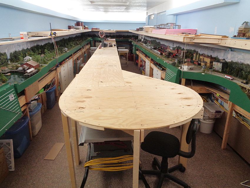

Great job and extremely impressive on the speed you're moving at. I don't remember if the second level to the right had the circular area in it previously or is that to make more room to get by?
Thank you my friend. If I can send the Judge off somewhere more than once in a while, I'll get the move on!

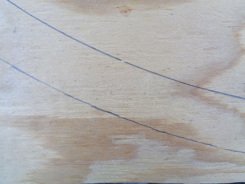

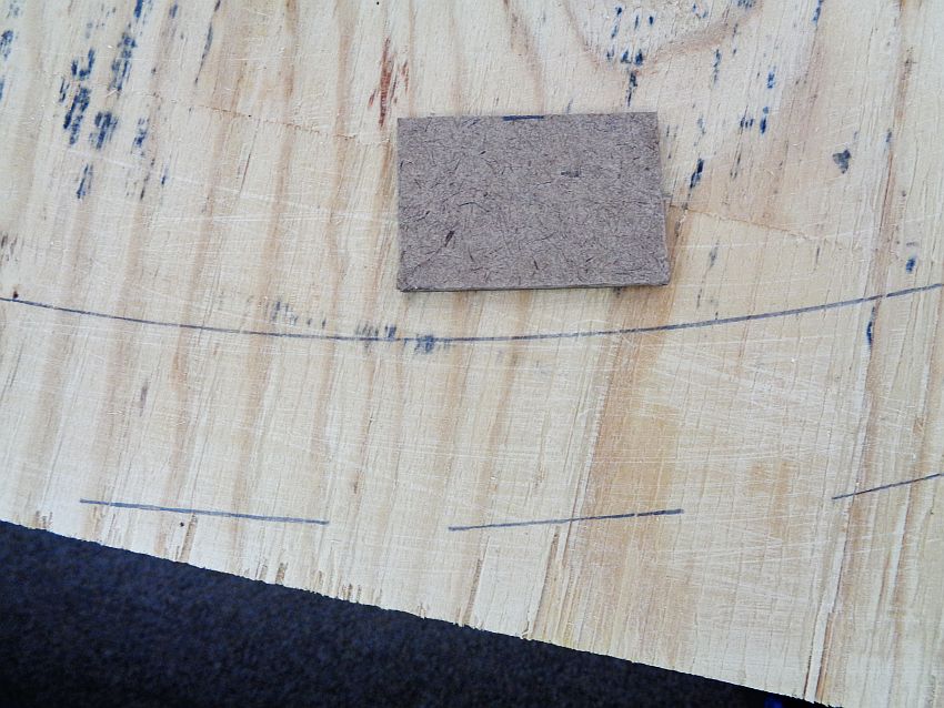

On this one day, he drew a rough circle on a large piece of 1 X 10.  I think he used the lid of a gallon paint can but memory doesn't serve me well on this adventure. He said he would show me a trick on how he was going to draw a larger second circle using straight lines. He took either a 1X2 or 1X3 and cut it to around 3 inches in length.
He placed one edge of the piece of wood on the outside edge of the circle and then drew a pencil line the length of the wood piece as shown below.
He left a small gap between the lines as he moved around the circle.

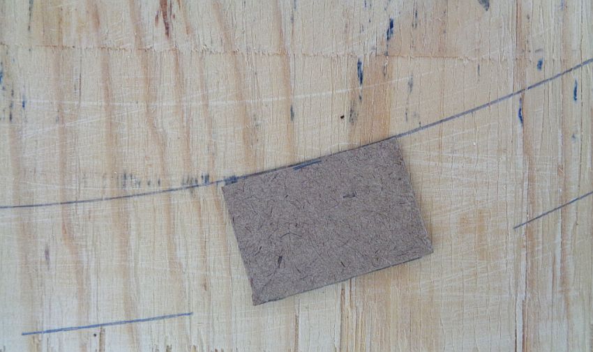

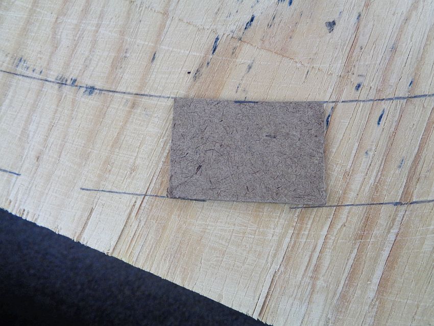

He then used the wood piece to fill in the blank spaces. Again, using the wood piece against the inner circle and drawing the line on the out edge of the smaller wood piece.
Here is how mine looked when finished.
It looks like a circle but put a straight edge to it and it will show only short straight lines.

By the way, I used this straight line circle as the circular edge of the roundhouse area.
In the photo below, you can see my inner circle and the edge of the layout where I cut on the outer straight line circle. I used the jigsaw for the cutting and went slow and followed the outer line.
