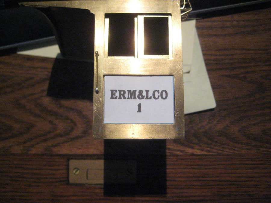

Thank you for your remarks.  I've been asked this before.
I went in with the notion of painting this.  I chose early what parts were to be steel as un-painted, oily steel cannot be accomplished with paint on brass.  The bull gear on the winch is an example.
Below is a photo of the draft decal sheets.  Elk River Mill and Lumber Company.
Special thanks to Henry Schmidt of HankInk for making these up.
The name Falk comes from the owner of the company, Noah Falk.
Thanx again for looking in.

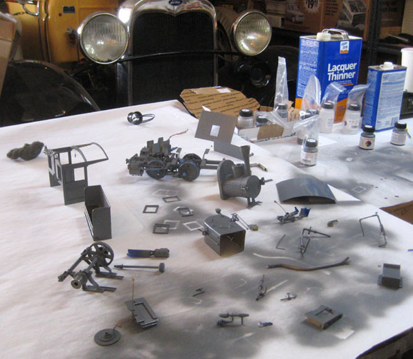

Here is a shot of the primer going on the various parts of the loco.
I took a lot of stuff apart but I left the frame and such mostly together.  I'm not sure I could get it back together if I tore it all down.  I masked off the tires of the wheels and the cross head steel rails.  Everything else got blasted.
I paint out in the garage and don't have any sort of formal spray booth.  I just go at it and then go back and look for anything missed.
see ya

Regarding over spray.........  Not much chance of that.........  The paint is a acetone base and the carry of live paint can't be more than a foot or two.

That's exactly why I didn't take the frame and valve works all the way apart.  I didn't make up an instruction book as I went along.
It had to come apart some as there are too many places where there would be no way to get the paint in there.
Thanx for your remarks and for looking in.
