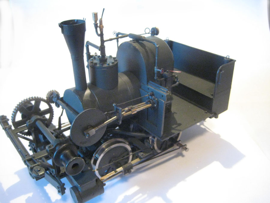

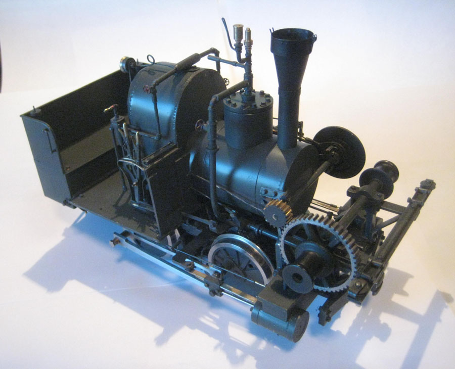

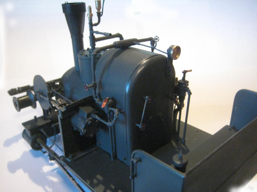

So the paint is on and some of the detail painting.  No weathering as yet.
Tomorrow is the decal stuff on the cab.
I'll also finish the pressure gauge.

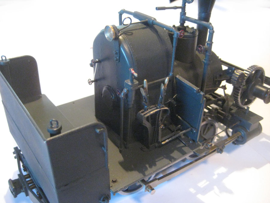

That must be the absolute minimum locomotive cab (controls and gauges)...  I'm sure the prototype didn't spend money on anything not absolutely necessary.
Dave.........
The controls were monumentally simple as most locomotives at that time did not even have brakes and they used the manual brakes on the freight cars to stop and secure the train.  The levers are a brake system that was driven by steam pressure with an oiler, throttle, direction control and the lever down low on the right near the floor was for the cylinder blow down cyl-cocks.

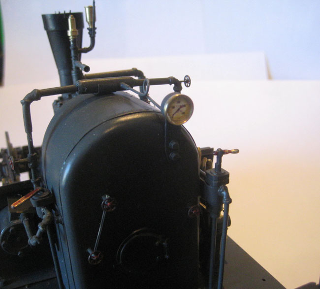

So here is a photo of the pressure gauge that I finished this morning. I cut a piece of microscope slide glass down to .300" and put it in the recessed bezel that I turned into the gauge when I turned in on the lathe.
see ya

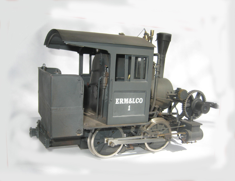

So I'm getting close now.
Need to make up a wood load and a broom.
I'm still massaging the chalks but I'm pretty happy with the subtle rust tone on the boiler and such and the cab, which is wood, a matching non rust color.
Also in are the movable windows.  They are cut from microscope slides and glued into the brass frames.
see ya
