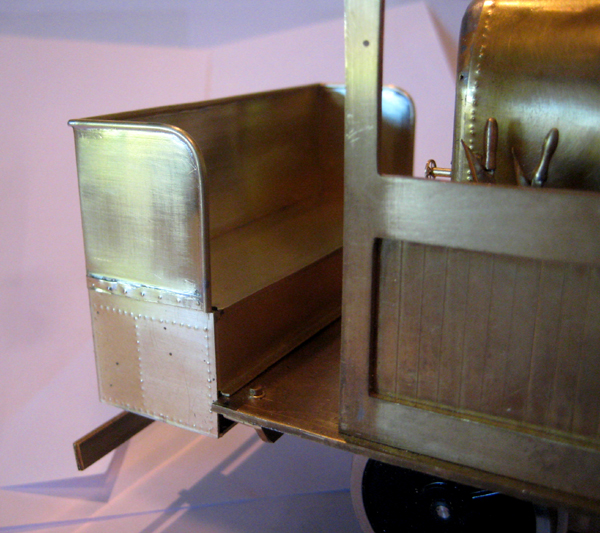

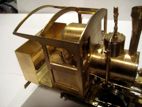

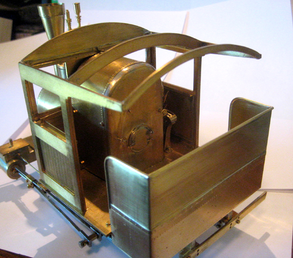

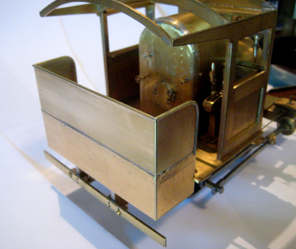

So I got the combined water tank and wood box at least mounted on the frame today.
Took a day of layouts and then a bunch of time pounding out rivets.   I have  ton of detail stuff to add: water inlet, water drain, box cover for access to the decoder, hand rails and round rail around the top of the wood box.
Still a lot of file and hand work also.
I'll be a while.  But it is a start.
see ya

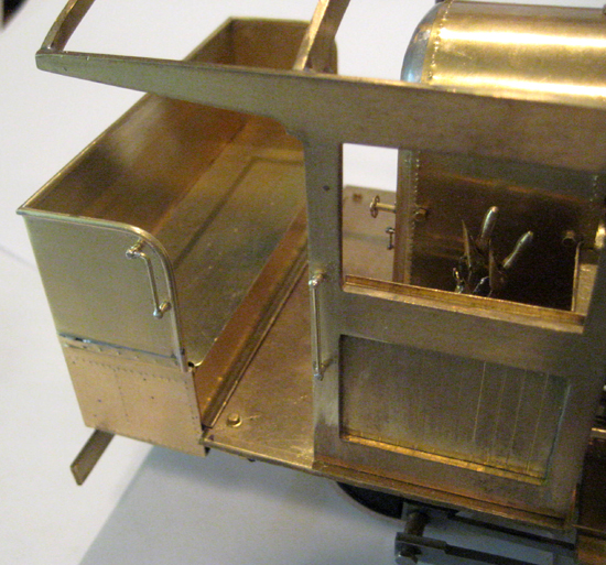

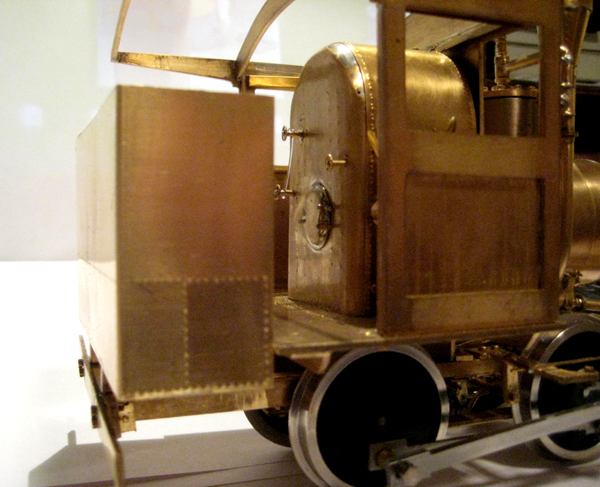

So I finally got some serious time up in the RR room today.

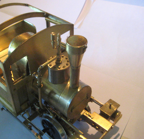

Got the water tank and wood box mostly done.  Still need to turn out 8 grab iron stanchions that look alike.  I think as I'll be turning them out of1/16 inch stock rod, I'll cut a tool that will whip them out rather than free cut them and have them all a bit different.  Four will need to be threaded for the cab and four will be a pin for soldering in the wood box side.
The pipe edging shown below was a lot of fun to do. I had been thinking how to do this for a long time.  I've never considered it in HO but in G there is a lot of stuff that can be done.  I took 1/16th brass tubing and cut one side out to get to the tube.  They layed it on there and soldered it down.  The curved parts were curved first so the tubing would not crush out flat while bending.    The electronics will go under the lid of the water tank.

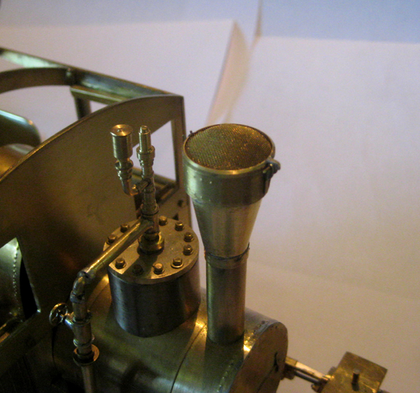

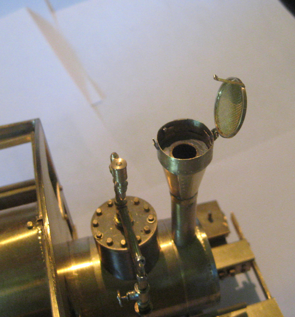

Oh........... what to do on a Friday afternoon.......
I have been working on how to do this one for some time........  The screen scales out to be one quarter inch mesh in G scale and is out of a fuel filter for some sort of army tank.  I have a modeler friend who was in the Guard some years ago.
The hinge was a "can you really do this?" sort of thing.
The ring on the outside was turned out of a piece of bar stock and counter bored to .040" and then a cut was put on the inside for the screen to snap into.
Having too much fun
see ya

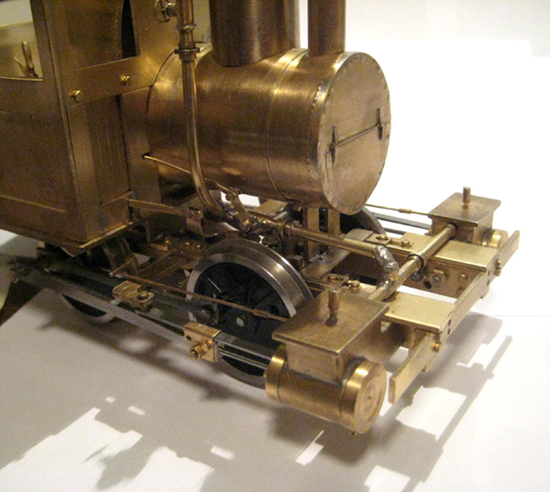

Finished the dry pipe to the steam chests........  The pipe union fitting was sorta fun to do.
Back to the grab irons tomorrow.
see ya

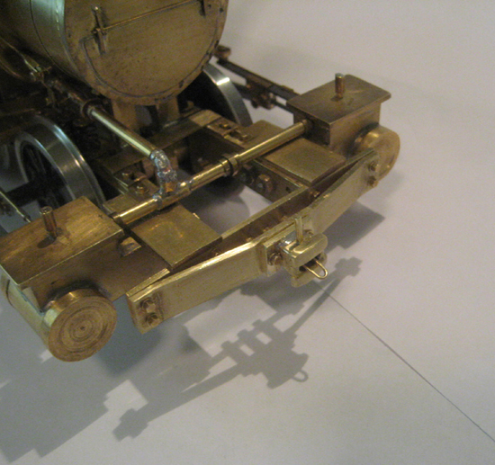

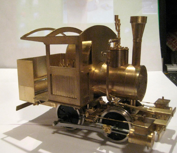

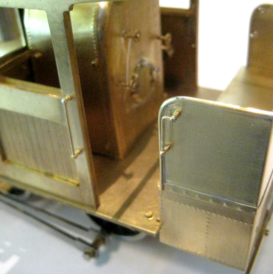

So I got a few hours today up in the RR room.  Haven't been feeling too well this week so this was the first good afternoon.  Got the front draft gear and coupler made up.
Also got the hand rails done.  The stanchions are 1/16th stock turned down to a scale inch and a half and the rail scales out at 7/8".  I tried making up a tool to cut them all alike but the brass is too soft and crawls up on the tool. So I had to make them individually...........  not fun..........X 8....
See ya
