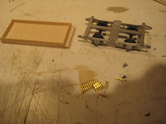

The Prototype Modeling certificate has certain rubric requirements: structures, locomotive, passenger car and freight.  Then after that there is stipulations for how much is scratch built.
So I needed a freight car for this.  Not a problem as there is a ton of information out there on this line.
Although there is no freight car in the source photo, our region allows for equipment that can be proven to have been on the line.  Again not a problem.  In addition to how much must be scratch built there is no rule on any of them needing to score individually at 87.5 or higher.  You can however have them judged under structures if you need that certificate.  I do not need them to be judged individually.
Below are the starting photos for a work flat that lived into the 1940's.  The base is a four wheeled frame from either a horse drawn street car or an early cable or electric car that was taken out of service.  Four wheeled cars were not used extensively as they were rather rough riding.
The wooden box is under construction and the brass strapping for hinges and corners are left over brass stampings from Labelle.
see ya

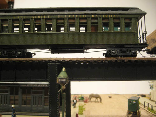

Got some bench time today and went after the passenger car.
Windows, seats and glass.
Then I glued on the roof and put the end railings and gates on.
Still needs a lot of finish work on the roof and detail stuff but................  It's coming together.
see ya

Nice indeed.  Whose passenger car is that?
Curt....
No it's not going anywhere.  I think after I take it to a local meet late this month and the PNR regional in Portland, in early June, I'm going to disassemble it.  The structures will go on my railroad and the scaffolding and rolling stock will go on the top of my roll top desk in the office.
Jerry.... you asked whose passenger car it is...............  Mine   ! ! ! !
I couldn't resist the cheap response ! !
It is a narrow gauge Labelle coach that has been grunted around in almost every direction.  Shortened, new end platforms, end railings, open windows, seats, couplers and trucks.  I think Rick (owner of Labelle) might recognize it but not much after the basic kit.

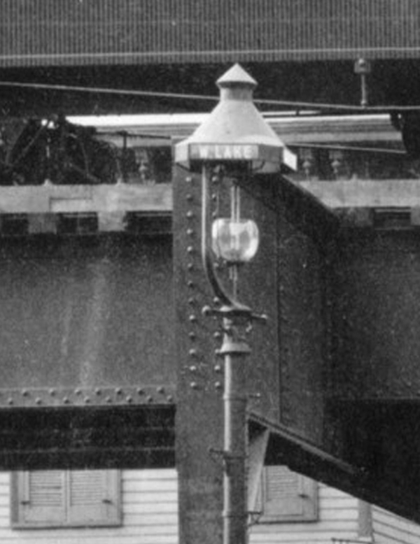

For now is the street names on the tops of the street lights.  These were at the corners of the main streets.  They used carbon arc lights that took nearly daily attention.
I printed the names in photo shop and did a negative reverse.  Also, Photo shop as also MS Word, you can put in any font size, not just what they hand you in a pull down menu choice.
I used a 3 font to get it small enough.
Below is also a blow up of the source photo to see what it said.  W. Lake and on the side is Oakley.
see ya
