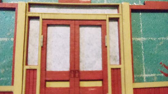

Thank you also my kind friend. The door hinges were painted with Model Masters Jet Exhaust. I still need to paint the door handles.

As Donato noted I painted the front door hinges. I used Model Masters Jet Exhaust for the hinges and I still need to paint the door knobs and plate brass.

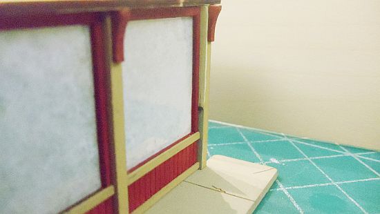

The kit also has several small corbels for the top of each wall post. These are to be glued to the top of each post with the two corner posts getting two, one on each front and side.
These get glued flush at the top.
I used a square to make sure they were all flush at the top.
I noticed also that the one top left interior wall brace could be seen from a front view. To solve this problem, I used a sharp #11 blade and shaved the corner as seen in the photo below.
I painted the shaved end with the Polly Scale ATSF Catwhisker Yellow - same color as the upper walls.

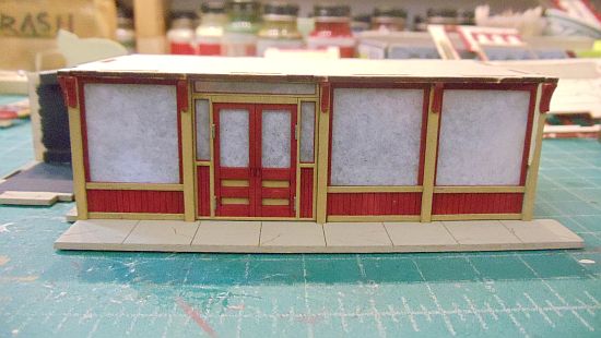

I then test fit all the front walls (not glued) into the slots on the base.
I then installed the roof section (not glued) on top to make sure nothing needed to be adjusted.

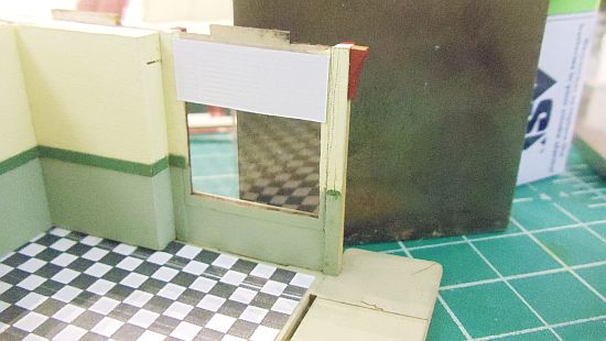

I noticed a portion of the right interior wall was painted as the interior.
This is an excellent reason to not glue but to test fit walls first.
I marked the window using a pencil.
I then hand painted the wall post with the Floquil Depot Buff.
Problem fixed.
