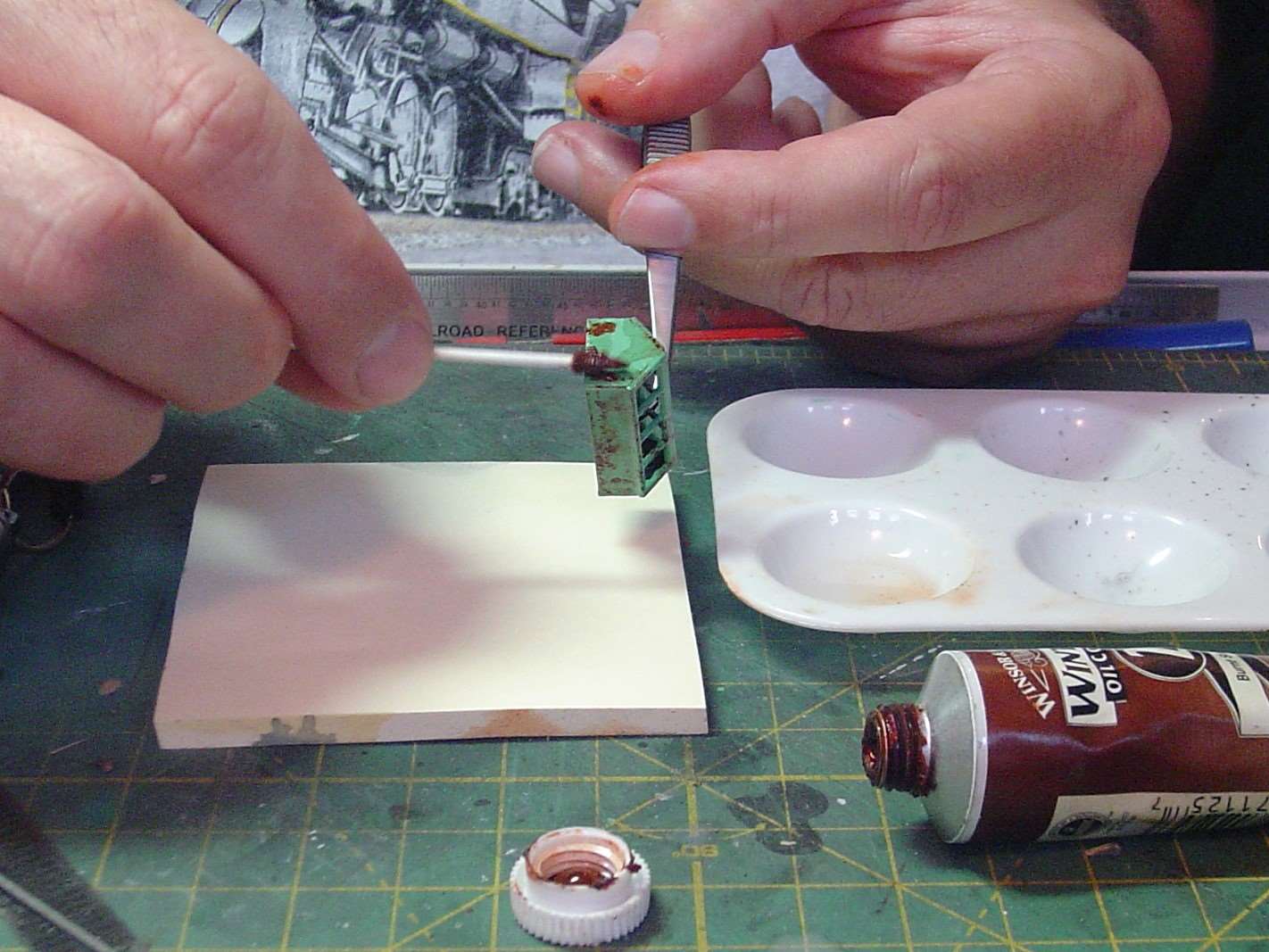

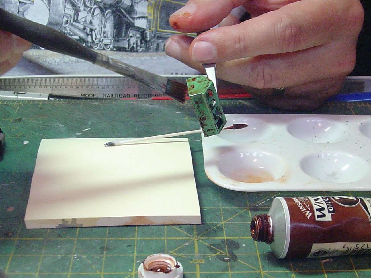

After building the skylight I opted to add some rust patches to it using oil paints.  I first dab on some small spots of rust colored (Burnt Sienna) oil paints using a q-tip like applicator (this is one I found in the model section of Hobby Lobby).
Afterwards I take a flat brush dipped in odorless mineral spirits and drag the brush (lightly) downward over the spots of oil paints.  This is a very forgiving way to get rust patches and streaks.  If you don't like it, wash it away with the mineral spirits and try again.  It takes a long time for the oil paints to set.  :D

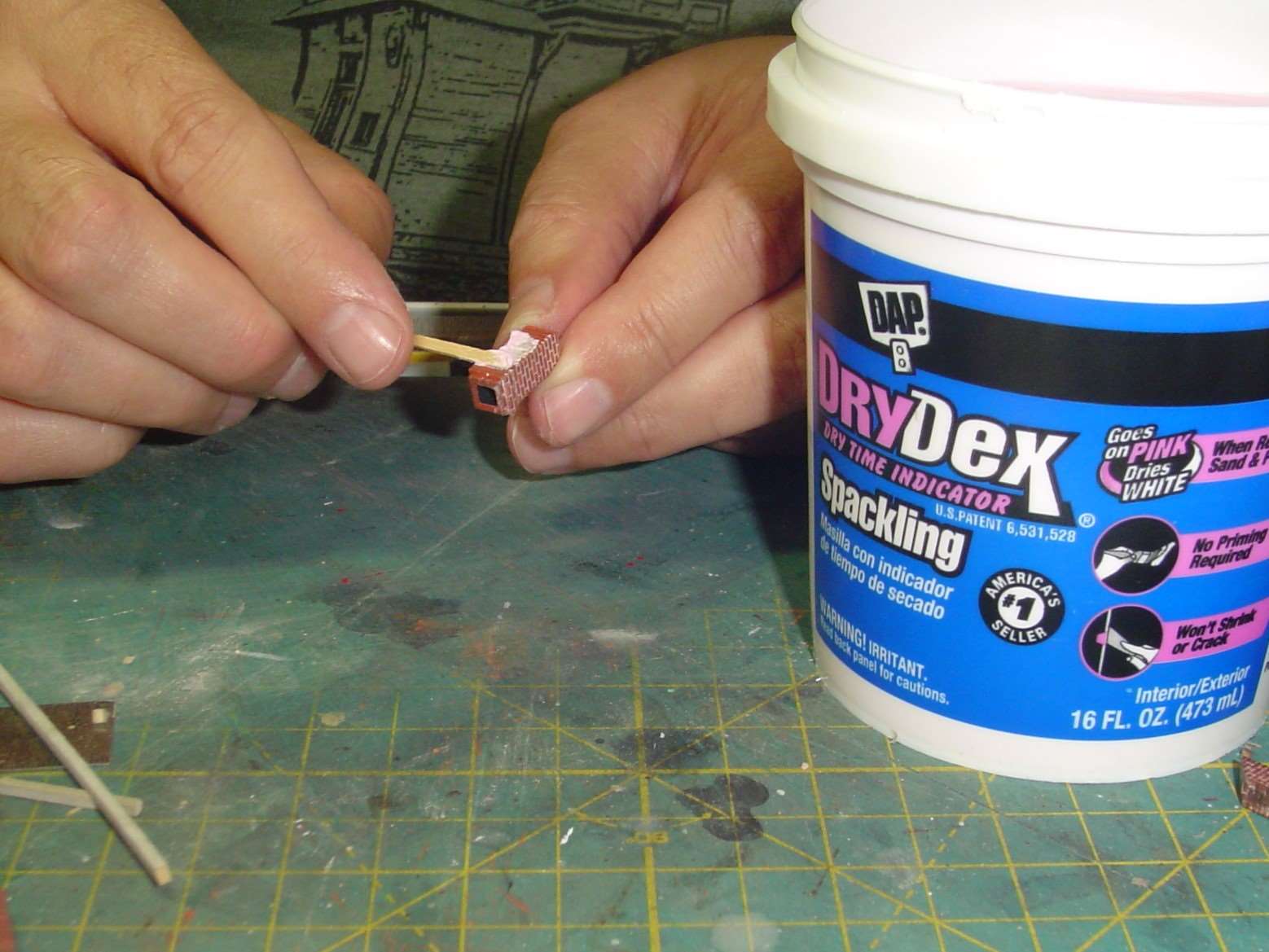

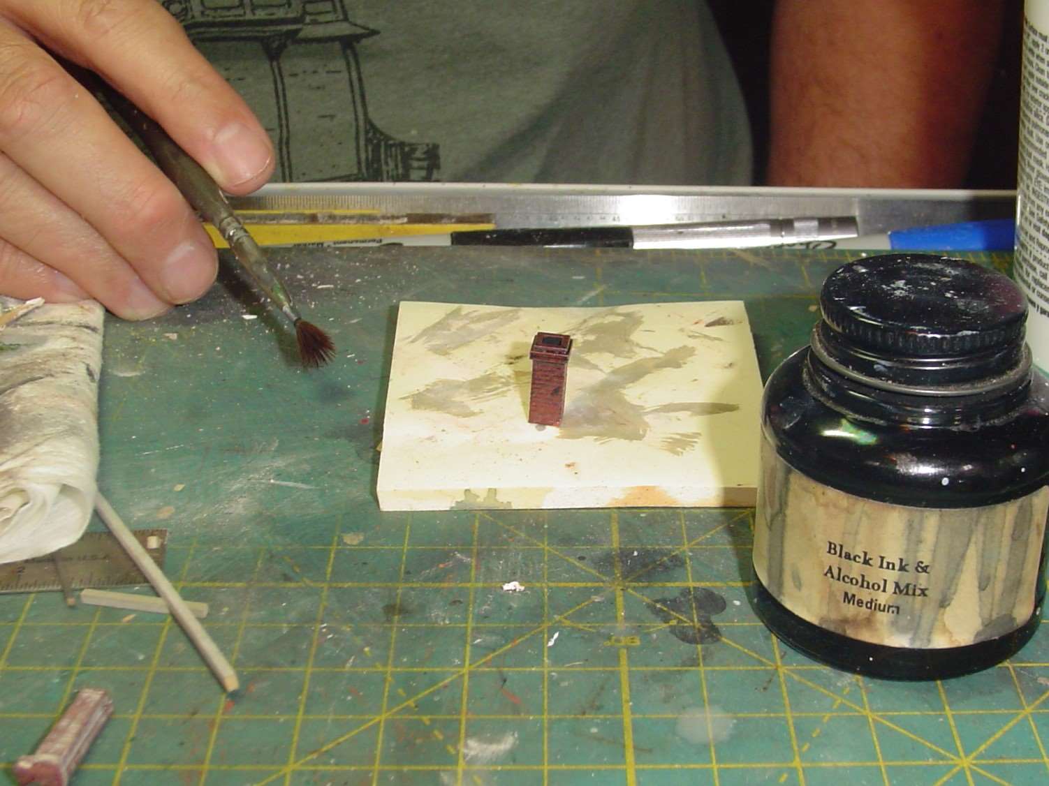

I added mortar to the chimney using regular lightweight spackle I picked up at Home Depot.  This brand is pink but dries white.  It's too white for most mortar (though I have seen some that looks very white) but that can be taken care of after it dries.
A wash of A&I tones down the white mortar considerably.

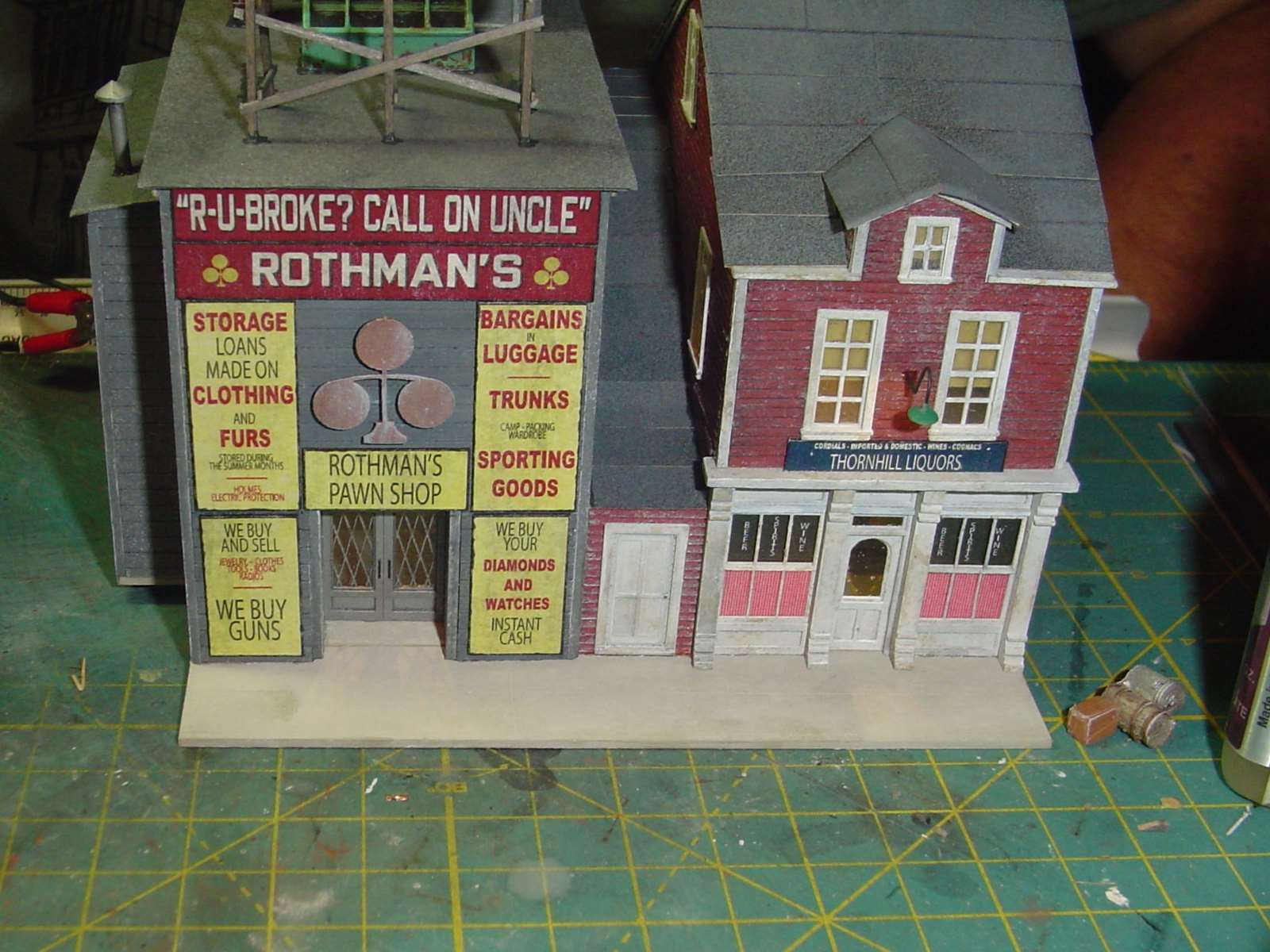

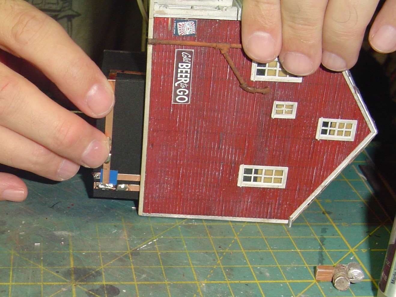

I won't go through all of the steps I did to light this one up but basically I crafted an insert that slips into the building and contains the LED's.  I was careful to not have the insert cover up any of the windows (though a dark room here and there is actually something you'd expect to see in real life).  On the top of the insert I left a + and - lead to solder the wires from the gooseneck lamp to prior to sliding the insert into the structure.
Normally I'd slide the insert into the structure and then adhere it with just the smallest drop of glue but in this case the fit was just about perfect and no glue was needed.  I got lucky.   ;)

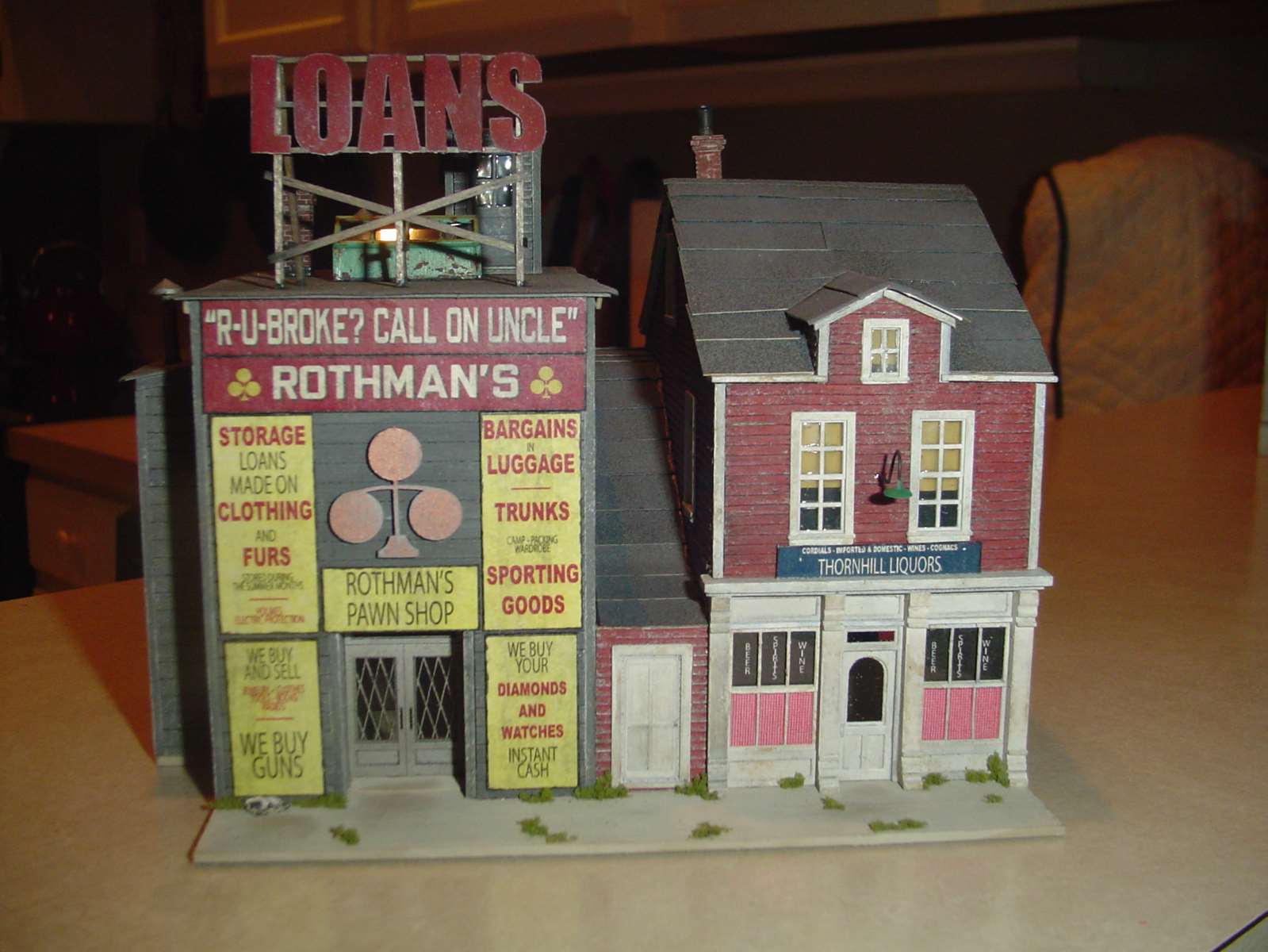

Bummer...the flash from the camera drowned out the lights but they're lit in this picture.  This was just a test to make sure they were working correctly before carrying on with the final details.

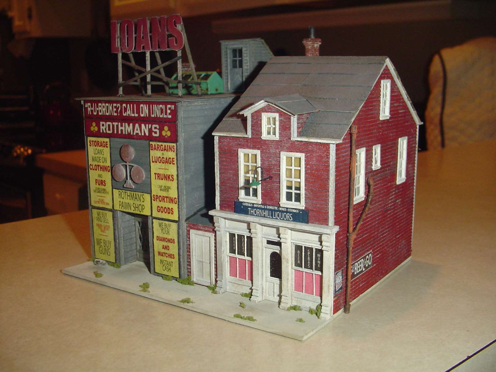

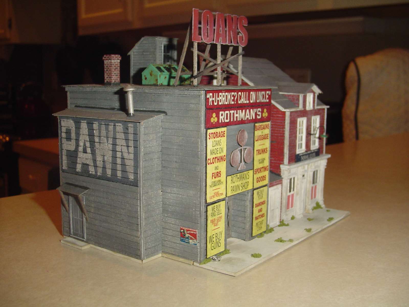

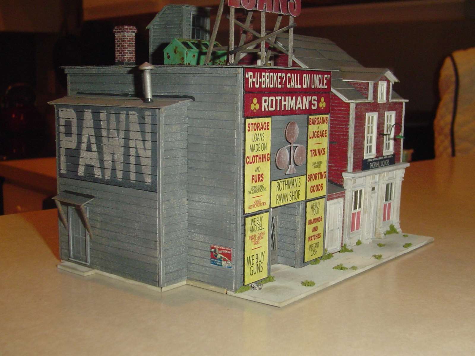

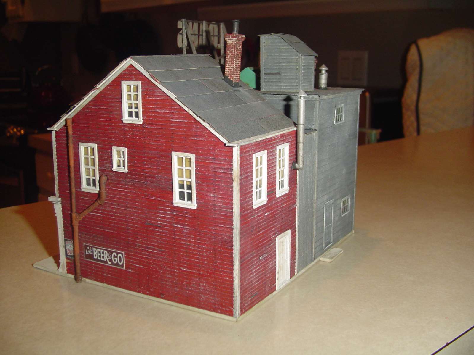

Here's the final structure after adding the chimney's, vents, weeds, etc.

Great job Bob. Is the black structure from the kit or made up by you to support the lighting?
Thanks Curt!  The insert was my own concoction and I made it up on the fly using some black, photo mounting board that I bought at Sam Flax.  It's a bit hard to cut, it takes several passes with a #11 X-Acto blade, but it's nice and stiff and works well for me when I add the lighting using copper tape.   :D
