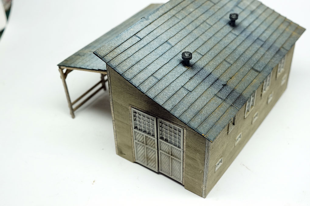

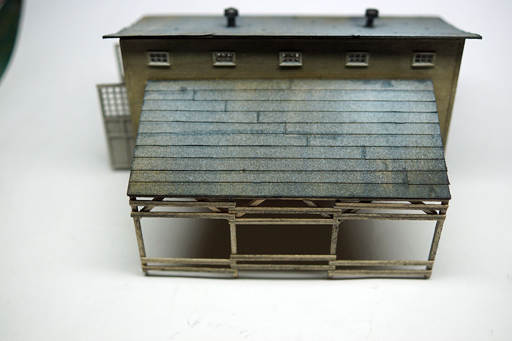

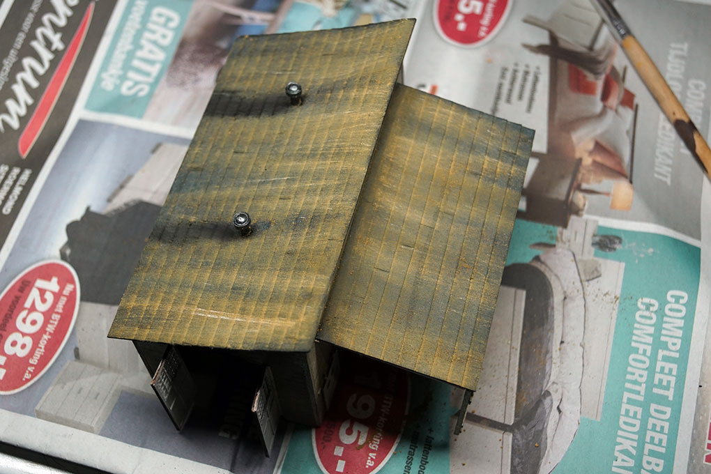

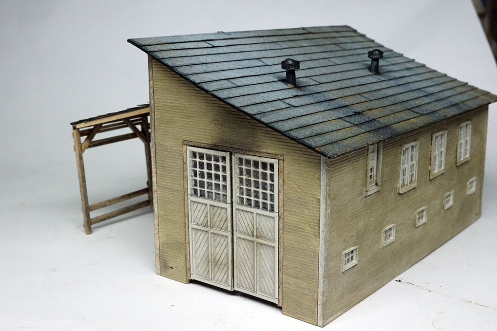

Weathering the roof with powders , a bit too much , no not really , you'll see later.

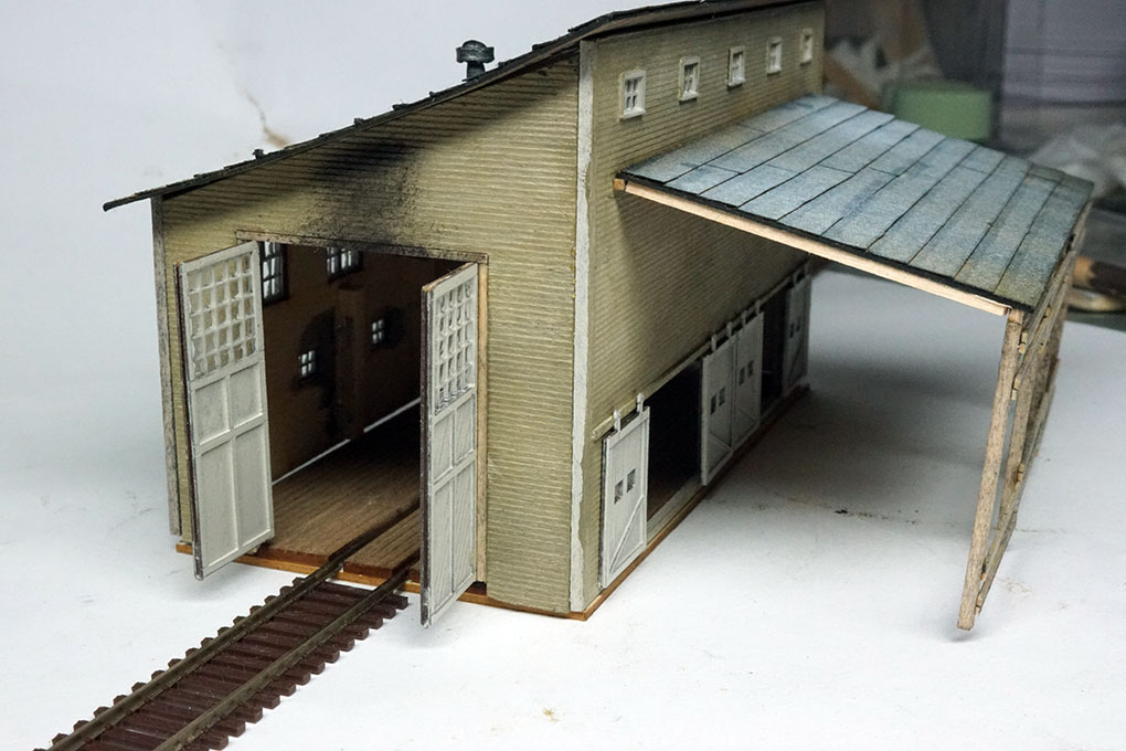

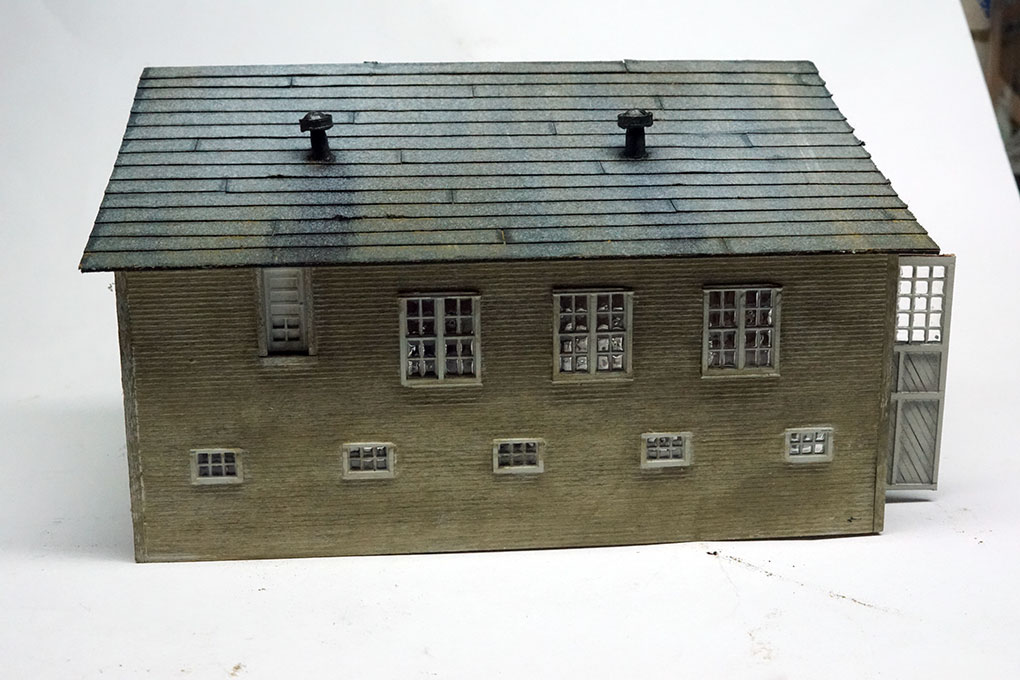

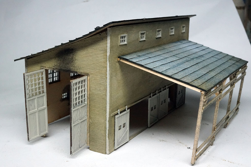

Same roofs after a spray of Dullcoat. And some more photo's of the finished outside of the structure, still hoping to find a decent photo for the inside.

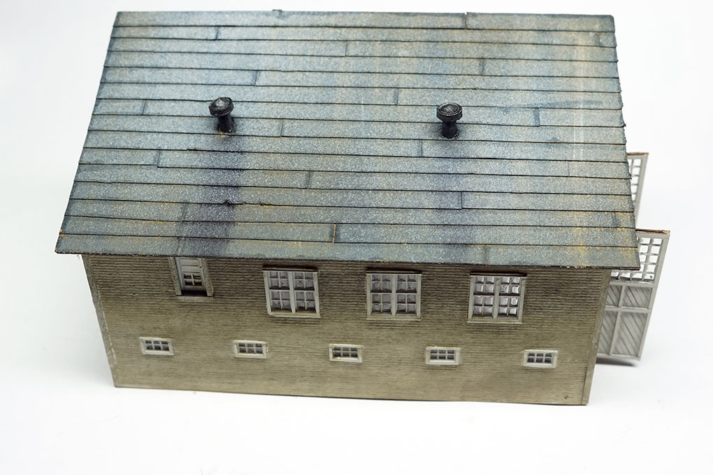

Okay , I edited the photo's and saw them at least 5 times each and didn't notice one of the walls was upside down, have to fix it tomorrow.
Quote from: Janbouli on June 23, 2018, 04:40:50 PM
Now that's funny.....don't feel bad, I've almost done that a couple of times myself (luckily caught it before it was glued).....and I'm a builder..... ;D ;D ;D
I guess the door at the top of the wall was a dead give-a-way.
Quote from: jimmillho on June 24, 2018, 11:47:18 AM
Yeah , the little people complained they couldn't get in. Fixed it this evening, all it took was a very sharp razor blade.

Just found this thread. Build(s) look great - can you give some more details on how you finished/weathered the rolled roofing? (or did you cover it and I just missed it? )
Thanks!
Marty
Marty McGuirk
Manassas, VA
#87
Quote from: CVSNE on September 19, 2018, 10:57:12 AM
Thanks!
Marty
I use powders , in this case some moss green and brown colored ones , just brush some on from top to bottom. Then  ( found this out by chance ) I fixate it with a spray can of Humbrols Hobby Spray Varnish , I don't know if it's the brand I use or something else but it always gets that white faded look, I love it so I'm looking for a new can of the stuff. Seems the replacement is Acrylic Varnish matt from Humbrol, just hoping it has the same effect.
