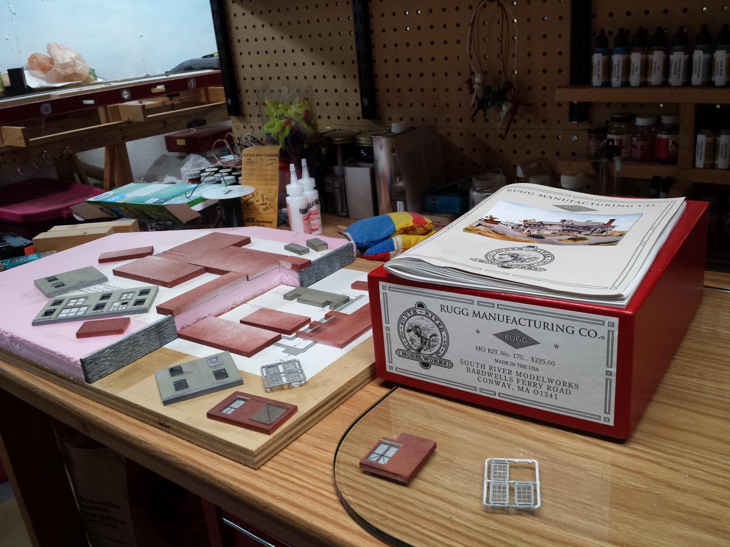

I'm going to try my first build thread. I have had the SRMW Rugg Manufacturing kit sitting on my work bench, barely started, for probably 10 years or more. For the last year or so I have been working on bench work/track work/wiring and whining that's it's taking a long time and keeping me from building models that I find more interesting. It finally occurred to me that I can control that outcome. So, my hope is that starting a build thread will add a little friendly (or maybe even not-so-friendly) peer pressure to make progress on the kit and have some fun in the process. Here's the state it has been in:
As you can see, I built the base, painted some castings, painted a few windows and "Micro Crystal Clear"ed them, and that's about it. Not sure which primer paints I used on the castings. Not sure where I am in the instructions. I'm not even sure if I lost any parts. I assume no but won't know until I get through the build. I have some Vallejo paints now -- used Polly S to get to this point. We'll see if that matters. Tonight I'll dig into the instructions and see if I can make sense of anything or how much trouble I'm in. I'm hoping that the collective experience here in the forum can help out as I run into problems.

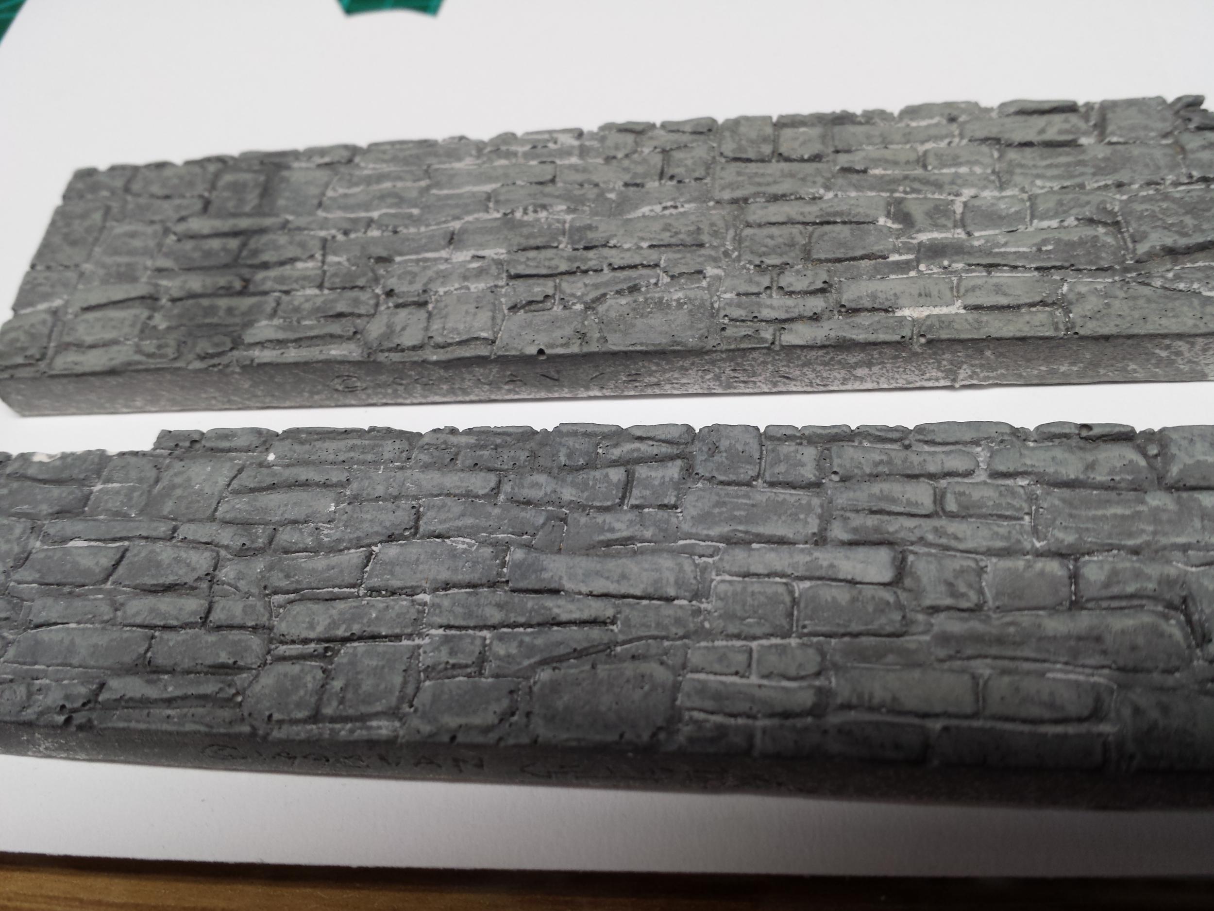

OK - looks like where I left off was preparing the castings that have to be installed as part of the foundation. I am starting with the stone retaining walls. Here is how I left them a decade ago:
Yuck. As I work through instructions, I check things off in the manual (as I am sure most do). I had this checked off. No idea what I was thinking that day. Doesn't come through with the picture very well but it looks like what I did was hit it with a gray primer of some sort and then a little AI wash. The white you see between the stones is uncolored hydrocal. I was pretty unhappy with the effect and decided to paint over it with acrylics. Normal thing to do, anyway - prime the casting with spray primer to seal it and provide a base color and then apply acrylics for the final effect. But, I didn't do that here. Also, I wanted to try to achieve a little variation between stones (as is suggested by Bob). Finally, I wanted to start using the MicroLux paints I purchased a year ago in anticipating of getting back into building. So, to start, here are the colors I'm going to use:

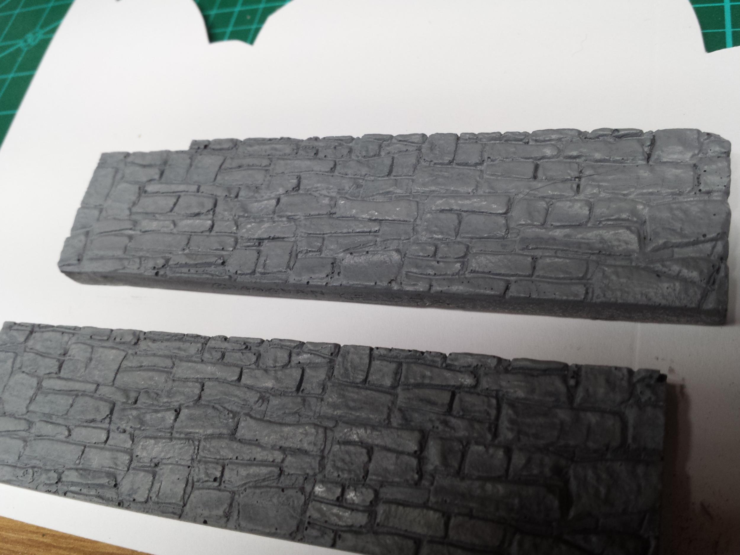

The Undercoat Light Gray looks pretty close to the existing color so I will first paint both stone walls with that.
The pictures are less than ideal. My shop light is directly over my bench so I have to take the pic from an angle to avoid shadows. Going forward, I'll figure out how to either move my work area or get a lamp involved. I am also using an old Samsung S4 for taking the pics. Autofocus on. Probably need to spend a little time figuring out how to do that better, too.
OK, for the first time I am seeing all of the air bubbles in the casting. Photographs are wonderful at giving brutal feedback. I wish I would have seen this earlier although would be quite a pain to fix them all. I'll leave it alone for now and see how distracting it looks when finished.

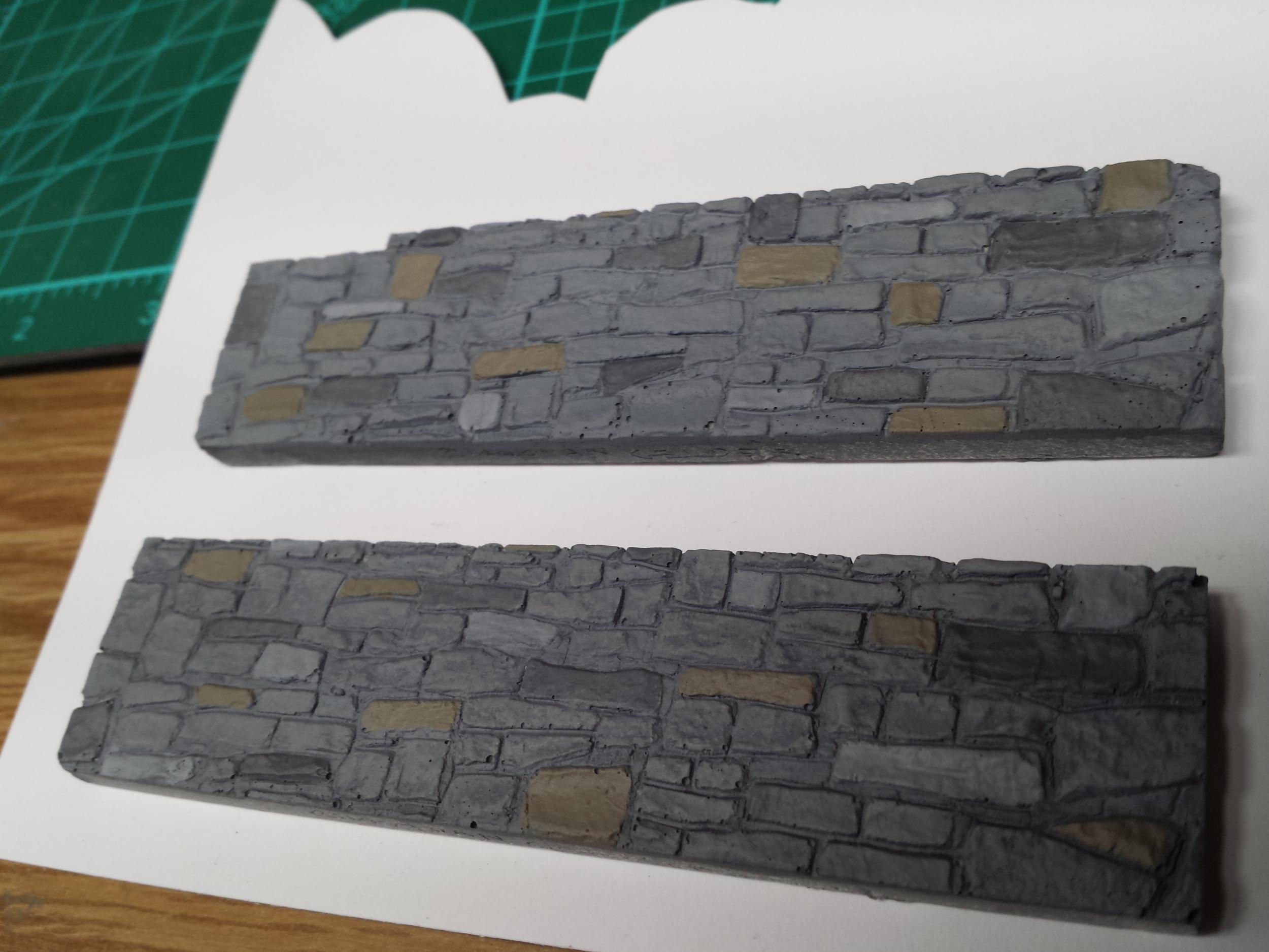

Next step, some stone variation. I'll paint a few stones "Earth" color and some others different shades of gray. For the shades of gray, I made three puddles of paint on my glass workspace: one Undercoat Light Gray (my base color), one Reefer Gray (a darker gray), and one Reefer White (the marketing guys kinda phoned that one in, no? Reefer This...Reefer That...  Anyway). From the three puddles, I made some more puddles from  the base gray and white or the base gray and reefer gray. No science to it. Just looking for slightly lighter and darker variation by eye. Here's the result:
My first reaction is that this looks much better than what I started with but the earth-colored stones look a little stark to me -- too much contrast. I now wish I would have watered down the earth to more of a wash rather than using straight paint. But, won't worry about it for the moment. We'll see how it looks after some chalks are applied.
Also, now that the paint is dry and I seem to have a better camera angle here, the air bubbles are more visible. Disappointing.
