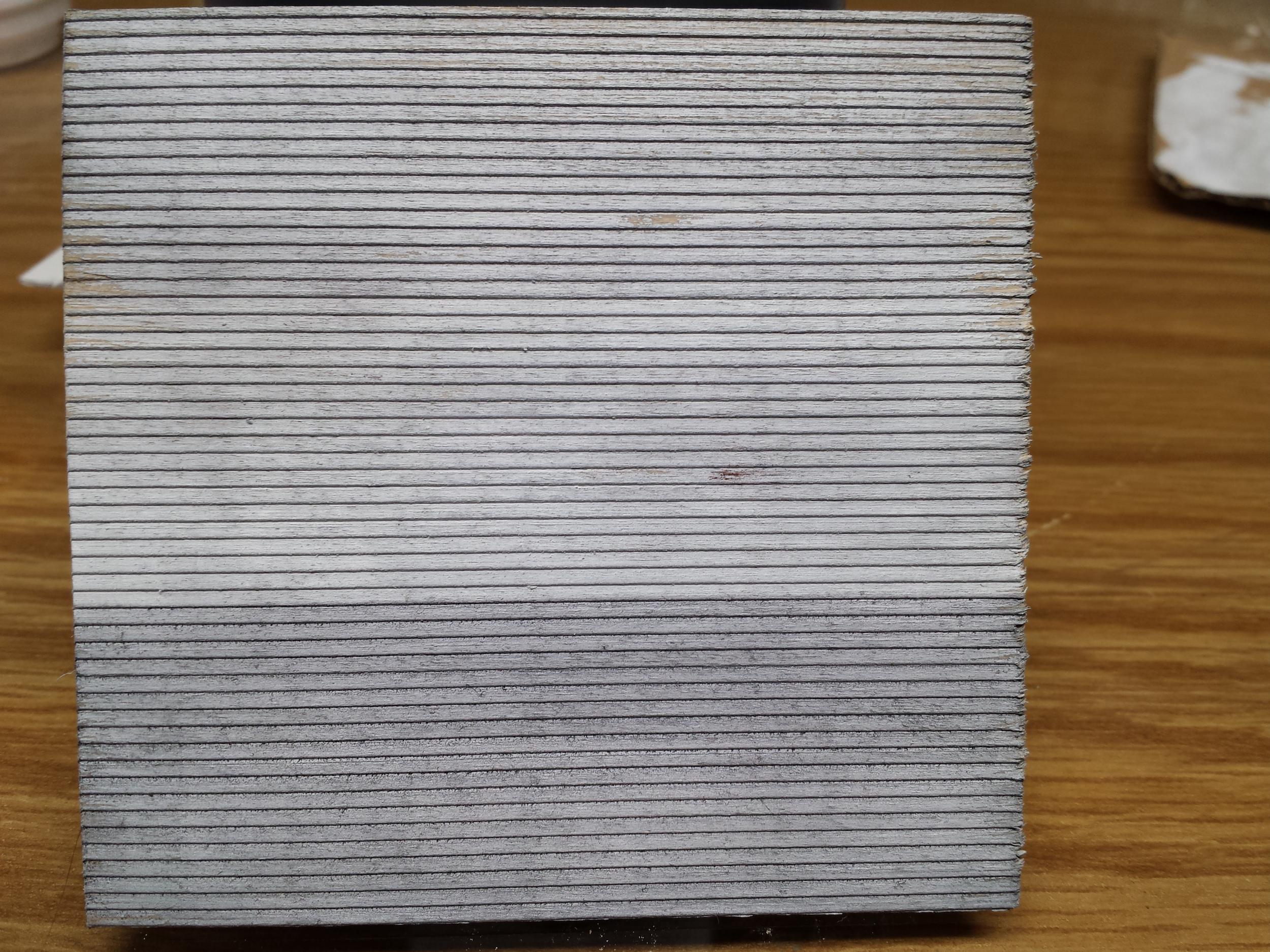

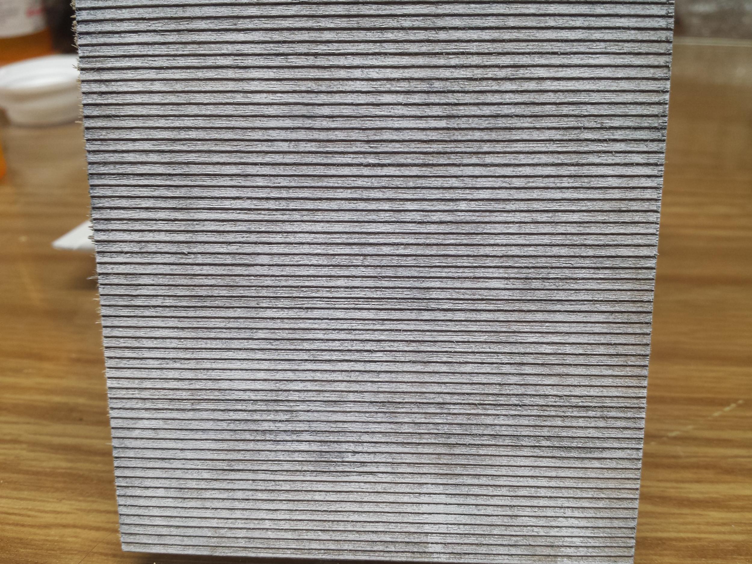

Finally had some time and the materials to do a few clapboard tests. As I mentioned earlier, I bought some clapboard sheet from my LHS and cut it up to make separate test panels. I would appreciate opinions and suggestions. For all of these tests, I started by trying to do a little texturing of the clapboard by first using a file card and then some scratch brushes.
Picture 1: start with medium AI stain (2 tsp / pint). Then, sponge on some medium gray acrylic paint. When dry, sponge on some white acrylic paint (using synthetic cosmetic sponges from Sally's beauty supply, FYI). I didn't do any board lifting here. If I do it now, I will get a "raw wood" color underneath. Would either need to touch that up with a pin or toothpick or, when I do the real walls, I guess I should do the lifting first, then stain.
Picture 2: Start with a light coat of Krylon gray primer. After drying overnight, paint with a light, somewhat watery coat of Reefer White. After drying gently use a single-edge razor blade to make light, horizontal scrapes of the paint to simulate some peeling. You can see the biggest example of that toward the top of the panel in the middle. Finally, I tried two different alcohol washes on top. The bottom third of the panel is a medium wash (2 tsp). The top third is a light wash (1 tsp). You almost can't see it (a little better in person). The middle has no wash. When I scrap away the paint, you can again see bright, raw wood. I could use a heavier stain on top, but that would darken the white as well. Perhaps the sequence here should have been dark stain first, then Krylon primer, then Reefer White, then scraping. I am also wondering whether some sort of chipping technique would make sense here between the primer and the Reefer White. I've never done that. Sorry -- forgot to mention -- on this experiment, I also used the file card after applying the Reefer White. Then, used the razor blade to make a few sections a little more bare.

Would love to hear opinions and suggestions. I like and dislike each one for various reasons. Not yet sure how to choose. Or, maybe try some more experiments.

Great job experimenting, Vince. I like the first sample. I do my board-lifting prior to inkahol wash to avoid the raw wood peeking through. I'm also a nail hole guy, but let's not go there. 😜
