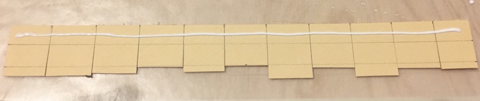

Not wanting to watch paint dry, I added blinds to the windows of the express building.  (This would have been much easier to do before I glued the walls together but I forgot.)  I added some simple view blocks into the building to prevent being able to see all the way thought it.
The blinds are cut from tan pastel paper and glued in place with canopy glue. I cut various heights of paper to prevent them all being the same.  Although there are a few matched pairs implying an office with a picky occupant.

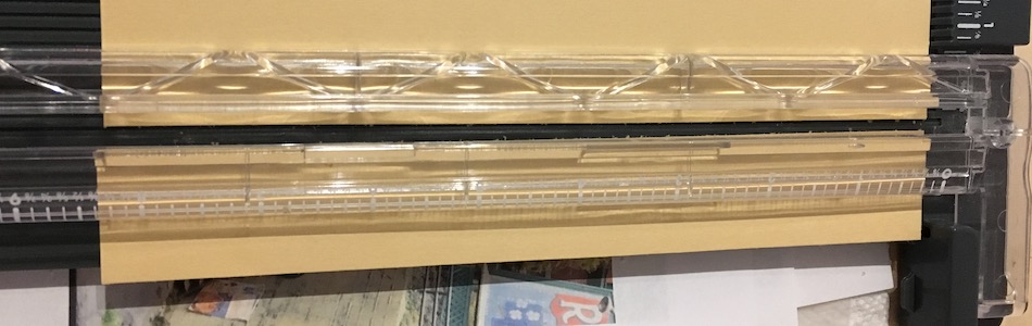

Coming along great Roger, love the canopy roof .  The cornice details came out excellent, just wondering why the cutter couldn't cut it  ;)
Random
Thanks.  I've seen the view block method used before in articles.  They are tacked in place with a bit of white glue but can be popped lose easily.
The issue with the cutter is the result of several factors:
Very small detail parts.
Material held in place by the tackiness of the mat.
Thick material being cut with a lateral blade movement in crosscutting motions.
Software limitations in creating the cut diagram.
The mat in use was not new and may not have had enough tack to hold the material.  The paper being cut was 140 lb watercolor paper and is fairly thick. The cut diagram resulted in the long horizontal cuts being made first then the smaller cuts occurring inside the small resulting areas.  I only posted one picture but there were several failure modes.  Sometimes the full sheet shifted resulting in offline cuts. Other times sections pulled loose when the blade crossed previous cuts.
I think this could have been cut on the machine but I needed more advanced software to design the pattern with as few cuts as possible.  I needed to control the order of the cuts.  And a new mat and possibly a new blade would have made a difference.  In this case I had simply exceeded my desire to fiddle with it.  Making the cuts by hand was not hard and got the project back on schedule.

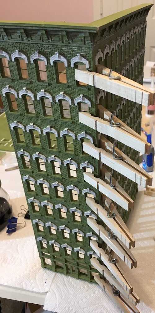

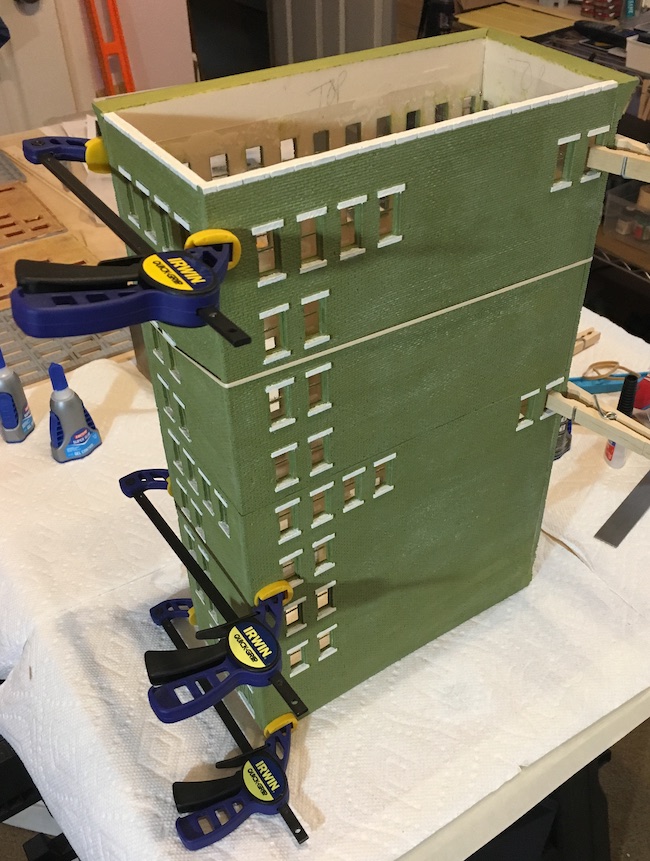

I assembled the green building.  I started with the beveled corner as this needed the most precise fit.  I used a bead of gel super glue to attach the beveled walls.  Wooden clothes pins in the windows provided good clamping points.
The cornice still had a gap at the corner.  I filled that later with squadron putty.  I allowed the beveled corner to dry overnight before moving on to the back wall.  A couple of clothes pins trimmed to blunt ends allowed me to use window openings on the back wall to help hold it in place.

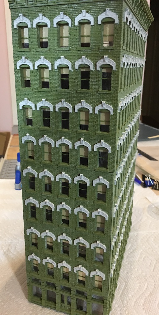

I allowed that joint to set for a few minutes before adding the final wall and clamping everything in place.
The butt-joints had slight gaps but those will be covered by drainage pipes and other details.  This was allowed to sit and cure for several days.

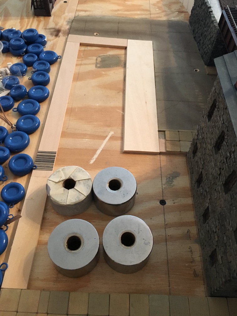

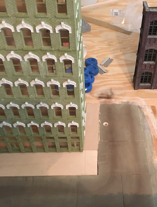

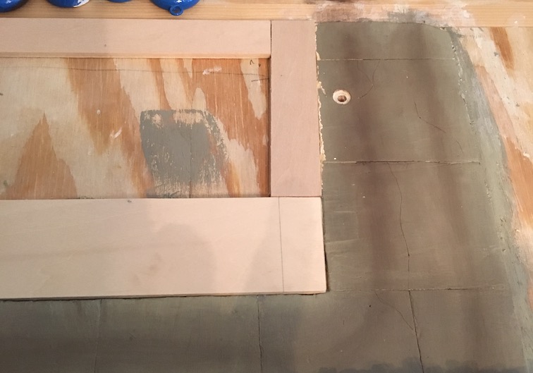

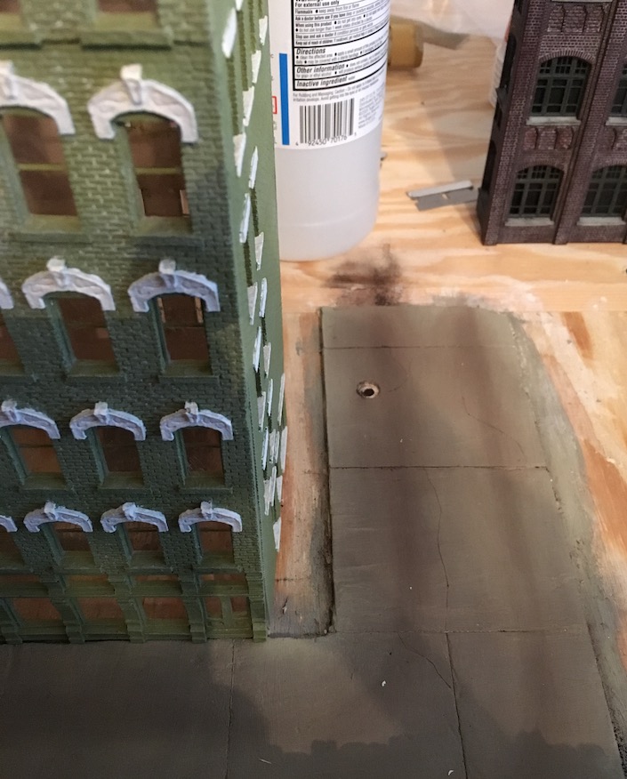

Once the green building had time for the joints to set firmly I placed it in the scene to test the fit.  Turns out the building is a trapezoid.  I didn't realize it until this point but the back wall was slightly longer than the front.  This left a visibly narrowing space for the sidewalk that would not have looked right.
My solution was to trim back the road to allow a full width sidewalk.  I used strips of basswood to build up the sidewalk and raise the building to properly align with the road.
I continued the basswood the full length of the block and joined it to the existing road.
With the building placed into the scene the narrowing road is not apparent and the sidewalk space looks correct.

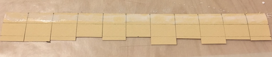

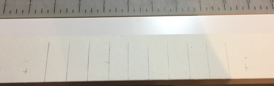

It was at about this point that I realized I had not installed window shades before assembling the building.  Rather than try to position individual shades I decided to try using strips of paper to install them one floor at a time.  I cut strips large enough to cover the window opening and allow space above the opening for gluing.  I cut strips of pastel paper on a paper cutter.
I made a template with markings for the position of the center mullions, top of the window openings and the center point between windows.
I placed each strip into the template and marked off the grid in pencil.

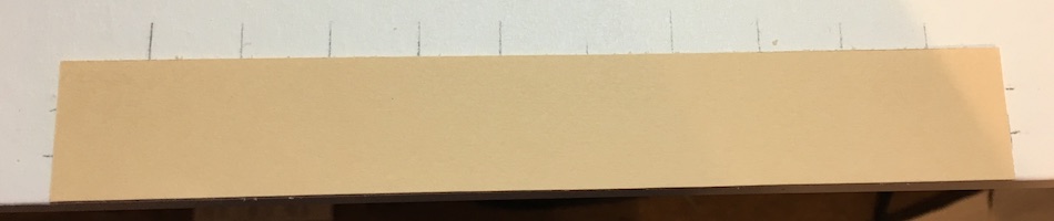

I cut each strip vertically up to the window top line and then trimmed each shade to the desired length and applied a bead of canopy clue along the upper edge.
I spread the glue out with my finger being careful to keep it above the window top line.

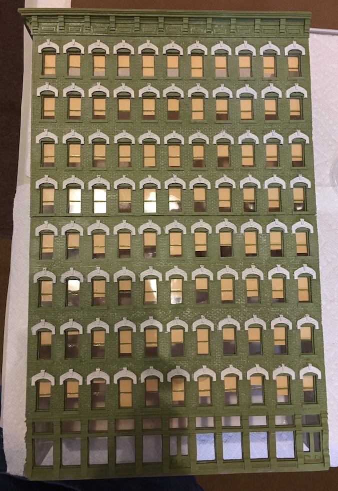

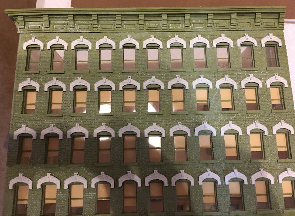

I positioned each strip behind the windows being sure to locate the center mullion line behind the mullions.  The process went fairly quickly.
Here is the full front of the building with all blinds in place.

Looking good Roger , I use strips of paper with office buildings or other buildings where they would have had the same window shades through the whole floor or even the whole building.
