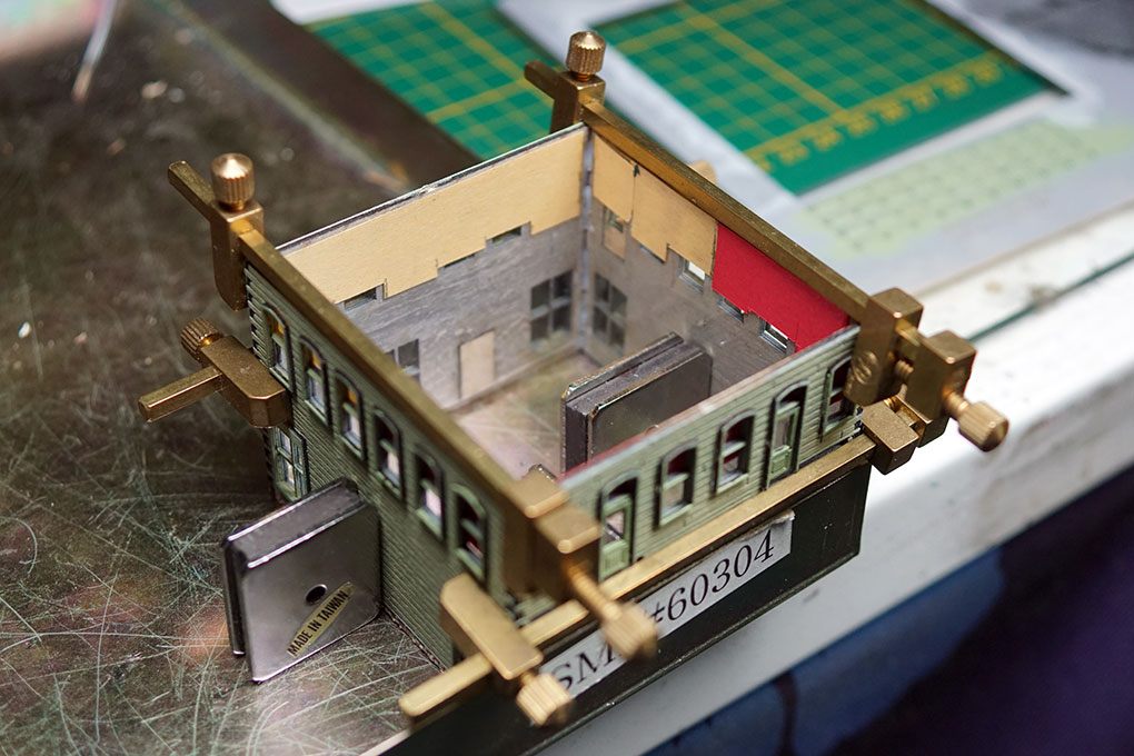

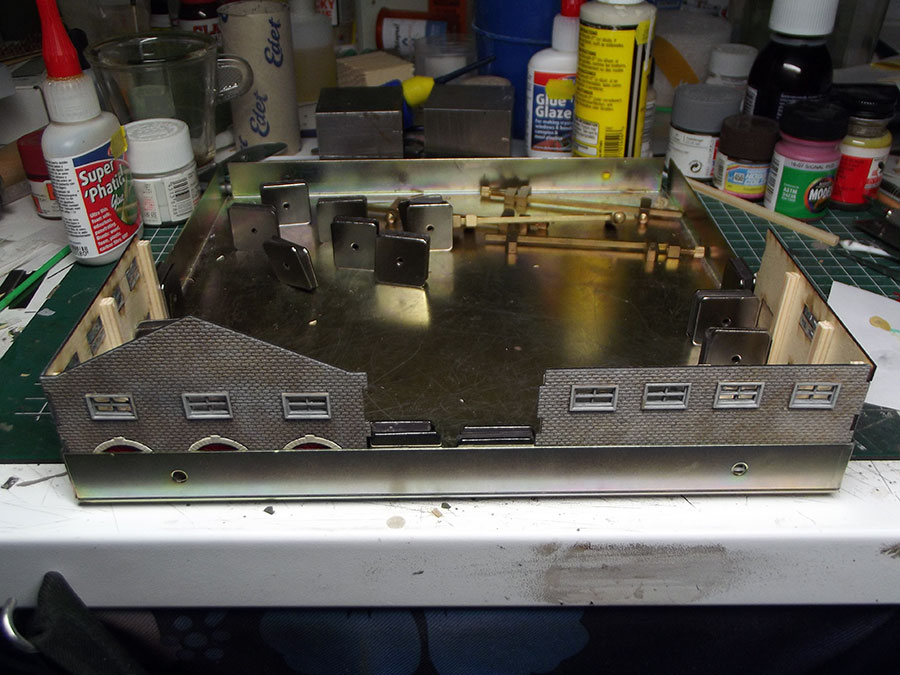

Assembling walls , very easy with the magnetic board.

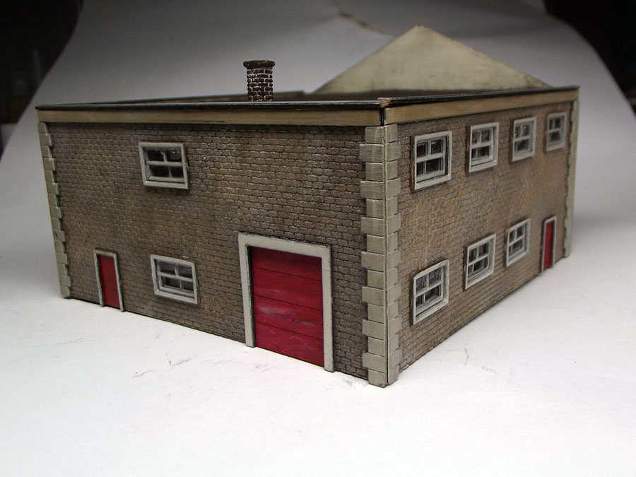

Assembled signs and trim. There is a tower in the kit for on top of the roof , I left that away , but that is a matter of taste .

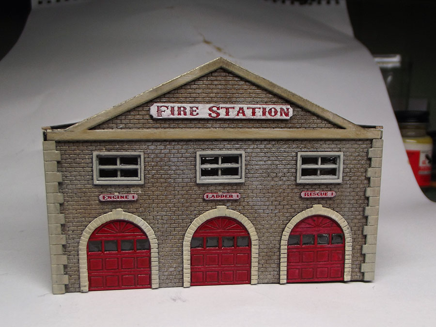

A couple of evenings fun and imho a nice addition to any N-scale layout.
Thank you Jim and Curt , these are really inexpensive kits that are fun to build .
Neat looking fire station Jan.....well done.  8)
That's are pretty nice looking fire station nice work.

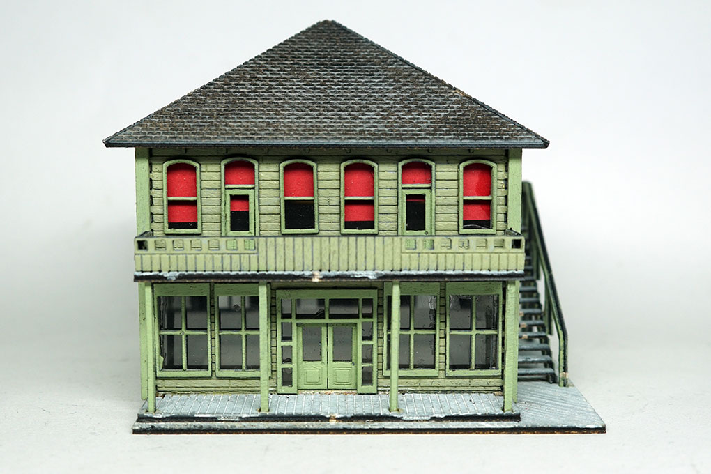

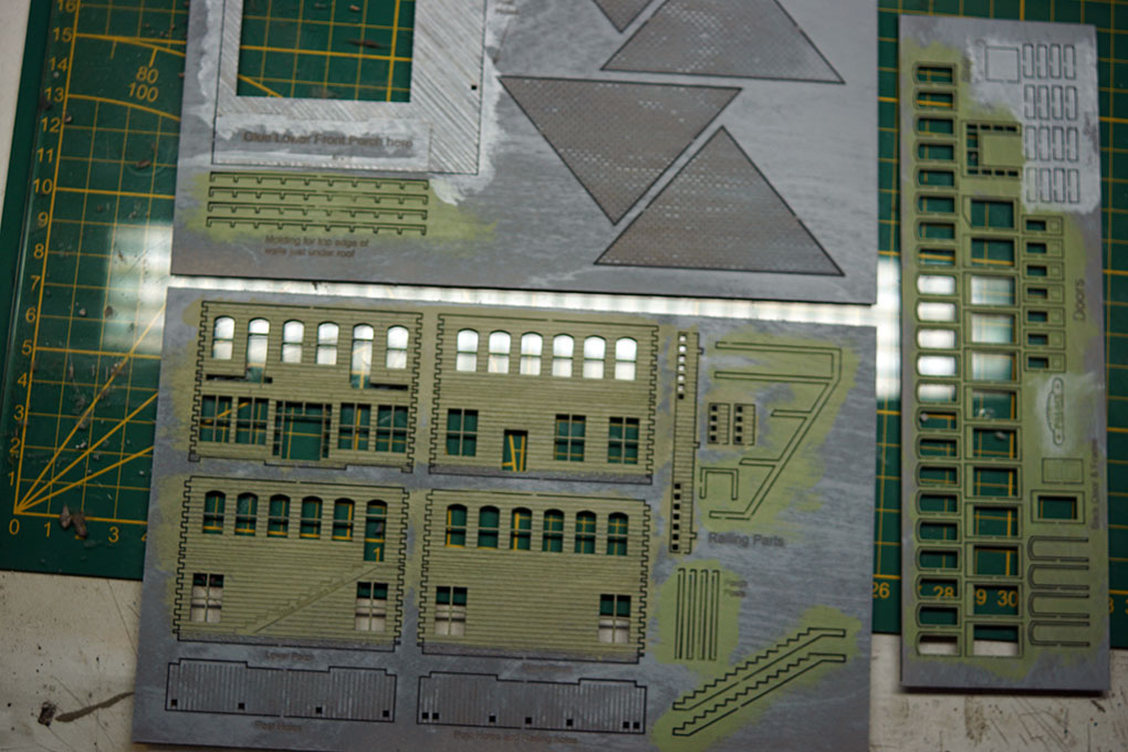

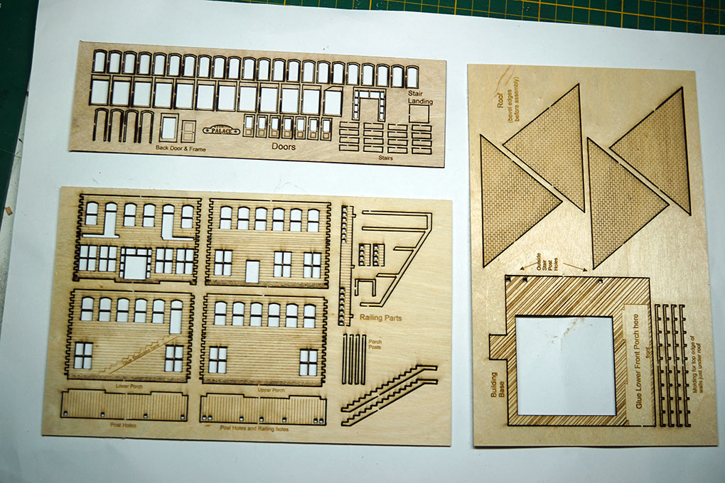

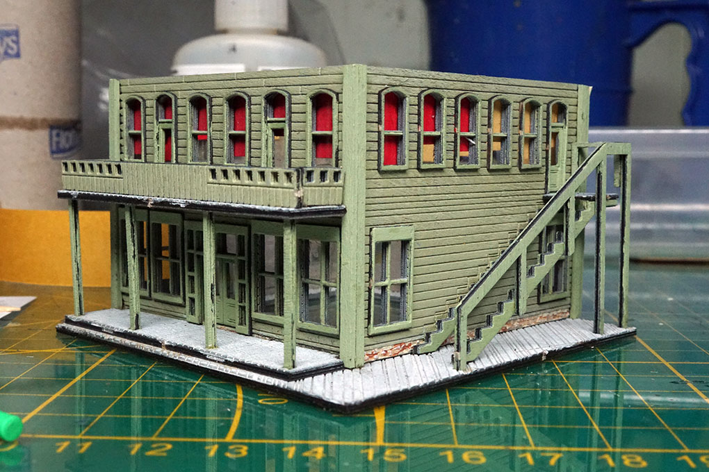

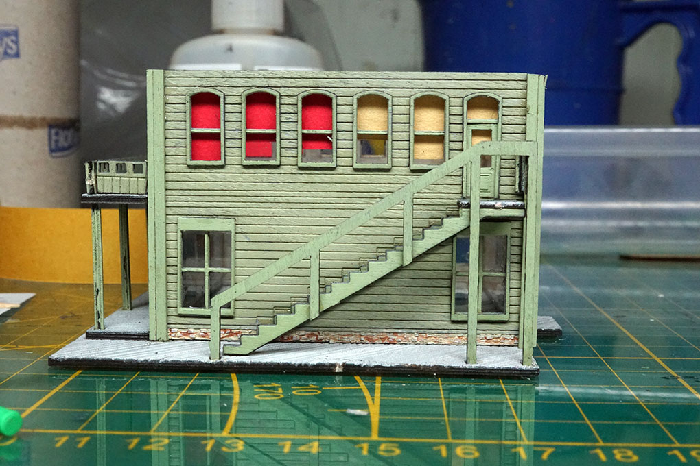

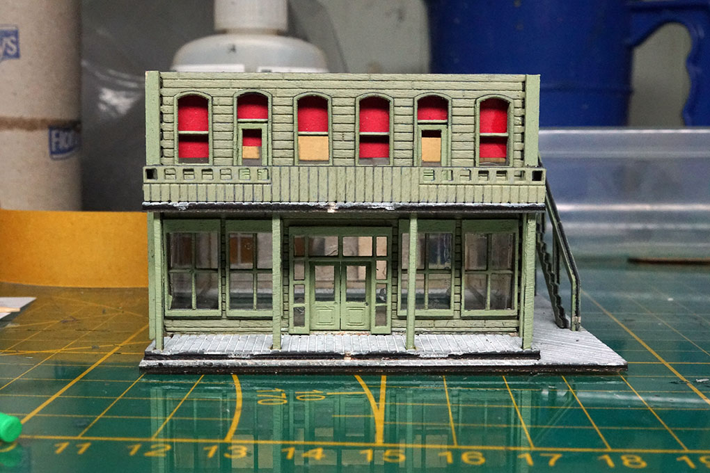

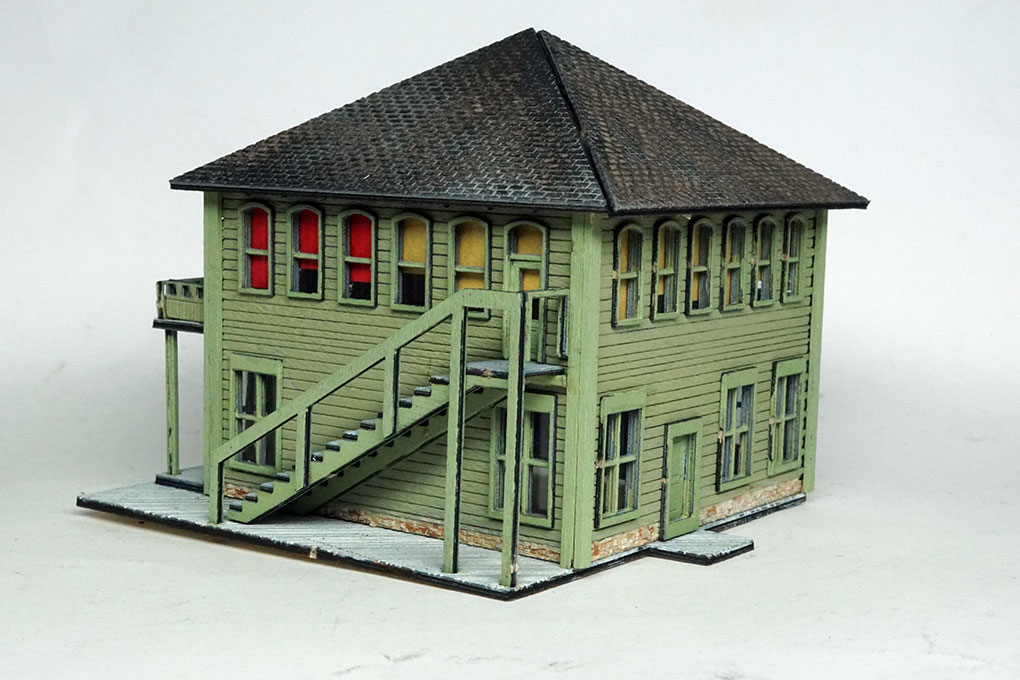

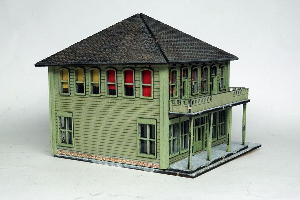

Another little kit from PPP
The real name is the Old West Hotel, it will be a restaurant on my layout.

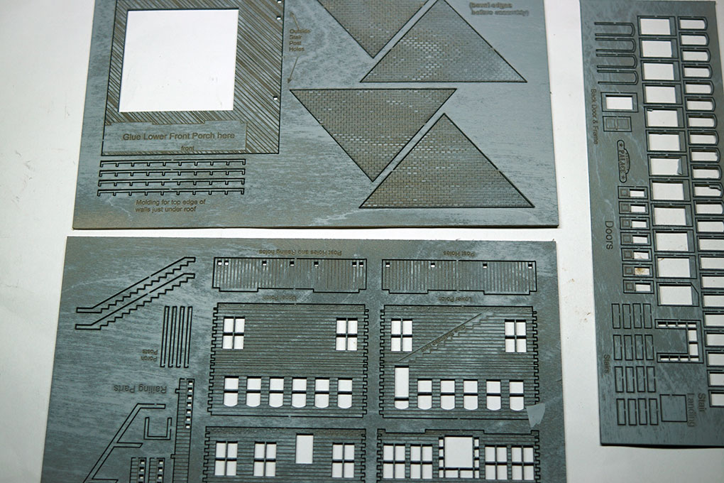

The parts, as with the other kits from PPP the walls are great , but the details should be in somewhat thinner wood.

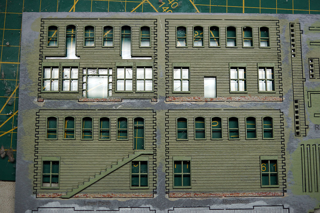

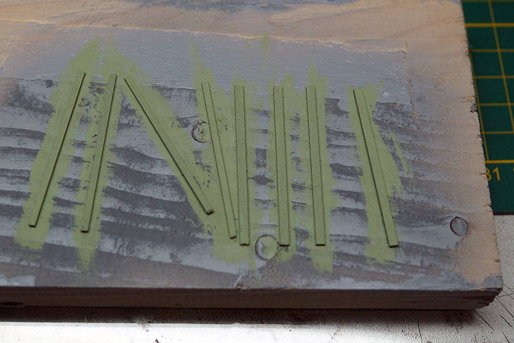

Primed with gray from rattle can.
Trim , doors , windows and walls painted with 2 different Vallejo greens.

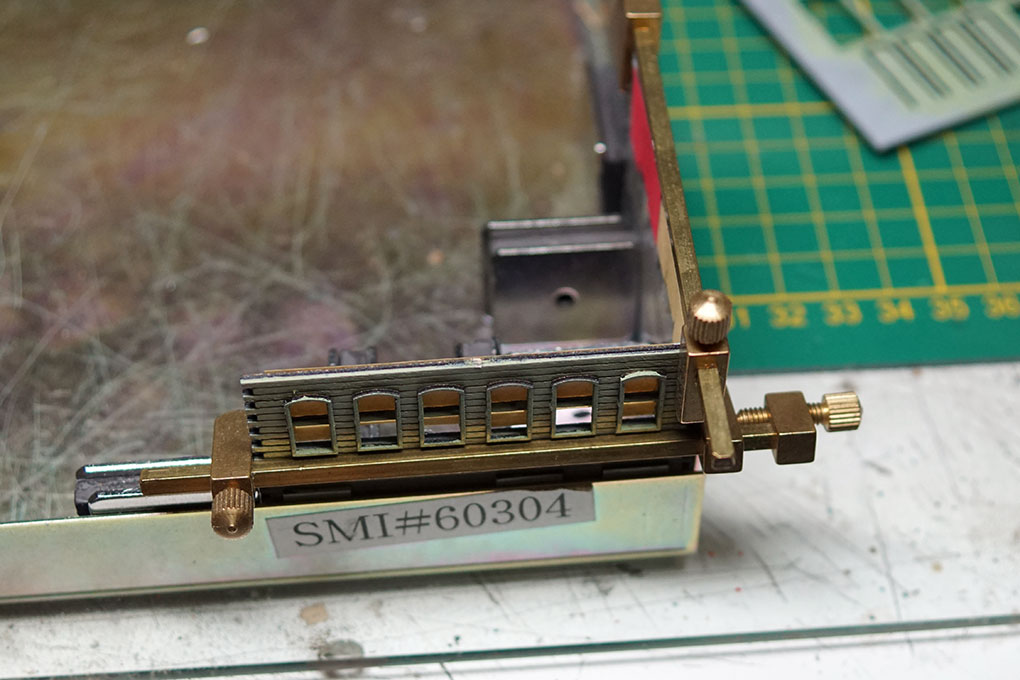

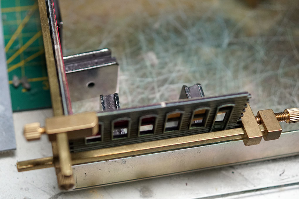

Window frames and staircases assembled to walls.
Base and floor of porch assembled and painted white.
Assembling walls.

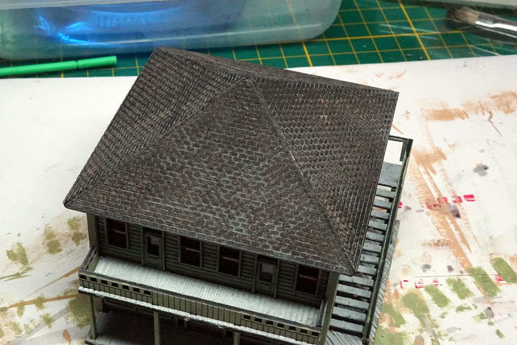

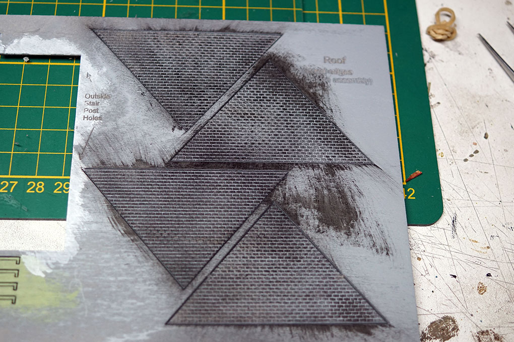

Roof drybrushed with black acrylic.

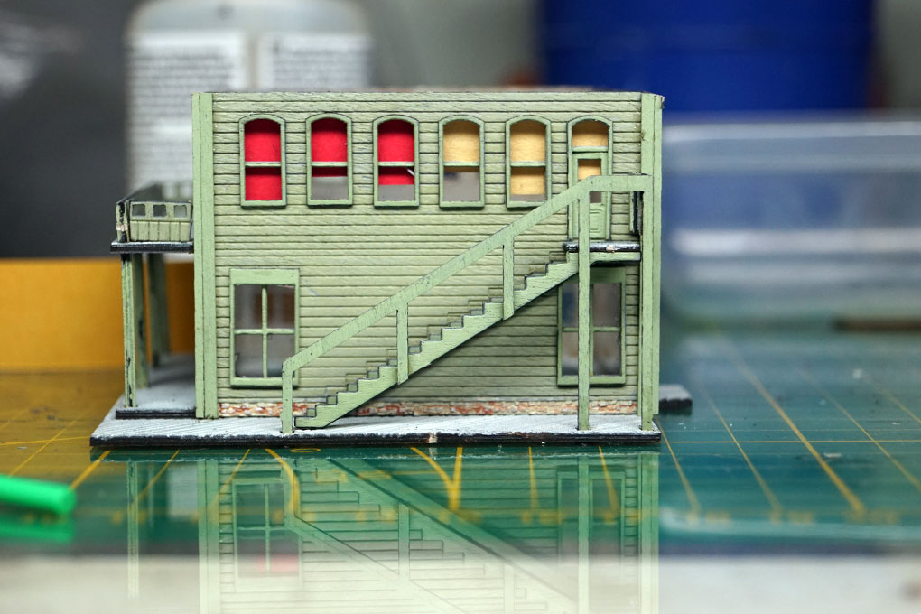

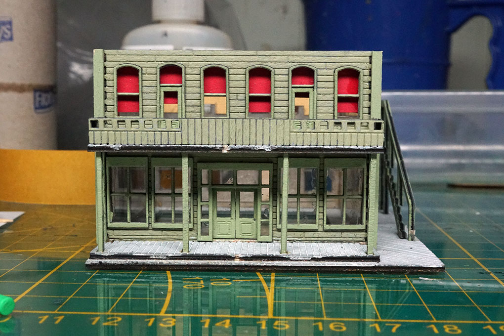

Walls fully assembled with window blinds.
Trim
Trim assembled.

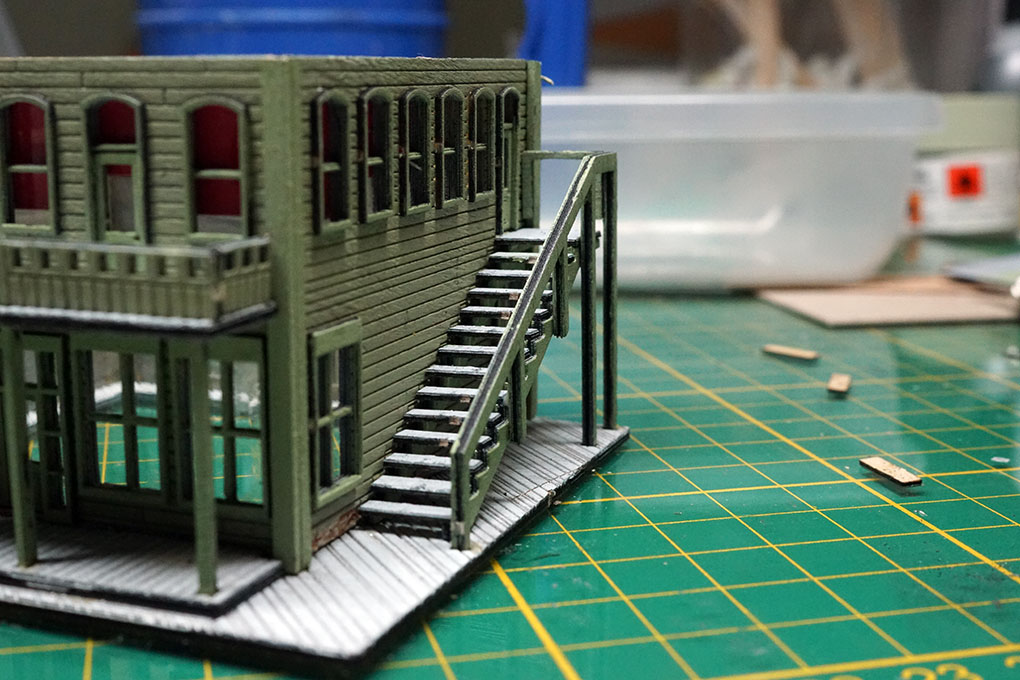

Porch and staircase assembled.
Stair steps assembled.

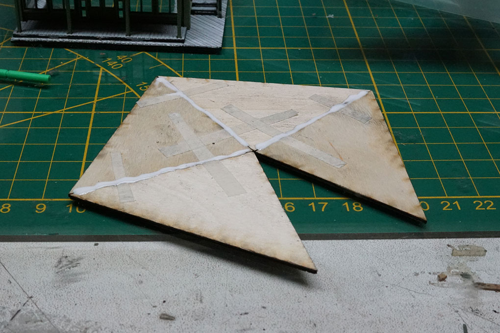

Flexible white glue for roof assembly, with strips of tape holding it together.

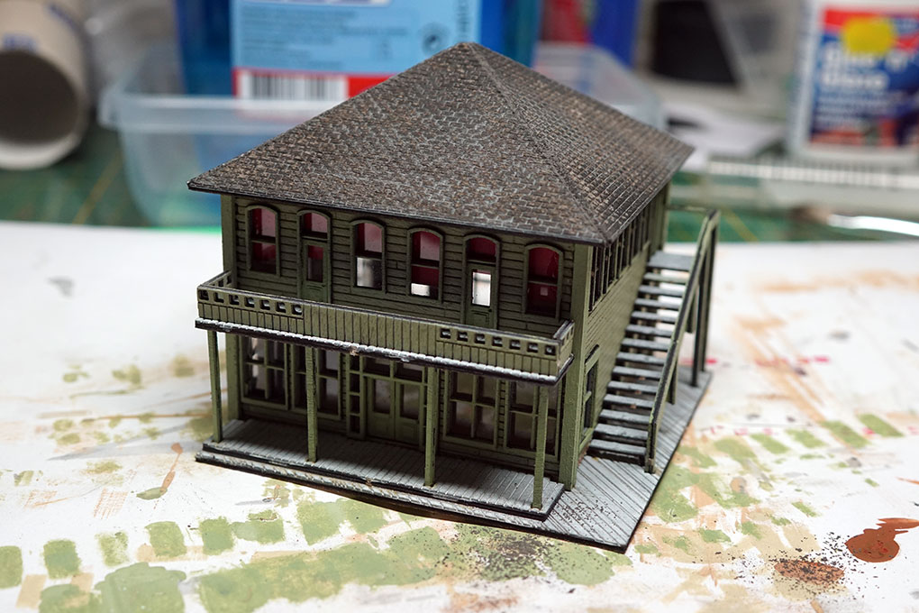

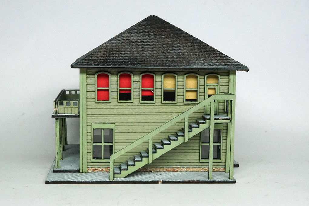

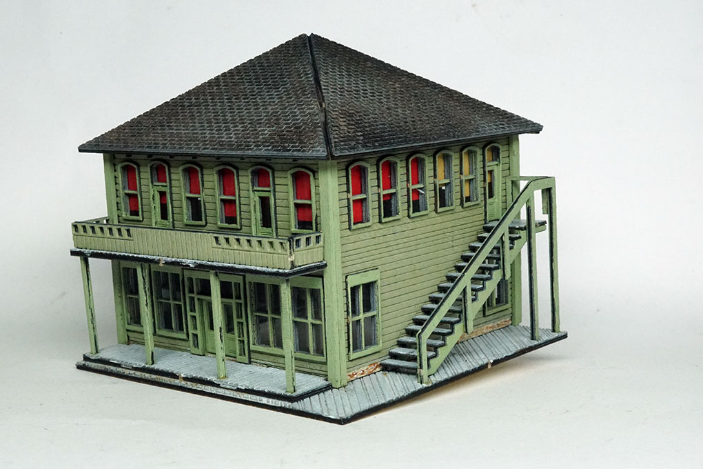

Fully assembled but still need finishing touches. Very impressed with my new camera and 30mm Macro Lens.

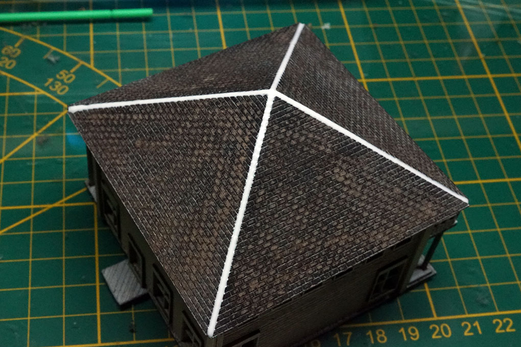

Filling the joints on the roof.
Roof looks much better now. Added several chalks and dullcoated it.
Still need to touch up the paint on the sides of the porch and such.
